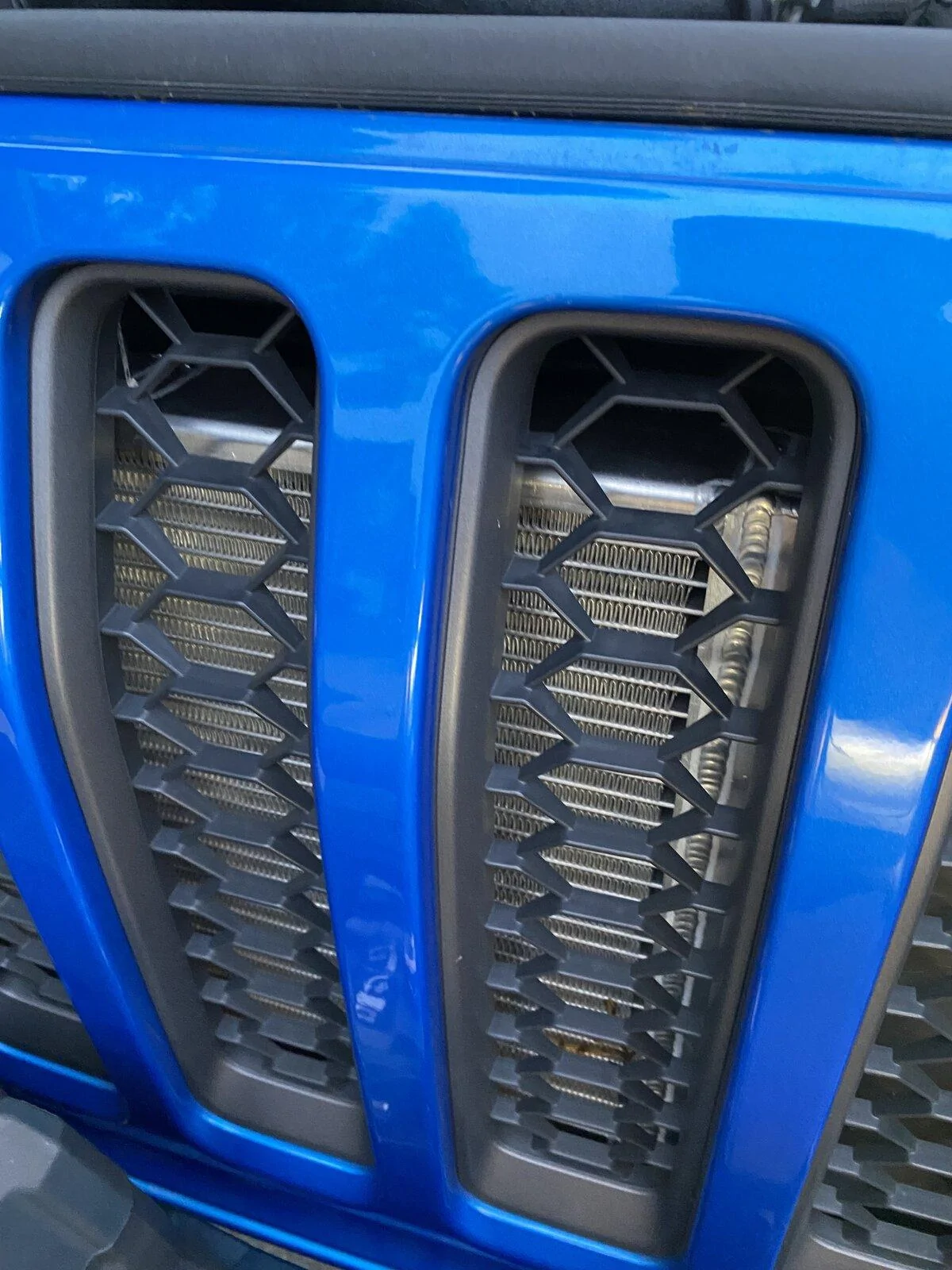

tow kits do. The problem isnt oil temps as much as it is (presumably) hot spots on the head and repeated pulls driving Up IAT’s.
im not sure how much of a problem hot spots on the head are on this application at sub 15psi. But in any event, no one reputable is working on a lower temp t stat.
my solution was a larger aluminum radiator behind the HX.

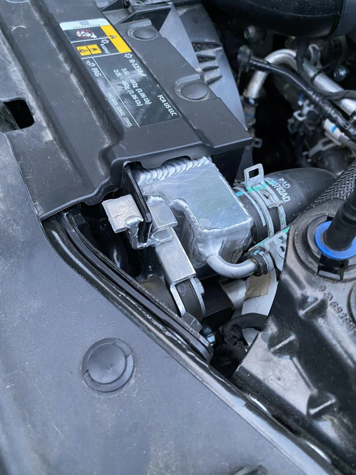

HX through the grill, other is the rad, obviously.
