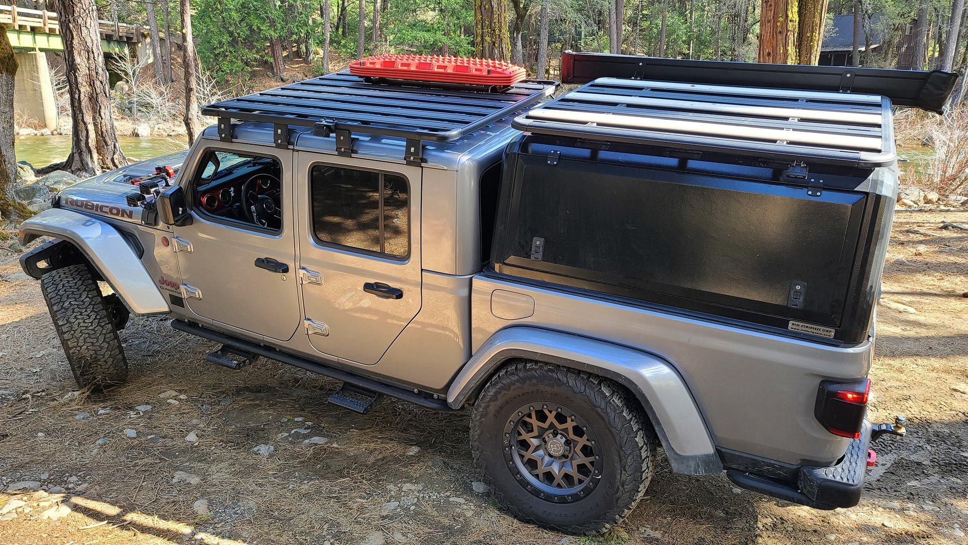

I mounted a Rhino Pioneer rack to my Gen 1. I had to drill holes. First I tried the tracks mounted to the raised portion of the Cap with rivets. Between the track, the leg mounts and the rack it was all too high. Later I purchased some mounts from Smittybilt and drilled holes to the side of the cap. This was the lowest point I could get it. To marry a Pioneer rack to the Cap directly you will need some sort of adjustable low profile bracket. Especially if you want to use the factory holes. I was going to try to figure out some sort of bracket when my Gen 2 gets here. If not I will drill into the side. The cap is pretty strong.
Jeep Gladiator RLD designs pic request 20200413_160820

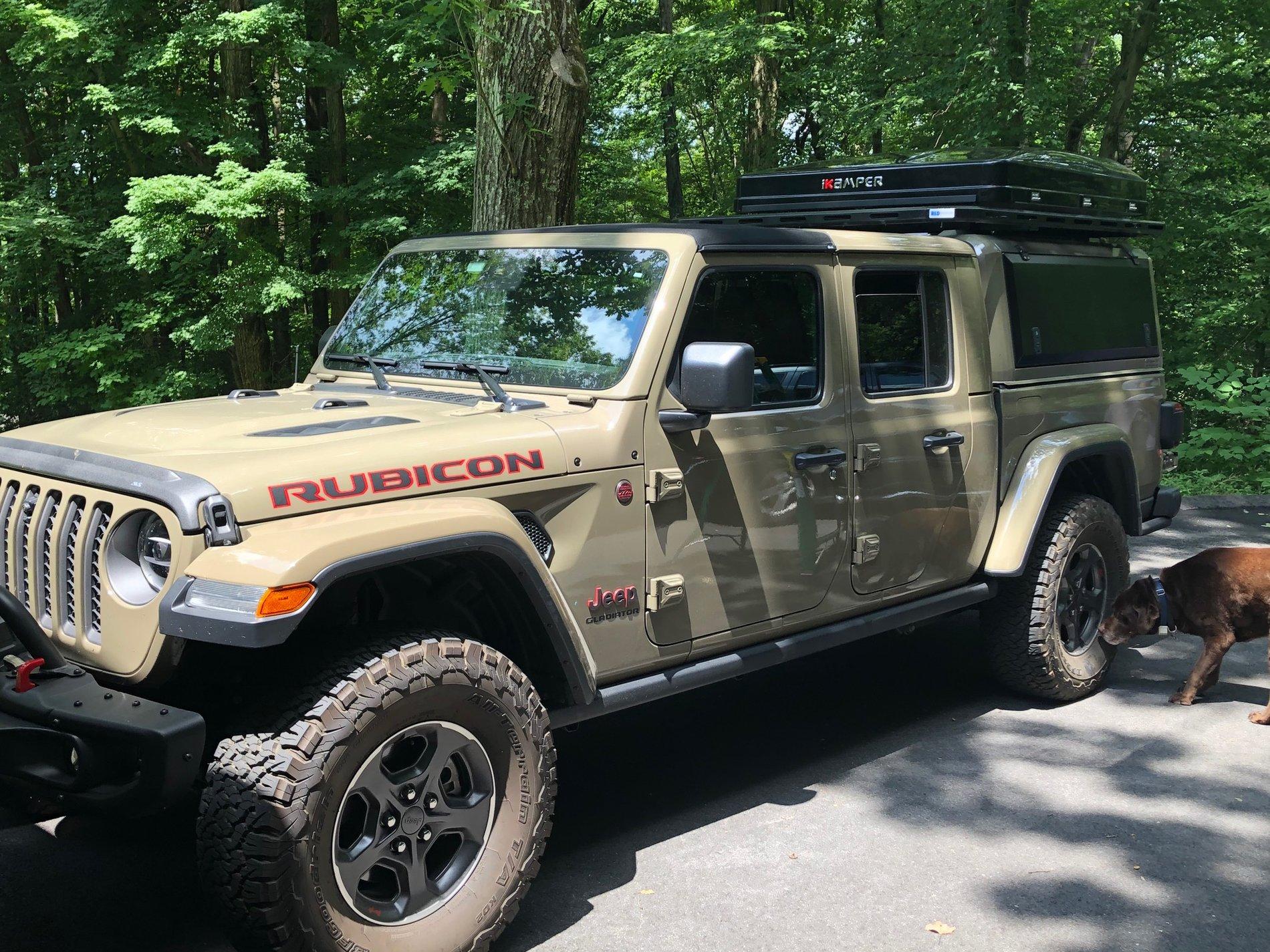

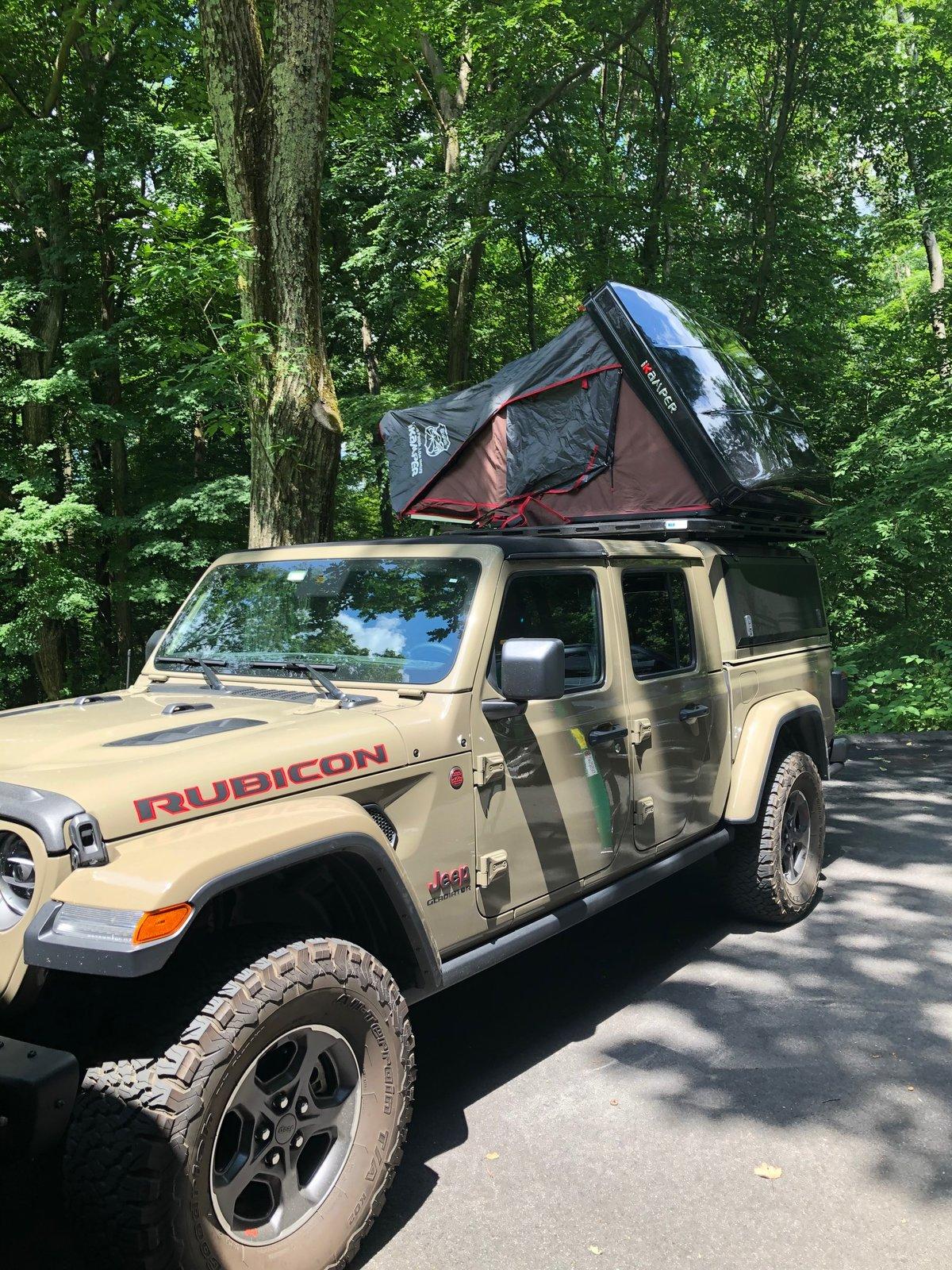

here is my iKamper mini
Jeep Gladiator RLD designs pic request IMG_2413
Jeep Gladiator RLD designs pic request IMG_2411
