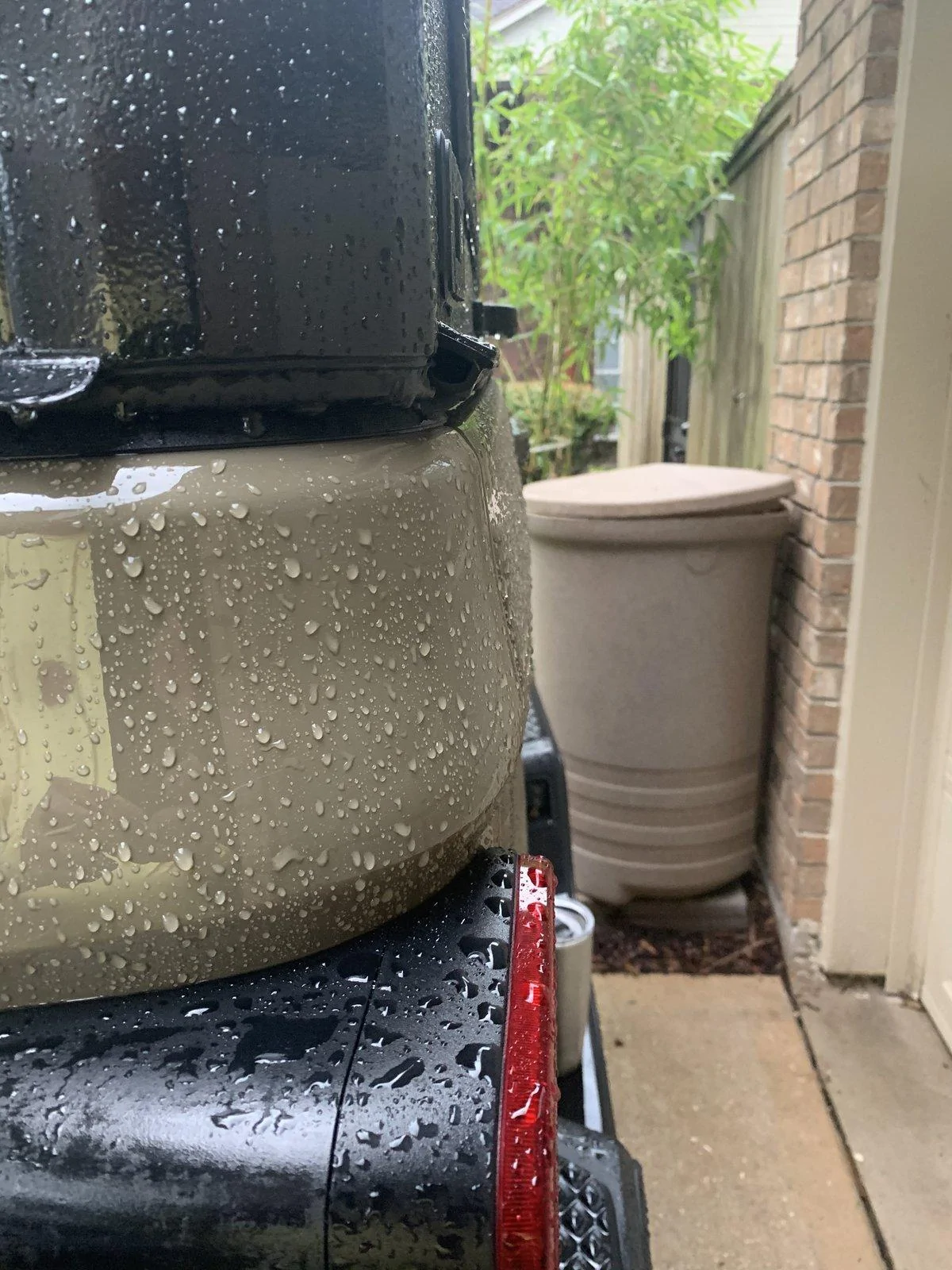

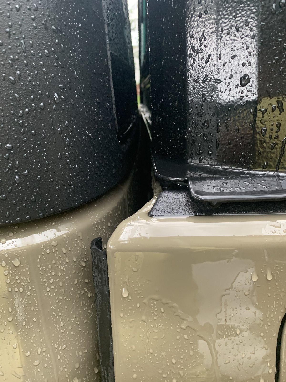

It seems RLD fixed some problems and now have others.
1. Big shout out to Joost and Chris at Rhino Adventure for taking care of me. I got my new Gen 2 and overall im pleased. They have my respect and my business.
2. The Cap looks better with the new shape. Definitely follows the lines of of the cab.
Fitment is still a slight issue. I kinda think all canopies don't fit perfectly. My last fiberglass had issues too.
For my Gen 2, now it's too far forward. My cap was bumping up against the back window. When the truck flexes on a bump it would make an awful sound. I had to put washers in-between the front mounts and the bed to push it back a few mm.
The other issue is the back door is too long and you have to close the tail gate and the door together. When you do the roof of the Cap flexes up. I was thinking of grinding down the plastic on the top of the tail gate. I just don't know if it's hollow it not. I have removed the gasket from the bottom of the window, but it's still way too tight.
If any one has ideas I'm all ears.

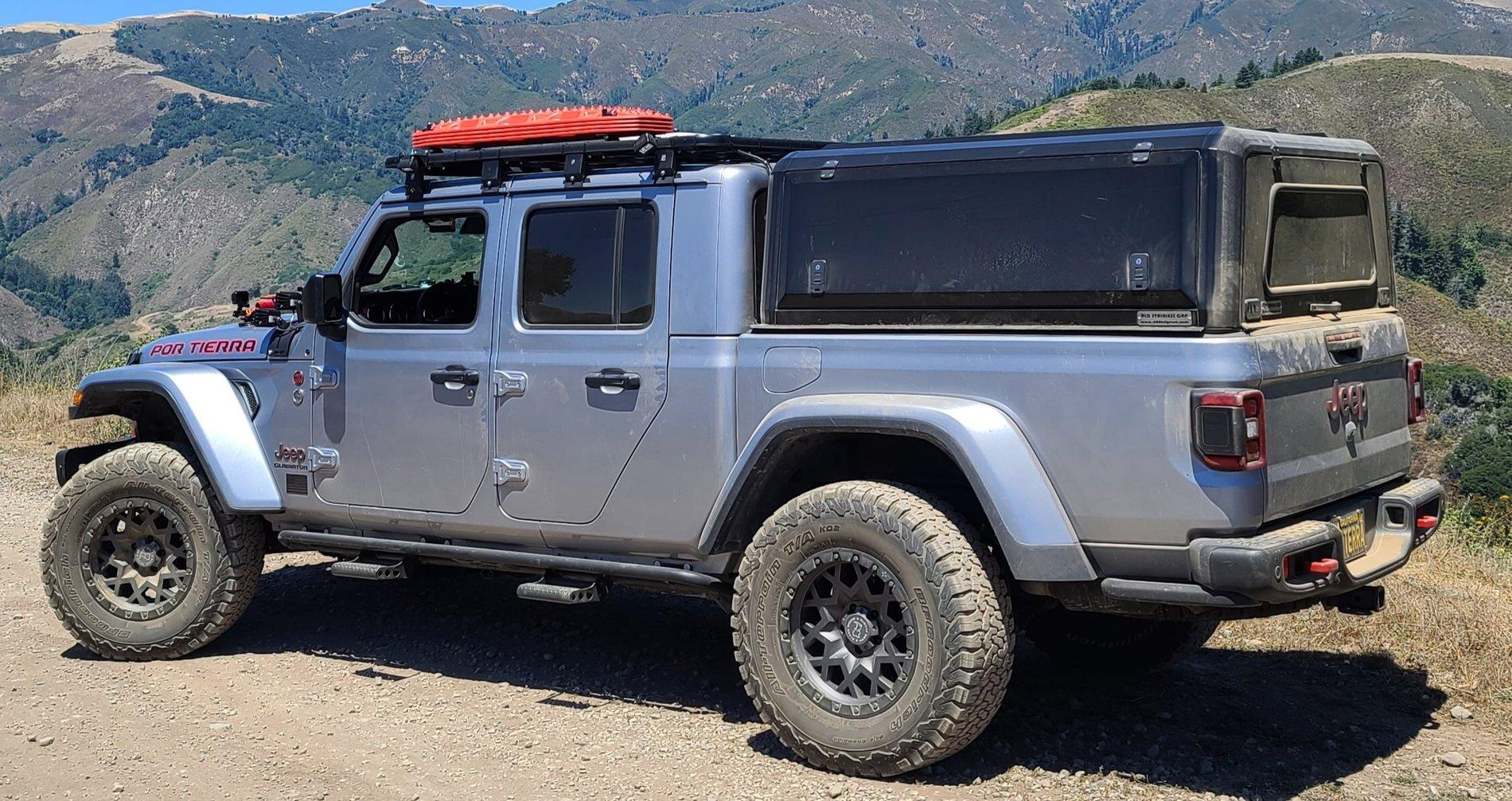

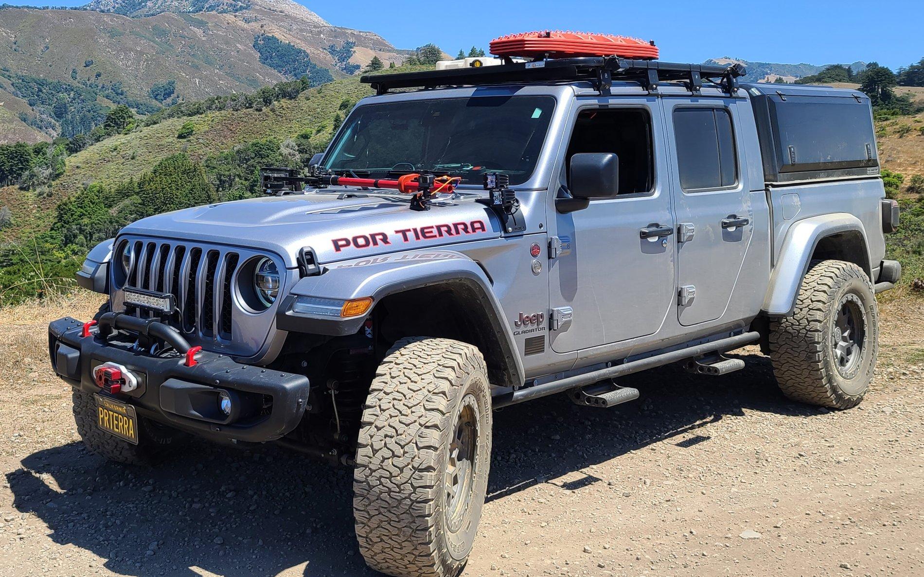

Here you go
I'm thinking RLD has the engineering and construction part down but struggles with the finer points of fitment. All their caps are almost identical other than dimensions so it's not really surprising and, as you said, I've never seen a cap that went on perfectly the first time. I mean Alu-Cab is well regarded as well and their first Tacoma cap fit like trash too.
Sounds like you had the exact same issues I'm currently having. Installing it where the front brackets fit, it was contacting my hard shell as well. Then on top of that, the rear hatch would not close unless i did them together and got the door behind the tailgate lip.
I spent some time on the phone with Joost and it seems that drilling these caps is normal. In fact that's exactly how all but the Gladiator and Tacoma caps are installed and he said they typically drill a lot of those anyway. The instructions I was given were to get the cap where I think it's right - where the rear hatch closes with effort but not an obscene amount and where the front is a little set back so it seals. From there it's just aligning the brackets, marking and drilling, and installing.
@FR33DOM has a shot (added below) where I think the cap needs to be and that results in the gaps that require drilling. In that position, my rear hatch is fine.
Going to take a stab at it today so we'll see how it goes. Also for any fab company out there listening, if someone does a mostly flat tailgate top plate that gets rid of that damn hump, I'm the first in line.

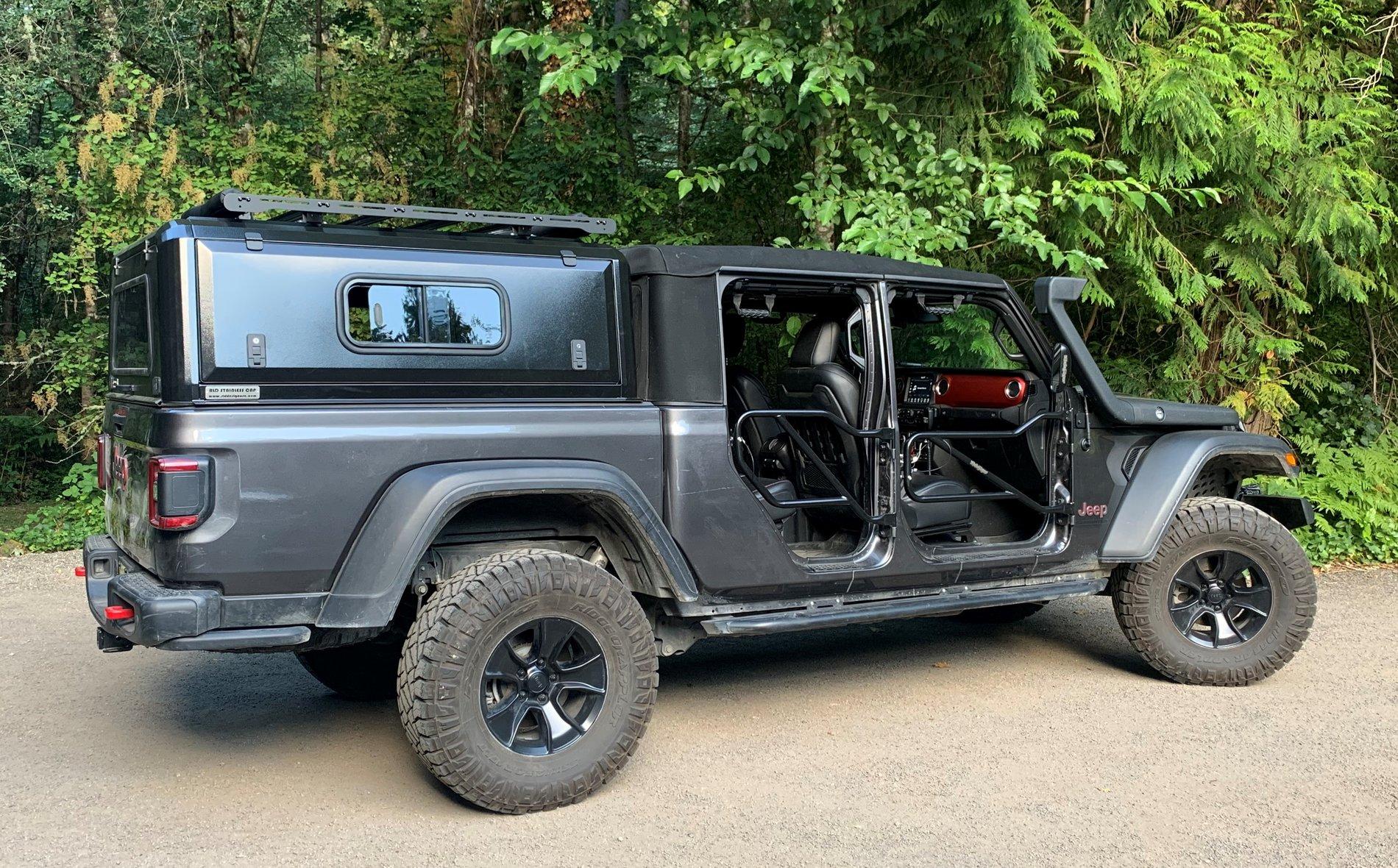

Installed my RLD canopy on Friday. Now that is on, I think it's great- looks good and fits perfectly. That said, I wish that I had read all of the comments on this string prior to picking it up at UPS freight on Friday. Quite the adventure to unpack it in the parking lot, lift it on with my son and then realize that despite bringing every tool I thought I would need, I neglected to bring a drill which would have been really helpful. In case anyone was wondering, yes you can strap the canopy to the truck bed from the inside and then drive 2 hours with it without it ending up all over the highway. Anyway, once at home, I had it installed properly in about 20 minutes. Also, added a Prinsu rack which, with some more drilling, fits great.
