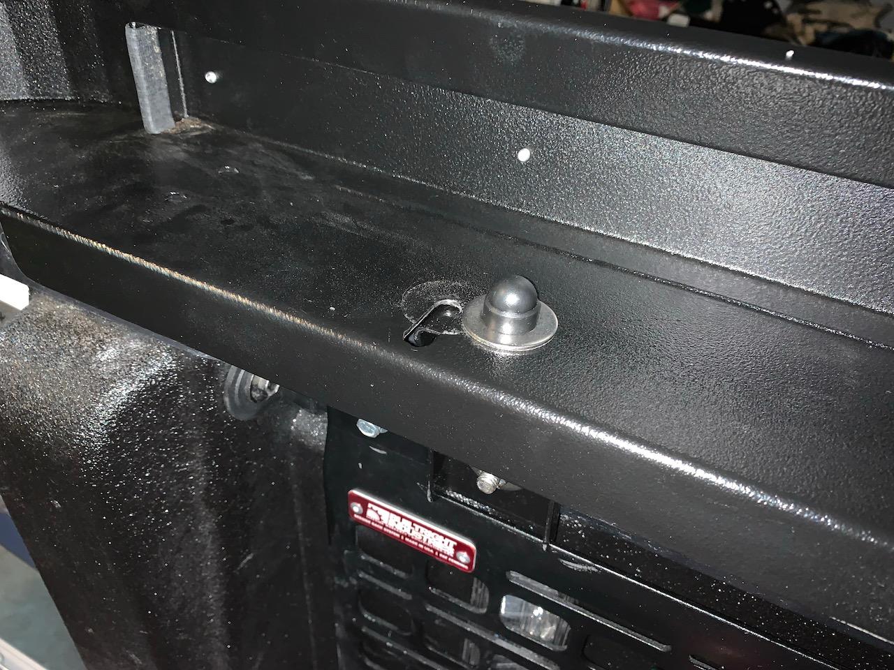

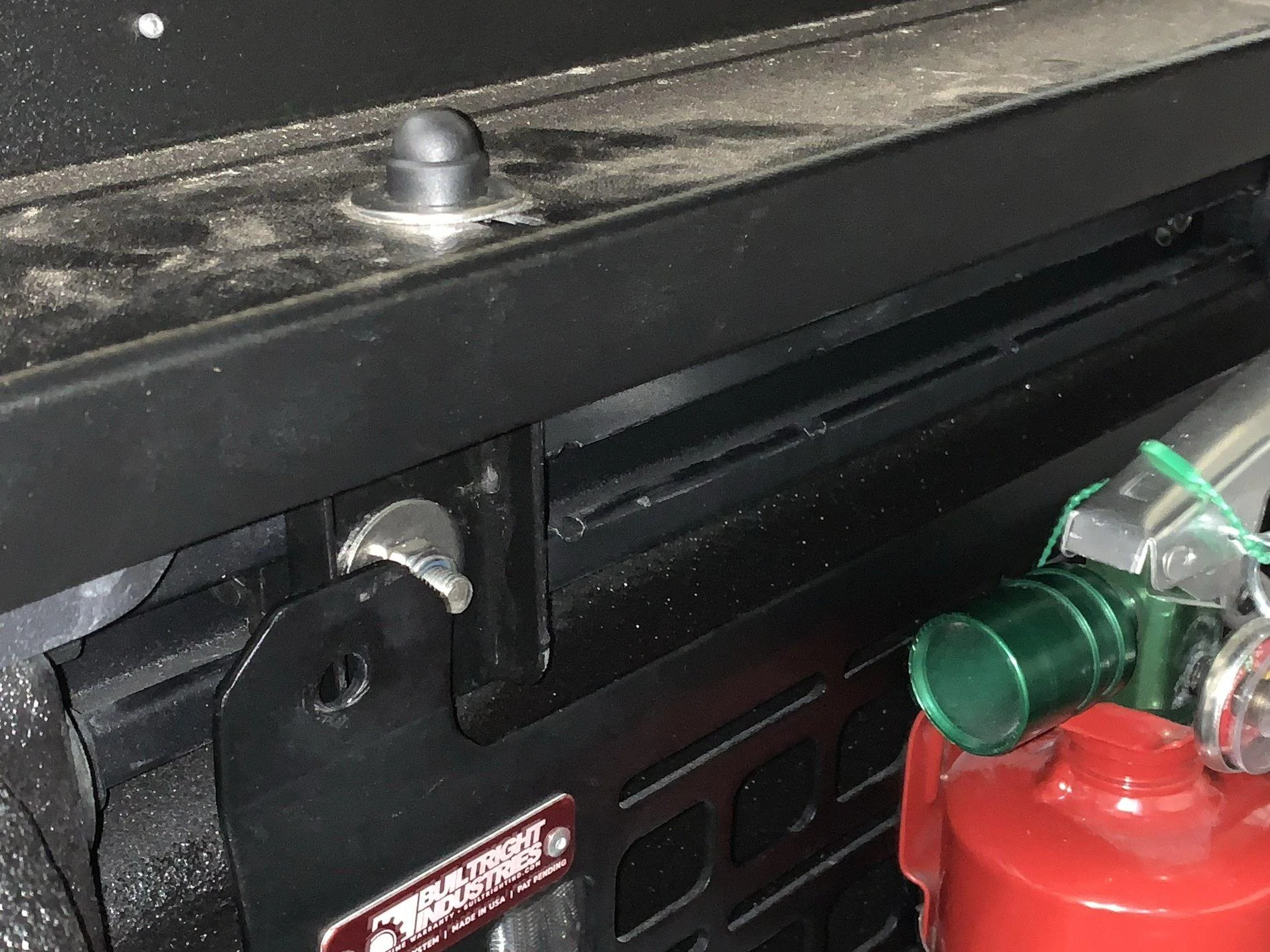

Roof rack going on now. There are six mounting points. The ones on the front (side to side) are fixed and can’t be moved easily. They mount to the bolt holes for the tonneau cover. It’s really clean and secure. The side mounts come pre-drilled to mount to the trail rails. But they can easily be moved by drilling new holes in the canopy where it overhangs into the bed.

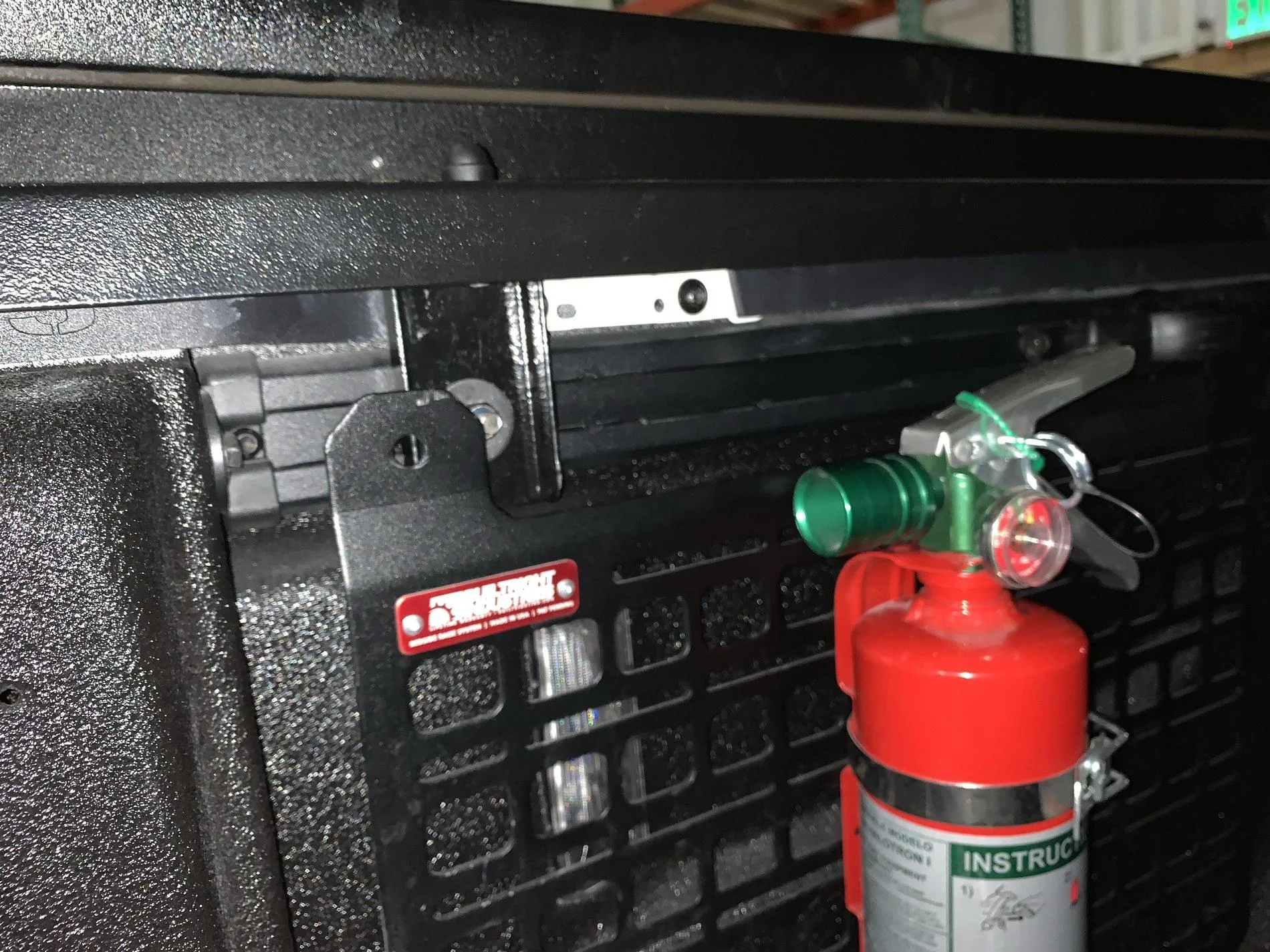

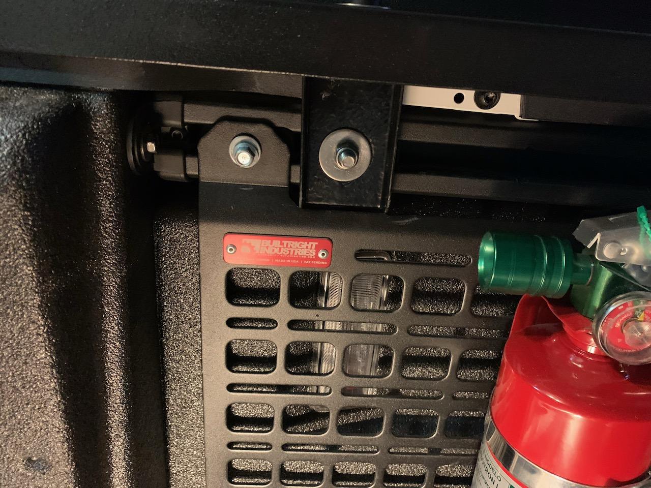

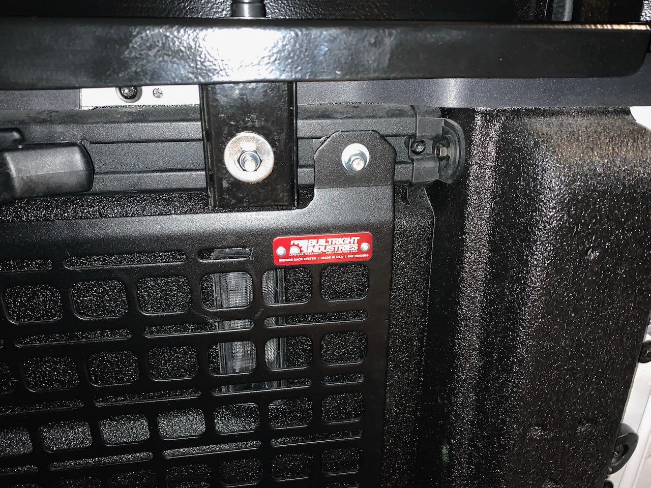

I wouldn’t move them too far as they are located to secure the canopy and give it a good seal. I am going to have to move my rear mounting locations a bit, see pictures.

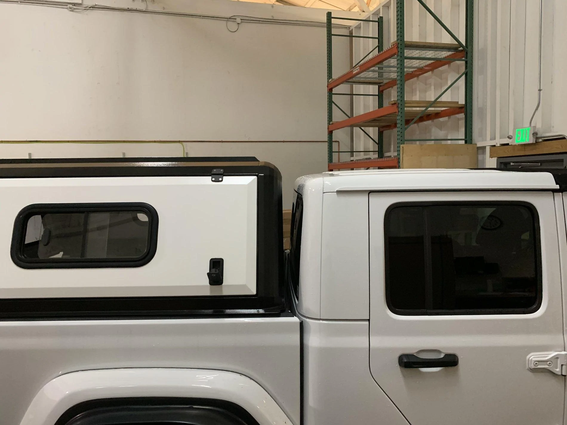

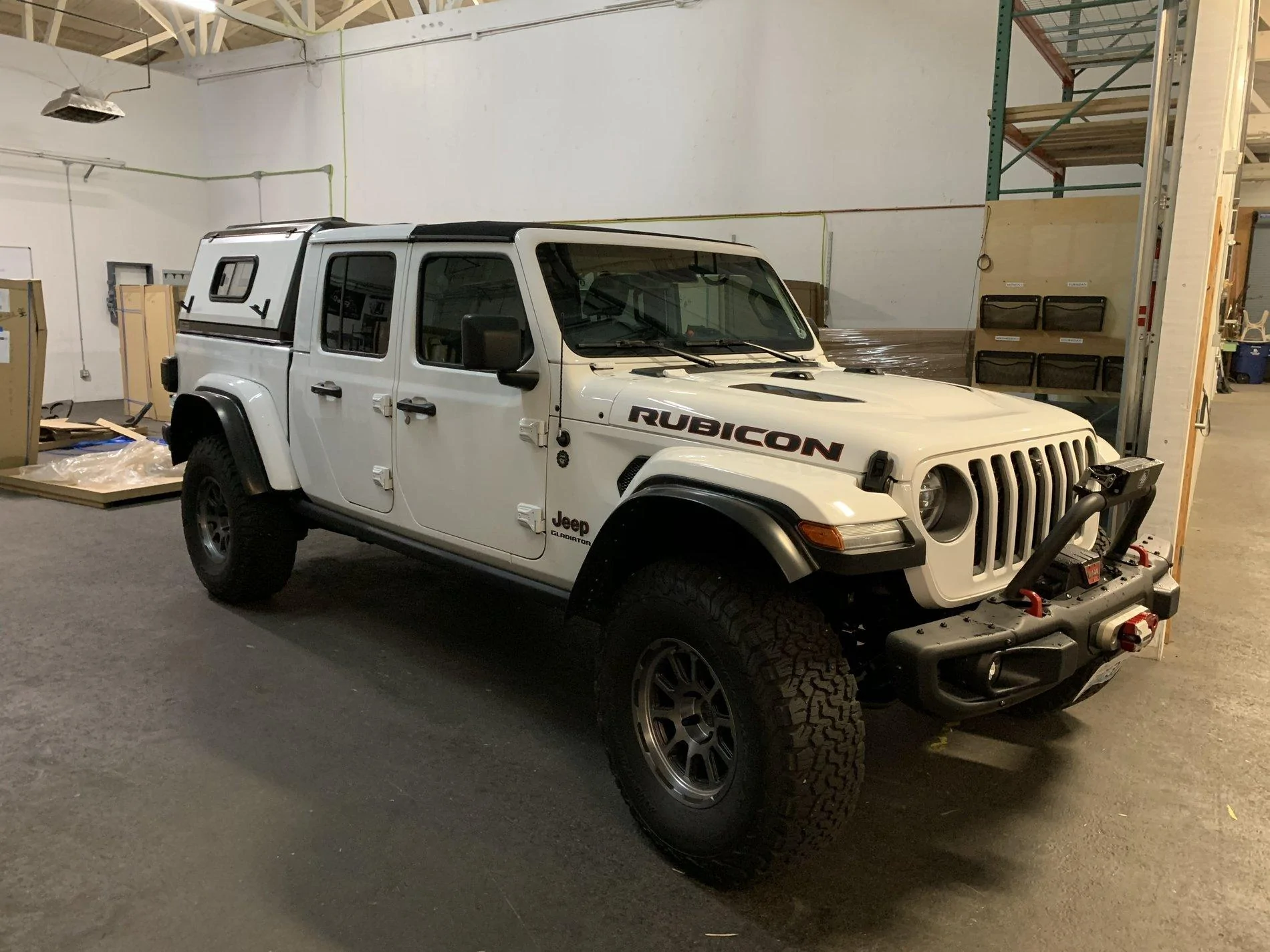

The canopy is about 3 1/2” taller than the hard top. I have mixed feeling about the height but overall I like it as it’s easier to move around under it than if it were lower.
The overall quality of the canopy looks really good. So far so good.
Me too haha. Looks like all of us are doing the BRI panels with the RLD topper. Doesn’t seem like a too much of an issue, simple to drill. But yes, need to confirm front rail interference as well!
Thanks for posting! This is the exact issue I was concerned about. Do you have the front BuiltRight panels too? Curious if any interference there too? Looks like the two rear mount points need to be redialed about 1.5" forward and its a fit, is that right?
Yes I have the front panels as well and no issues there. I need to correct myself . When I said there are six attachment points I was incorrect. There are only four. The two in the back I posted pics of earlier and the two in the front that mount to the bolts for the tonneau.
I was able to easily relocate the two mounting points in the back to accommodate the BuildRight panel mounts, see pics. I will post some more pics tomorrow if the rain lets up a little. This is Seattle.

yeah I’m not sure about the height now! The load bars will only lift the RTT even higher, which I am not liking, but oh well.
Also, it looks like the white color doesn’t match very well in the photos. Is that the case or just the lighting?

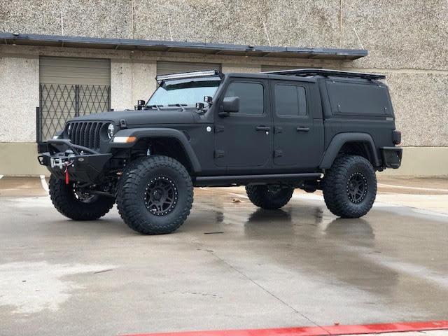

They are considering making them shorter. I agree the load bars and the rack make it quite tall. About 70" with a 2" lift and 37s. I took the rack off today and am going to store it for when I need it. 70" is too tall for me. Plus I decided I don't want that much weight that high.
Not sure if the color doesn't match or if it's a lighting thing. There are different angles and the finish on the canopy is textured so its probably never going to match even if its the same color. To be honest I care more about the function than an exact color match. The folks at the mall won't notice anyway.

Thanks again! The hole relocation looks simple enough. Was it about 1"?
Looks like I can safely order and install the BR panels now before my RLD comes in next month.
Can't wait to see more pictures!

I didn’t measure but yes its about an inch. I just unbolted one of the canopy mounts at a time and moved the bracket forward until it was out of the way and drilled the new hole there. You can see the washer overlaps the original location so its not much, I wanted to keep it as close to where it was intended to be as possible. No other modifications were required.

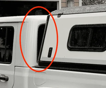

I must confess that I am quite disappointed in the lines of the product. Roof is too tall and side angles are not even close to the JT doors. I was expecting something close to the rendering that has been circulating.

This one doesn't look so bad. Almost like the canopy is wider that the cab. Might just be the angle.

I'm glad I waited to see how the production model looks, but I'm dissappinted that it's so far off from the vertical body lines. And the height looks to me like it will interfere with the soft top operation when it's open. Maybe it looks better in person? Maybe it will grow on me...
I had really high hopes for this product with its light weight and strength. I was 95% ready to pull the trigger, but now I reckon I'll wait for the aftermarket to bring out a couple different options. Such a shame that I'm being so vain, because this definitely offers the functionality that I want, at a very reasonable price IMHO.
