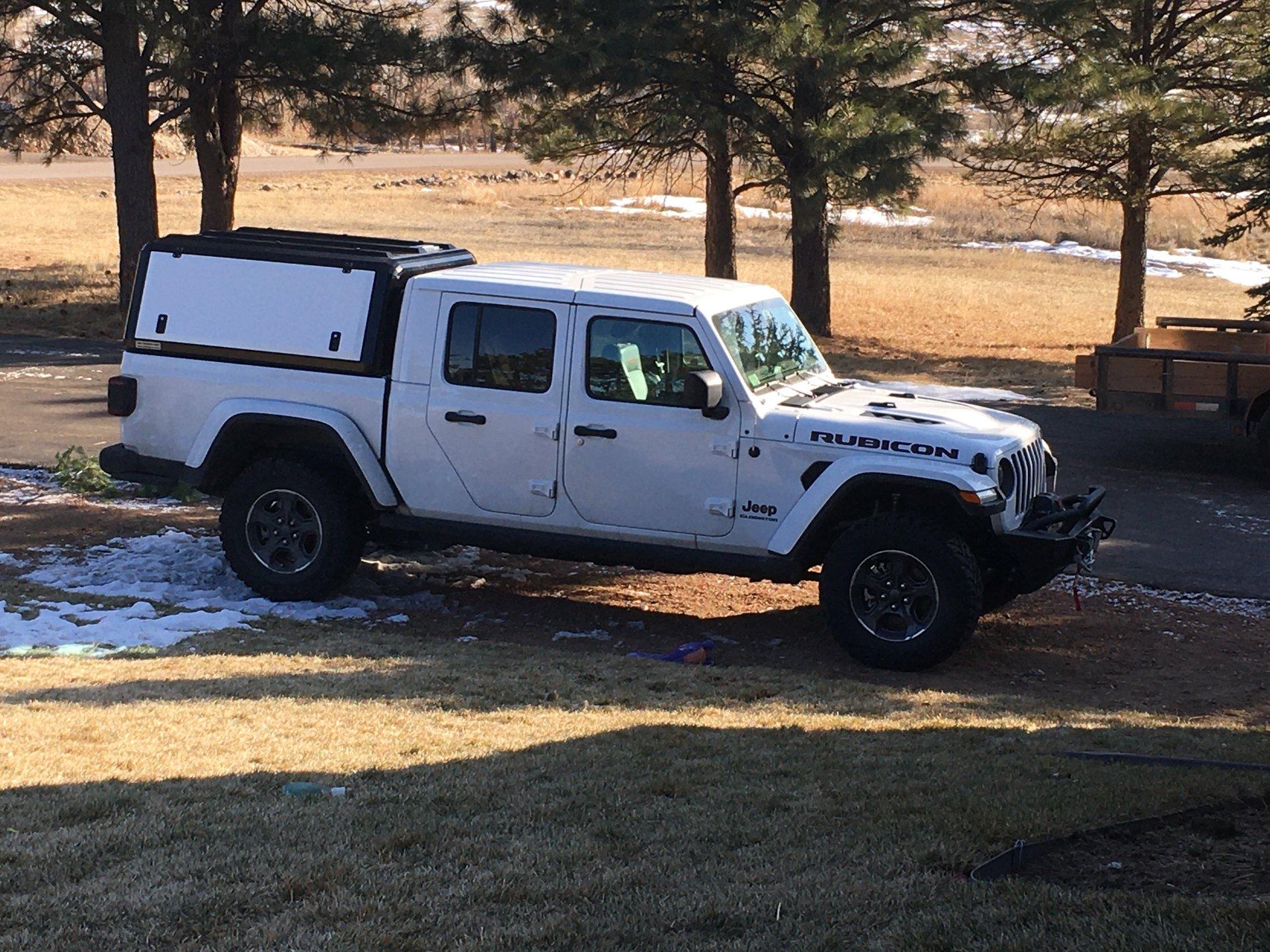

I was able to get my canopy opened up and installed on my JTR. Turns out the shipping container was completely mislabeled and my White top with White doors was actually Black top with White doors. Thus my rig looks just like the others posted above. Mine also has some shipping damage where a forklift punctured through the bottom packaging and dented my drivers side frame. Have a claim filed with Adventure Ready and am hoping to get it replaced. But it sounds like I may have to wait for the next shipment out of South Africa.

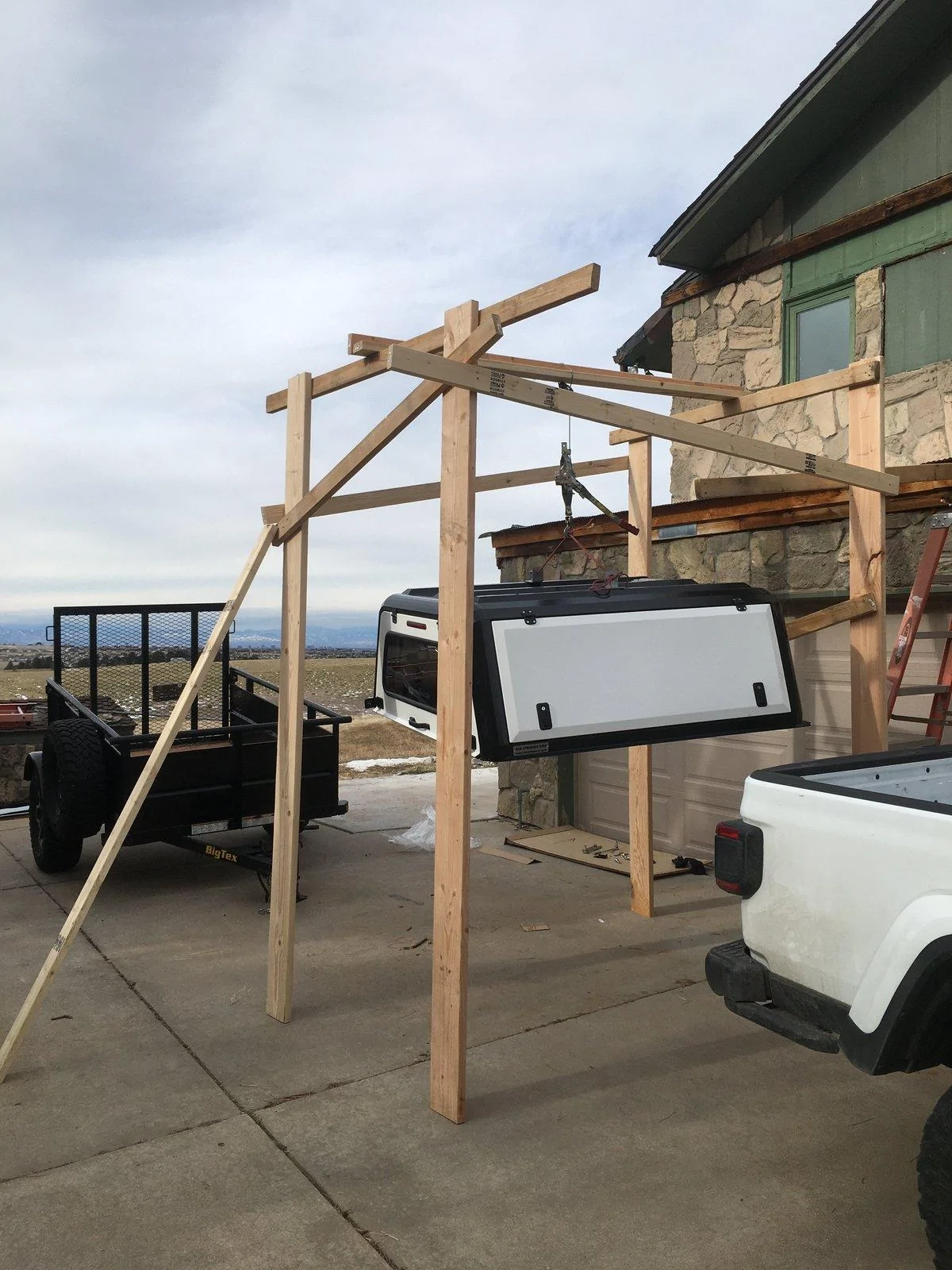

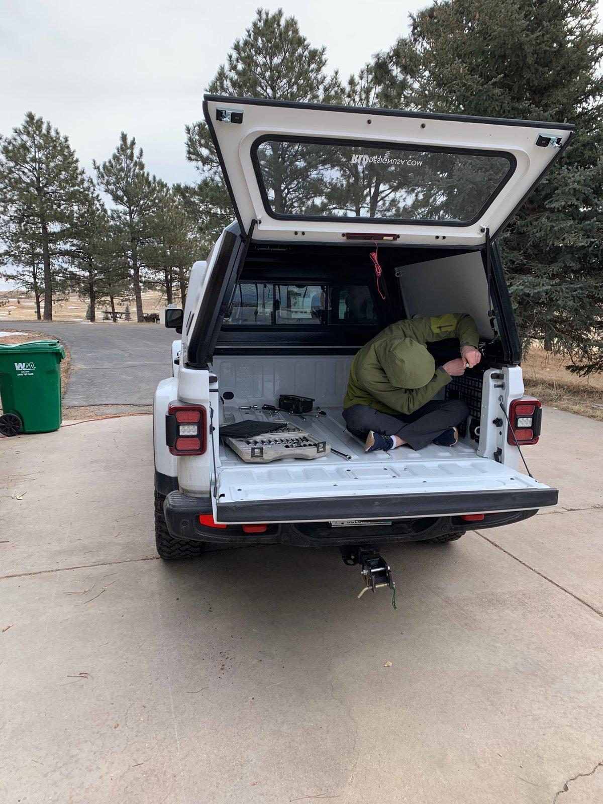

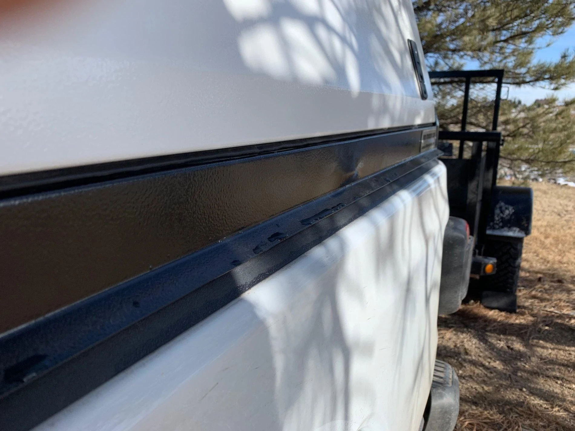

Install was fairly easy once I Jerry-Rigged a 2x4 Gantry with a cum-a-long. Some issues did arise. The front flange on the topper just slightly interferes with the shape of the bed causing the canopy to sit back about a quarter inch. This creates a fairly large air gap in the back door and tail gate. Given the shape of the two components this will have to be addressed with some additional weather stripping. Another issue was that I installed when it was 20 degrees out. I could not subsequently compress the weather stripping on the canopy which resulted in a 1/4 inch gap across the entire front. Thus I pulled the top off and installed some neoprene strips along the top of the front bed rail. I also had to modify the topper to move the mounting holes to accommodate the Built Right racks. Last, I punched out the 6 plastic inserts in the roof channels and mounted two pieces of Uni Strut on the inside of the canopy using bolts and neoprene washers to prevent leakage. I was then able to mount my KC Lights inside and will use those sections of strut to mount other items like my shovel and MaxTrax.

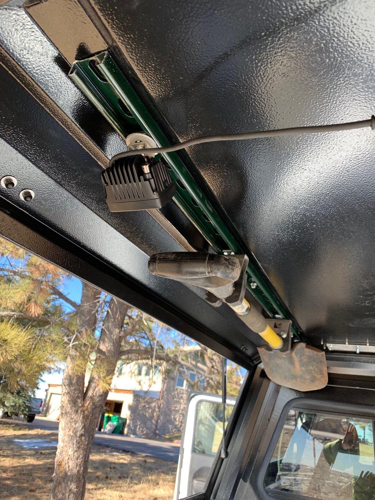

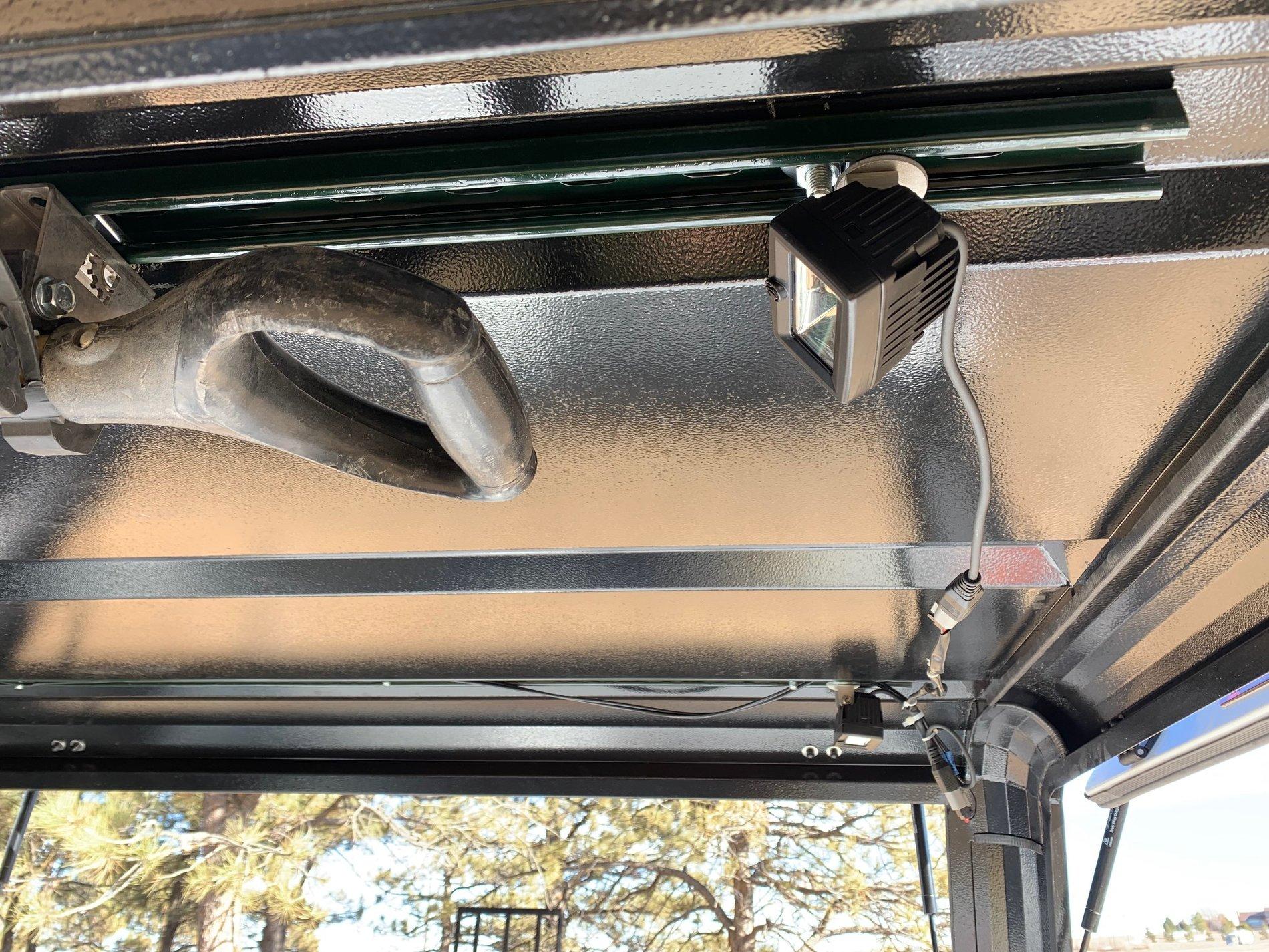

I love the Uni Strut idea - can you share a picture of that please?

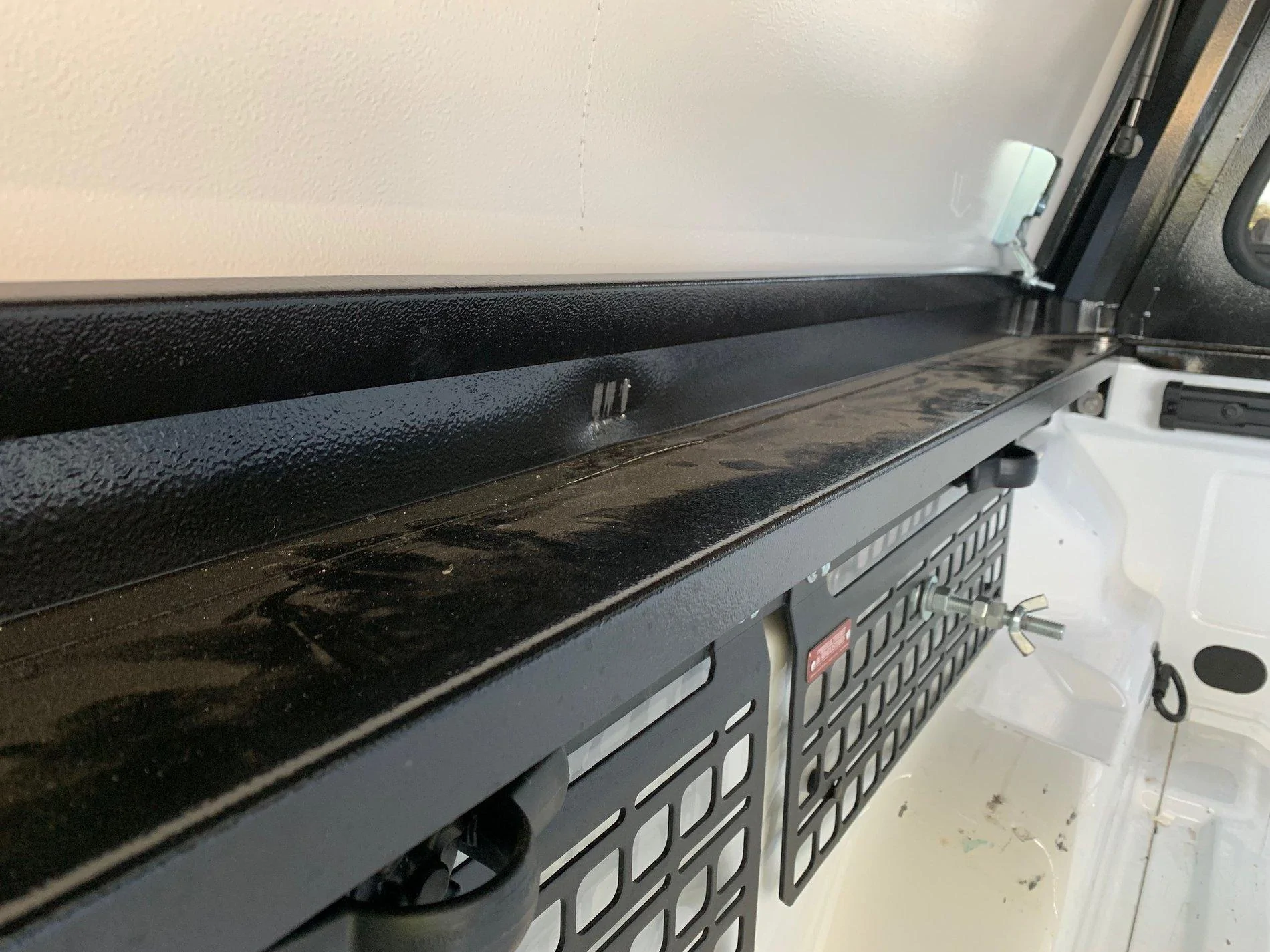

Here are some images of the strut mounts inside the RLD shell. I have mounted KC lights and the BuiltRight shovel mounts. I wanted to put the MaxTrax up there but upside down is a pain in the butt so I have bailed on that idea for now.
