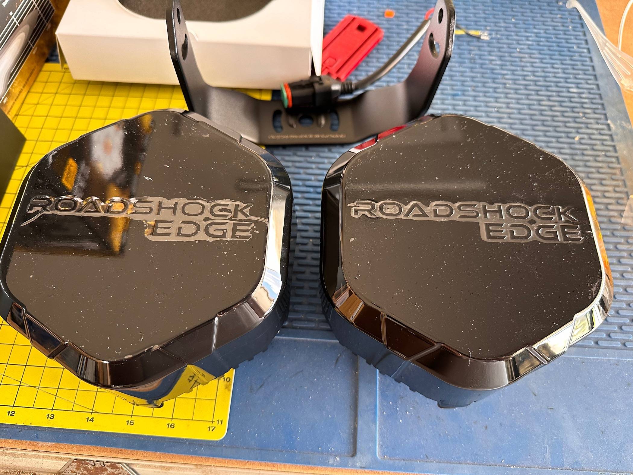

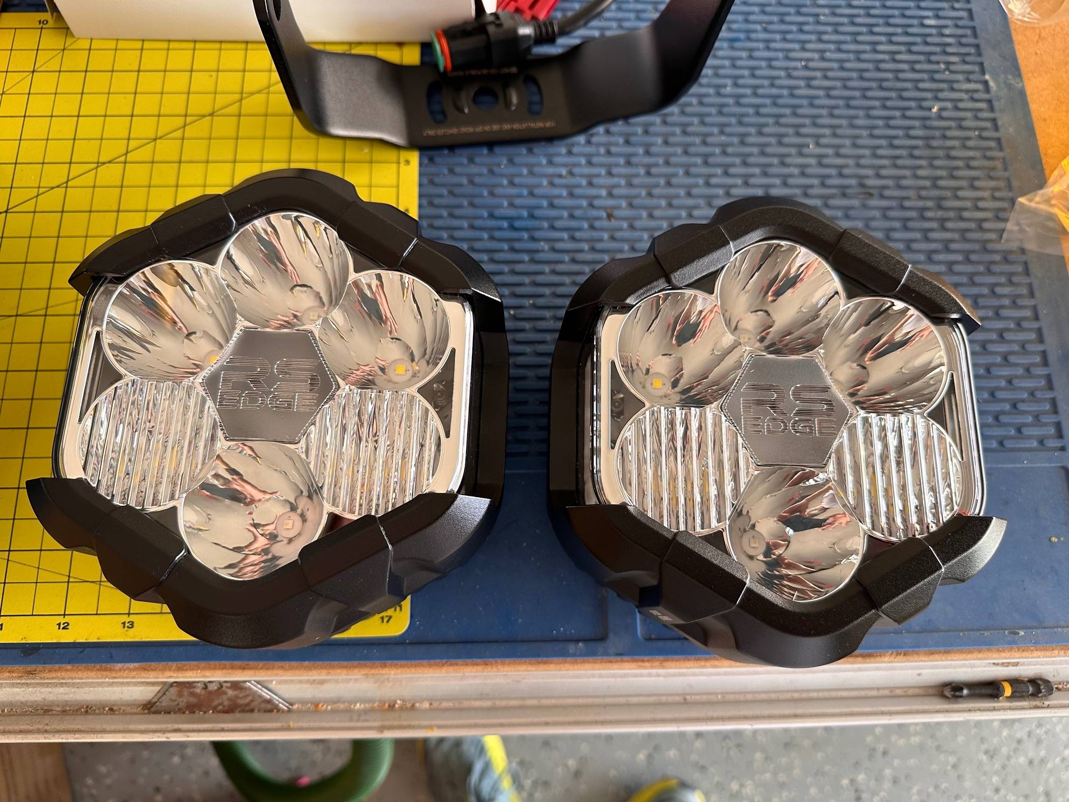

I purchased the 6's yesterday and the harness today, Test fitted them on the bumper this afternoon. I have no idea about wiring these thigs up. Don;t like the idea of running the single switch that comes with the roadshock edge wiring harness, I'm sure I can install a Voswitch JL400 or JL800, after that i'm at a total loss. I need someone to publish an offroad lights for dummies for this install. If someone in my area could give me a hand would compensate you with a bottle of your favorite drink (with in reason or some $) I would really like to try this install solo but need some good direction, Thanks fellas
Test Fitted today
Jeep Gladiator Roadshock Edge 6 light unnamed
