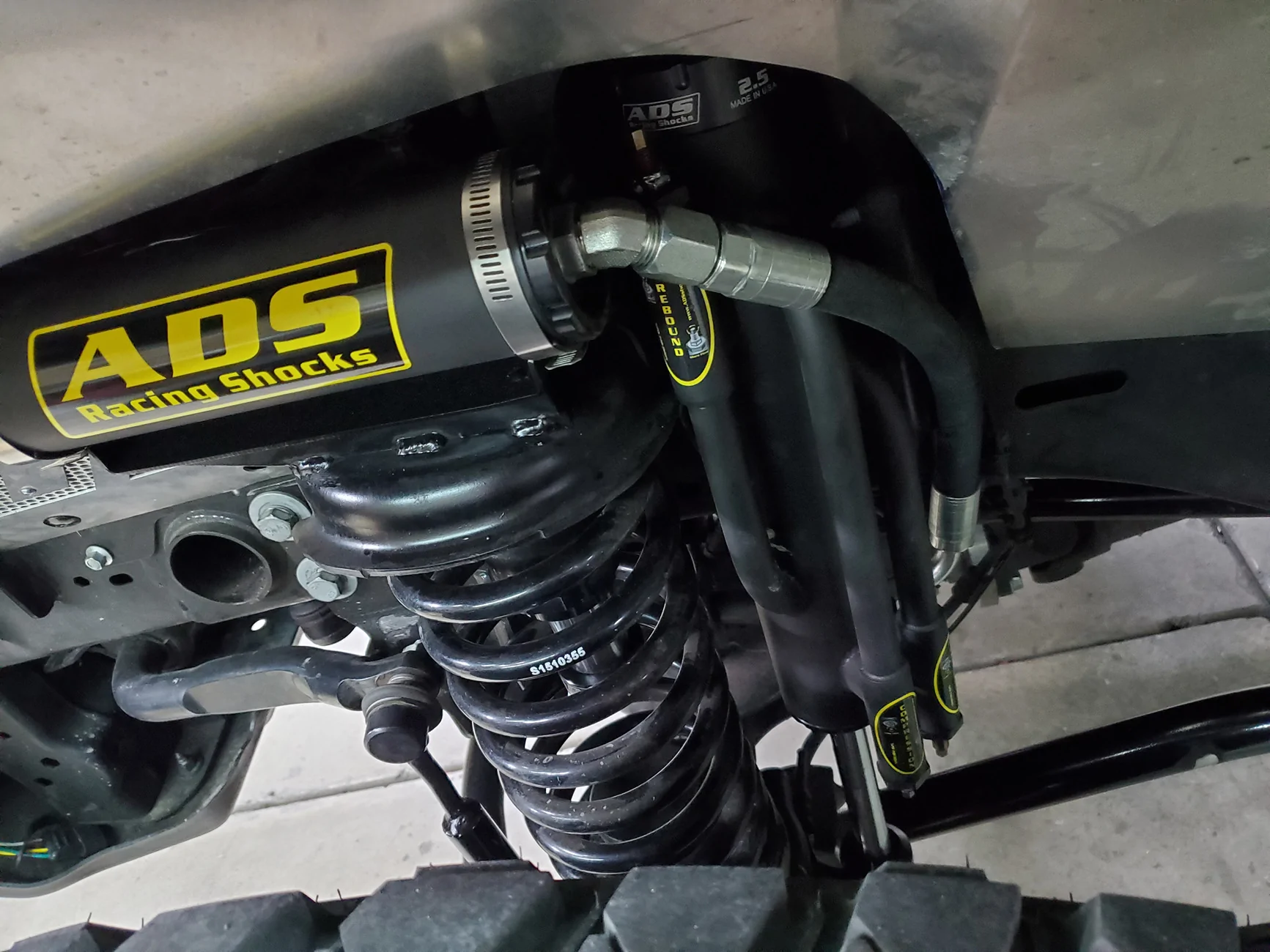

If you have the $ ADS 3 tube bypass shocks.
Jeep Gladiator Rock krawler adjustable shock reviews? 20240330_120932
