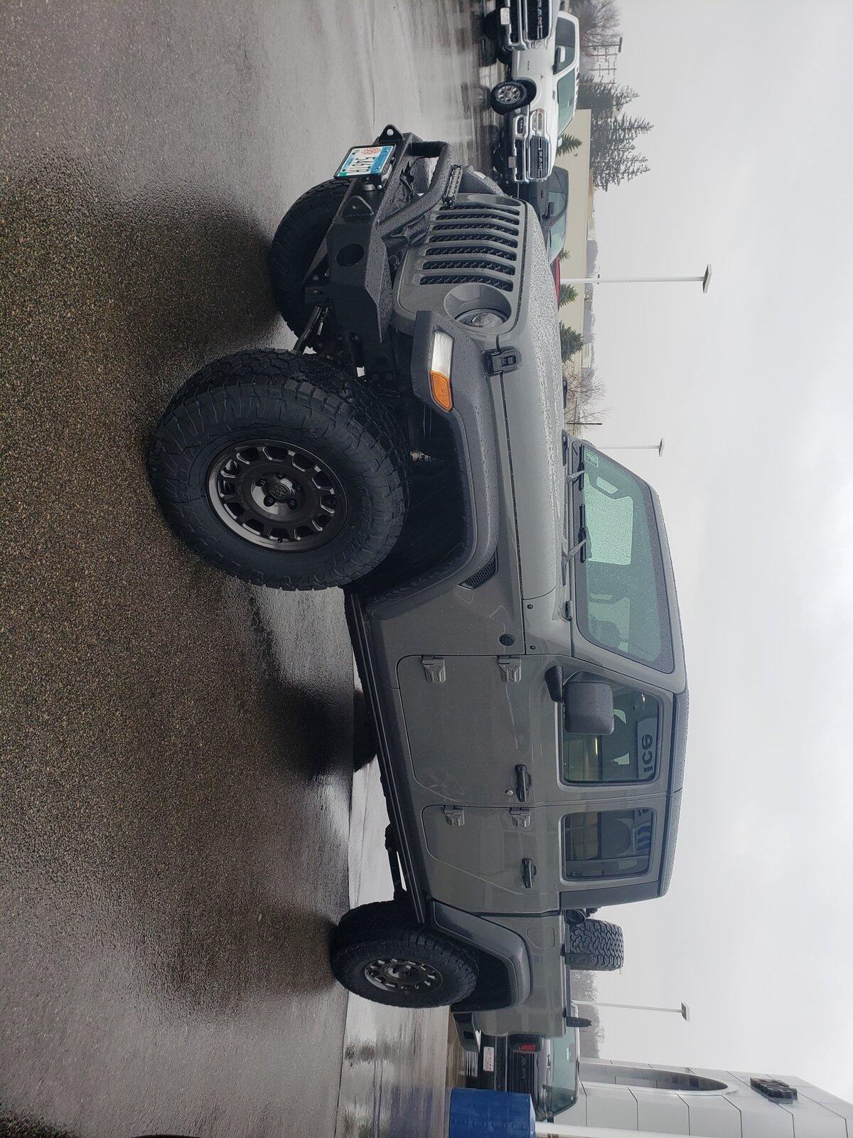

I see bigger tires in my future...

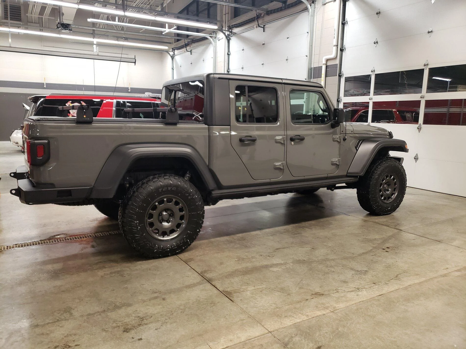

Installed the MOPAR 2" lift
Terafelx adjustable front trackbar
EVO adjustable rear trackbar
Rancho geometry correction brackets
Fox TS steering stabilizer
Very happy with the ride

So I can't compare having the lift with brackets vs no brackets because they went on at the same time. MOPAR says you can add the lift as is, no track bars or brackets, and it works. I'm sure that's true but I'd rather get all the angles to a stock setting reducing the chance of any weird steering or handling behaviors.
The rancho brackets I have on now will be going up for sale soon. Nothing wrong with them but I ordered AEV brackets but was too impatient to wait for them to install the lift so I went with rancho temporarily. Is it worth the hassle to switch them? Probably not but I like AEV stuff. I was very close to going with the AEV lift but was able to get the mopar lift/track bars/brackets all for less money. I have no regrets, the set up I have works very well.

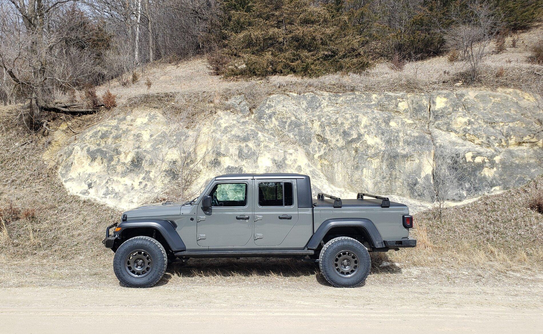

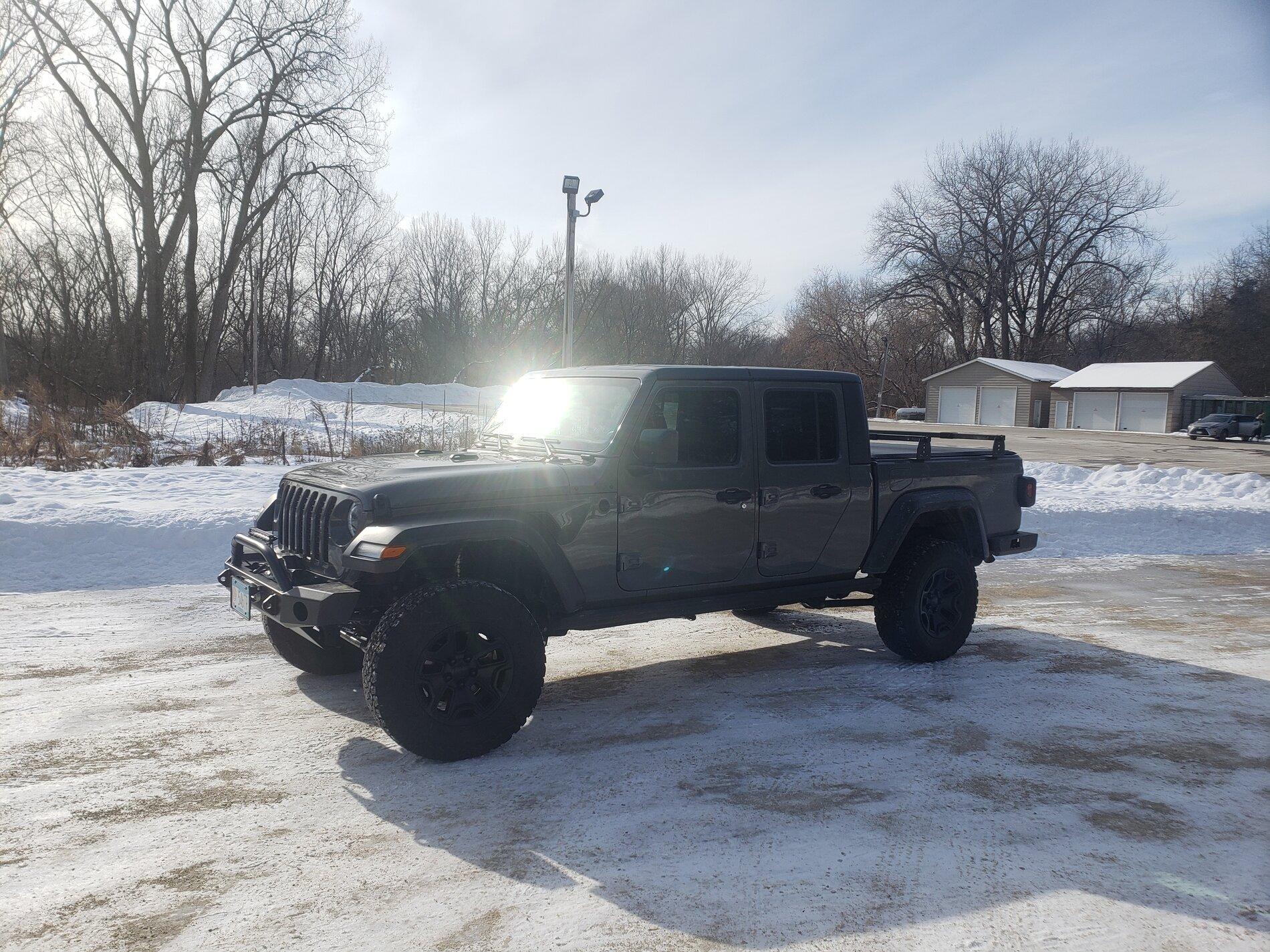

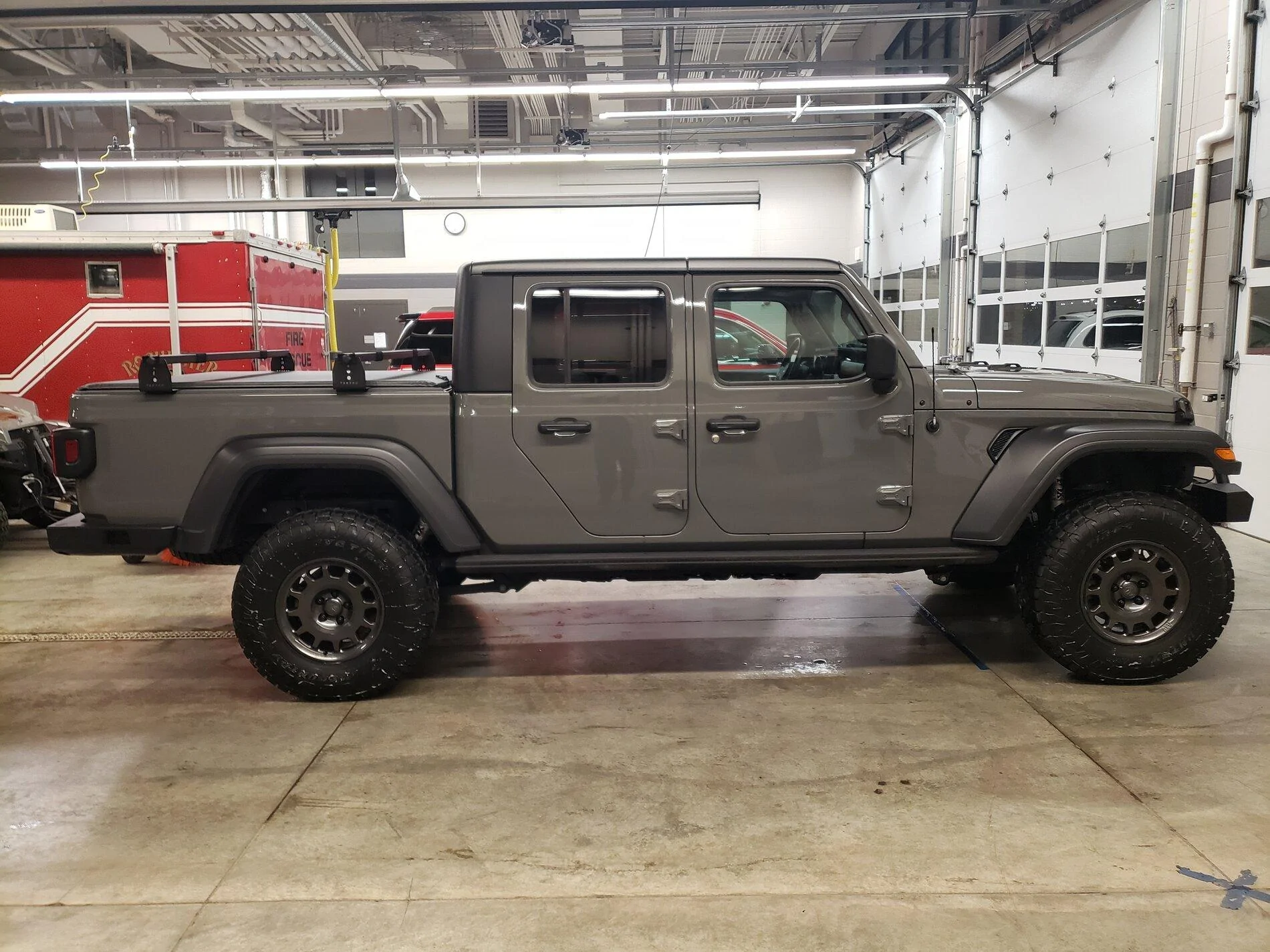

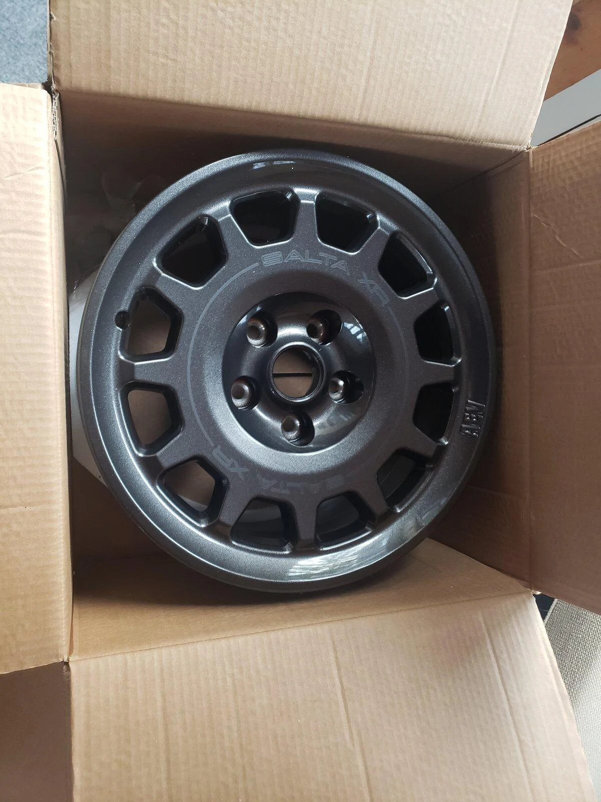

Pretty happy today. I've been waiting for AEV to come out with the new salta wheel for the JT. The JK version would fit but I really like how AEV specs the offset for the specific vehicle. I paired them with Toyo ATIII in 35/11.5 R17. These tires keep width in check, are C rated (ride quality for me), and pretty light for a 35 at 63lbs. Only have 20 miles on the set up but I love the look at ride. The tires are a little louder but thats all I've noticed so far. Pics!

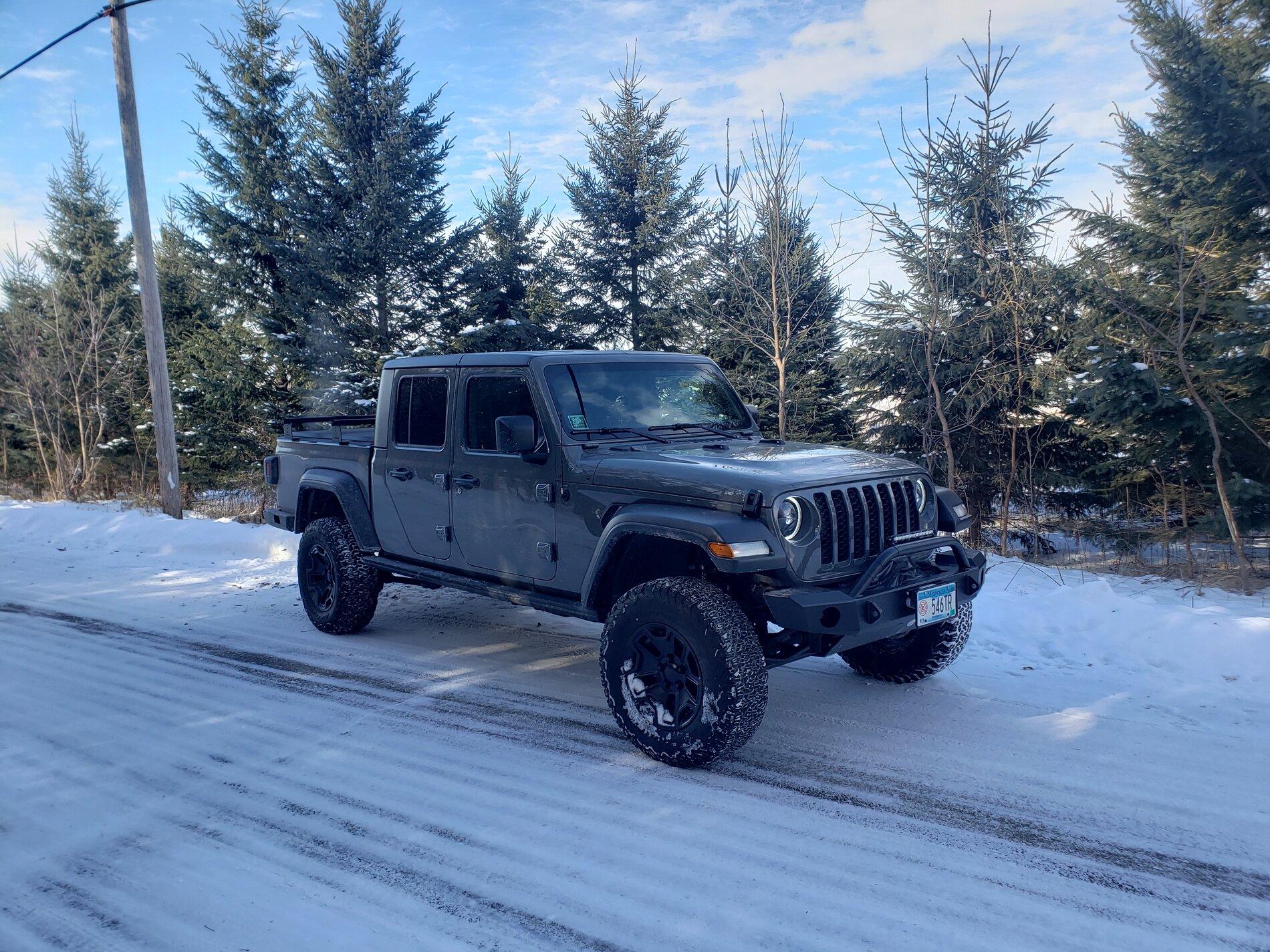

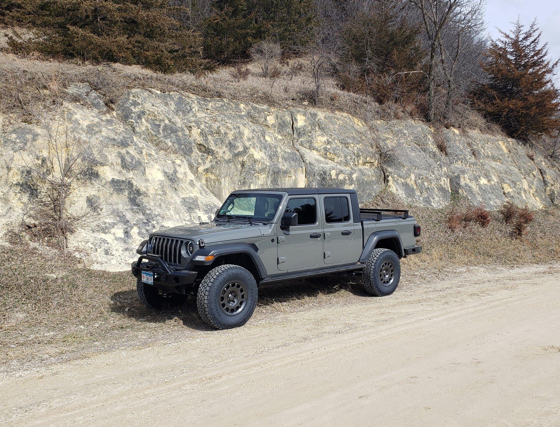

The Rancho geometry correction brackets were swapped with AEV brackets today. Don't think it makes much of a difference but time will tell.
Dirty truck, slightly better pics in the sun.

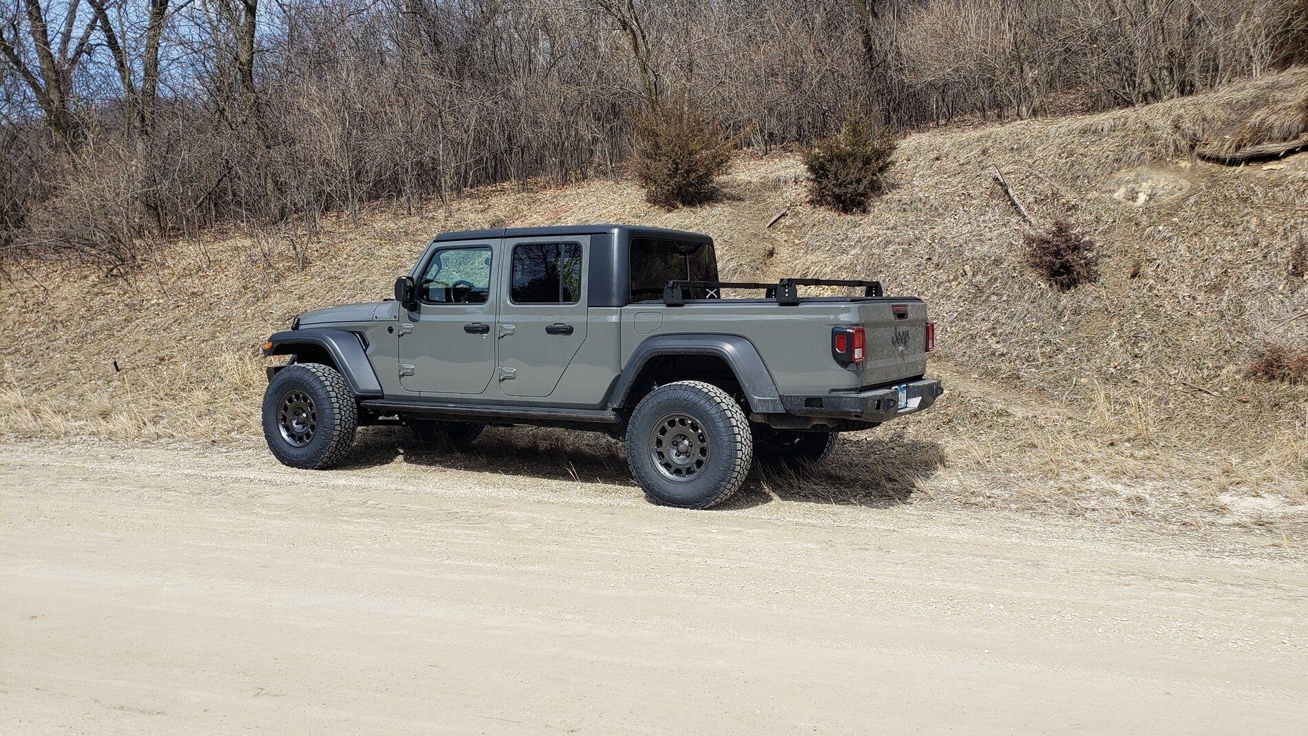

I forgot to add that the spare is a Kenda Klever RT 35/10.5r17 on the stock spare steelie. I went this route to tuck the tire up out of the way as much as possible while still having a full sized spare, and it's an inexpensive 35 option for a tire that hopefully isn't needed.
Two more shot cleaned up at night.

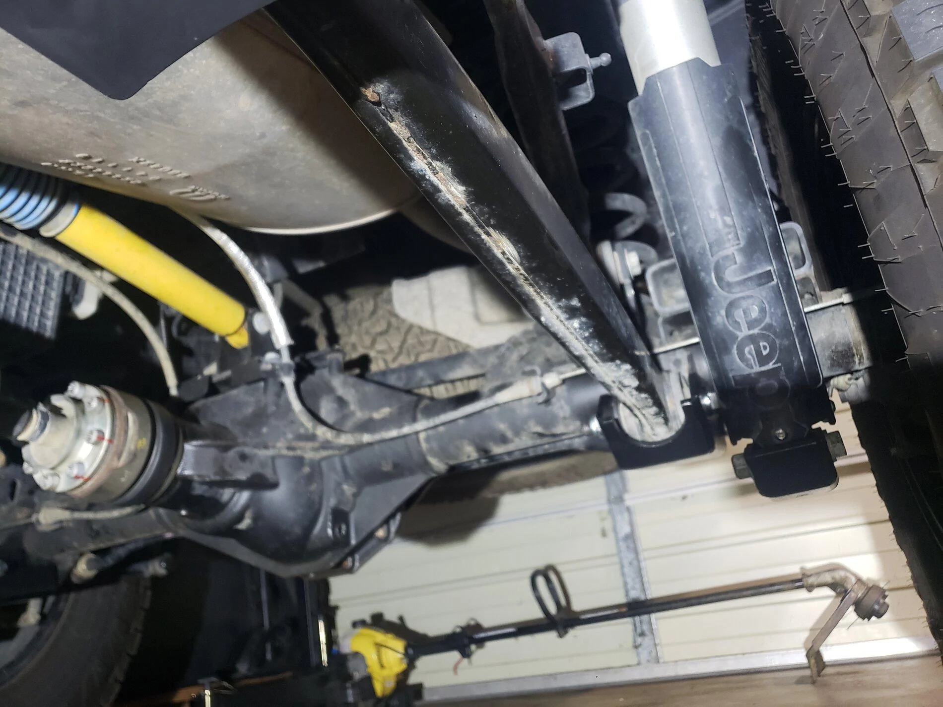

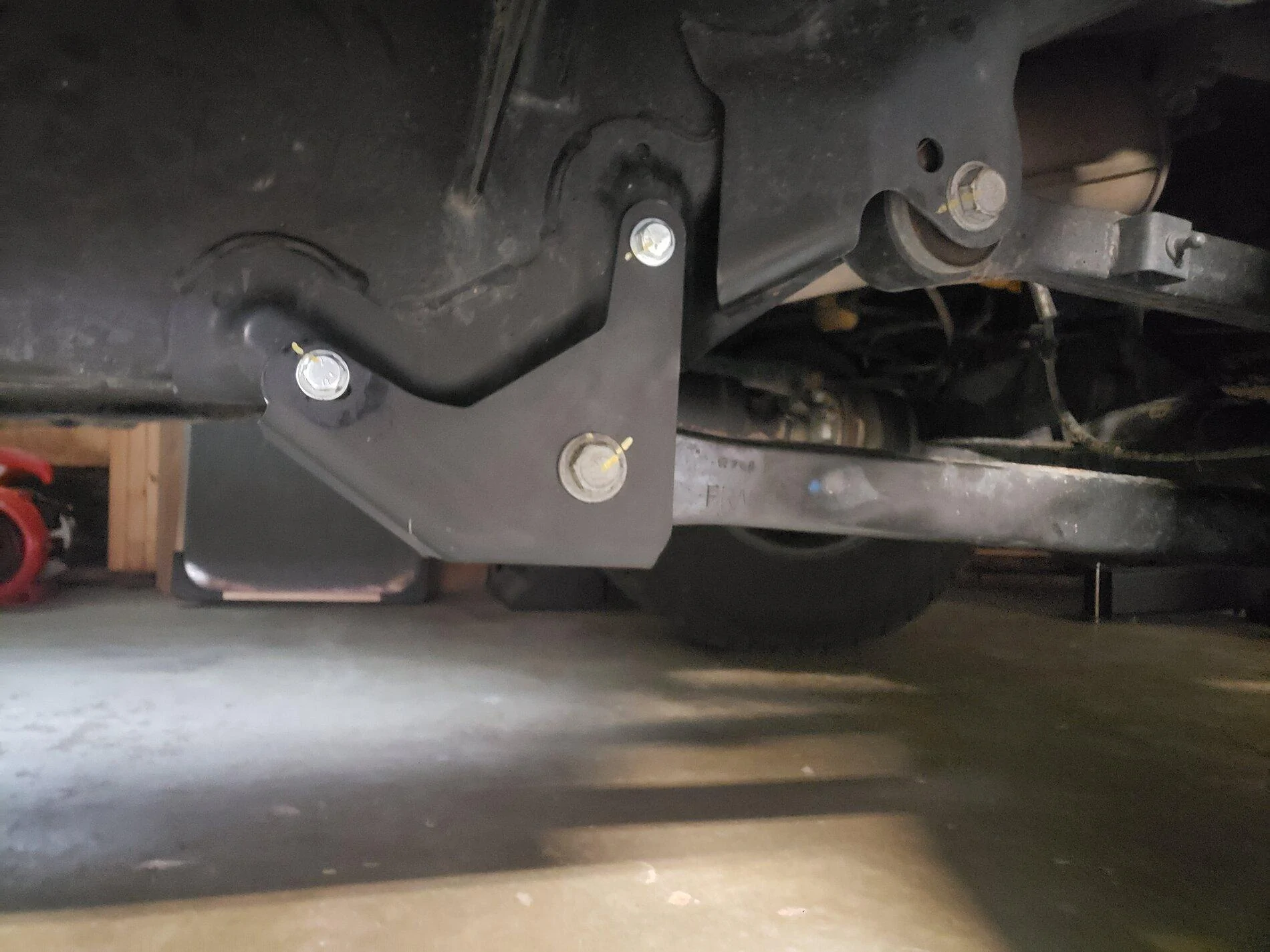

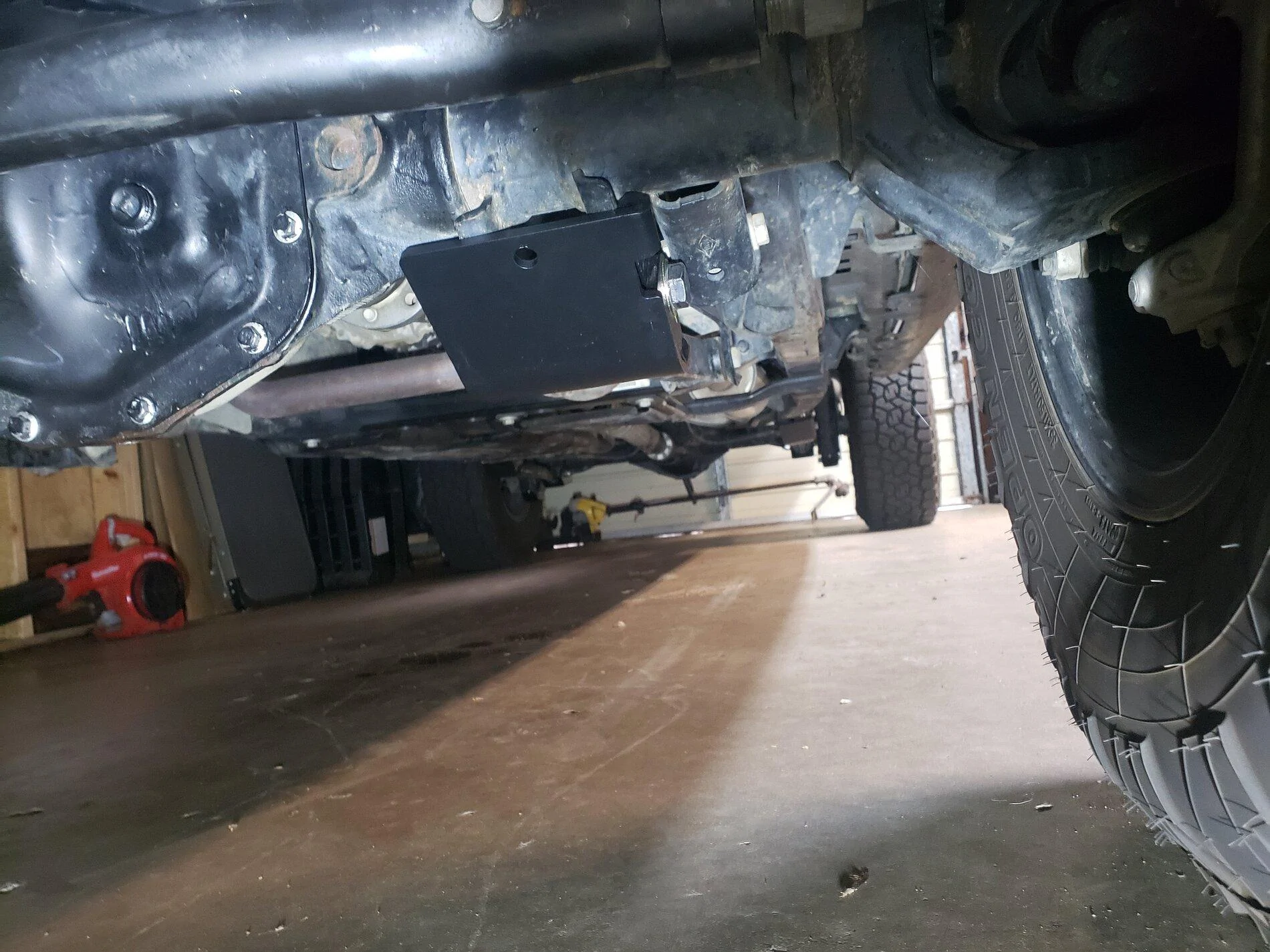

Been busy chipping away at some mods that I've found I needed...
Put on some skid protection: Rusty's Frame side LCA skid, Rockhard LCA skids front/rear + rear shocks, Rancho front diff skid
Slight Rant:
Not super impressed by any of the skids. The all seem beefy and up for a beating but every brand of skid fought me during installation. Rusty's had one hole that didn't line up and required drilling. Rockhard required shims and washers to fit properly on the front LCAs and required me finding some additional washers to keep the bolt head and nut from wallowing the bolt hole. I'm currently waiting on Rancho to supply to correct U bolt so I can install it. It seems these are known issues but damn...I was hoping for better.
All that said I think I now have some decent protection for the type of wheeling I do. Pics

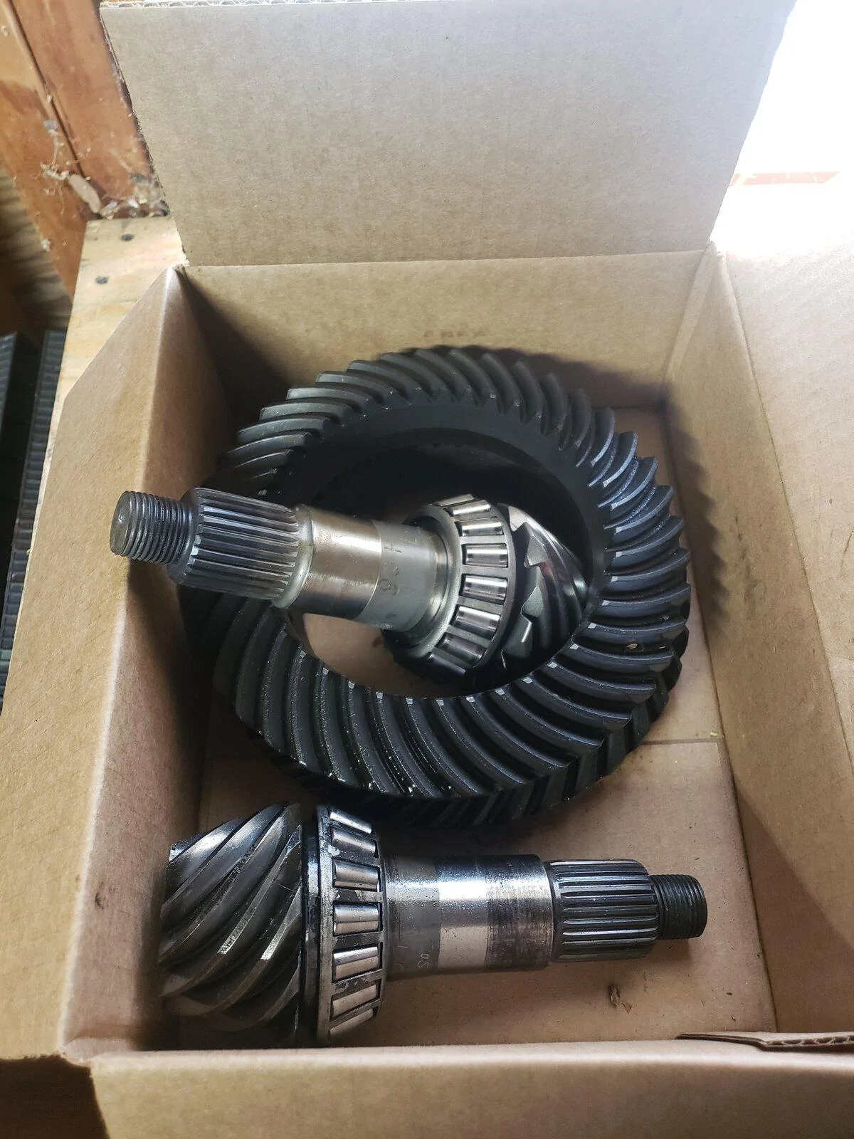

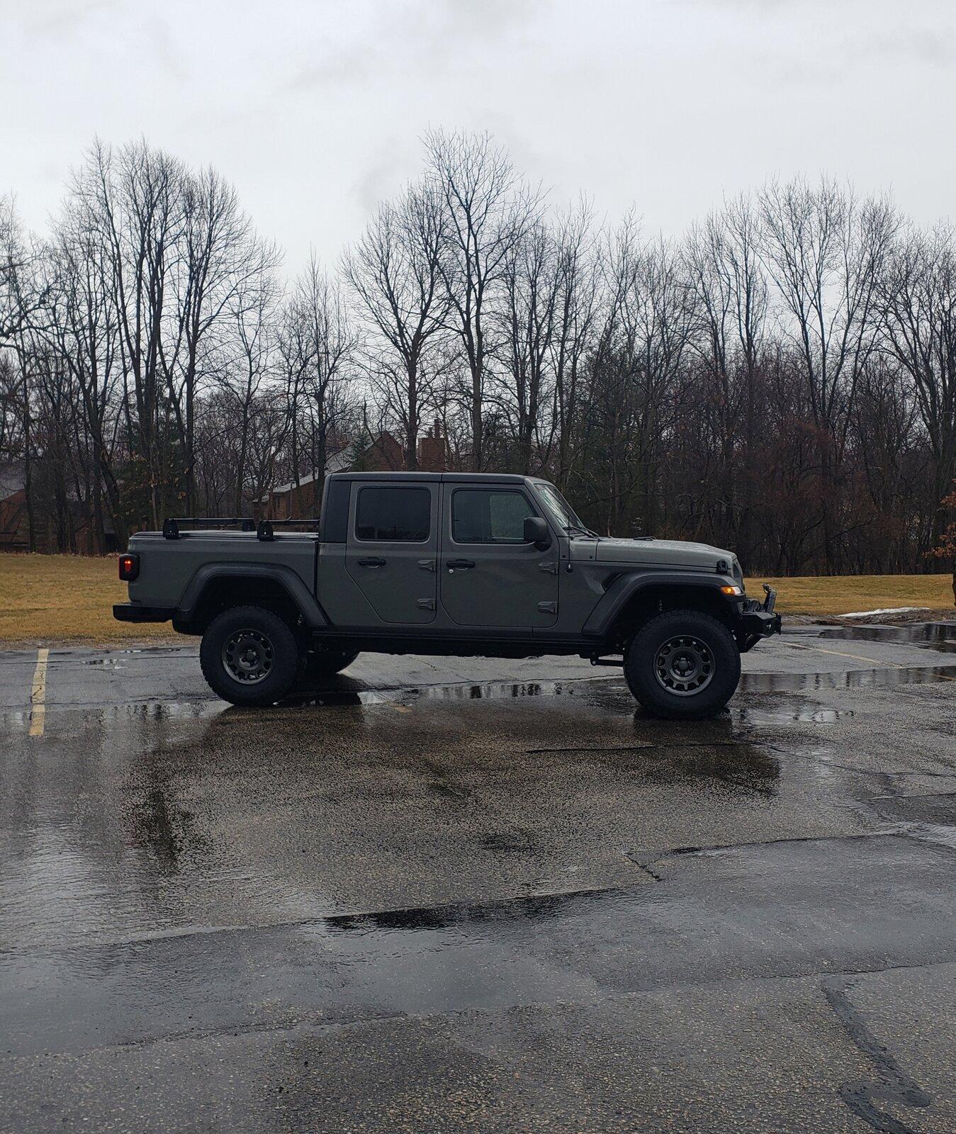

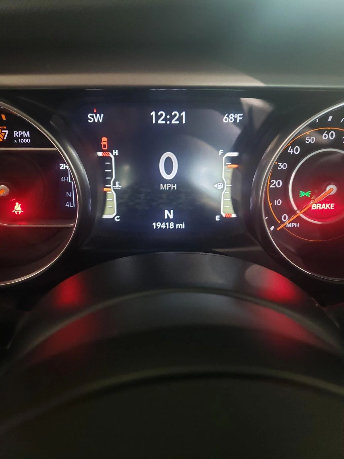

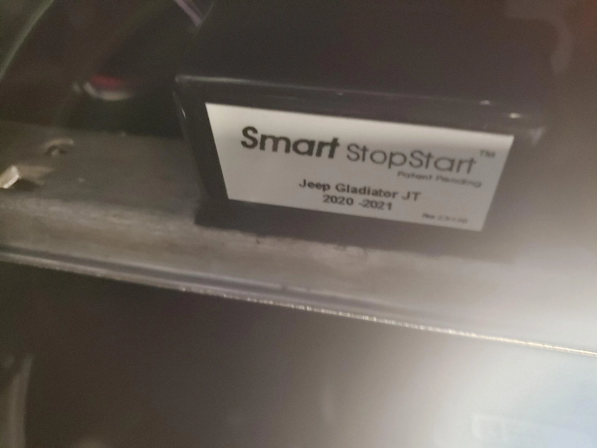

Then I regeared to 4.56 and finally got the clutch software update. The 4.56s really feel right w/ 35s for a DD. I'm digging the gear indicator too
Jeep Gladiator RodReckets Sport S Build Thread JT gear indicator
Jeep Gladiator RodReckets Sport S Build Thread JT gear swa
