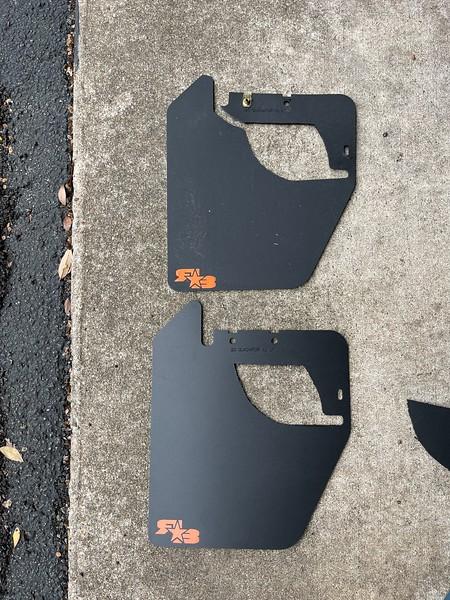

For those that have a Rubicon with MOPAR Performance Rock Rails-- need advice on the RokBlokz mud flaps, it any with both running with these? I need advice (pics please). Not sure whether to buy with or without cutouts to customize for best fit??? MOPAR Performance Rock Rail pic on my Rubicon below...

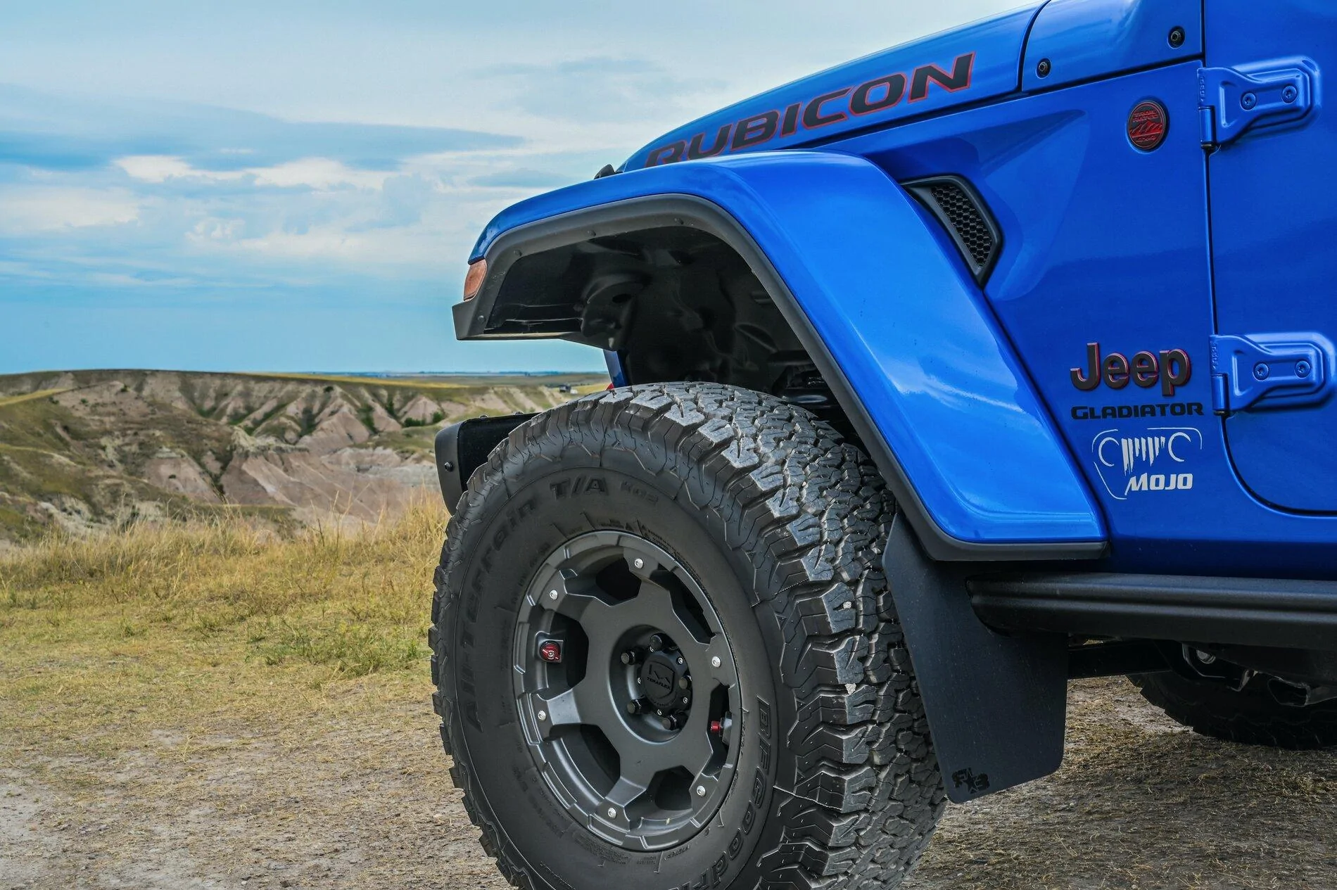

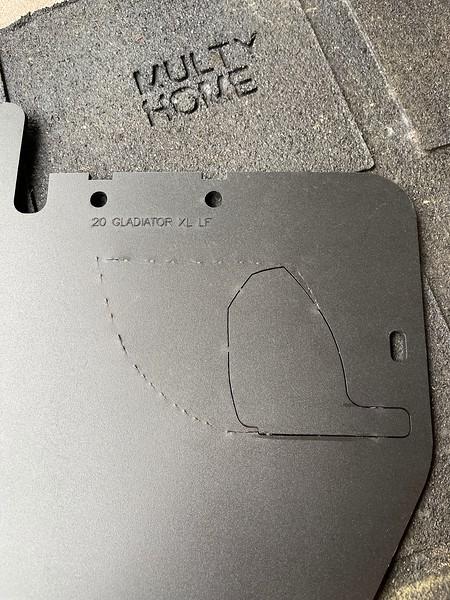

You need to buy the RokBlokz with the cutouts then modify the cutout to fit the extended rails. The rails go through the cutout. The other option would be to cut the front of the rails back then you could get the ones without the cutout.

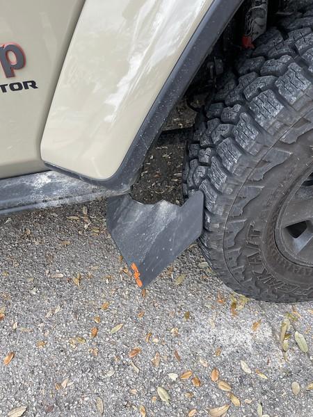

I have this combo. I very carefully enlarged both front openings on the flap to fit around the performance rails, both flaps failed and tore after a few months. I think it's too much material to be removed and the flaps are not as strong as a result. This was just city and freeway driving, no off-road.
best option IMO is to trim the performance rail.
I haven't done it yet, but might do it in the next few months.

just some photos for this thread, rokblokz is a quality product, just doing the additional cutting needed to fit the performance rails is probably pushing it too much- so no fault to them.

Thanks again for taking the time to show the pics! They really tell the story. I'd have to agree after seeing these....grat product but just not enough material left if you have to trim to fit the performance rails. The size difference between the standard rubi rails and the performance rails really is quite significant. In my case the funny part is that I was intending to get a set of rubi take off rails....but when I met with the guy from craigslist and he had the new in box performance rails (that he had advertised as rubi rock rails) and was only asking $200 I pretty much felt obligated to take them...lol. Deal of a lifetime. In the end I do love them though and they provide the perfect step that is just big enough to help my smaller kids climb in.
