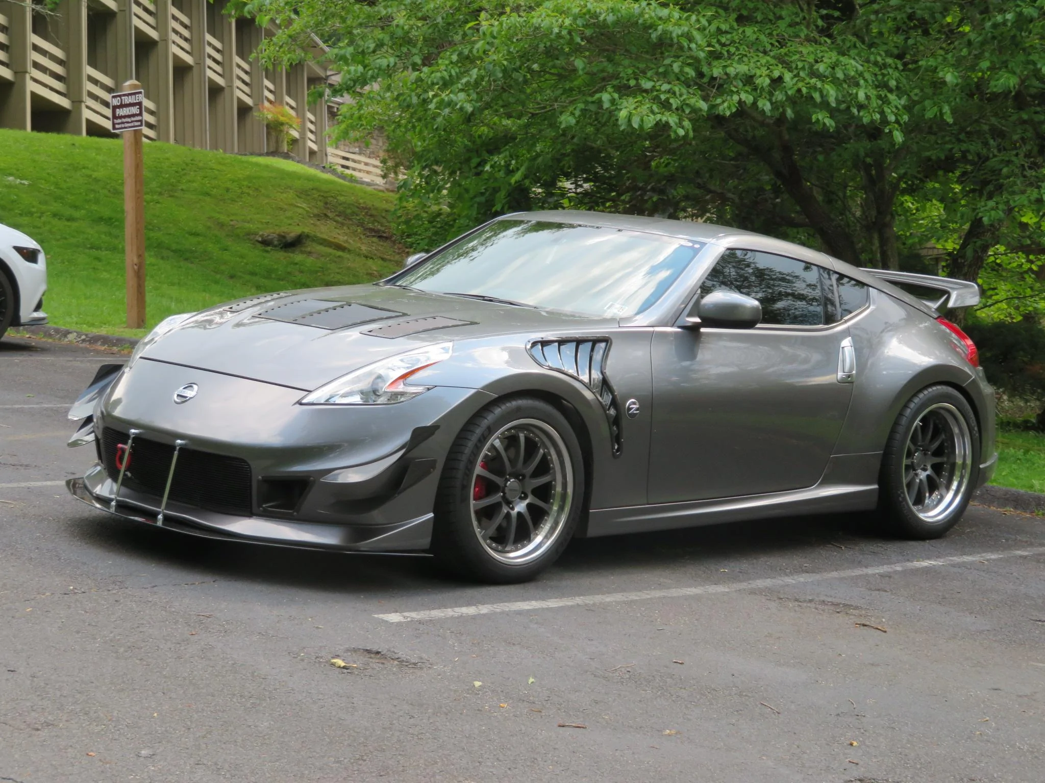

Were you on the370z.com if so I think I can recall your Z, sweet set-up, wouldn’t mind seeing a pic of it again. Sorry, not trying to poach the OP’s thread with this topic.

Yep. Were you on it?
Jeep Gladiator Rotors and Pads VS Big Break Kit IMG_2834
