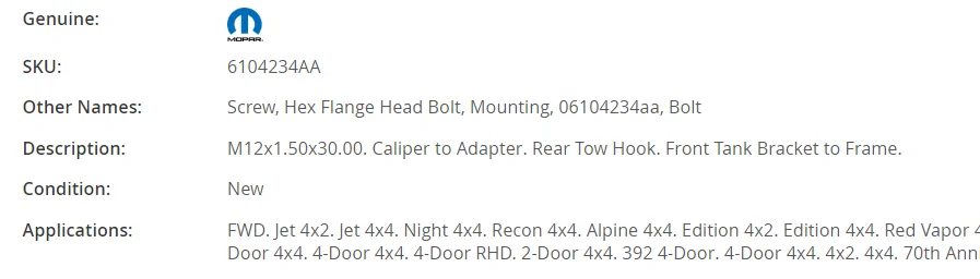

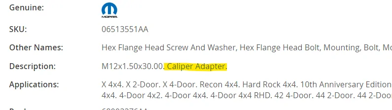

21 and 23 both take the same size bolt (different part numbers?), so I don't know why they would have jacked the torque specs up +18 lbs. That seems like a lot. Perhaps they changed the grade of the bolt?
2023 - Rear caliper adapter bolt M12X1.5X30
2021 - Rear caliper adapter bolt M12X1.5X30
Weird - read the descriptions -
Jeep Gladiator First time ever replacing pads and rotors. Did not go well... 1692457777595
Now look at this one -
Jeep Gladiator First time ever replacing pads and rotors. Did not go well... 1692457799504
Both say caliper adapter, but then also rear tow hook, etc.
And was is 2021 that had the caliper bracket bolts coming loose and/or missing?
There's a TSB about that.
I do recall some reports for the caliper bolts being loose.
I never saw the TSB on it though. Would love to. If the torque specs need to be changed in the tables I can do that, but I want to see the documentation.

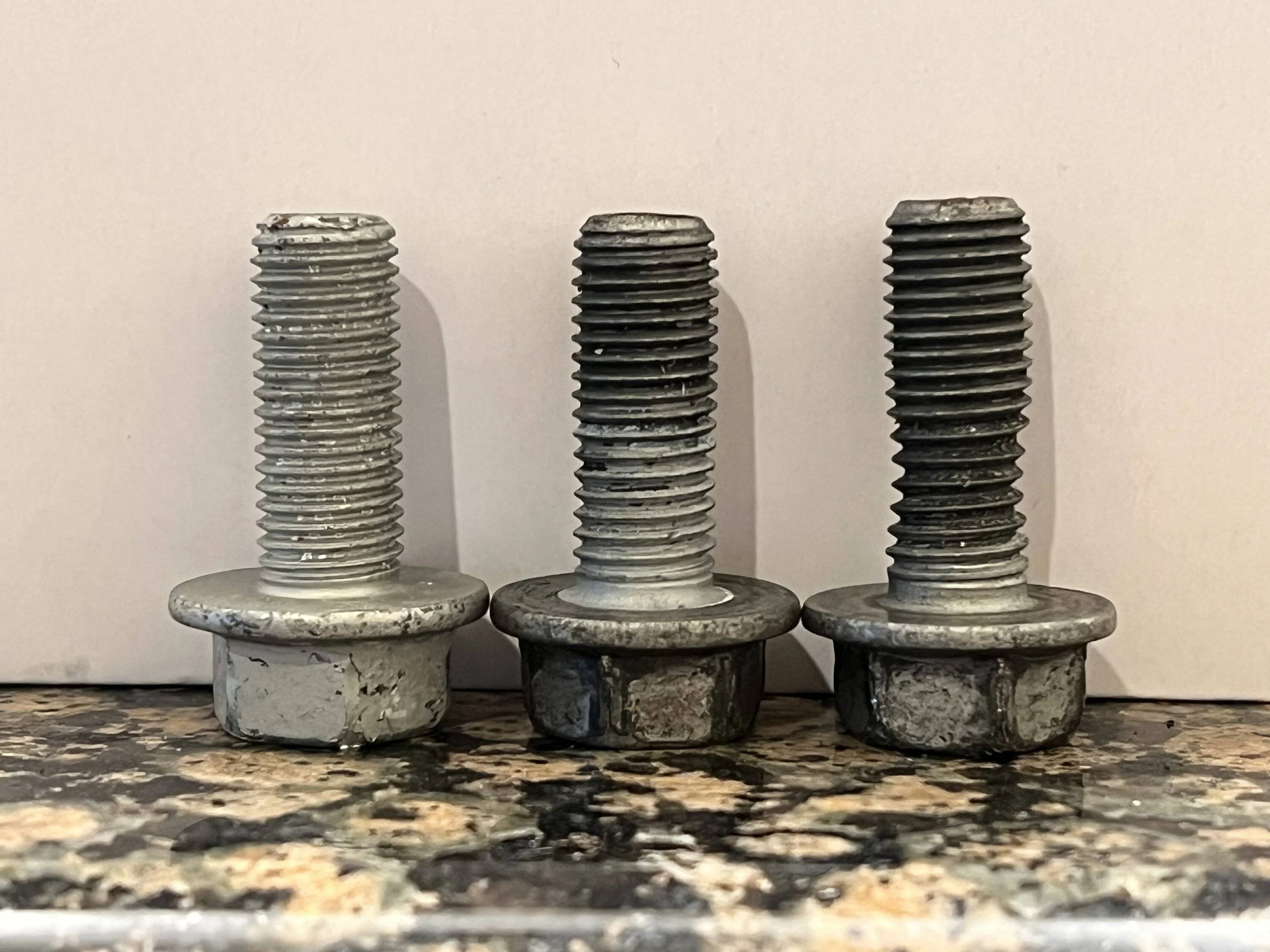

Never mind.
I found it.
They added 3 mm to the bolt and upped the torque to 92. (PN 06513551AA still comes up as 30mm though)
https://static.nhtsa.gov/odi/tsbs/2021/MC-10204371-9999.pdf
I'd like to see one of each side-by-side (bolt that is, not Jeeps)
Apparently since this applies to 2020-21 it makes me wonder if they decided the torque wasn't enough, and the added length if they actually are physically longer is either to engage more threads, or, to keep the bolt in the hole 3mm longer if it comes loose.
Is it the same class bolt, or a higher class?
Did they go from a class 10.9 (roughly equal to Grade 8) to a 12.9 or is the class the same? (12.9 not having an ASTM hex bolt equivalent)
When I get go home I’ll post a pic of both the factory and the replacement.
From left to right
New MOPAR bolt M12x1.5x30
Factory Bolt M12x1.5x30
Stretched Factory Bolt M12x1.5x30
All three are class 10.9

From left to right
So the new bolt and factory original are identical.
I'd double-check the torque wrench. I'd also use some Loctite knowing the history with these.
BTW - the one on the right is no longer class 10.9 - it looks more like no class.

From left to right
Is that the new TSB bolt p/n 06513551AA, or just a new replacement bolt?
I’m not sure I’ve seen a better representation of single use hardware! I have owned a few cars that require new head bolts when replacing due to high compression and stretch. Amazing the forces these components undergo.
