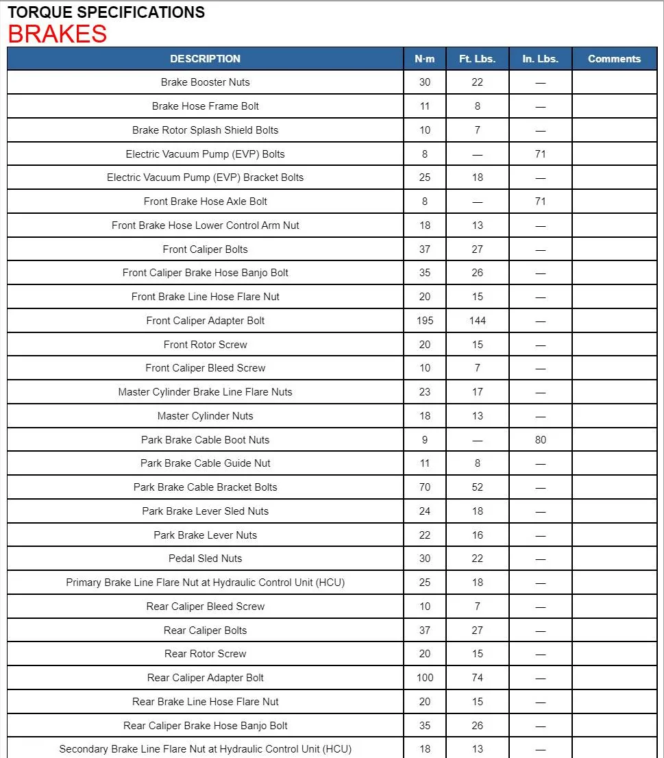

Whats the part # for the replacement bolt you ordered? I have new brakes and calipers inbound now and honestly forgot to order the extra bolt and stud I learned I need to keep on hand after doing my Jks brakes.
Front 06104258AA
Rear 06104234AA

That may be a big part of it. There's a list of torque specs for steering and suspension in these forums somewhere........ REAL torque specs from FCA themselves for Gladiator - not Wrangler from 5 years ago. Not sure there's any brake torque specs, though.
Brakes, suspension and steering I often do torque - but I have torque specs in hand first and if new bolts are required, the specs will say "one time use bolts".
Some systems I've done so much work on I can tighten from memory - do 50 GM brakes and you don't need a torque wrench after the first few.
These trucks have a mix of torque, torque plus angle and torque to yield so ya gotta look before leaping (easier to say than do!)

Still gotta know what year, I guess. I was comparing that table to what the service manual for a 2023 Gladiator says and at least one bolt was different. Rear Caliper Adapter Bolt is 92 ft lb in the service manual, not 74 ft lb.
I went with 92ft lbs on the rear, that might be the issue.
