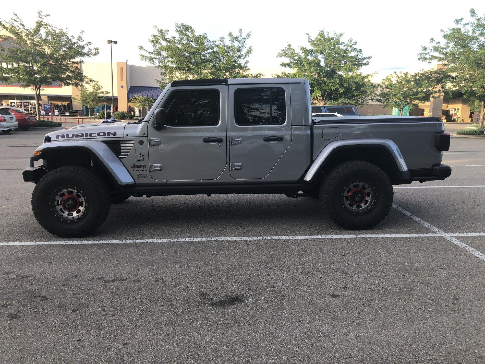

Anyone with actual review? Do those who have it think it sits too high up front? I want a level not a lift and am debating which route to go.

JMO, if you are looking at the fenders in the picture above, the front appears higher. I honestly look at the hood and bed, looks good to me. I think I will do this to my Rubicon.

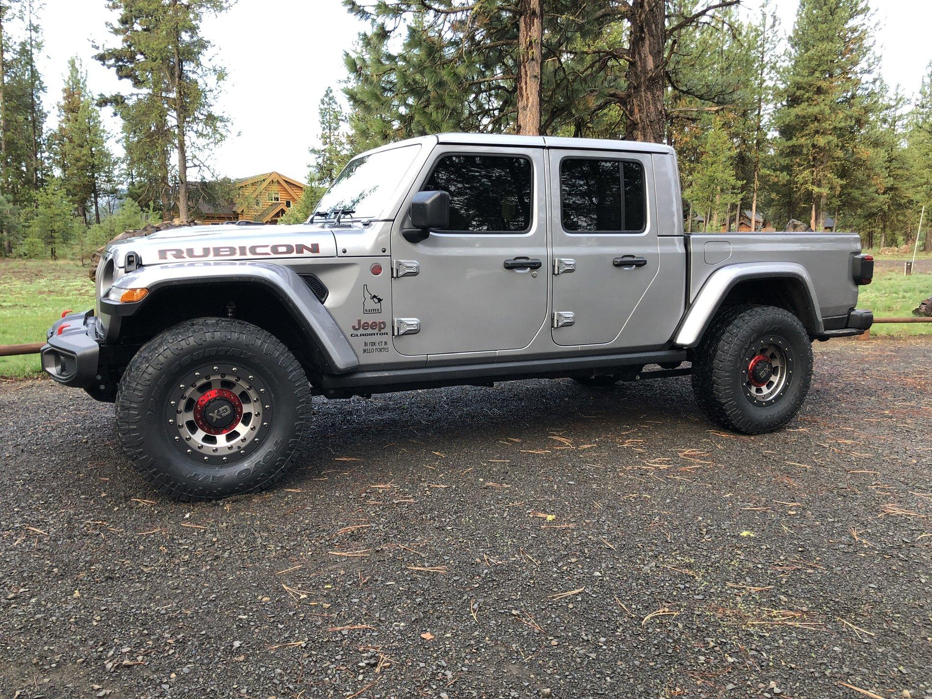

The RC leveling kit is going on my Rubicon this week. Also adding a LoD bumper and Warn Vr8000s.....figure with the added weight the 2 1/2” will end up around 1 1/2” to 1 3/4”..should be perfect! Will post pics when I get it back and pick it up.

RC kit, bumper and winch went on this week....leveling kit was perfect. Very happy!

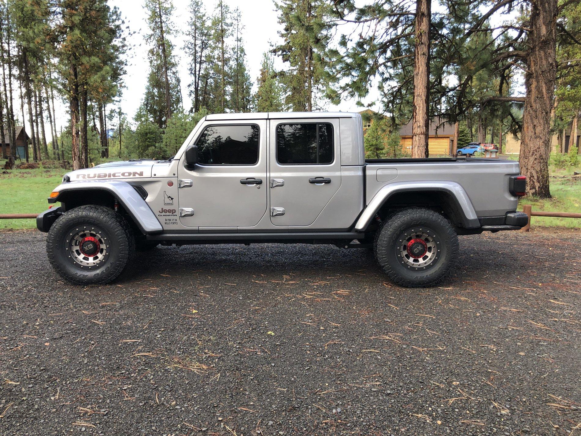

Better side view pic to show the leveled stance -very happy with the look and the RC kit

Level looks great. I plan to put it on my stock overland once it arrives; I’ll take before and after measurements and pictures.

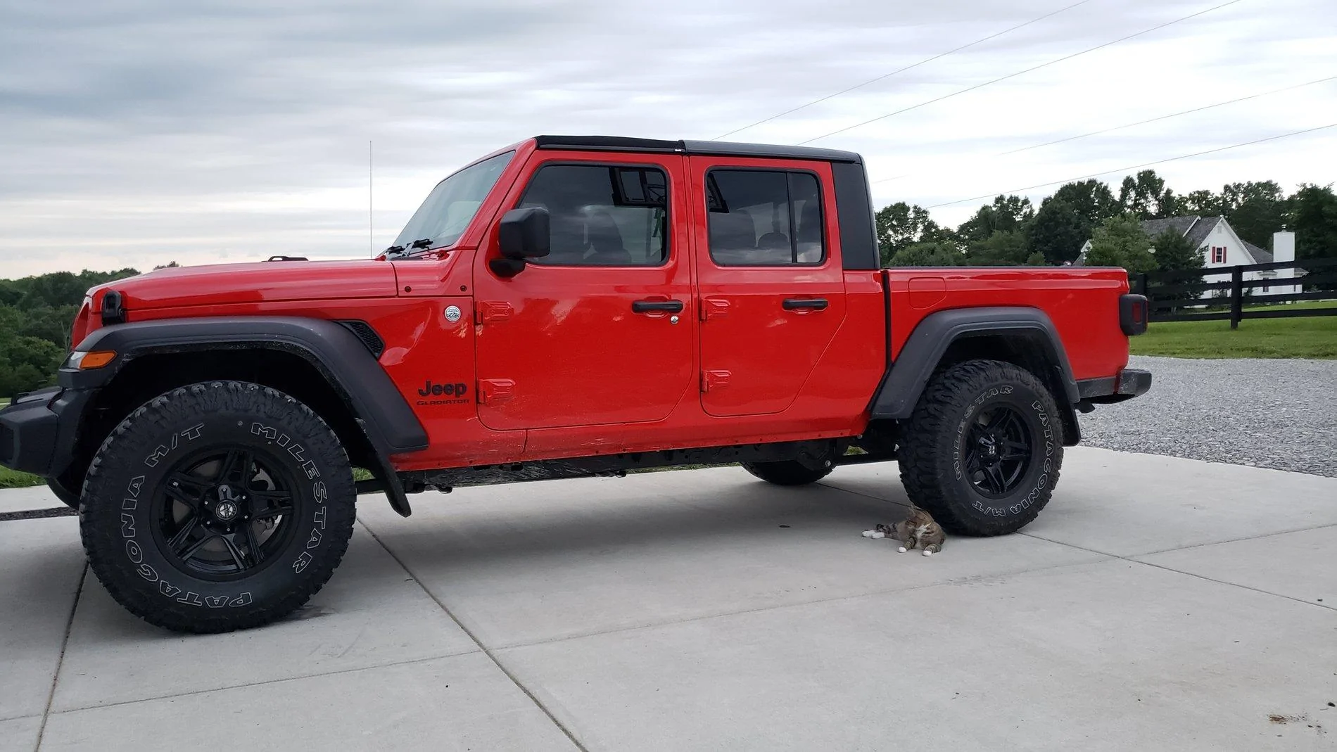

Take measurements from the center of hub to lip of fender front and rear. Mine was only 1.5" higher in the rear, and obviously that is for a specific purpose on a pickup truck.
So I ended up using a 0.75" leveling kit from Rough Country instead. The 2.5" is WAY too much.

I think I’ll go this direction. I’d be happy eliminating half of the rake also. What size tires are those?

Those are 315/70-17s on 17x8.5" wheels that have +10 offset. On a Max Tow or Rubicon, +25 offset would be ideal but I already had these from my old JLU.
