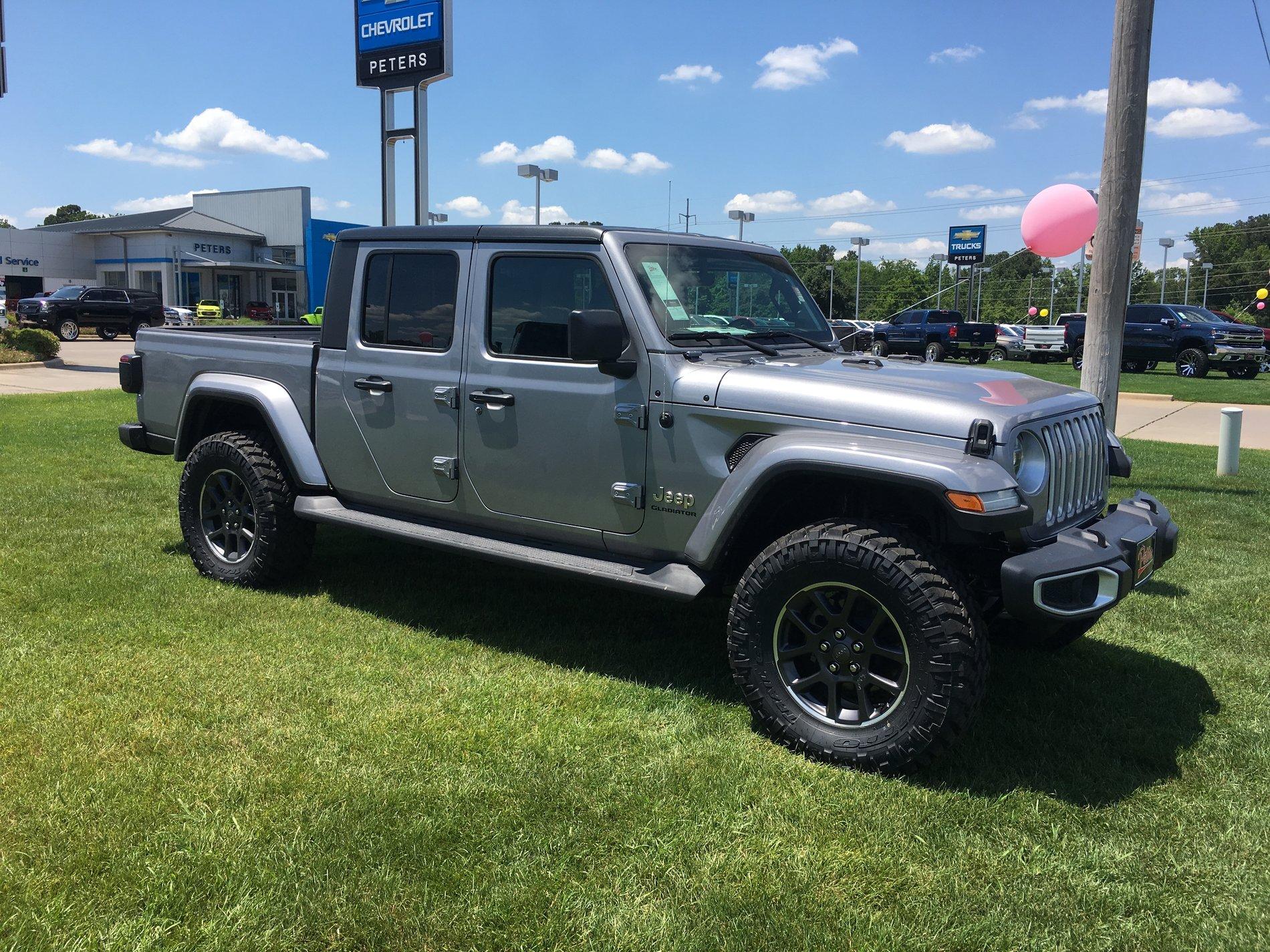

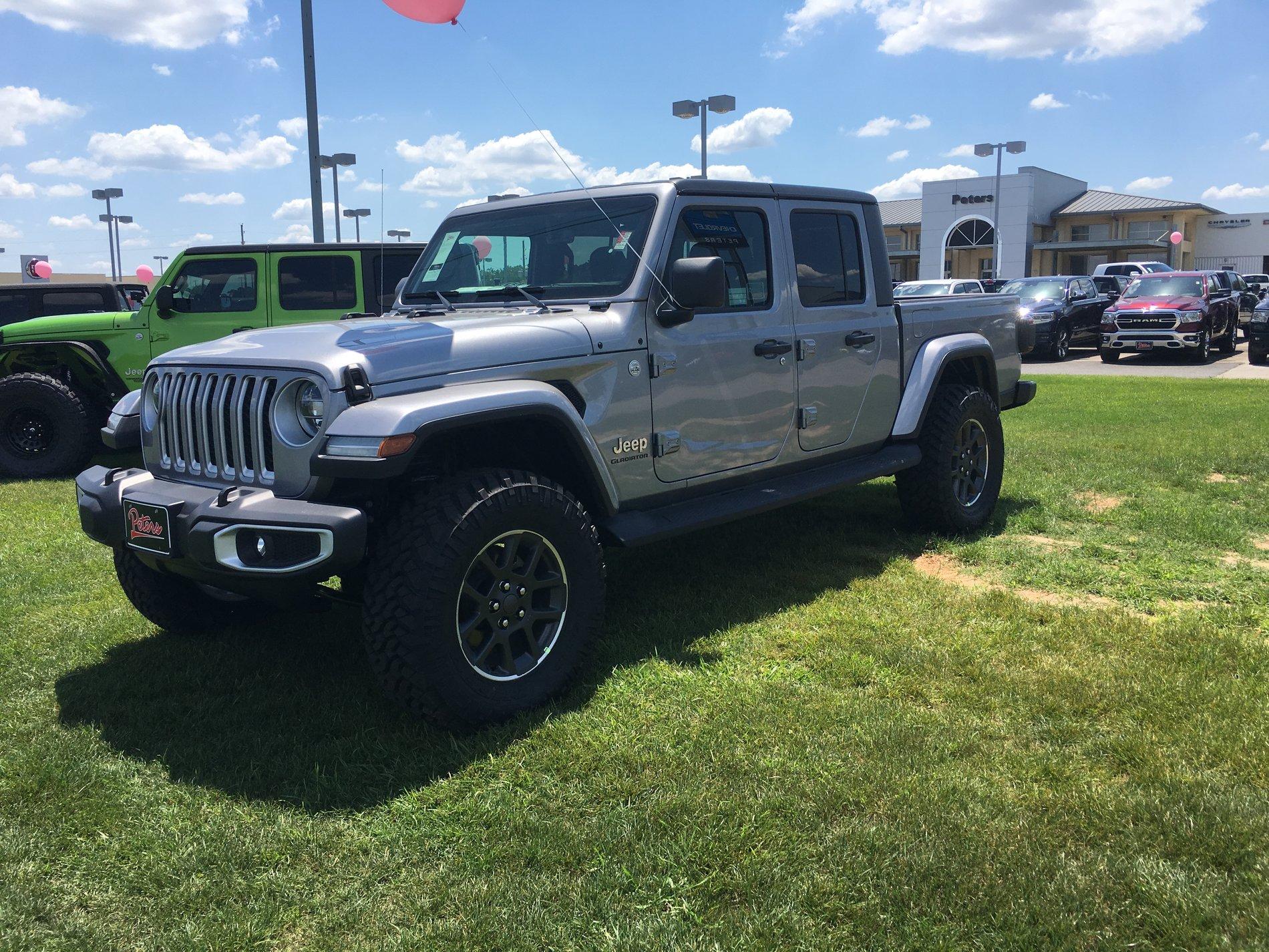

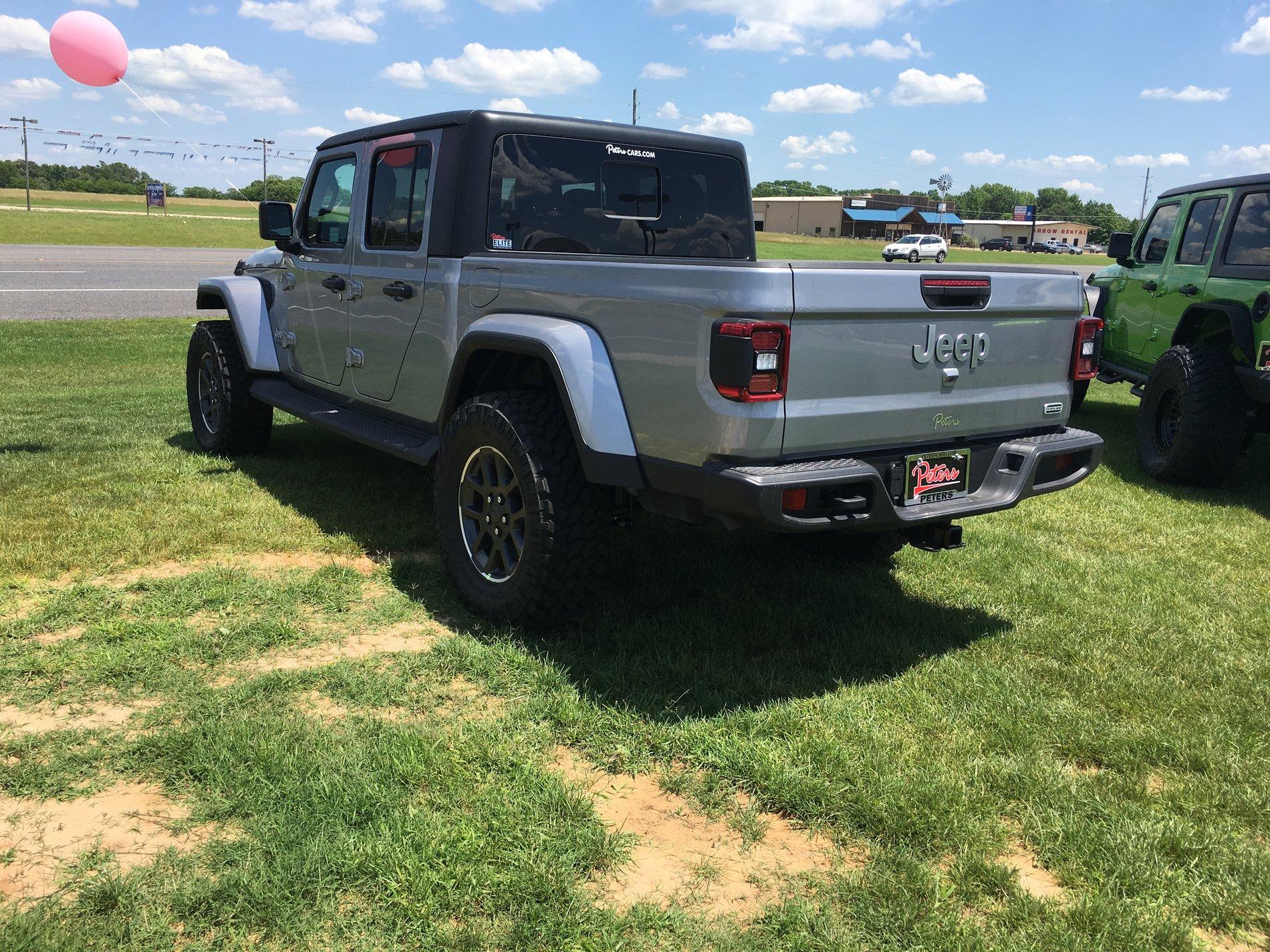

Nice, I want one of these with the body colored top.Gladiator Overland with lift and 35” tires at a local dealership. It is for sale in Longview Texas at Peters Chrysler dodge Jeep. If I remember correctly it is approximately $56,500

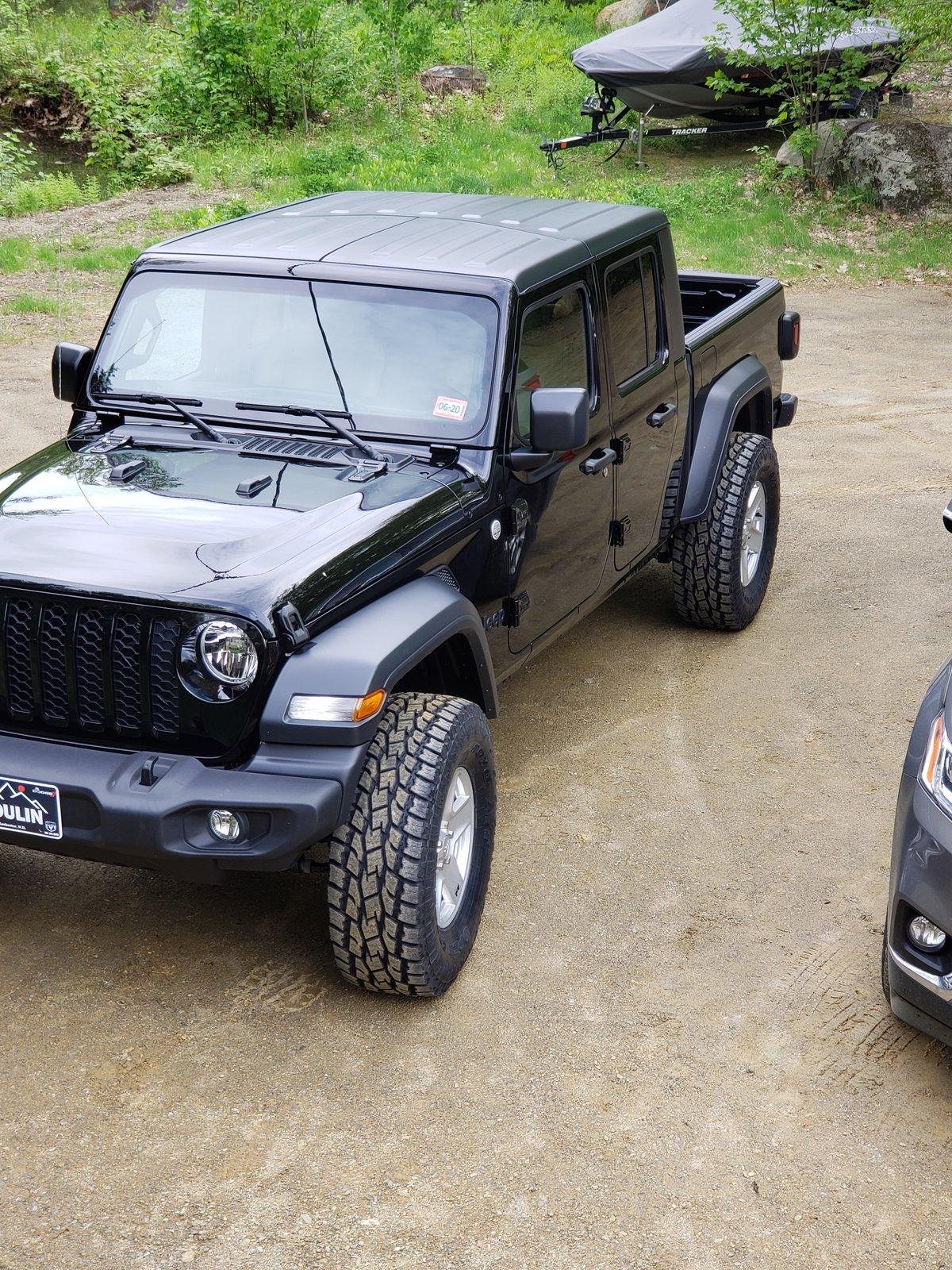

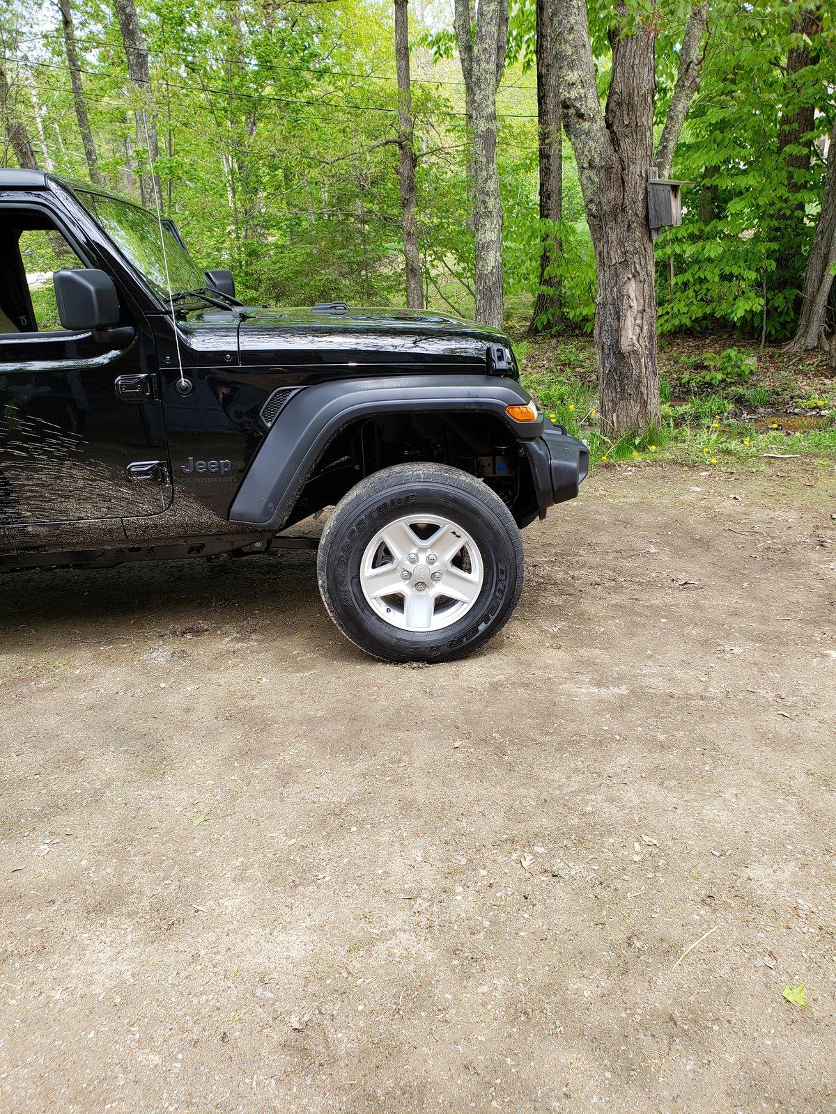

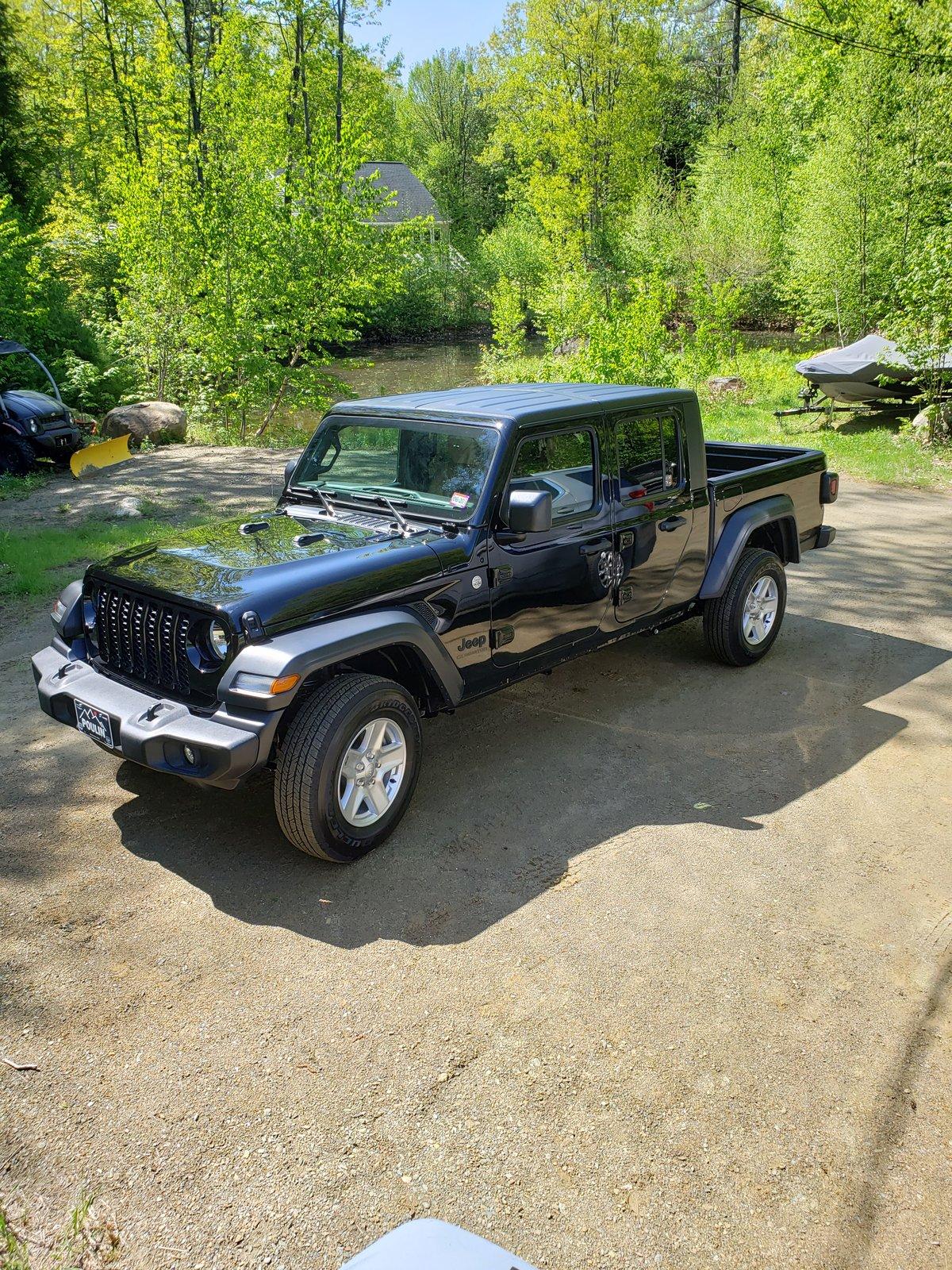

Stock rims...2" spacers. I put the spacers on before, just in case. Im removing them tomorrow. Tires are 35/12.5r17 Toyos. I'll take some better pics tomorrow.Every photo I've seen with this kit have aftermarket wheels. I too wanna see stock car before, then an after photo with same stock wheels and tires.
@Haveachew - Nice truck! (But waaay too clean)Stock rims...2" spacers. I put the spacers on before, just in case. Im removing them tomorrow. Tires are 35/12.5r17 Toyos. I'll take some better pics tomorrow.
Do you have more pics?, are the 3 photos above with stock wheels/tires with the 2" spacers?Stock rims...2" spacers. I put the spacers on before, just in case. Im removing them tomorrow. Tires are 35/12.5r17 Toyos. I'll take some better pics tomorrow.
Thanks...its only 8 hours old, have no fear it'll be dirty soon.@Haveachew - Nice truck! (But waaay too clean)
I'll take more tomorrow. Yes those are the stock rims with 2" spacers. Bottom pic was lift installed, factory 245'sDo you have more pics?, are the 3 photos above with stock wheels/tires with the 2" spacers?
So you used 2" wheel spacers
Ohh, so you didn't do the 35" tires with stock height, you lifted it as well?I'll take more tomorrow. Yes those are the stock rims with 2" spacers. Bottom pic was lift installed, factory 245's
