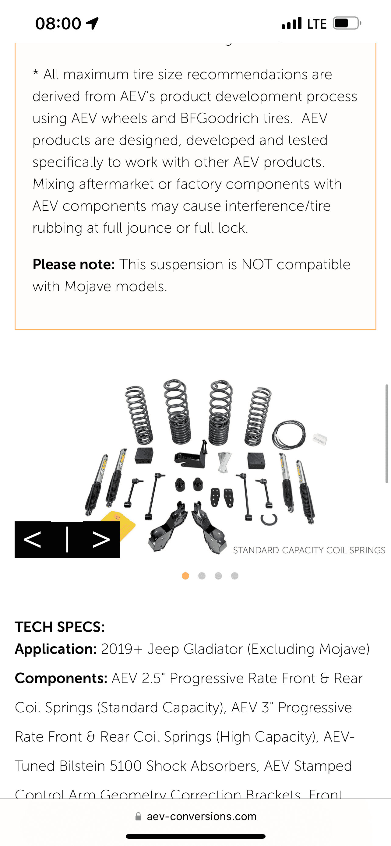

So did you do anything to increase caster? The AEV lift will actually reduce caster from stock since it doesn't come with new control arms or drop brackets.
this is wrong. The AEV lift DOES have geo correction brackets. Seen in a screenshot of their website here. It does correct geometry. And it also includes a rear track bar relocation bracket.
Jeep Gladiator Rough ride 578C0D64-1BFC-4D33-980E-72E43FFEE529
maybe you are referring to the AEV spacer which is not an true lift kit. For some reason everybody on this site always refers to AEV as a spacer kit but they have several options for a true lift kit.
You can get them several ways. With or without the brackets.

yes but the spacer lift is entirely different, and IMO not a true lift.
I just wanted to highlight this because everybody on this forum seems to be fixated on AEV only offering a spacer lift. But they offer a full kit with geo brackets as well.
so it is important to specify what folks are talking about to avoid unintentionally misleading others seeking information, which has happened to me a few times here with less than complete info

My previous post was specifically to outline that AEV offers more than just a spacer lift. It seems apparent that, for some reason AEV is associated with only having a spacer as whenever that company is brought up, that is the first thing everyone gravitates to and there are probably some people on the forum who have no clue that AEV offers other options because of that. I am not trying to get into a 'what is better' debate.
Personally, I don't consider spacer lifts true lifts because often times they are the bare minimum and don't even include extensions for sway bars - some do, but I have seen some that also don't. I would consider a 'lift' to include all things necessary for the vehicle to function properly (maybe not perfect, but at least properly - which of course is subjective). I see them as a way to 'look' lifted without anything else. Maybe a better way to frame it would be, spacer lifts are the most basic lift option to fit larger tires, gain some clearance, and keep relatively the same ride quality as stock. So maybe 'true' is not the right word to use but 'complete' is more proper.
Now if a person wanted to keep the exact (or close) handling characteristics, and also included geo brackets and track bars, then this option might work out perfectly.
Also, I am really confused by your comment on articulation? Not once did I mention articulation earlier. The AEV DualSport RT (NOT the spacer lift) offers no more or less articulation than that of a spacer setup - in fact the only difference would be springs and possibly shocks if using longer/different shocks as compared to factory shocks with shock extensions and maybe also geo brackets if those were added. Articulation is not a point of discussion I was trying to make.
For me personally, I need more spring. Based on the various calculations I have made I think it is pretty fair to reason that most people, including those looking at a spacer lift, find themselves needing more spring when loaded down for a camping trip, and the family, or even just a dog. Not everyone mind you - and those using their JT strictly for road use or commuting then a properly built spacer lift will work great (pending keeping control arm geometry the same as well). But, 9 times out of 10 those looking for a lift are also looking to carry more weight on a regular basis - so the stock springs will end up sagging.
