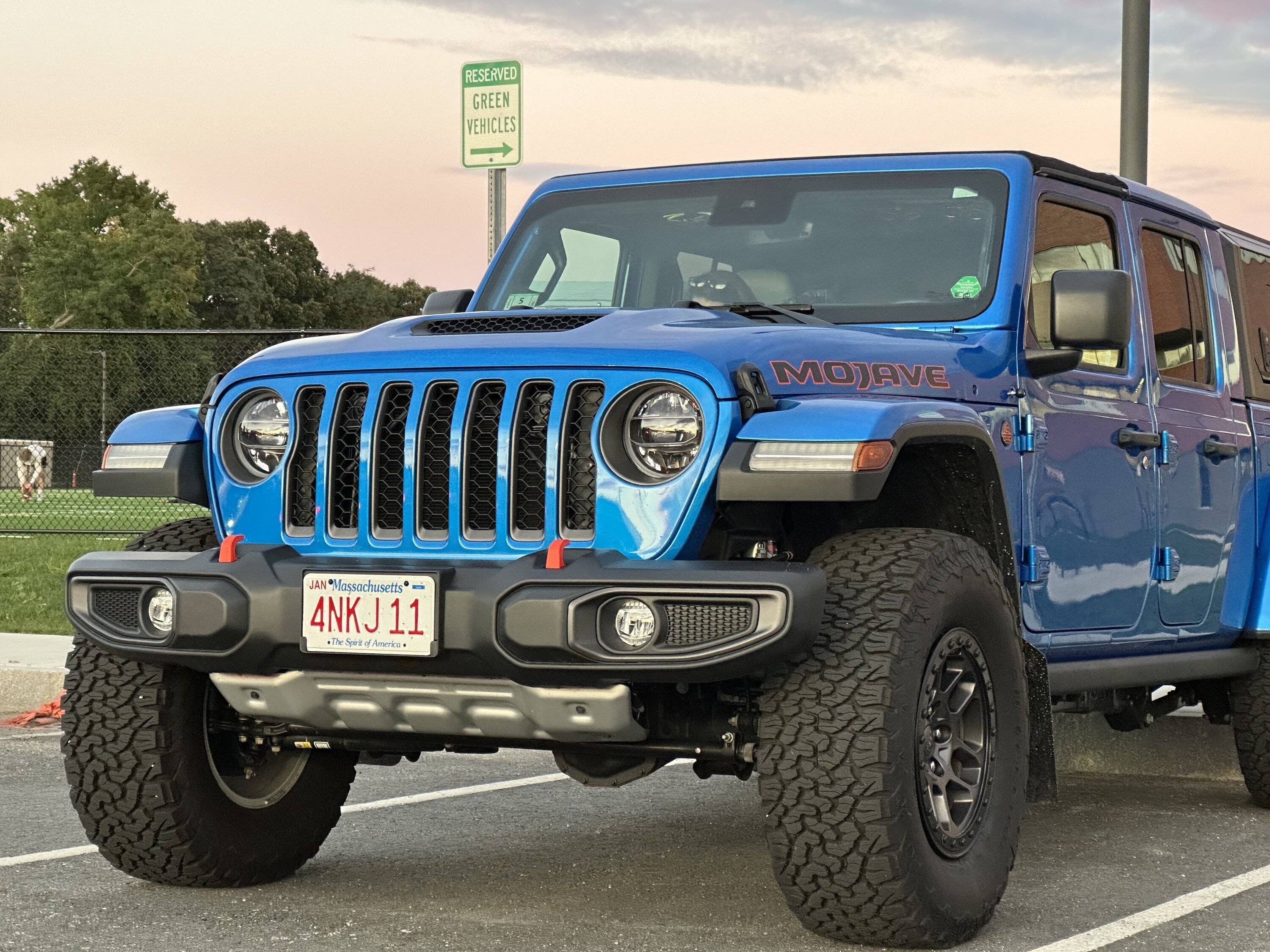

On road ride in a capable off road setup was the main reason I got the Mojave.
It just feels well sorted out. It's got relatively soft springs and relatively heavy damping.
Between the extra height at the front and the high fenders I can run 35s with no lift, no rubbing, and it doesn't look "stuffed", which is a look I dont like.
I'm very happy with how it looks and drives with 35" Xtreme Recon take-offs with BFG C rated K02s.
