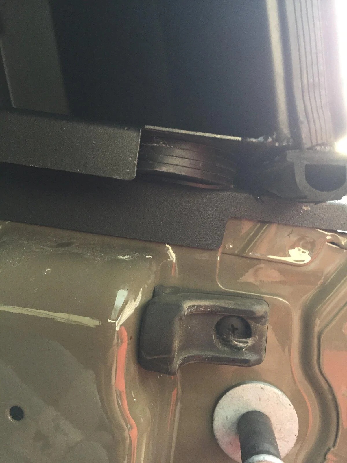

I chatted with the RSI regional rep. He is unsure if the newest models on the water have the thicker shims. Fingers crossed that it does, but I’m not going to take any chances. He says he bought the ~9/16“ shims at Ace and placed them in the corners near tailgate (see pic). I’m going to a box store to get the shims just in case - cheap insurance for when I start putting this thing together. I’m going to be anxious to get it on and plan to use a 600lb hand winch and nylon strap to hoist into place - I’ll take images of that setup at some later point.
Jeep Gladiator RSI Smartcap 17ECA762-64EF-42C5-BE71-EEFD1B7D7801

@Bwitherel that seems like a lot of shim. Does it make the cap look unlevel? It seems to me like there would need to be a shim under each of the clamping points to keep the frame bottom from bending as it gets tightened down. That shim just doesn't seem right.
