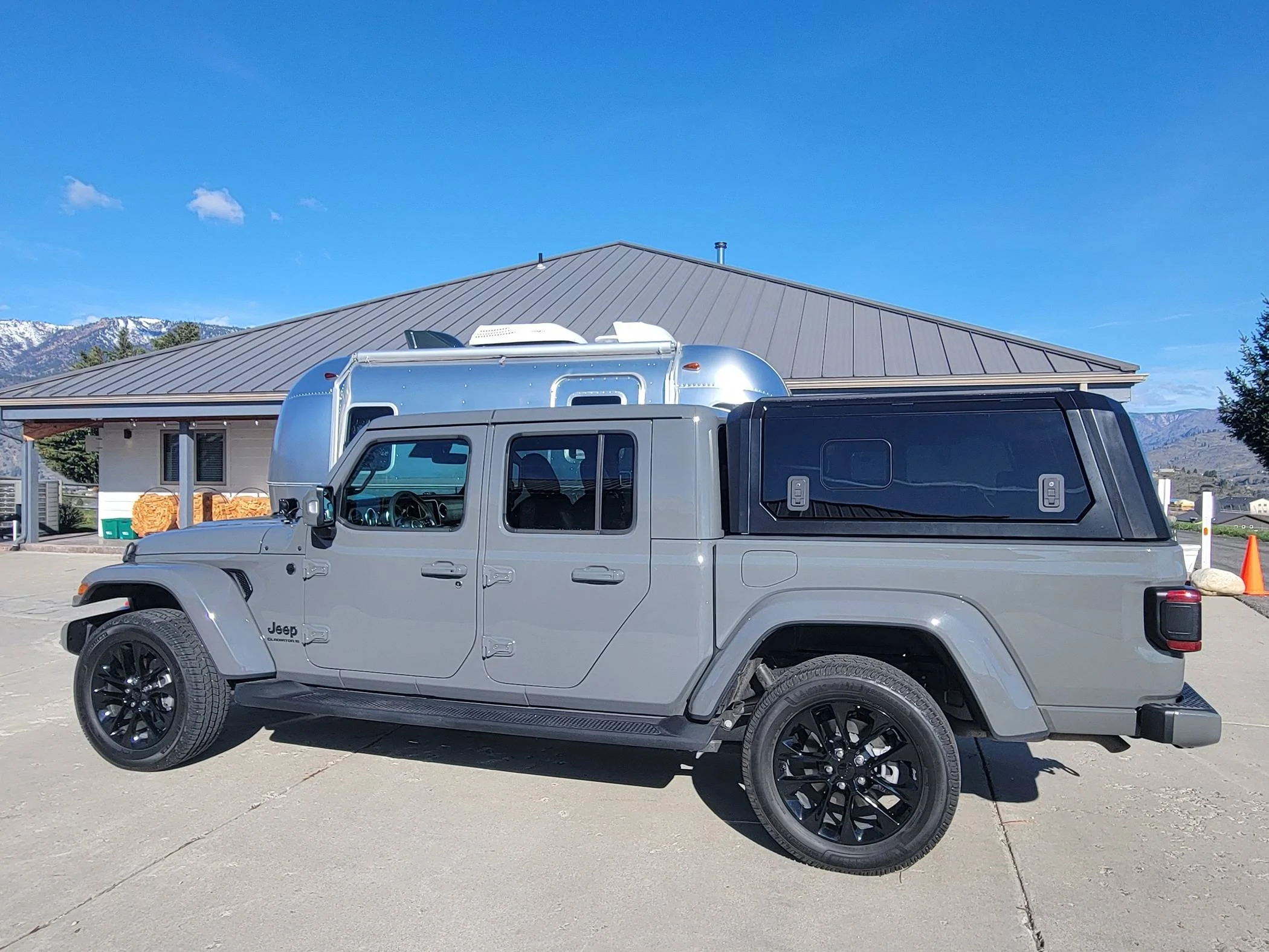

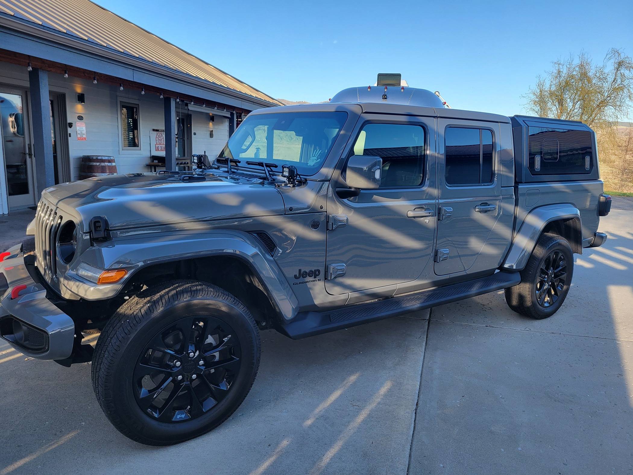

RSI SmartCap installed about 1 month ago. I'm not a great DYI'er when it comes to large items so had distributor put it together and lift it onto the bed. I witnessed the team of 4 guys carefully place it on the bed - well worth the price of professional install. Have not noticed any effect from the weight of the topper and it is SOLID. Did an unscientific MPG test on trip to get it installed ( 161 miles to Yakima installer and 162 miles back) Mileage IMPROVED by 2 mpg ! We'll see if that is a long term effect but happy so far. I also bought the SmartCap load bars and installed them this week. Again , super well made but at 3 1/4" wide, a lot of my vintage racks need some modification to fit. I'm a Happy Canopy'er.

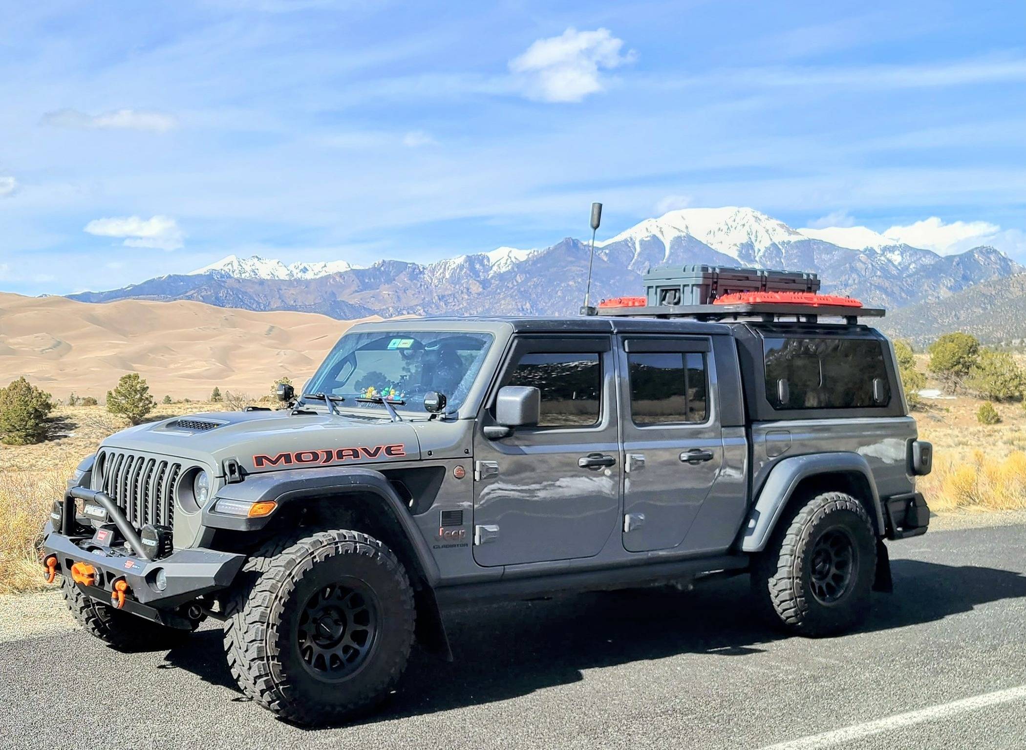

I noticed the sag on mine after adding smartcap, frontrunner roof rack, steel bumpers, winch and recovery tools. Im planning on getting Dobinson adjustable shocks and HD weight specific Dobinson Springs (apprx 800lbs-1200lbs) with my 3in lift kit when i have the funds. Im building an overlander so thats always been part of the plan.

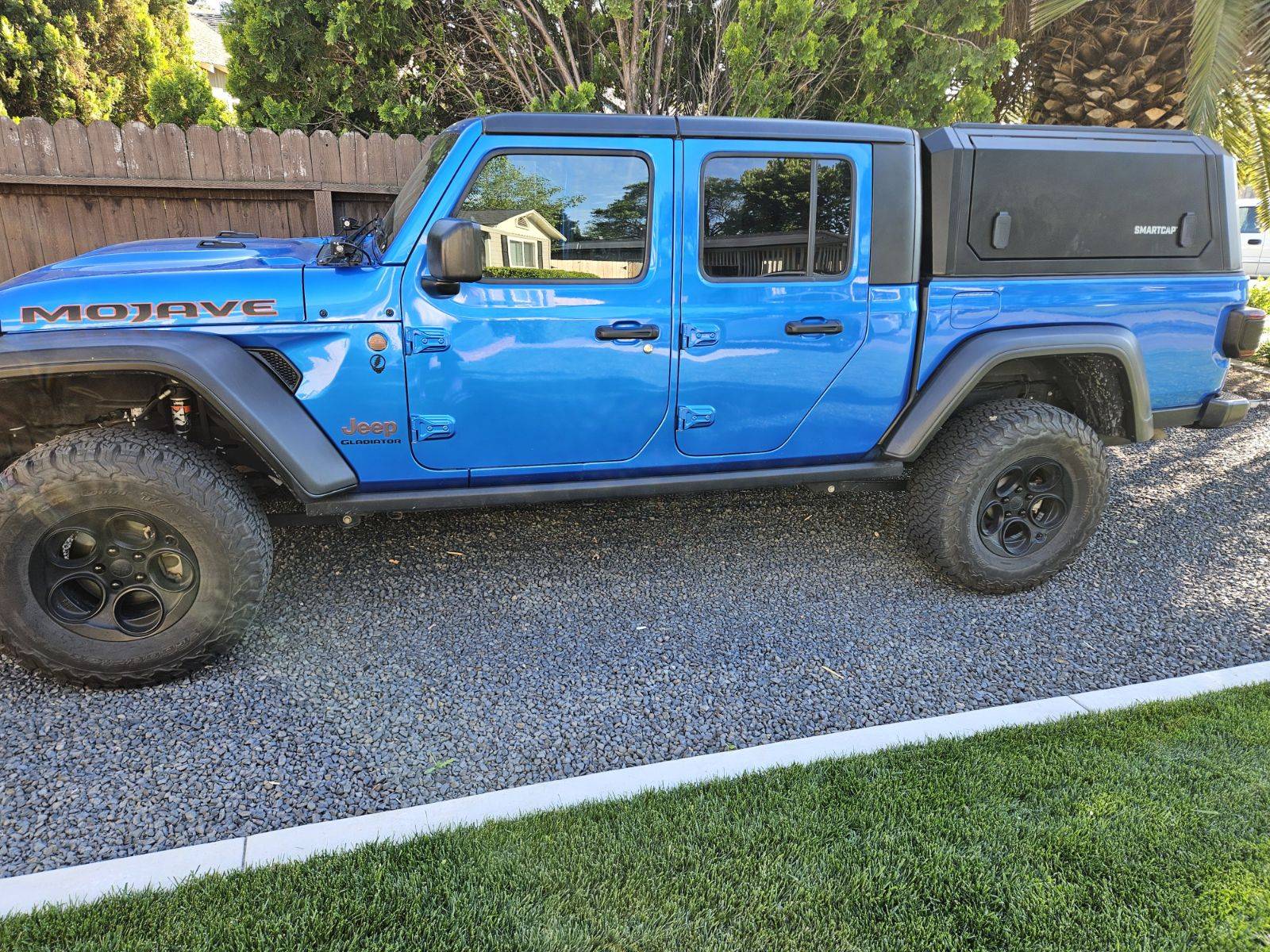

Got my smartcap. I went ahead and added the air lift bags. This is with the minimum 5psi.
