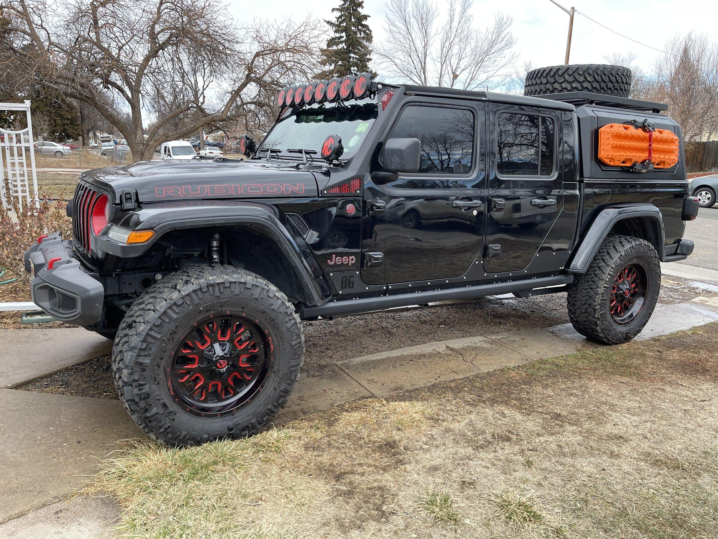

Can you not mount them on the inside of the door and just grab them when flipping to door open? isn't that the point of the molle panels on the inside of the door?
Doubt that would work since the boards are as long or longer than the door & besides this adds to the overall esthetic’s.
