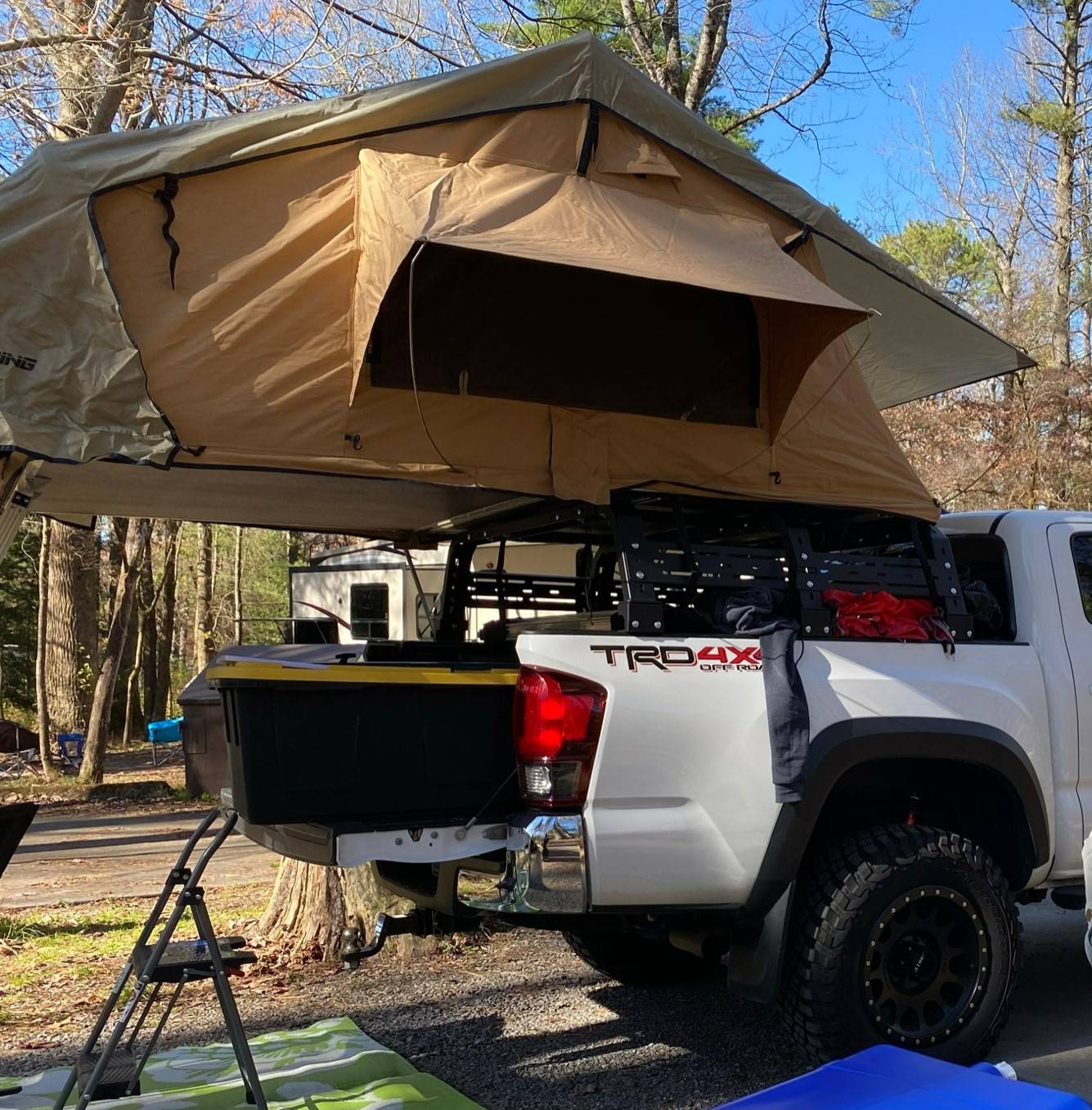

I ran my RTT on my Tacoma that way it was perfect. I sold that tent and switched to a Wedge style that is a lot easier to setup and takedown since buying my Gladiator. Not all tents would work for this but the soft canvas type I had from ARB worked well. I liked that I could open it up and it created a small sheltered space under it. It was low but I am short so not an issue.

Similar to what the Wrangler guy had done. Thanks for the pic!.
Yeah, it looks like some of the tents that you used to be able to do this with like the CVT's and Tepuis are now not quite so square anymore. The ARB's seem do be more dimensionally square still compared to the others.

That is exactly what I want to do. I'm on 38s with a 6in lift so walking under it will not be a problem. Thanks for taking the time to post the pic.

No worries, a friend has a full size Tundra and set his up like this. The Tundra sits high enough that he is able to attach the annex room under the tent which is pretty nice to have for somewhere to change clothes or whatever.
