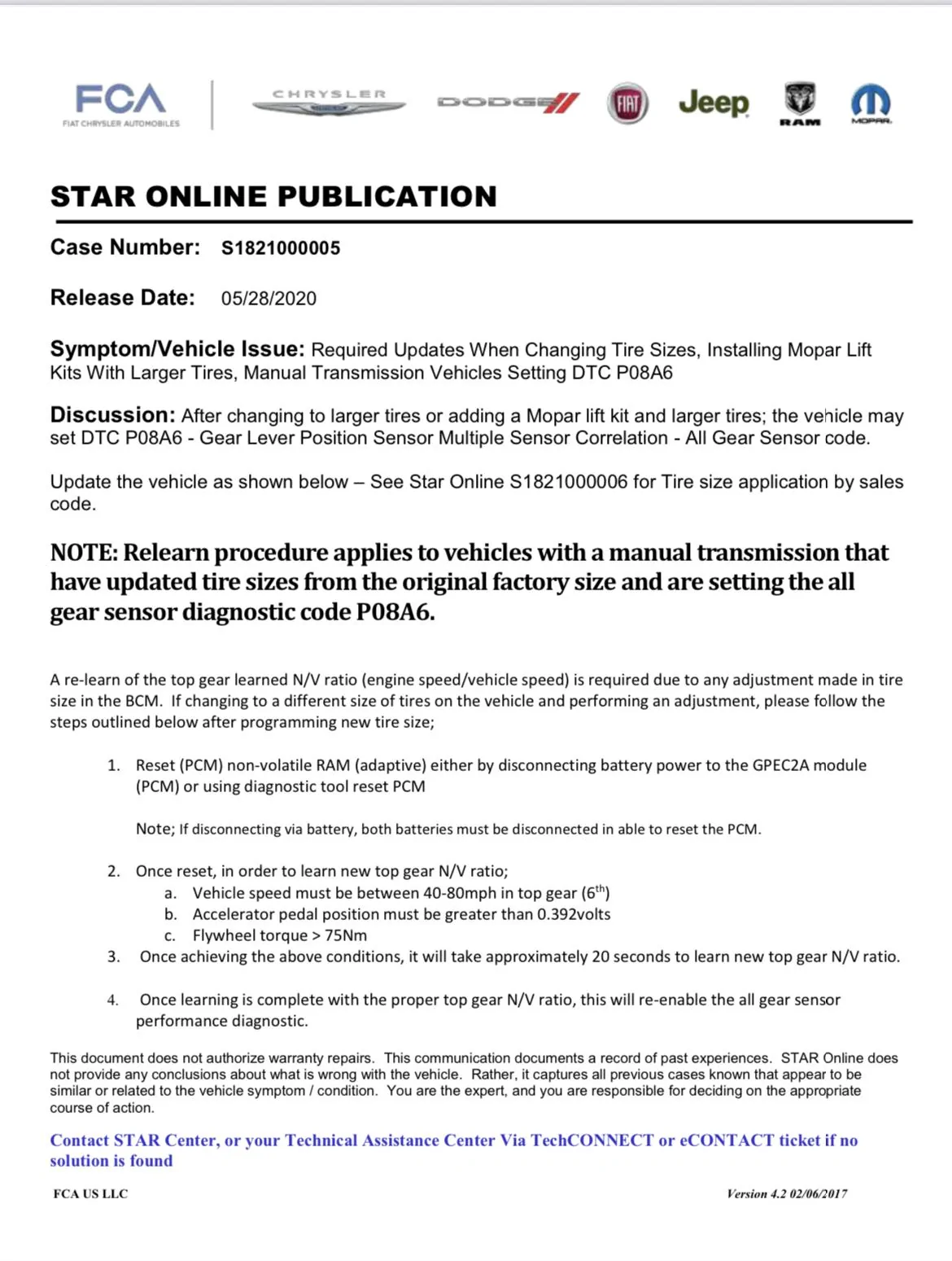

Here is the TSB for the fix.
Jeep Gladiator Rubicon 4:10 to 4:88 upgrade issues (Jeep DOESNT Cares Case #79708336) E78E9120-3274-4CA2-8B78-8F1786FF3B2A
I brought this to the dealerships attention a few months ago. They said this is a totally different issue and that yes, they did the top gear relearn after lift/tires and then again after the gear change.. The ongoing issue I am having is when they change the programming from 4:10 to 4:88 then start my truck it automatically goes back to 4:10.

TwelveGaugeSage
Jason
Aug 17, 2021
281
411
Massuhtwoshits
2017 Kawasaki Z125, 2016 Yamaha WR250R, 2021 JTR
Air Force Contractor
Thanks for sharing.
I don't know if you read the links to the JL forums, but it seems exactly like the issue they were having which was resolved by unplugging the battery, separating all connectors attached to the negative terminal, turning on the lights, and holding down the brake pedal(The last two to drain any capacitors).
Have you tried this process?
Edit: Here is what one poster did to resolve it. There are several ways like this, but they all involve disconnecting all power and all seem to have the same outcome: Problem solved.
@gts and @rustyshakelford thanks for the help. Disconnecting full power did it. I disconnected the two negative leads on the main battery and separated them. for good measure I put a multi-meter on the battery + and fender ground and watched as some large capacitor discharged. I waited till it got down to about 1/2 volt then reconnected everything.
Took it down the highway and did the 6th gear relearn procedure, and the ESS errors are gone! Woot! I'm going to find a dirt road in the morning to test if that solved my "service 4x4 system" issue too :fingerscrossed:
