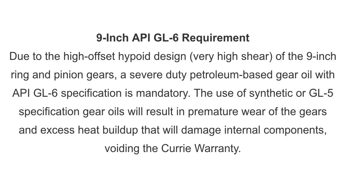

If you read that, it is very very very specfic to the Ford 9" Rear
Currie said:
The 9-Inch Gear Is Unique
The design of the 9-inch features a high-offset distance that places the center-line of the pinion gear 2.25-inches below the center-line of the ring gear, which is substantial when compared to the 1.125 to 1.5-inch offsets of other gear sets (see image below). The high-offset distance increases the contact patch between the ring and pinion teeth by approximately 30-percent and is a crucial reason for the legendary strength of the 9-inch gears. However, strength comes at a price, as this high-offset distance creates increased sliding friction and heat across the gear tooth face. Because of this, not using high-shear oil such as Currie’s 85/140w can lead to scoring and certain gear death, especially during extreme scenarios such as off-roading and racing.
Our Dana Axles are physically different. The above however, is probably a good idea for people who tow and do a lot of long distance driving. It definitely would not do anything bad.
