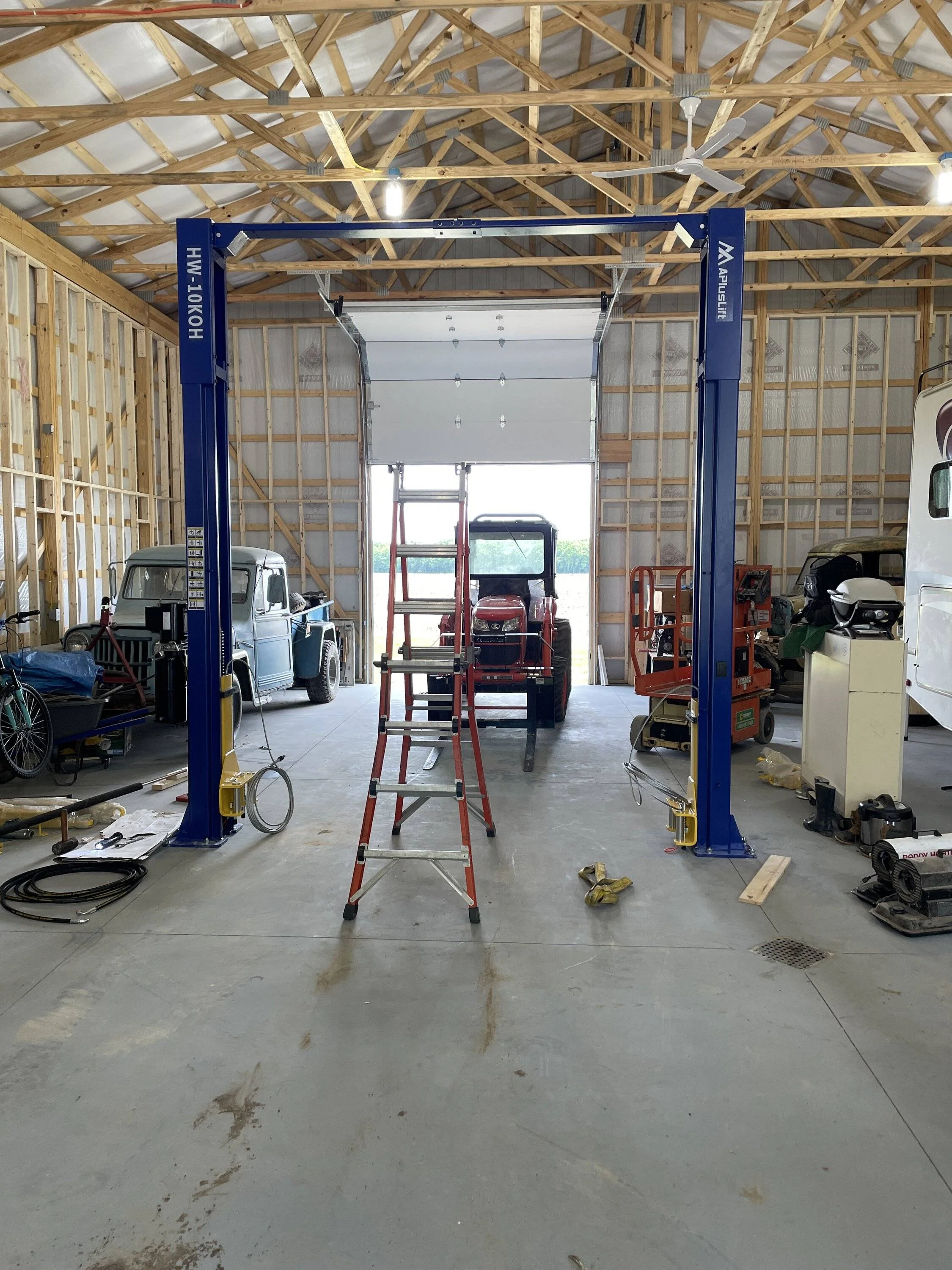

I have 35s and 4.10s on my JTR and hate it. I'm going to 5.13s.
I'll have $4,000 in my regear.
$1,000 in the spicer gears and rebuild kits
$3,000 in a two post lift because I don't want to roll around on the ground anymore.
mac 'DIY and keep the lift' gyvr

Jeep Gladiator Gladiator 5:13 Gearing quotes 52DDD15C-C96D-473A-8325-35C340040551
Started the install yesterday…
mac ‘of the lift’ gyvr
