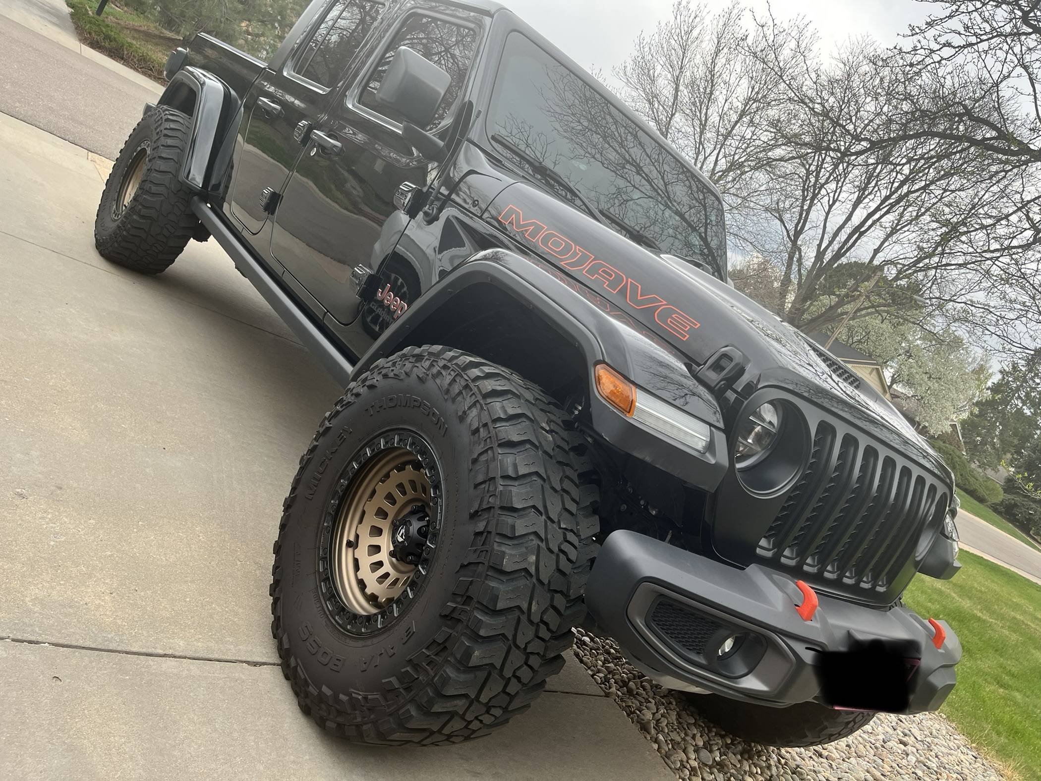

I know this topic has been addressed and best to death, but I’m hoping for some feedback.
I recently did something I thought I’d never do; I traded my built 5th gen 4Runner for a 2020 Mojave. The Mojave is in incredible condition, I scrutinized and looked over it in detail prior to purchasing.
Its setup on Mickey Thompson Baja Boss MT’s (37x12.5x17) on Fuel wheels running what looks like a -18 offset. The truck drives amazing and I’m pretty happy about the switch.
All that being said I’m looking at a Regear (5:13) for here in the Rocky Mountains. I’ve gotten two quotes from very reputable Jeep shops in the area. Both were between 4-5K. This seemed incredibly high based on my research and I’m debating just moving to a 35 on the OE 4.10 gearing.
Thoughts?
