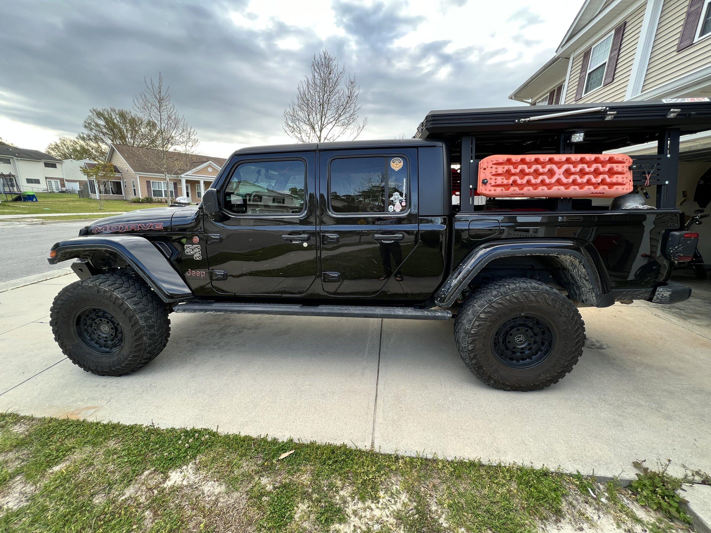

Well folks,
I think it’s time for me to regear from my 4.10 to either 4.88 or 5.13. The question I have is which gear ratio would y’all recommend & what brand? Also, another question I have is how much did y’all pay for it to be done? Or did y’all do it yourselves? A little about my truck before you answer!
4” lift, 37’s Yokohama Geolanders, black rhino wheels, rebel off road full rack, c02 20gal tank, a 79qt Iceco fridge w/ slider, a roofnest Falcon XL, rhino rack 270 awning (don’t buy this it’s trash), front Fab Four Steel stubby bumper, 12,000lbs cap winch, a tool box full of tools and recovery gear. So I weigh a lot. Thanks everyone!
