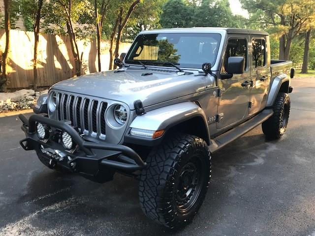

Kyle-I have the silver Overland here in Tulsa that I am looking to regear to 4.88 as well. Who are you using to install gears? Would love to connect some time. Scott
