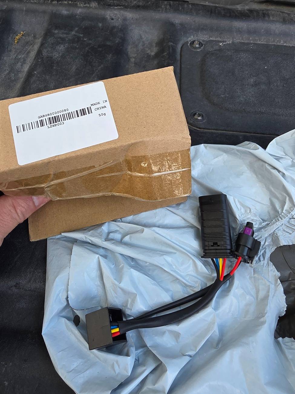

Just got the Jeep back from the dealership who replaced it under warranty.
Of course it still cost me over $500 to do the 30K service. Would do the service myself if my knee and lower back weren't so Fd up.
Complete knee replacement in May and as soon as recovered from that I have to have another spine fusion---this one L5-S1....
Stinggrey 21 Rubi
Brian
Sep 29, 2022
61
74
Usa
21 JT, 1998 ram 12 valve
Bum
20$ ebay, about to install and test.
Dealer is last resort for me.
