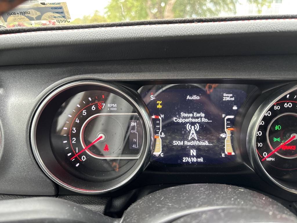

ISSUE! Rear Axle Lock Indicator
WILDHOBO
Sep 24, 2021
73
11,682
17,782
2021 Gladiator Rubicon
Network Engineer
Any time. The sensors fail when their seal fails and they get filled with gear lube. There was gear lube in the external connector on mine. I just cleaned it out and connected the tazer fix I linked. That was a year ago. Not a single issue since.
Verne
Oct 25, 2021
203
297
Ohio
2021 Jeep Gladiator Mojave
I don’t have to clear any codes, do I? Or will the plug and play automatically clear anything?
WILDHOBO
Sep 24, 2021
73
11,682
17,782
Network Engineer
It’s not a persistent code. Same warning occurs if you just unplug your locker sensor. As soon as you have the inline fix in place, it’ll go away. Nothing to clear.
Verne
Oct 25, 2021
203
297
Ohio
Got the part today. Mine didn't come in any type of fancy protective box. It was in plastic and then inside of a padded envelope. That worried me a bit but product looked fine. Installed in under 30 seconds. Took me longer to put on two zip ties, lol. My sensor goes off once the truck has been at highway speeds (gears are warm) so I cannot tell if it worked, but will know shortly. Thanks for the advice. I hope this fix lasts a while.
