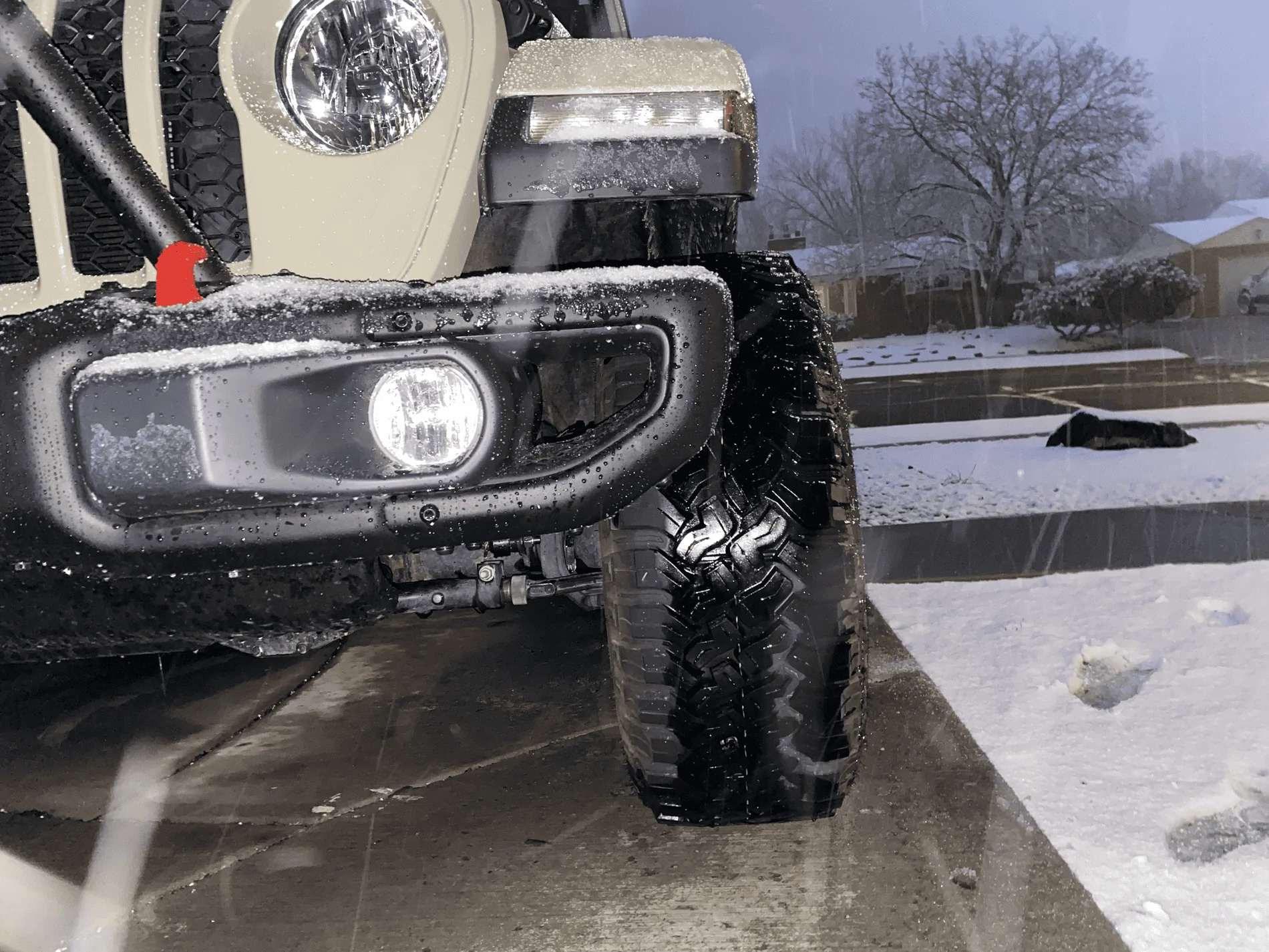

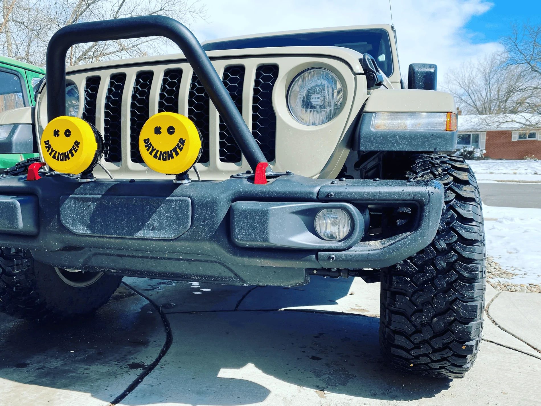

I have 3.73 at 6,100 feet. I adjusted with a tazer, added a rubicon suspension for $200 and added JKS quick disconnects.
I may eventually go to 35s, but I am very happy with the current ride height. See before and after.
