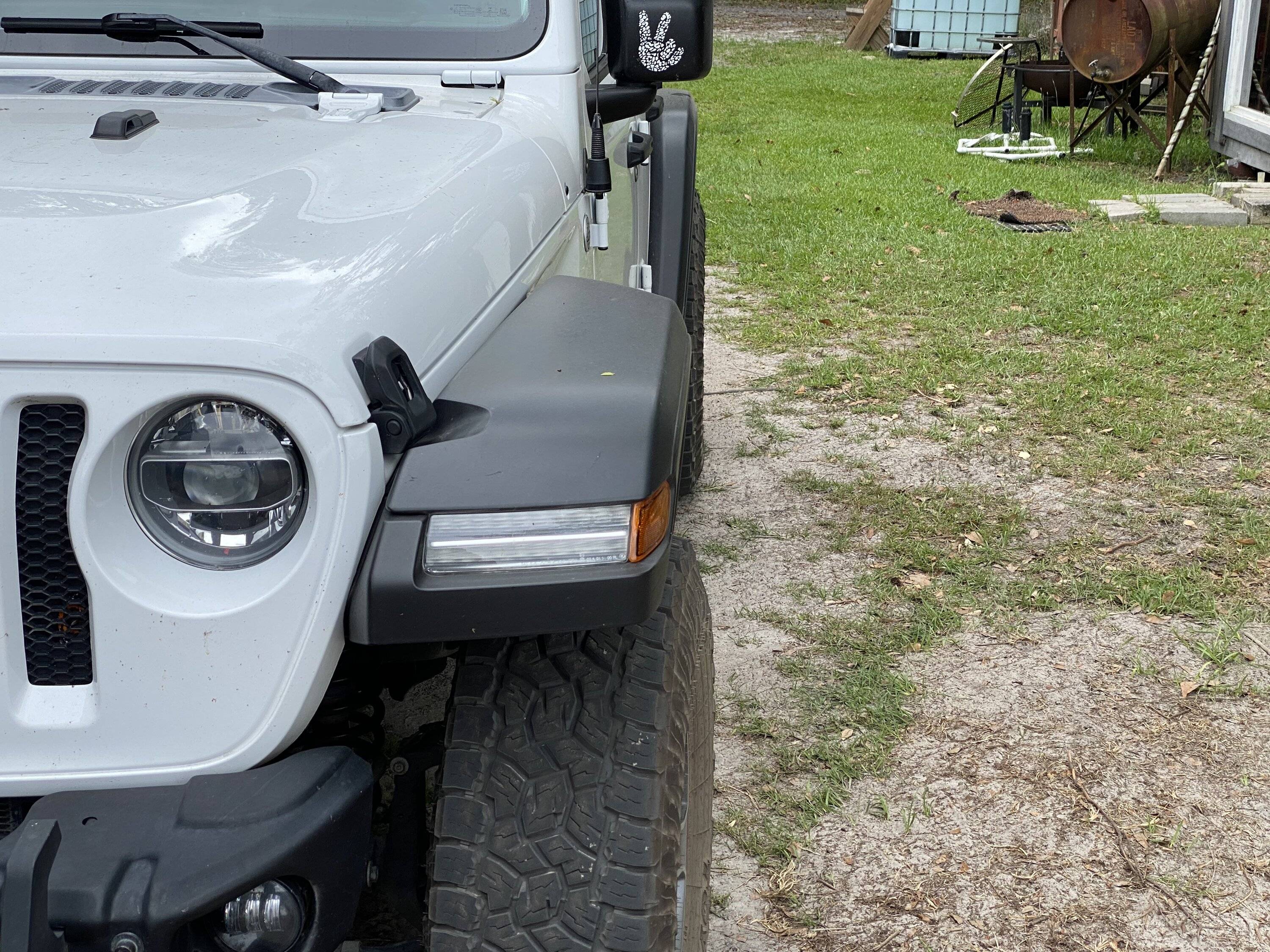

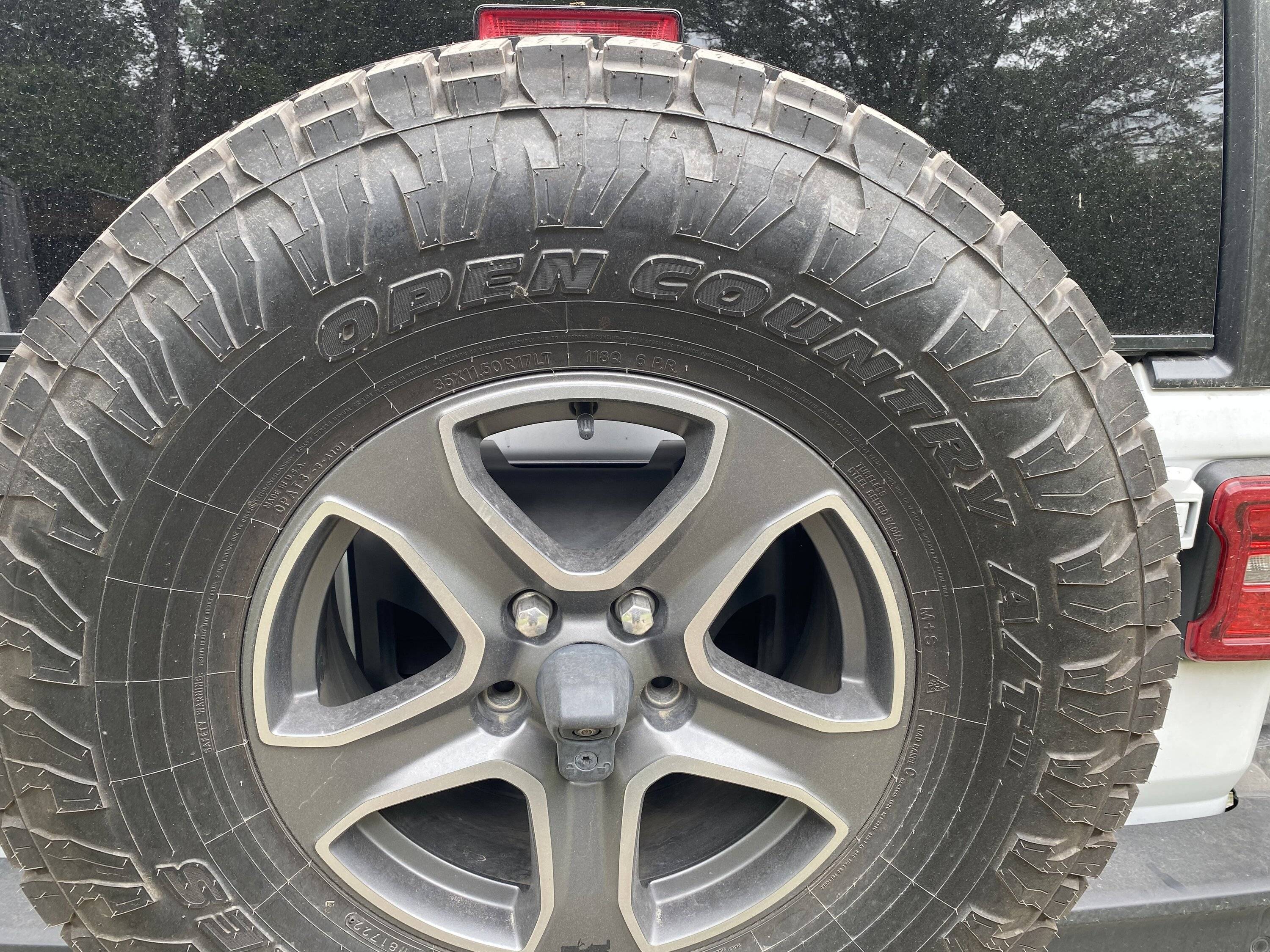

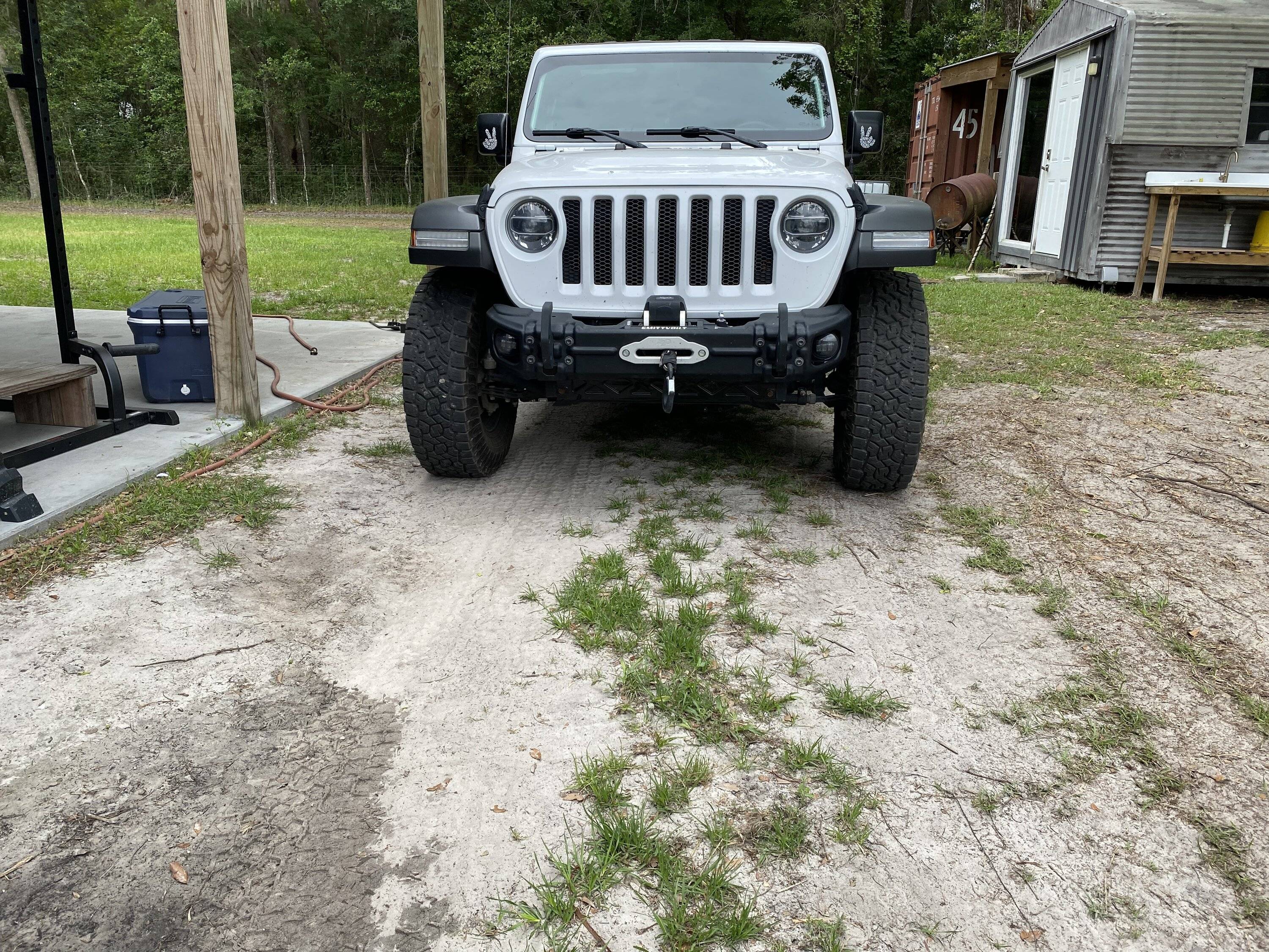

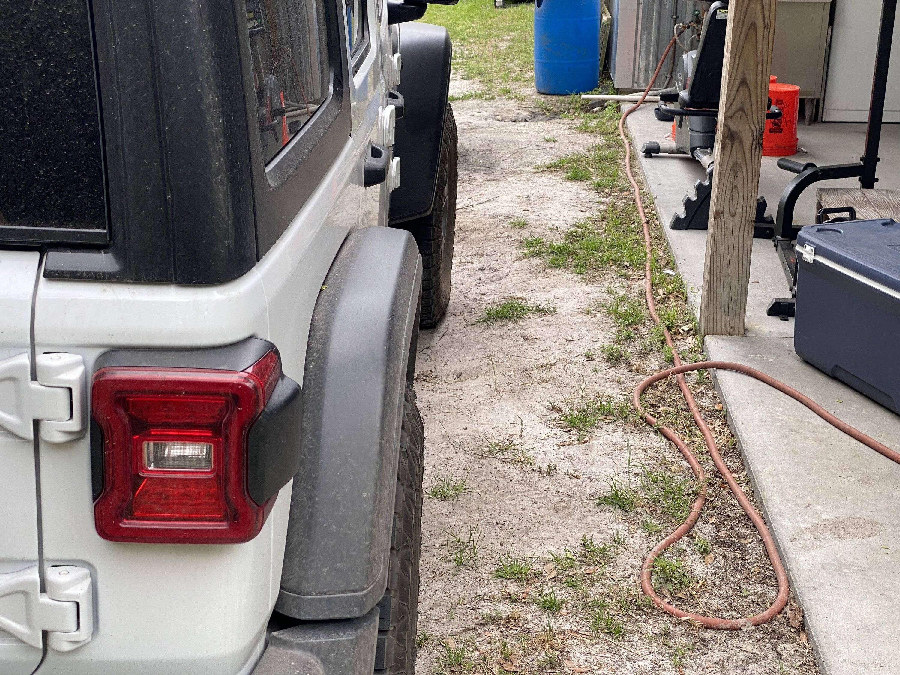

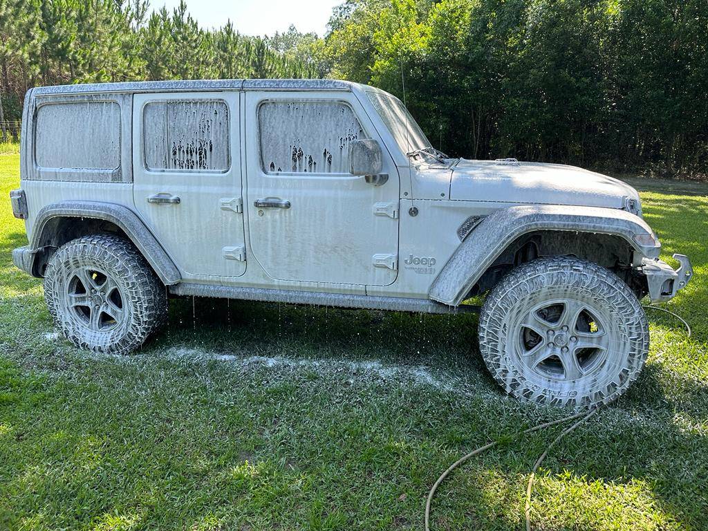

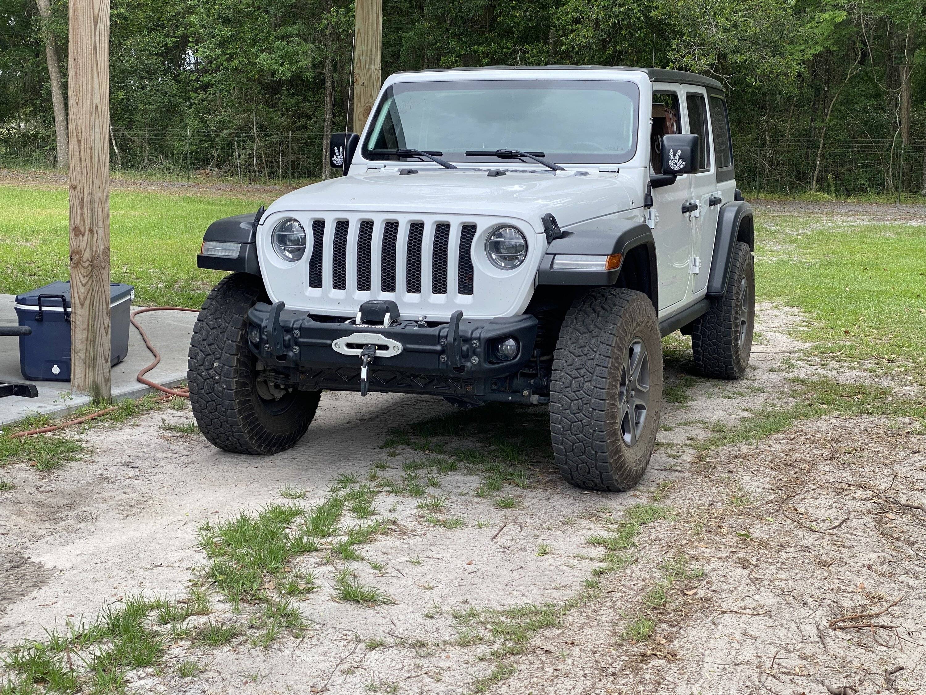

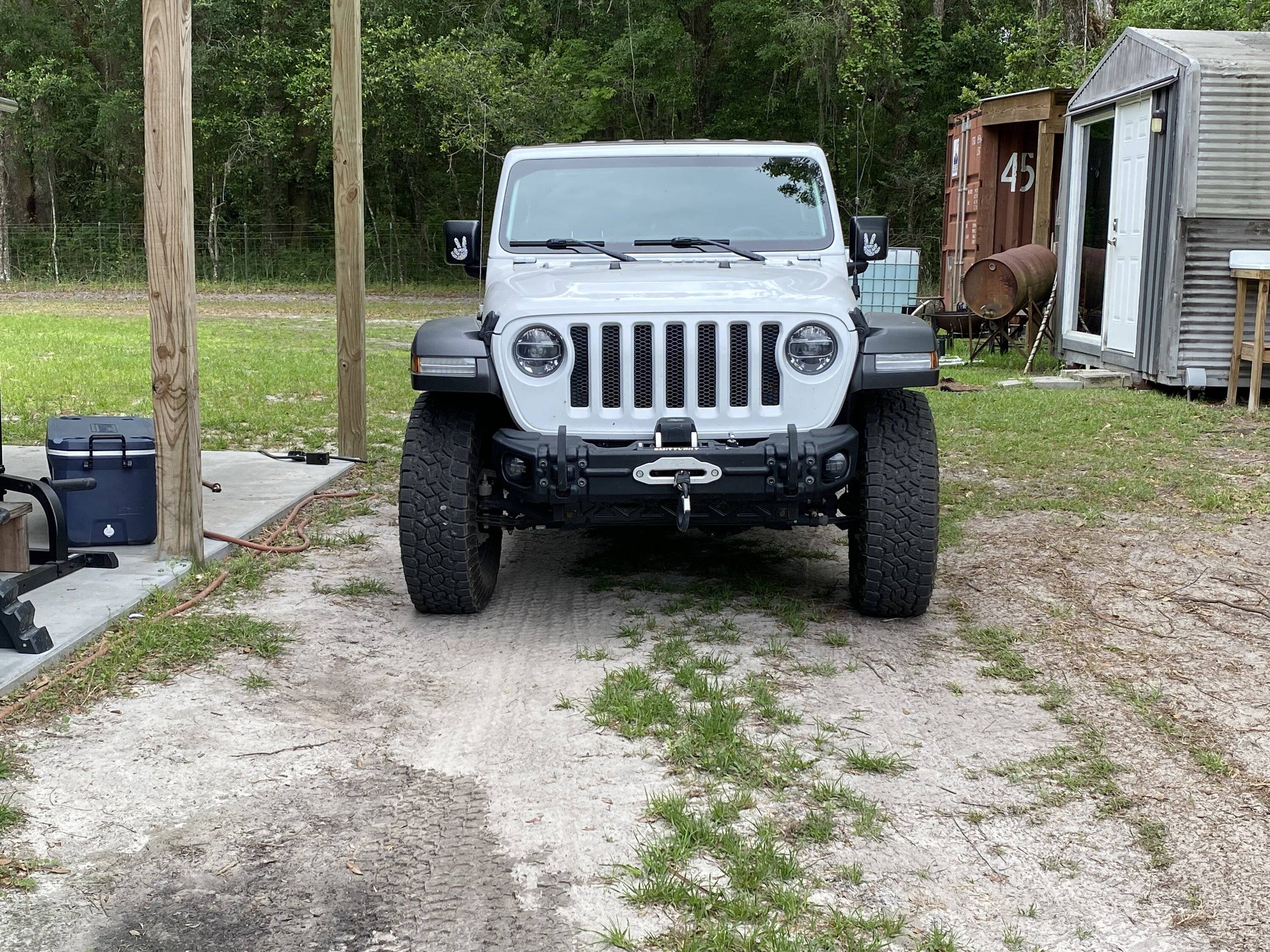

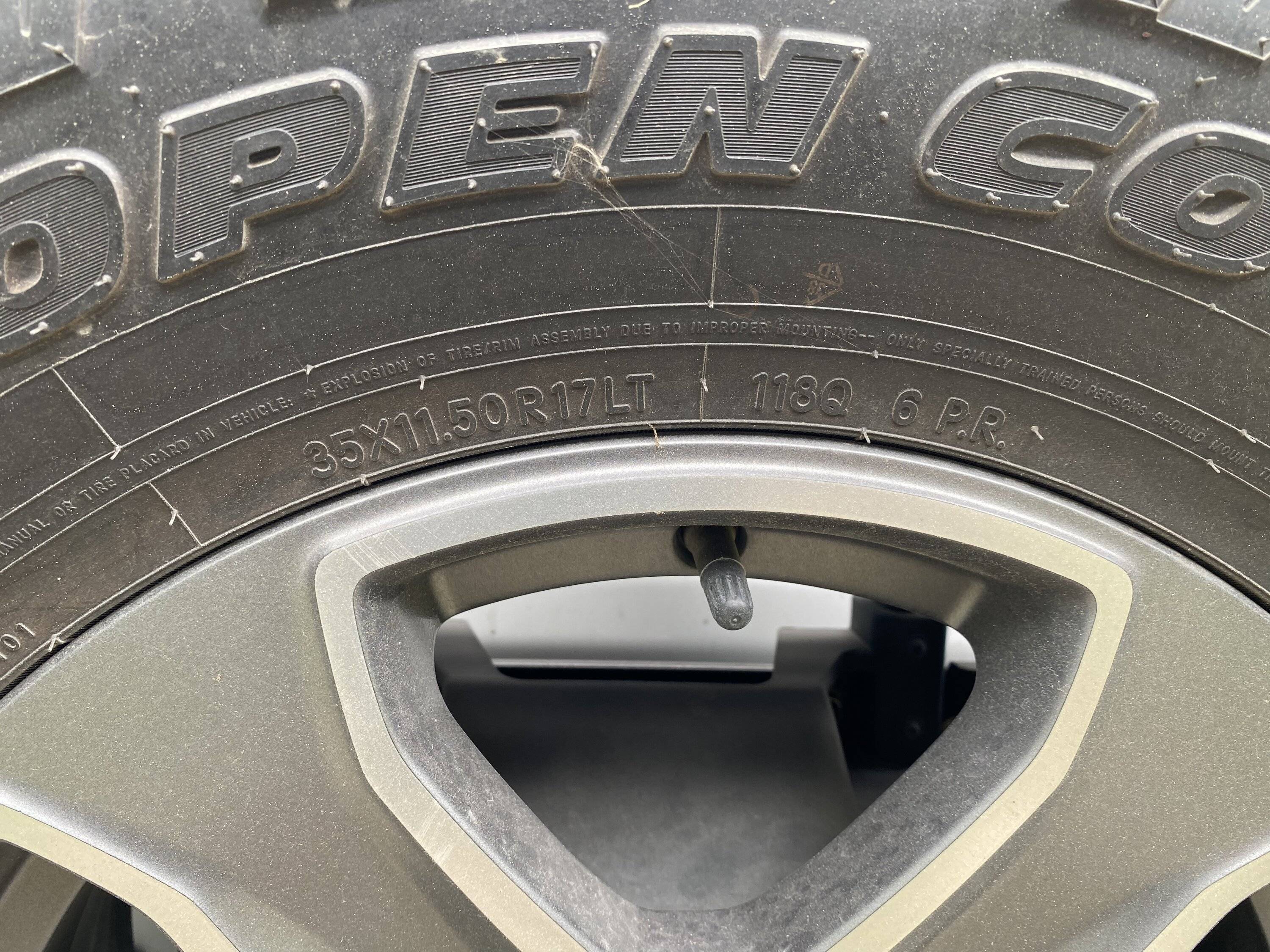

A buddy of mine has a 2018 JL Sport. He got a Take-Off Diesel JL suspension. Additionally, he picked up JL High-Line fenders, which actually do more to provide tire clearance, from FB marketplace. He installed Toyo 35x11.5r17 tires and it works like a charm. He has an Arcus steel bumper with winch and says it's never ridden better. He doesn't have the wider axles and ended up using wheel spacers. I'll edit with photos.
