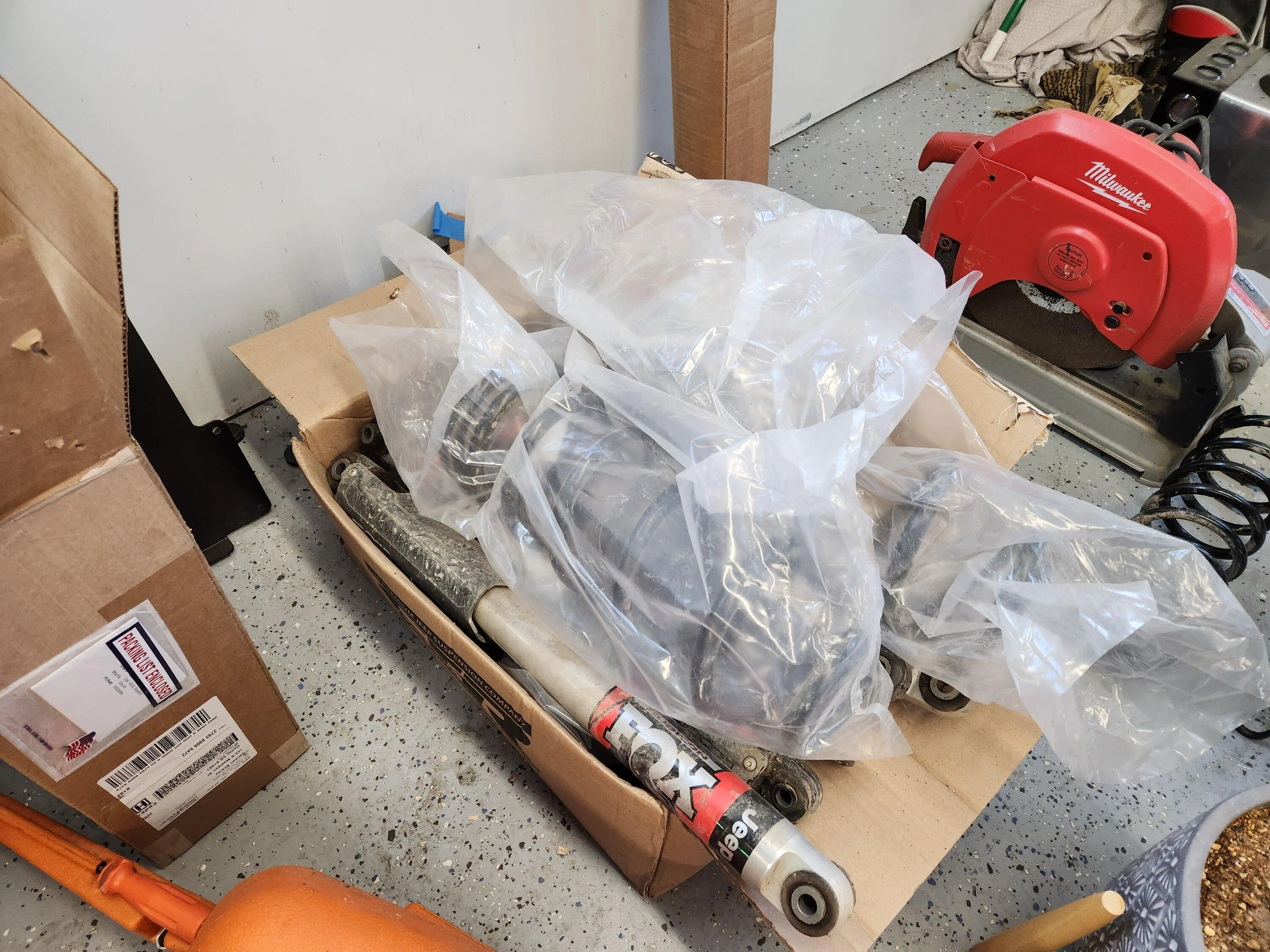

Are you looking for Rubi Diesel takeoffs? I have everything in a box sitting in my garage. Its has about 4500 miles on it.
Jeep Gladiator Willys suspension vs Rubicon suspension 20221111_104221
Maybe….. where are you and what’s your price?
