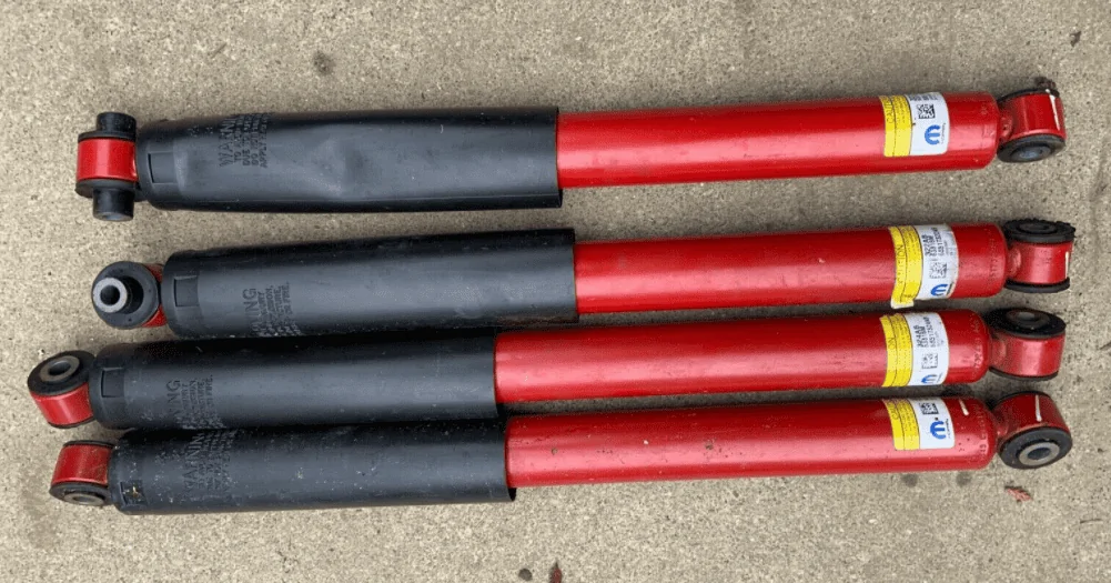

My 2021 Willys gasser was delivered with steel body red shocks with the black plastic strut shaft tops. They look like the same style the JL's would get.
40,496
54,011

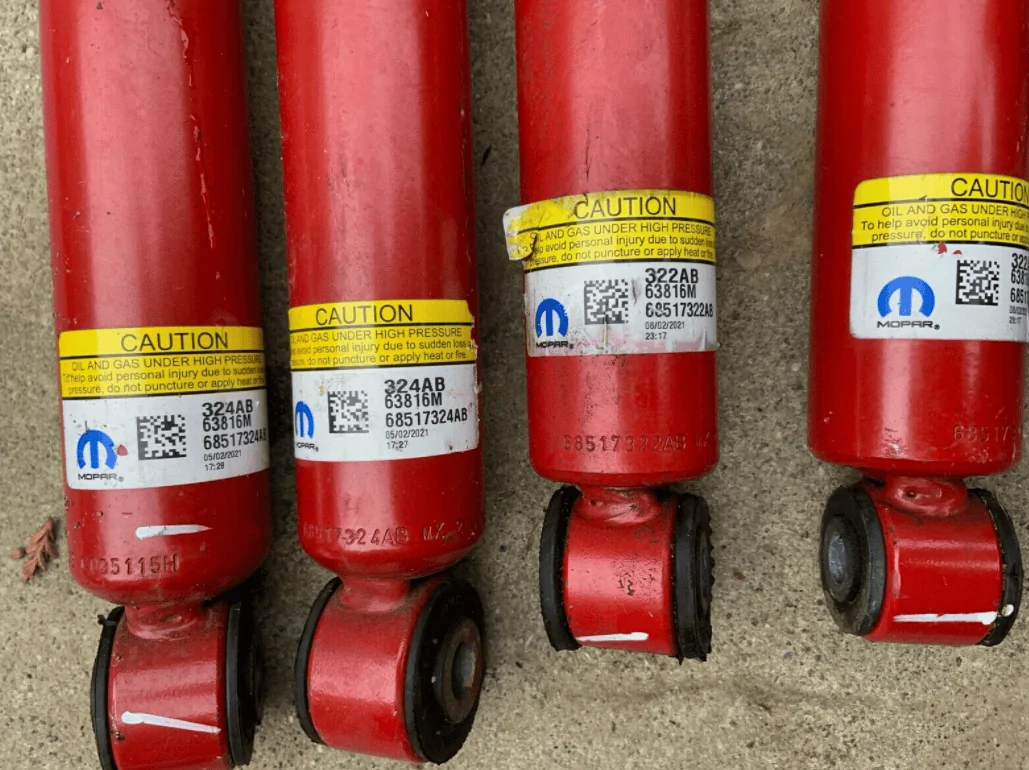

Gladiator Willys shocks - low miles take-offs -
Jeep Gladiator Willys suspension vs Rubicon suspension 1644550634899
Jeep Gladiator Willys suspension vs Rubicon suspension 1644550660160

Mine are red. From what i've read all the red accent shocks are the same from mopar. (in terms of jeeps) and the JL Rubis come with Red Accent shocks.

I just checked under the truck, this is exactly what I have.
I was led to believe we got the Fox too, seen it on this forum. I apologize
From what I have seen, the false assertion of the Gladiator getting the Rubicon Fox shocks was by people early on when the Gladiator Willys model was first announced. They made the assumption that since the Wrangler Willys JL got the JL Rubicon shocks which is like these red steel body shocks, the Gladiator JT Willys would get the Gladiator Rubicon Fox shocks.
