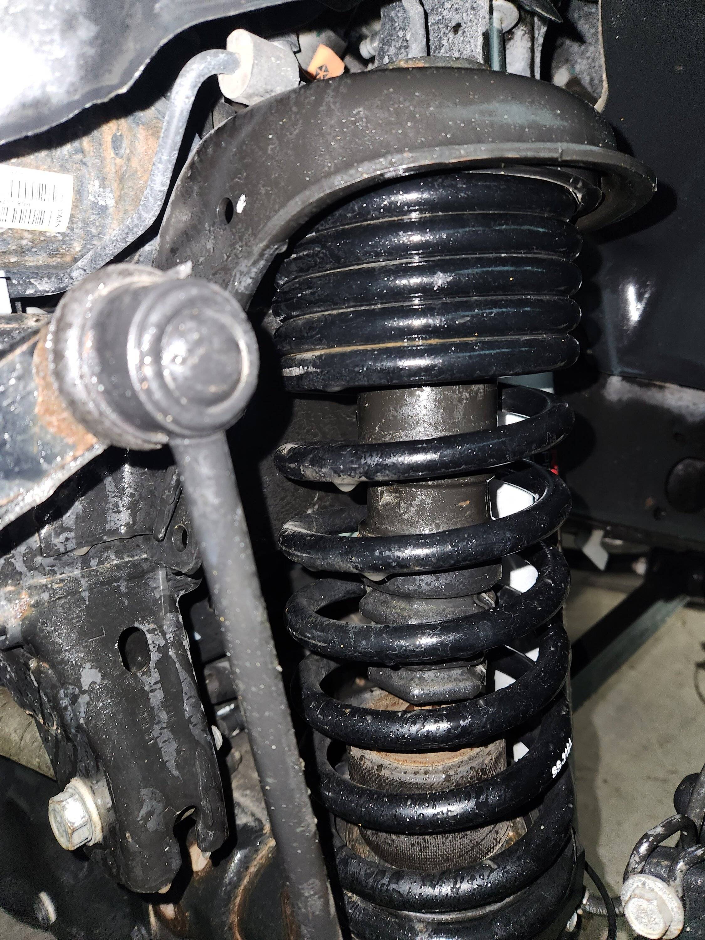

I took a picture of my front left bump stop as it sits right now. Pretty sure the tube is longer

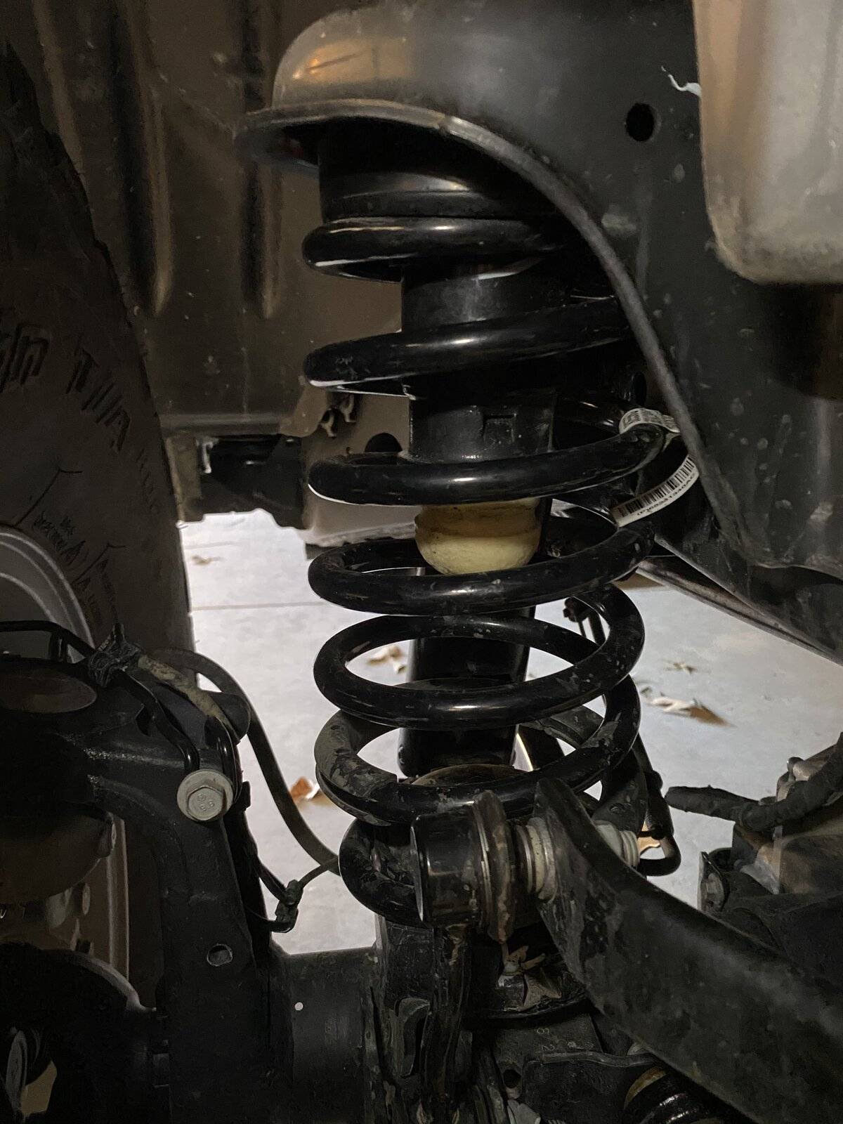

Looking at this pictures, id say they are much shorter on the 3.6
Is the top pic the gas or diesel ? If diesel, which model ?
Im not sure about length so I can't answer your question, but on my JTRD, my bumps look like your second pic.

The top picture is the diesel, the bottom one seems shorter.
Will measure that next week when i'll install the 1" spacers.

The tube is longer on the diesel, you will have less up travel.
I believe it’s about 1 1/4 inches longer. Same on the 392 JL I’ve heard.
diesel springs will have different rates as well.
I run shorter bumps, and a small spacer on my Mopar lift with 35” tires.
