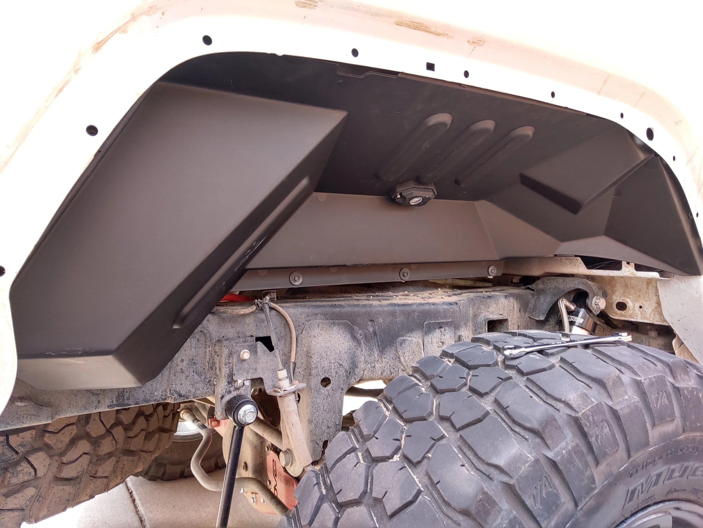

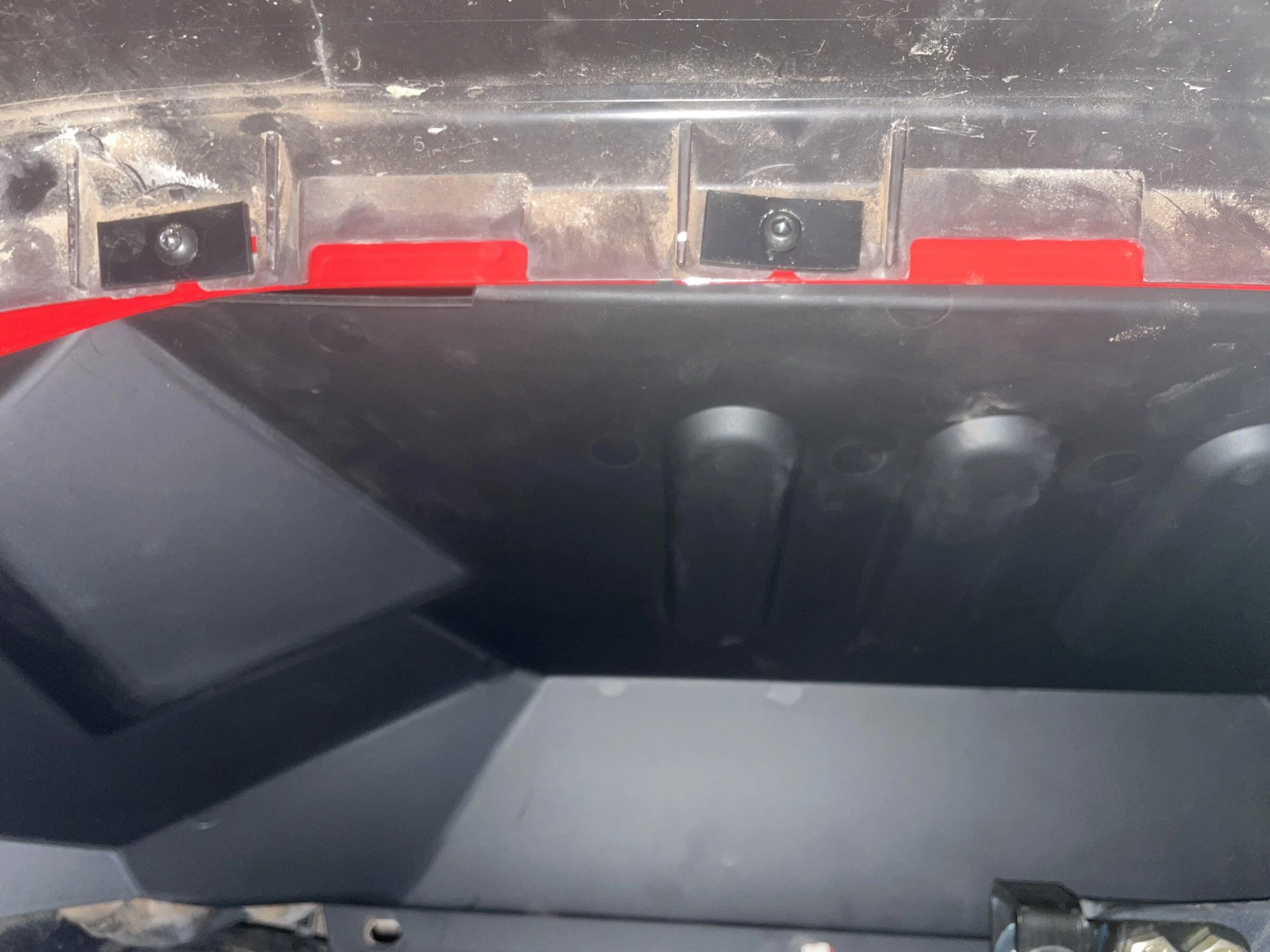

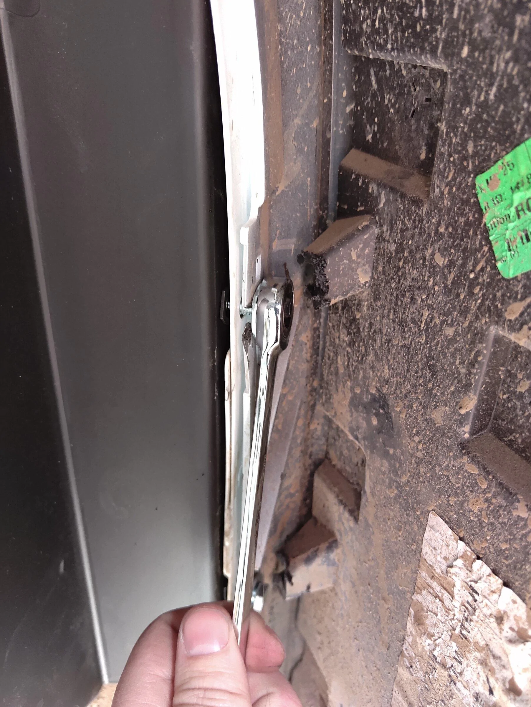

Joined the club today. Have had these sitting in the garage for a while now, finally got around to installing. I went and made some changes, because I am clinically incapable of not screwing with things, but they worked out well.

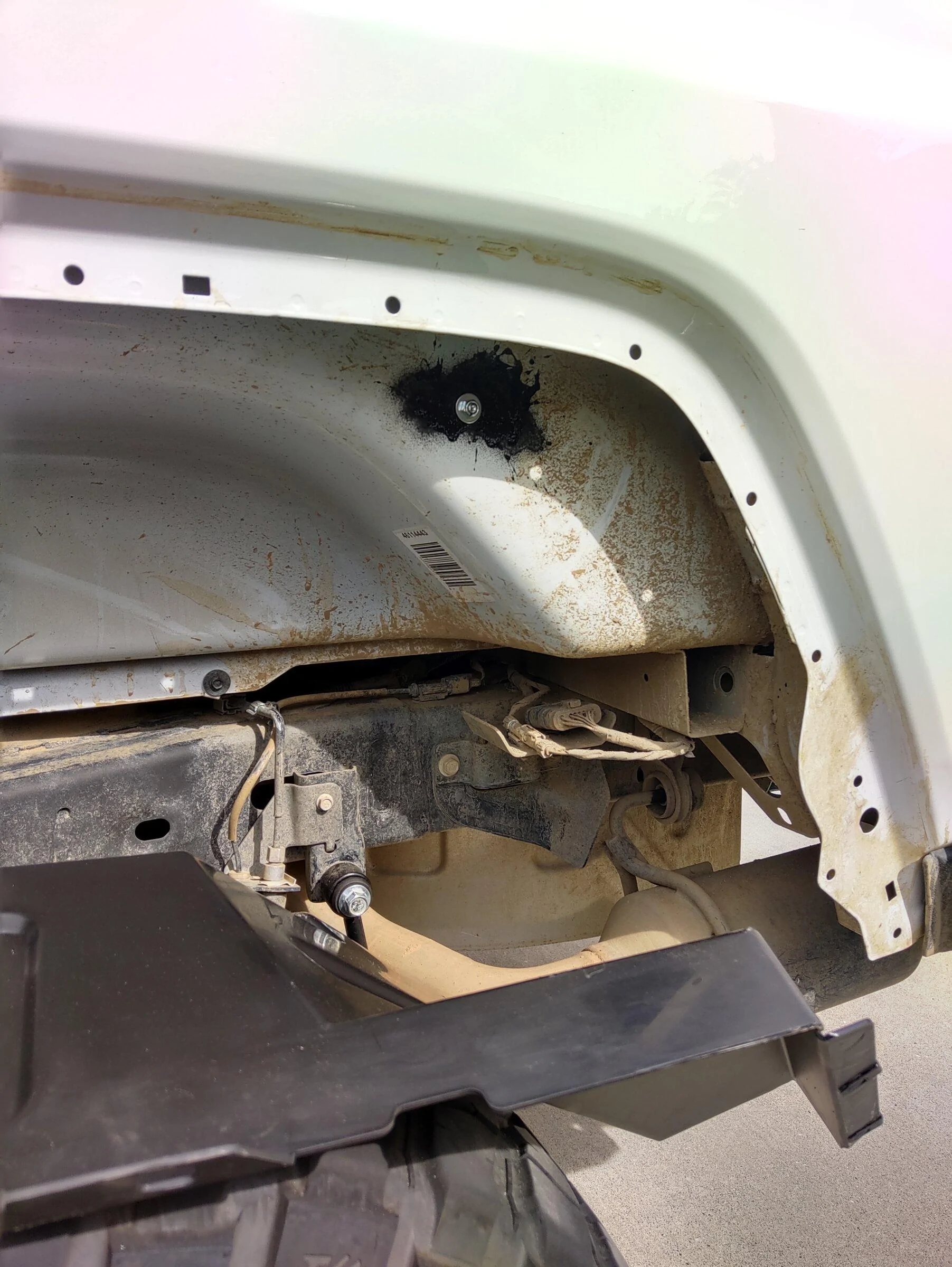

1) On test fit, I actually didnt have to move the charcoal canister for the drivers side to fit, BUT I did have to screw with my bedside molle panel - One of the rivnuts from the Rough Country bedside molle panel was sticking out too far for the Rugged Ridge liner to fit properly. Of course, the button head fastener provided by RC stripped out when I tried to remove it, but thats my own fault for not replacing them before I installed the molle panel (MOMMA SAID BUTTON HEADS IS THE DEVIL).
I ended up hacking off the rivnut and then running a shorter M6 (16mm, if anyone cares) through the existing hole with a locknut and that cleared the liner just fine. I rattled canned it as I mucked up the paint a bit grinding & cutting - I dont want to make anyone uncomfortable by showcasing my top notch painting skills, just eat your wheaties and youll be this good someday.
Jeep Gladiator Rugged Ridge rear inner fender liners IMG_20220226_111721242_HDR
2) I replaced the button head fasteners with hex heads because the only thing worse than commies is button heads.

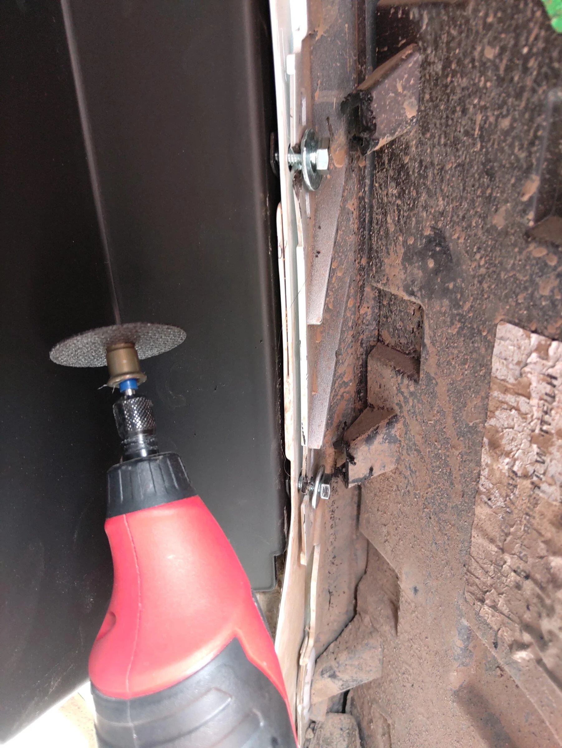

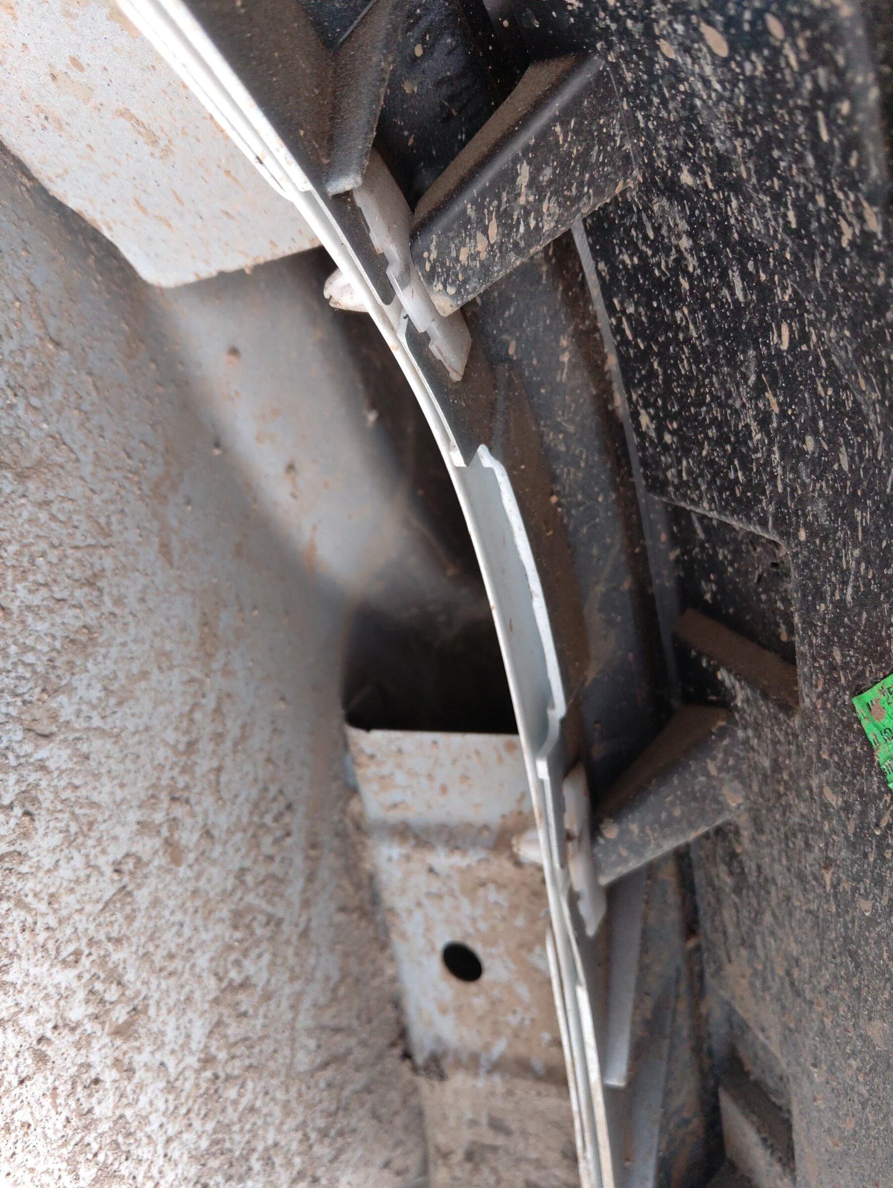

3) I didnt want to remove the OEM outer fender braces / inner piece so I hacked off a few of the flanges to allow for fasteners to be secured.
Jeep Gladiator Rugged Ridge rear inner fender liners IMG_20220226_090032668
Jeep Gladiator Rugged Ridge rear inner fender liners IMG_20220226_112625306
Jeep Gladiator Rugged Ridge rear inner fender liners IMG_20220226_113055097

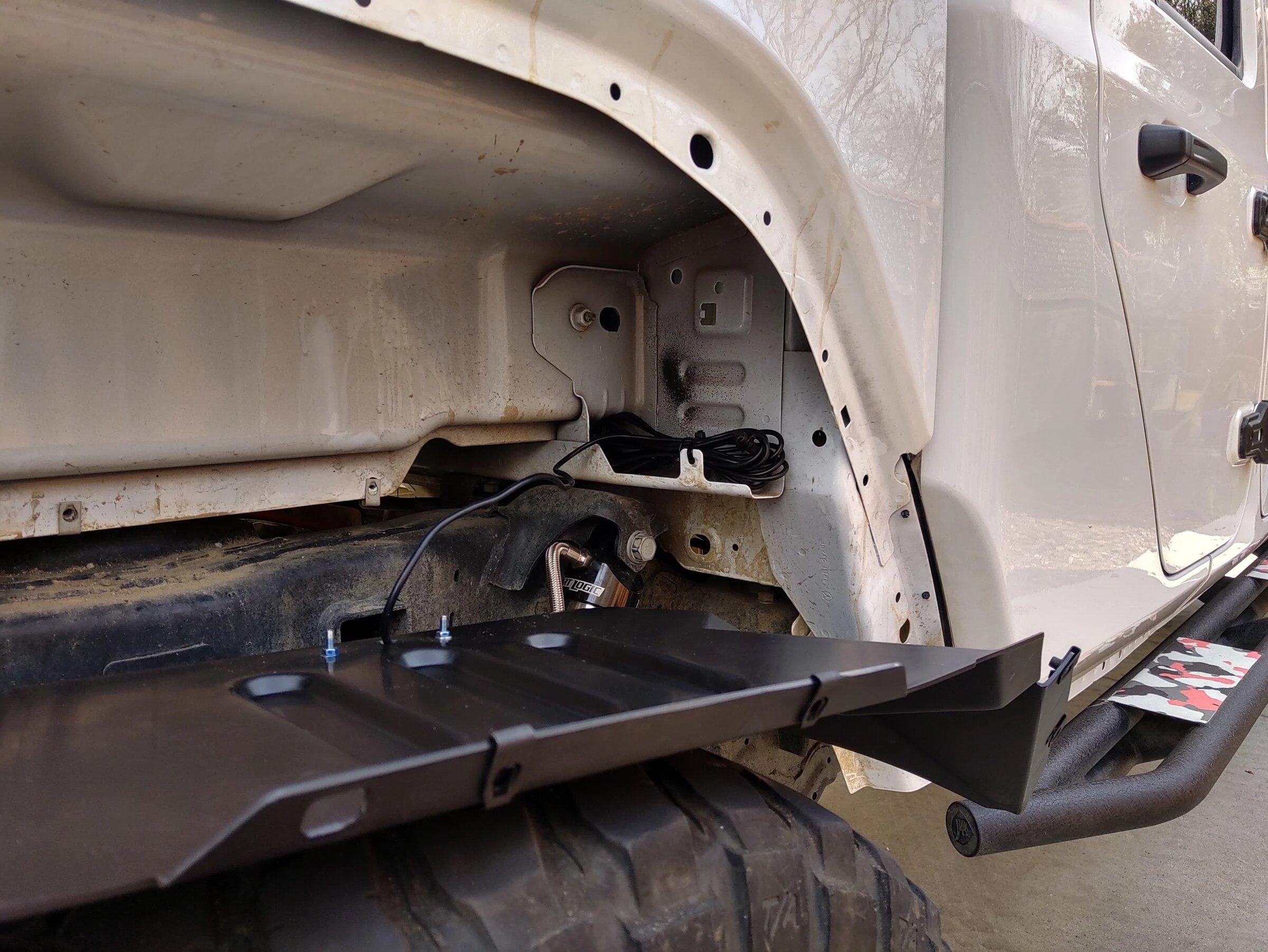

Lastly, I installed my rock lights to the fenders before I installed them, so I wouldnt have to yank them out again later. I dont have time this weekend to do the full install on the lights, so I sealed the business end of the harness with heat shrink and tucked / zip tied them in a spot that keeps them behind the fender but can be accessed without a headache.

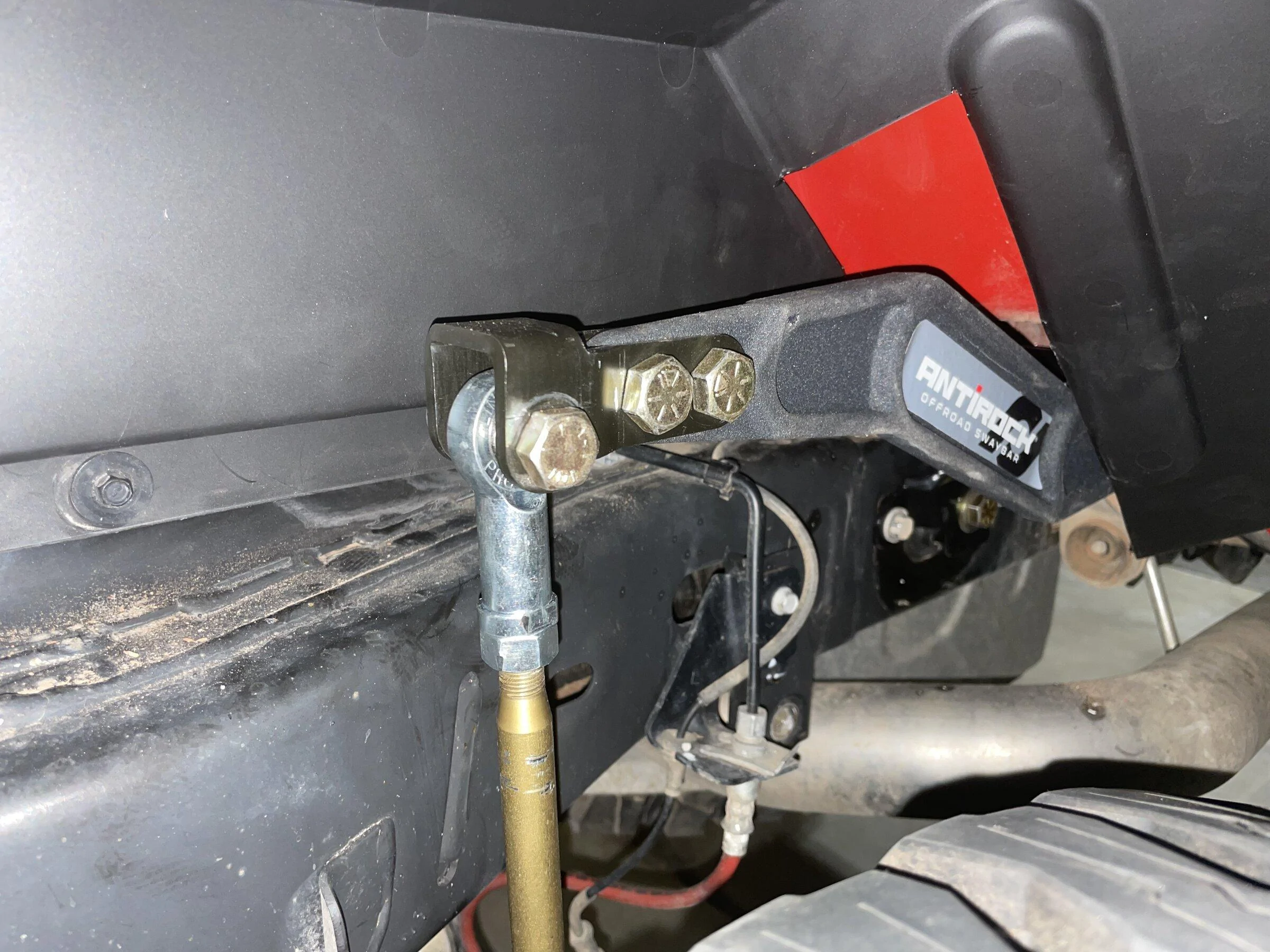

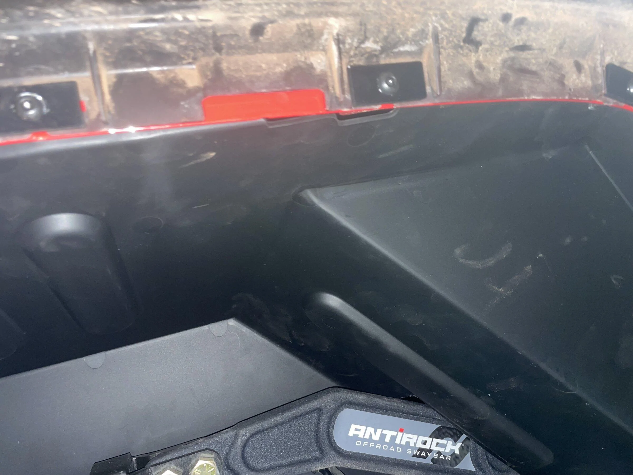

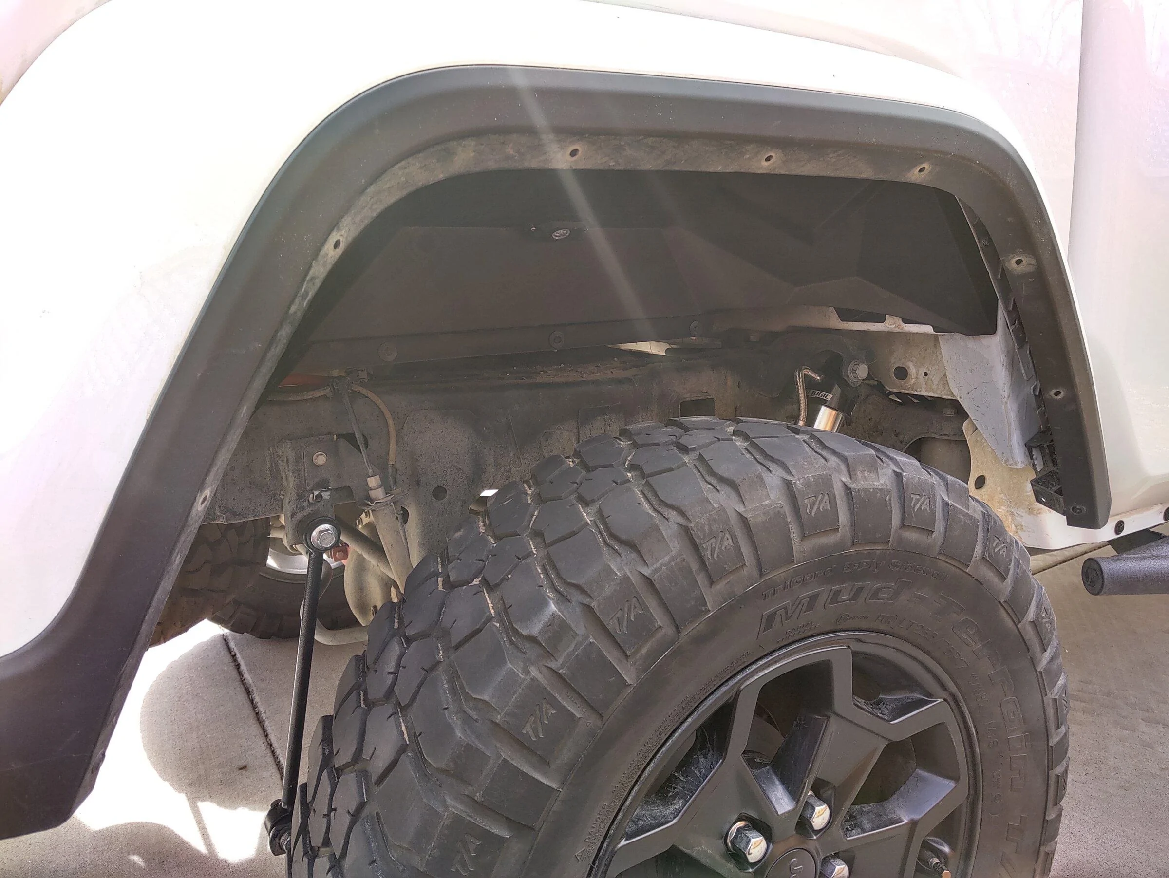

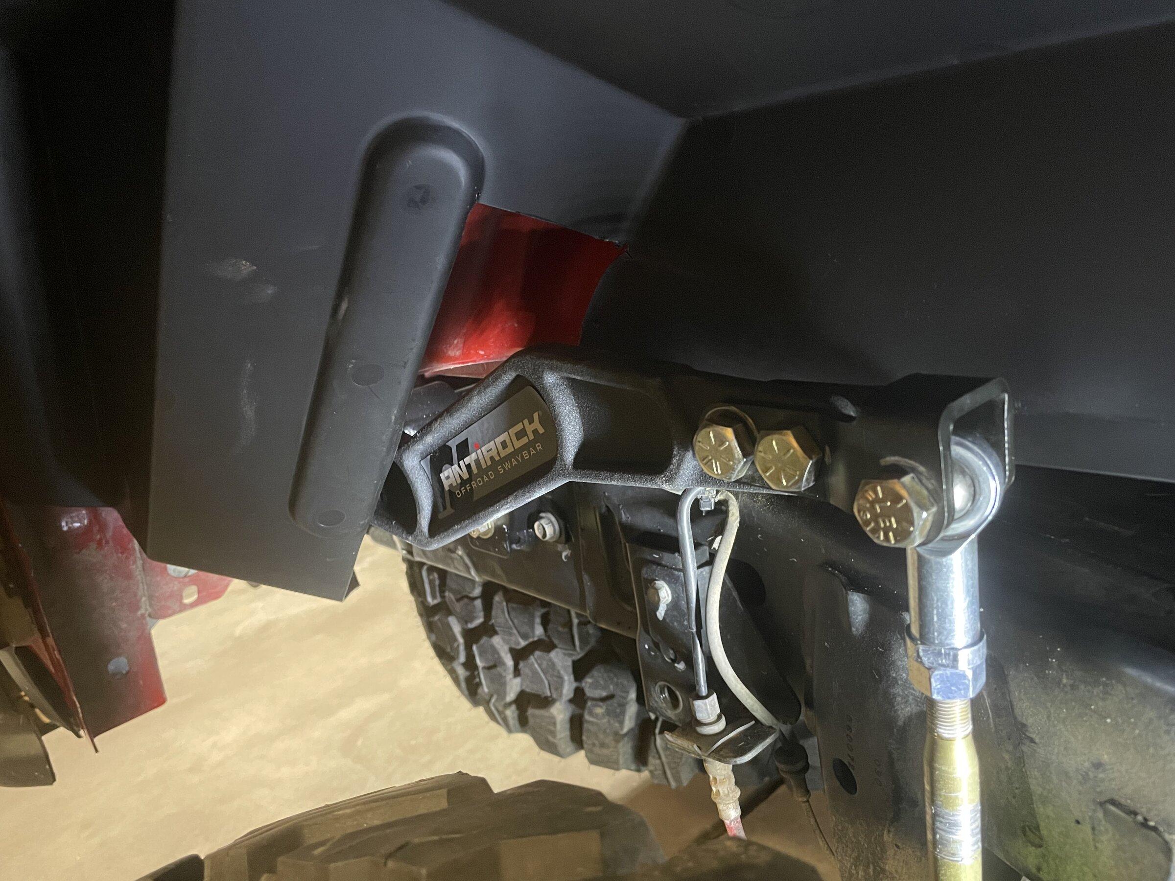

Got my rear liners in… definitely solid pieces. Had to do a little chopping for my rear antirock but they are holding up super nice.
Ps I know bad pictures.
Jeep Gladiator Rugged Ridge rear inner fender liners 523C9FF3-4E2C-40C5-B179-3DA2F97AE94D
Jeep Gladiator Rugged Ridge rear inner fender liners 732F78DB-5A7C-429C-BDC7-4BB19D80DA4E
Jeep Gladiator Rugged Ridge rear inner fender liners A1A519D9-79F4-4BB7-9804-F14C0BEA2B4F
Jeep Gladiator Rugged Ridge rear inner fender liners B0086E68-8F6E-400E-B8C6-335F30CE4C12
