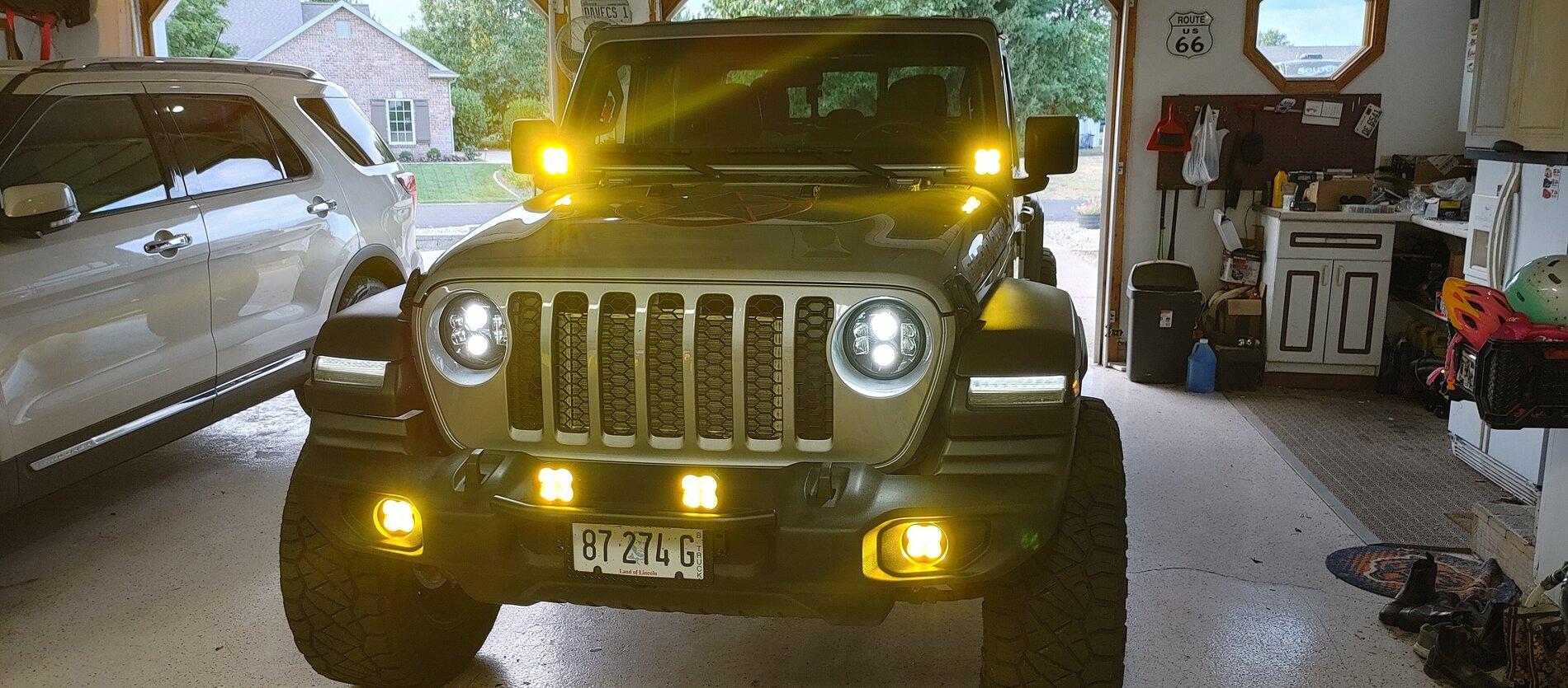

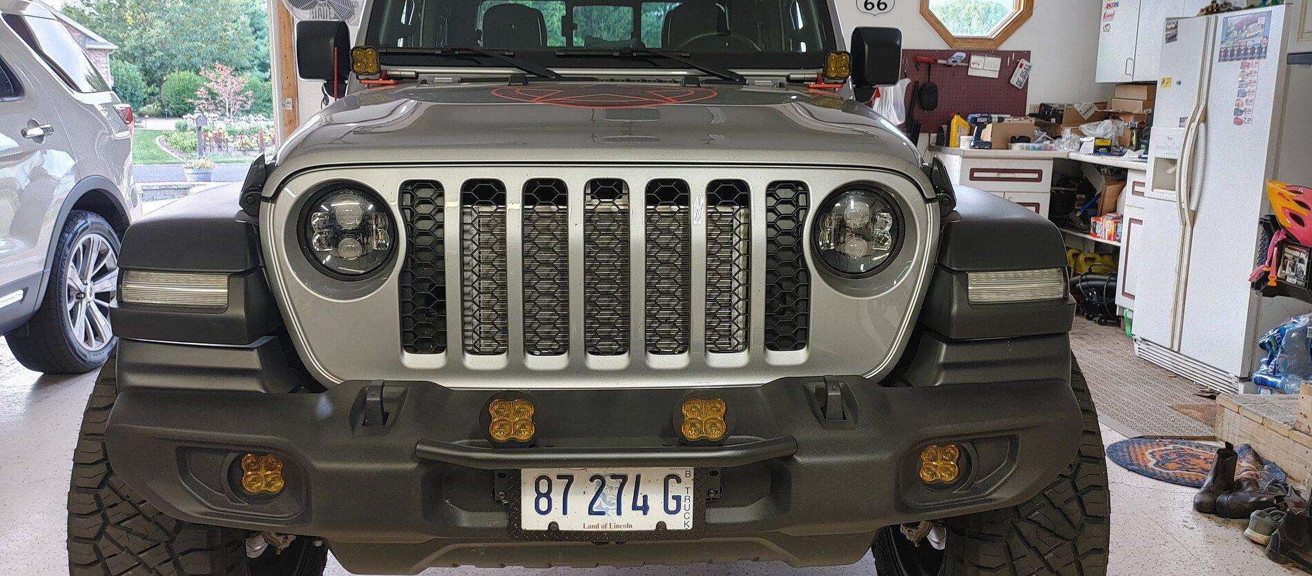

The stock location fog lights are the DD Pros and the rest are the sports. The pros are supposedly DOT approved but they are really bright! I have even aimed them mostly downward, but I still feel guilty using them in the city limits. I usually switch to the center driving lights, which are sports. Still a good amount of light without looking like the sun. All of them have aged Awesome, they still look like new after multiple off road trips and a full Midwest winter season on them. No moisture, nothing. On the back roads in inclement weather they are absolutely amazing and I do not want to drive anything else.

Whered you get those amber pods and mounting plate? I have a similar license plate mount but it sticks out ridiculously far..i like that yours almost rests on the bumper.

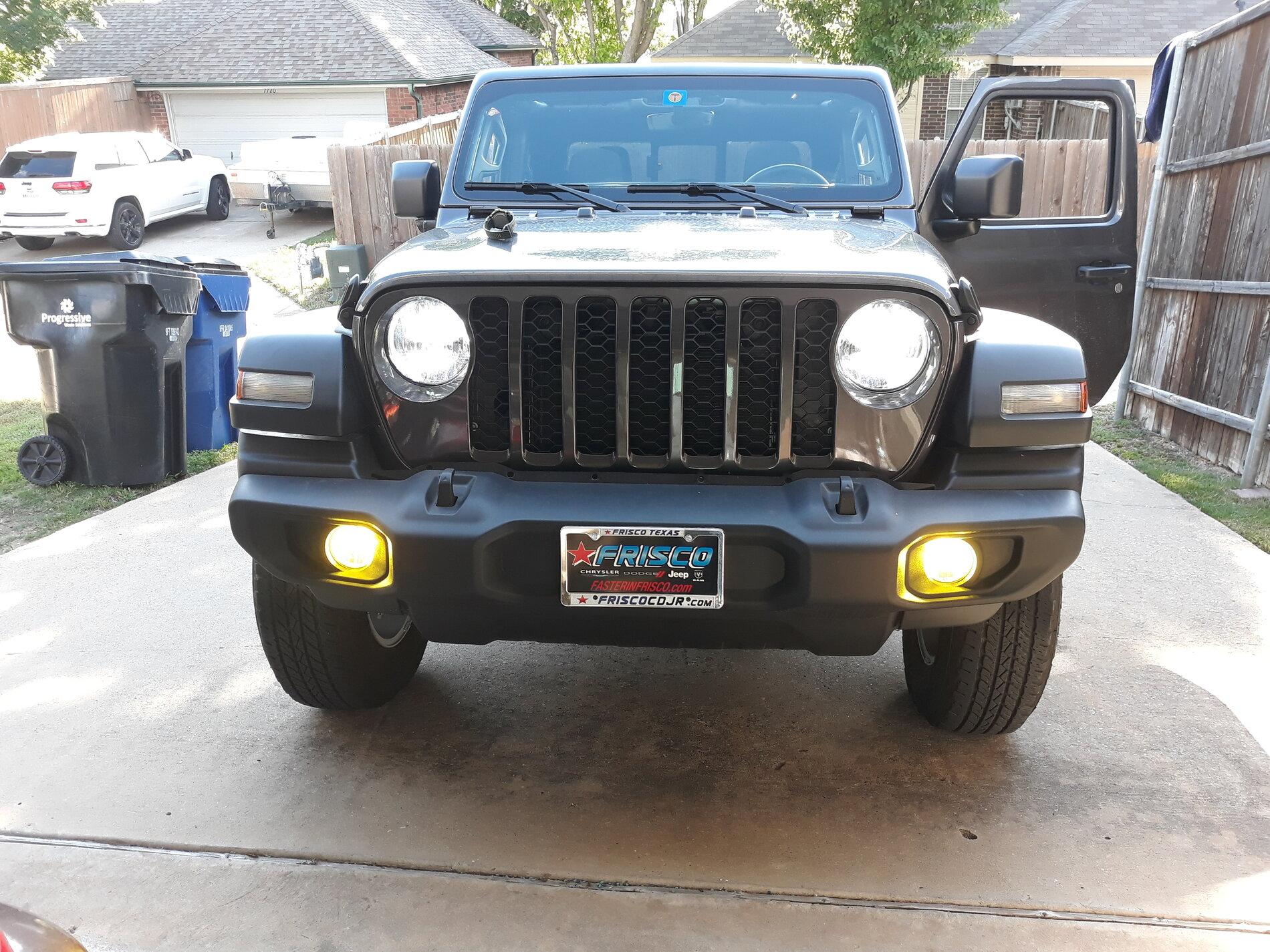

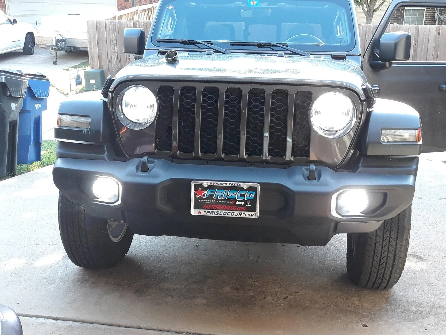

I replaced my halogen fogs with Lasfit switchback bulbs and I really like them. You can go either white light, or amber light, I haven't had an occasion to use them but I'm sure there will be some reason to soon.
The plate is off Amazon. I drilled outmy bumper and used clip nuts. The ambers are Diode Dynamic SS3 sport lights. I got the driving patern to add contrastto my LED head lights. They match up well. In the winter when the headlights freeze over I can still drive on my ambers.
