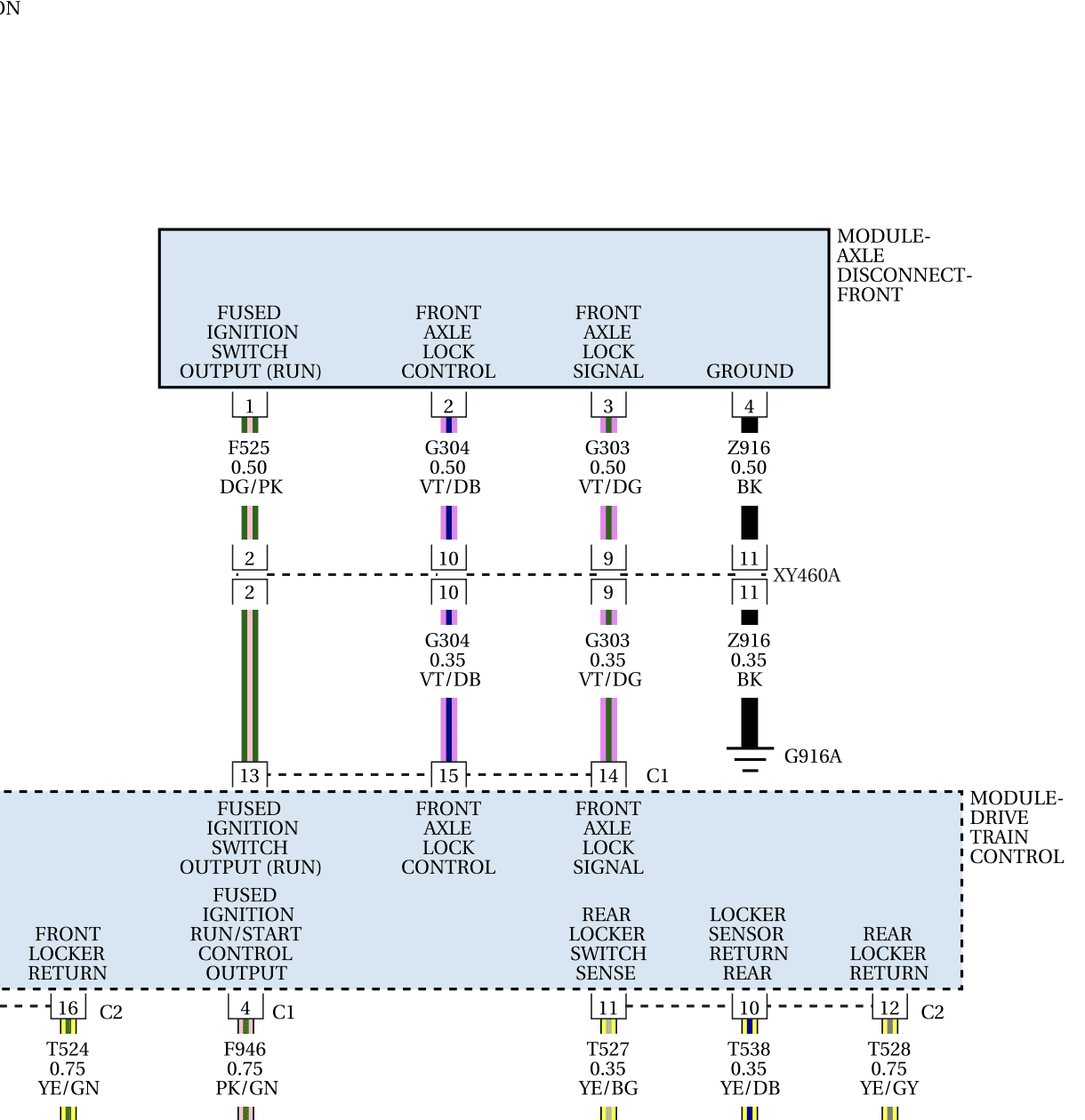

OK thanks for confirming the spring return. That sucks.
I did say I don't want any aftermarket solutions, I want to keep my truck bone stock and just have some sort of a band-aid in case I have to deal with this for an extended period of time.
That said, I did find conflicting accounts that the FAD is either spring return or power-driven each way, I'm glad you confirmed that before I wasted my time on that. And if I'm going to go through the trouble of pulling the collar out of the axle, why wouldn't I just reinstall the parts that fix the problem for good, right? As I mentioned above, I also found conflicting reports about the pins in the FAD, one source says 12v to pin 2 closes it, another says grounding pin 2...obviously vastly different outcomes if I guess wrong. I suppose I could get under there with a meter and figure it out, maybe I'll give that a shot.
I'm starting to think maybe the best course of action here (obviously depending on what the dealer says next week) is to just fix it myself, which frankly is very upsetting, but I guess if you want things done right in a timely manner you just have to do them yourself. This'll be even harder to explain to my wife, who pushed me to get a new truck so she could start seeing me on weekends...sorry hon.
Thanks everyone for your input, I appreciate it.
D
Just be aware of several things:
  • There is more than 2 wires going to the fad. It not only energizes and slides the coupler, but also has confirmation sensors.
  • There have been some cases of the plastic bushing in the end of the inner shaft causing problems rather than the actuator being the real problem. If that’s the case, you may have to replace the inner shaft rather than work on the actuator.
  • The actuator can be removed from the axle housing, but the actuator itself is sealed. Manipulating that will likely void any warranty on the part.
Already aware of all of the above. My suggestion to the dealer was to order an intermediate shaft kit,which includes the shaft, collar and bushing. No plans on even removing the actuator from the axle, unless I'm going to complete the entire repair myself.

OP…did you ever get this fixed? I had a similar experience, and the issue is a worn plastic bushing between the two piece axle shaft in the FAD. It allows the shaft to slip and slightly engage, causing a howling noise. There is a Star Bulletin on this issue and Jeep will fix. I recently had mine repaired and now my FAD won’t engage at all…think the FAD module may have shorted. Taking it back. However the howling noise is gone.
Yeah, had to buy the parts and fixed it myself, but it's been good for over 40,000 miles since.
Was it the plastic bushing like mine, or something else? I can’t get my front tire to spin in 4wd. I think my FAD module is bad?

Military
The kit comes with a bunch of parts, a stub axle, bearing, the plastic bushing as I recall. I replaced everything that came in the kit and haven't had the noise return since. I've never had a problem with anything not working, just that horrible grinding noise. It should be fairly easy to troubleshoot, you can pop the FAD off and just let it hang by the wire and see if the fork moves when you put it in 4wd. Maybe when you had it apart you didn't get the fork back in the groove on the collar?
yep..this is what the dealership replaced. Taking it back tomorrow...
