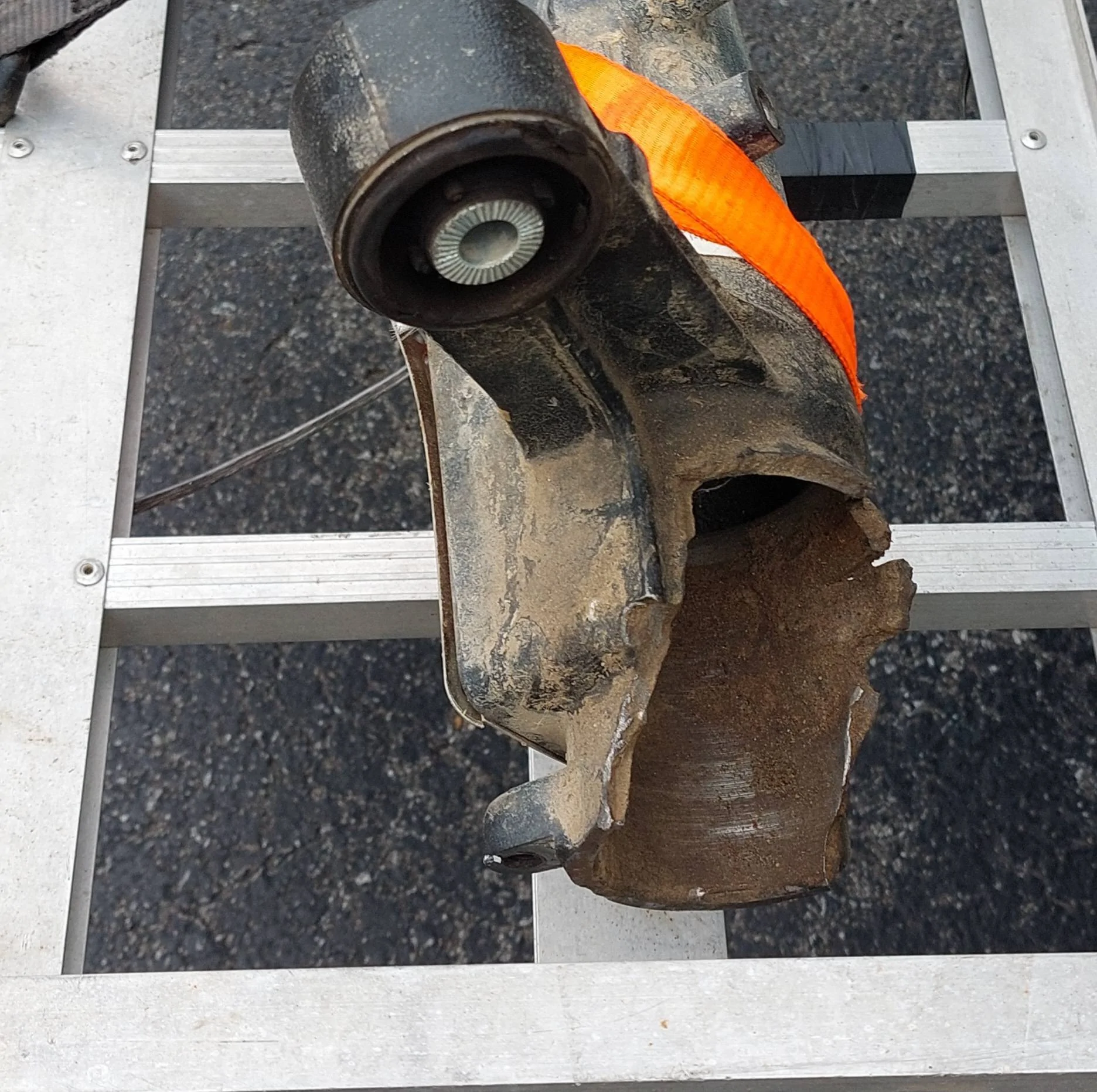

The Rubicon front locker I got was due to 40" tires and snapping front axle at the FAD. :like:
@Blade1668, the shaft snapped or the tube? Any pics? Haven't heard of that specific failure yet.

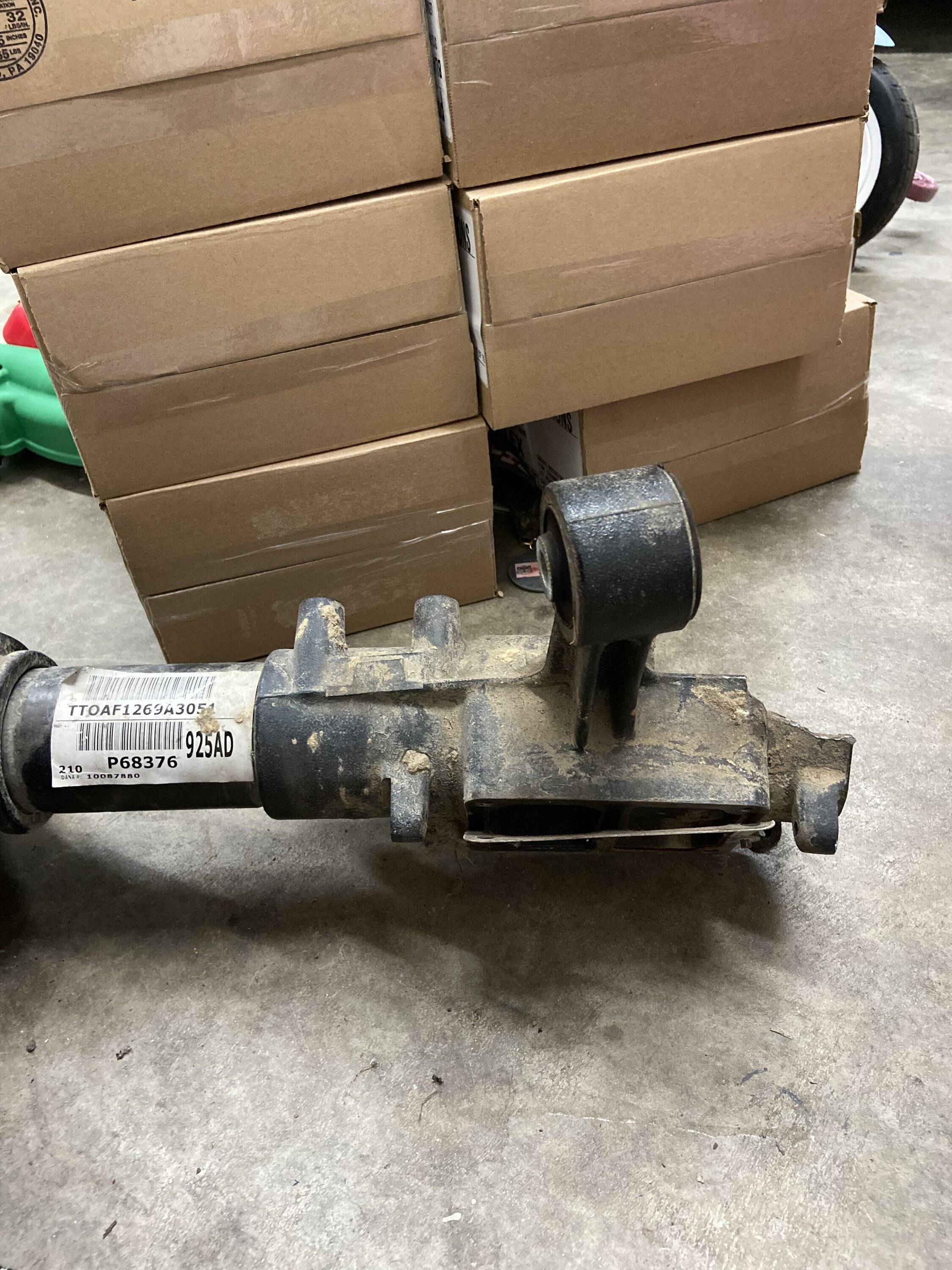

Snapp8at the "FAD" or formerly know as "CAD" on XJ's, MJ's.

FYI: I bought it for the Rubicon locker, from someone who was/ is a member here.

@Blade1668, and others…I gotta ask your opinion: would the tube have snapped at the FAD on 40s if it was trussed?
In the case of the one I got a truss wouldn't have helped, it was a JLUR with close to that size of tires. The P.O. hit a ditch or something with some speed or something on that line. After it was fixed it was traded in on different brand of vehicle according to his wife. All I wanted was the locker. :like:
I’d say unlikely. The gladiator front axle is stronger than on JLs. And I personally don’t think the fad is the weak point others do. Granted I’m on 37’s, but I push it, and I’m not trussed. I’d just put two piece RCV’s in and let it ride.
