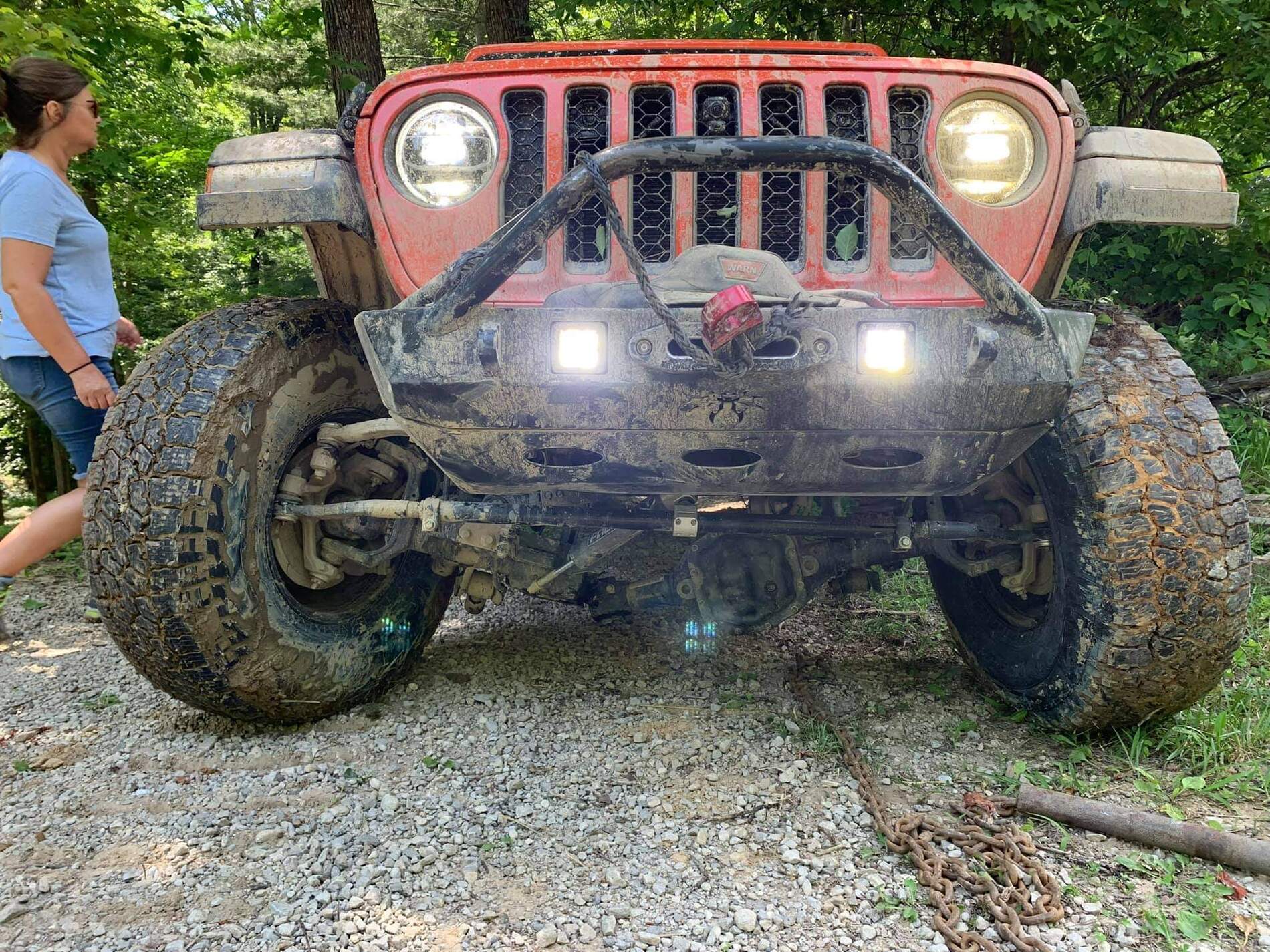

This JT slid on a trail and hit a rock just right...
Looks like the housing snapped at the FAD? That sucks. That damn opening into the housing is no doubt a significant vulnerability. I’m on the fence about further upgrades to my front axle but I can’t help but feel like I just should replace it altogether to get rid of the FAD. A delete and no amount of money spent on upgraded shafts would have prevented the carnage pictured.
PyrPatriot
Oct 27, 2019
193
2,668
1,877
Kentucky, USA
JT Sport S Max Tow; Honda Element
May have been a freak accident. Plenty of folks have gone years and years of bumps without breaking a FAD. But I can certainly see slipping and hitting a rock, this is what a major portion of the (estimated) 15mi trail looks like. Up and down and around mountainsides
