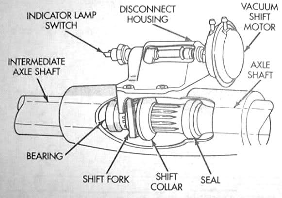

The current FAD is electric operated, it was vacuum operated on the YJ and other older Jeeps and Dodge vehicles. It was prone to not operating (consistently) when there was a vacuum leak on the engage or disengage vacuum circuit. There were aftermarket cable FAD shifter available for the YJ and XJ.

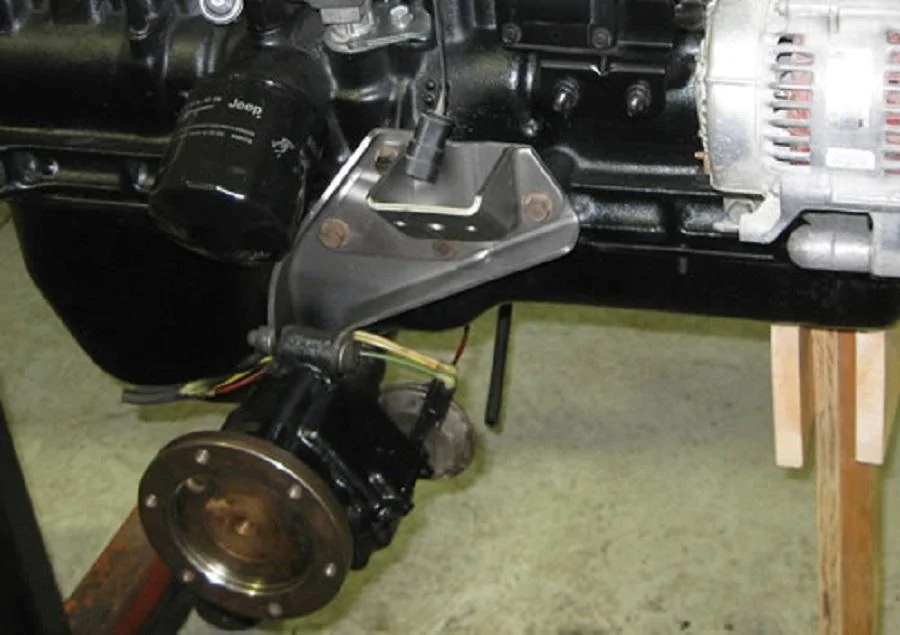

AMC found that the disconnect saved a whopping 1 mpg on the Eagle so got rid of it about 1984 or so. That also resulted in a shift-on-the-fly system since there was no need to stop to let the axle shift and the t-case was synchronized (up to about 55)
I have a spare NOS FAD vacuum motor for my car as well as a pair of good used motors for the axle and t-case shifting.
