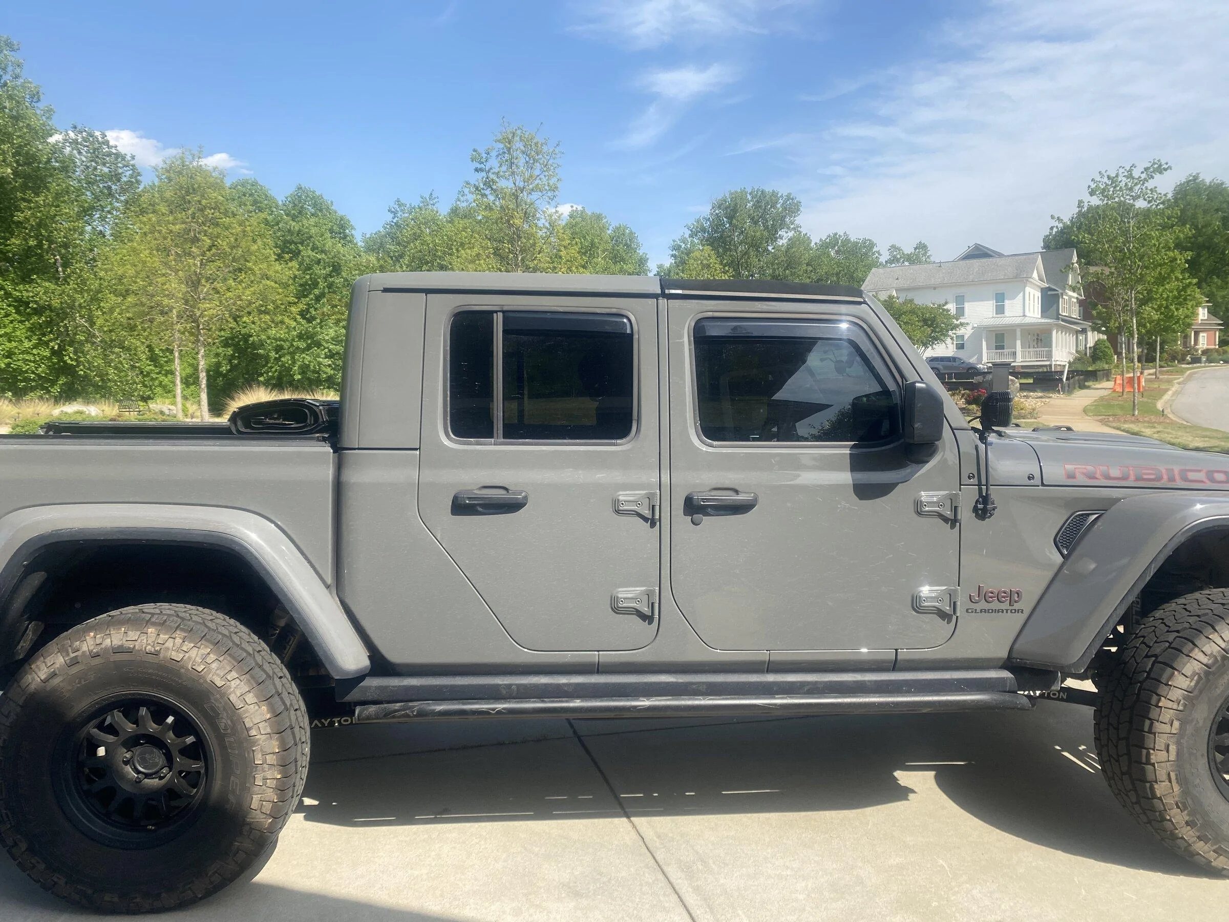

Samson got a set of 37-inch Cooper Discoverer XLT AT3 shoes with new Black Rhino Rapid wheels thanks to @Discount Tire (his previous 35-inch Falken WildPeak AT3’s on LE wheels are up for sale in the member marketplace).
The 3.5-inch @Clayton Off Road lift was screaming at me everyday for a larger set of tires. And YES, as you can see in the last picture, the lift allowed me to fit my 37-inch spare under the JT!
Can’t say enough good things about the customer support and service from the Tega Cay store - outstanding folks!
Note: one of the reasons that I chose this wheel/tire combo is weight. The Rapid wheel is 26 lbs and the Discoverer XLT AT is a 68 lb tire. Plus I tow a camper - the Cooper Discoverer is designed for towing. The wheel was my fourth choice wheel, but in the supply chain limited environment that we are currently experiencing - it was my best option. I really do like the wheel, really happy. Just wanted the Black Rhino Bantam or Dugger a little more.

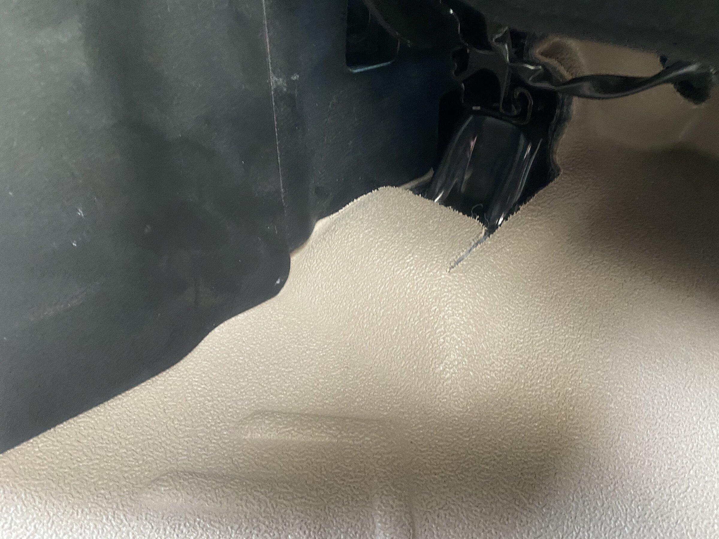

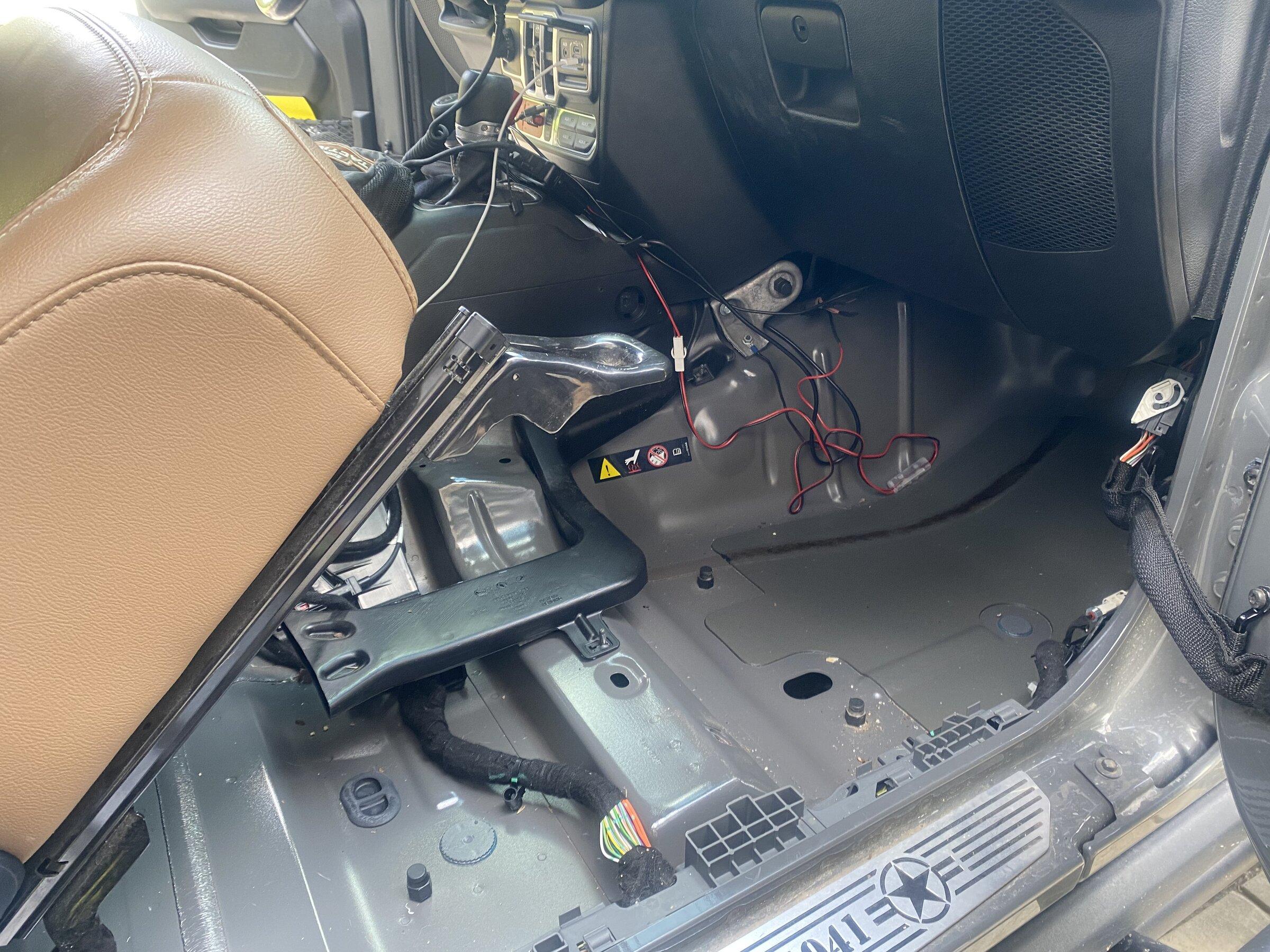

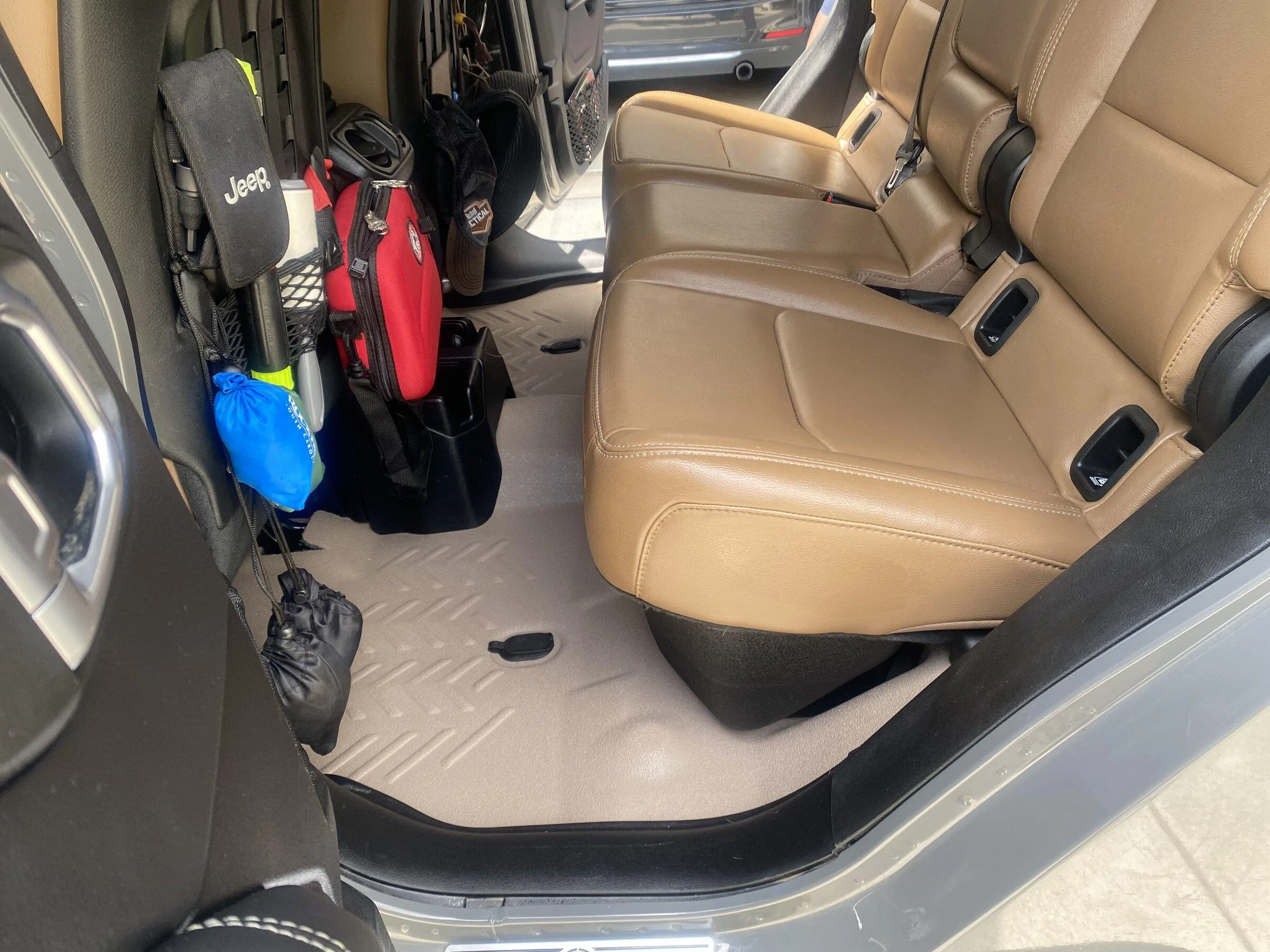

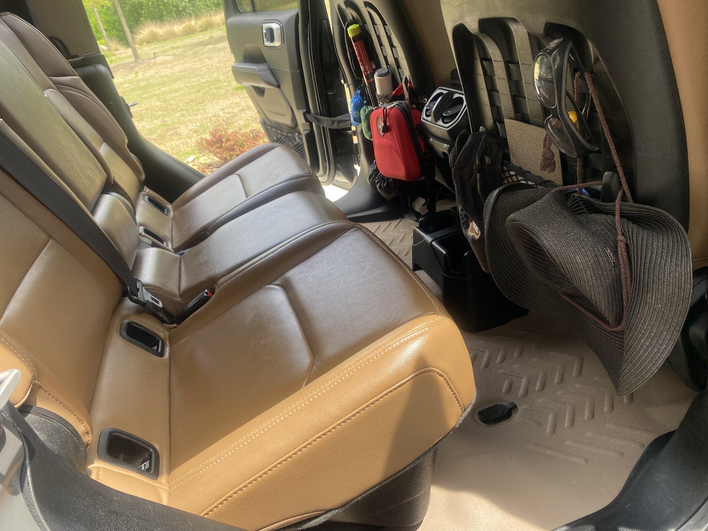

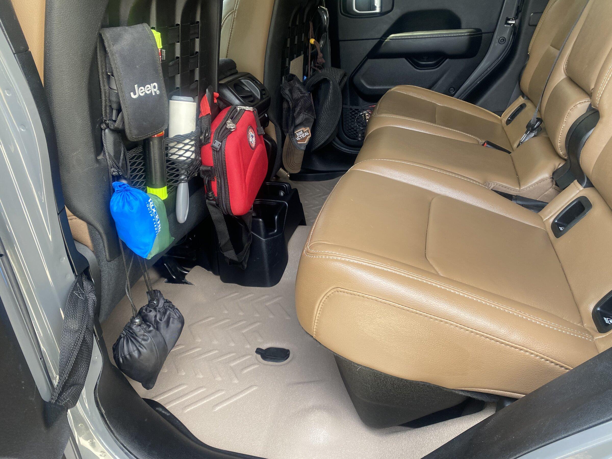

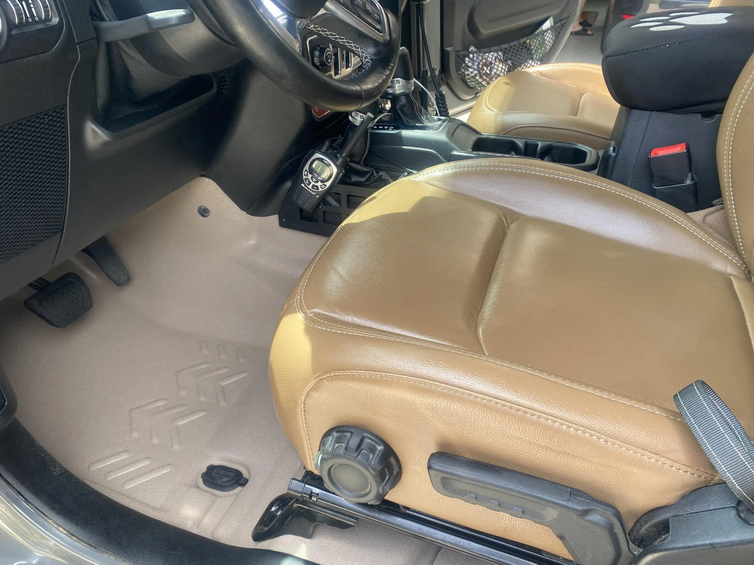

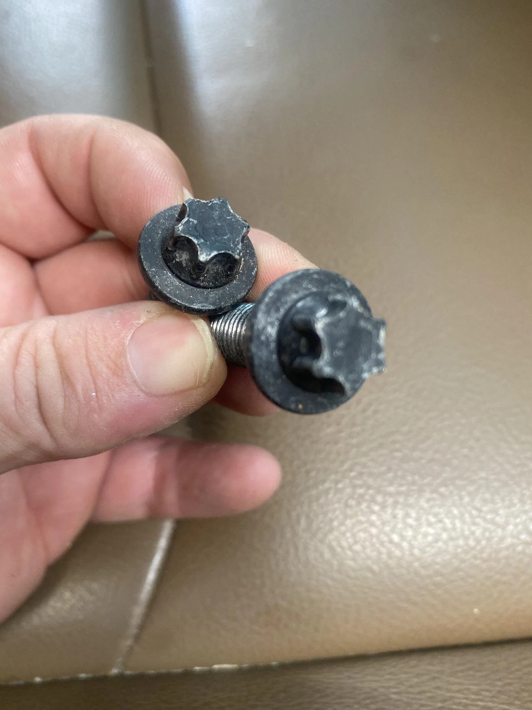

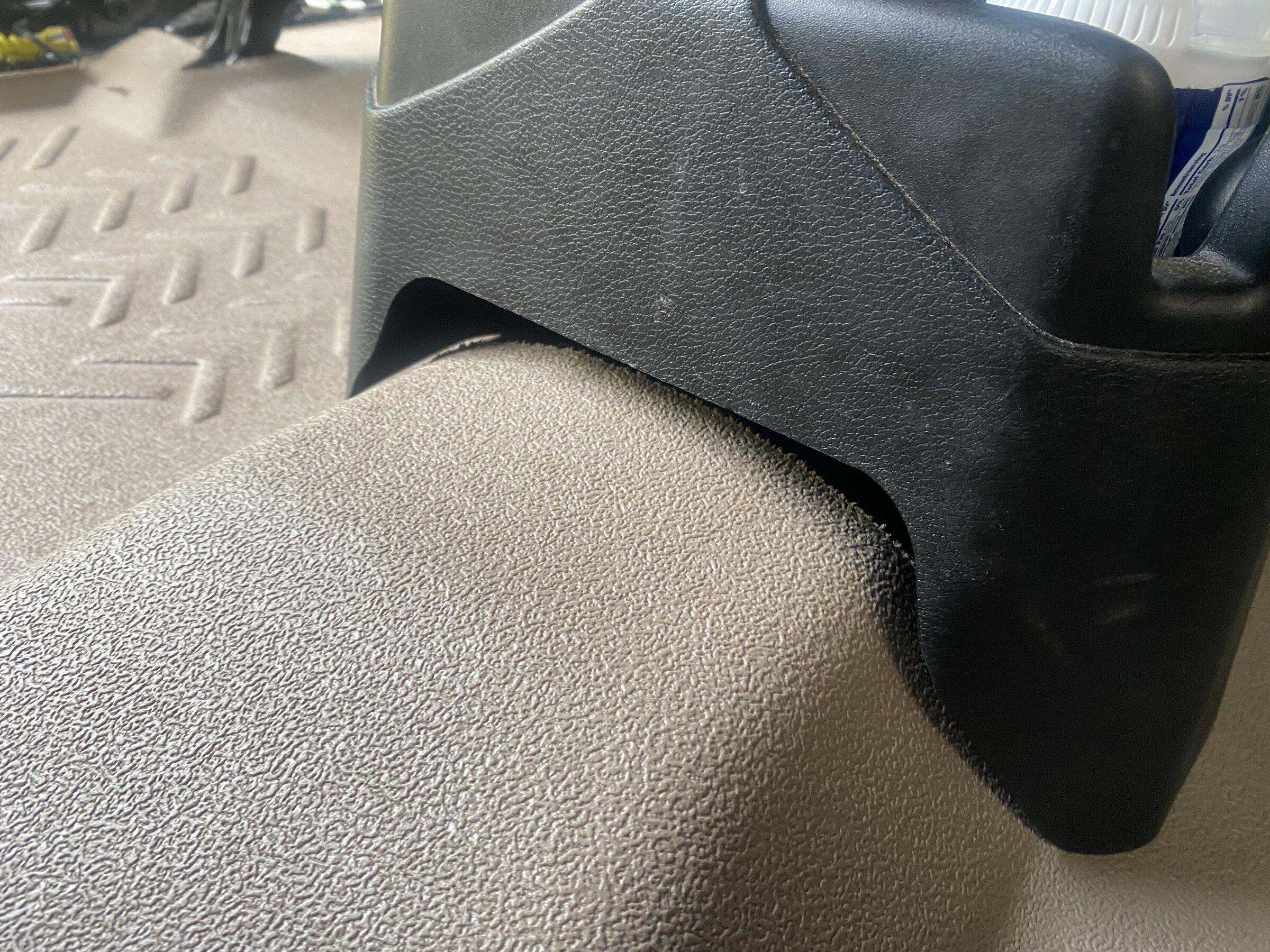

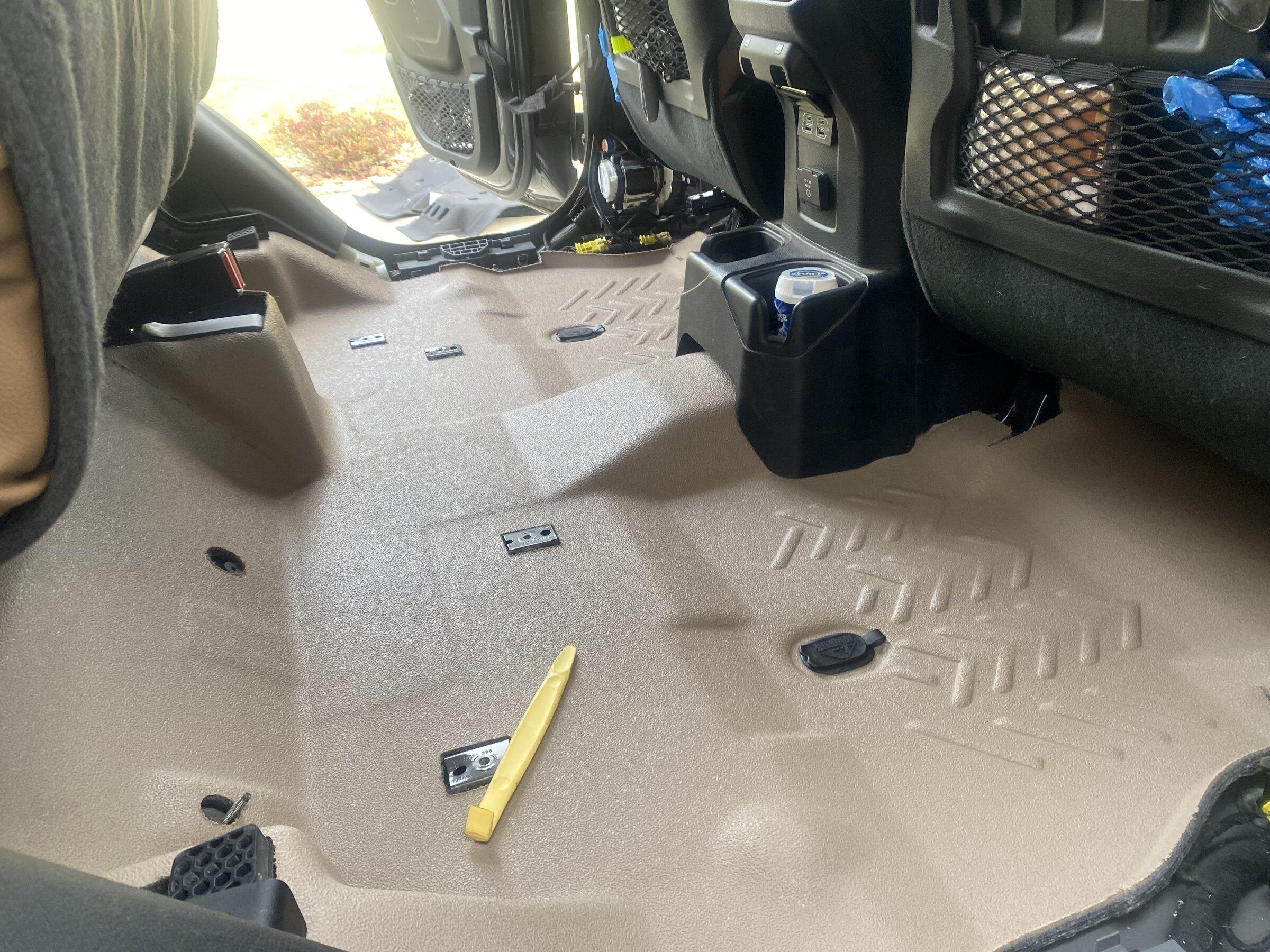

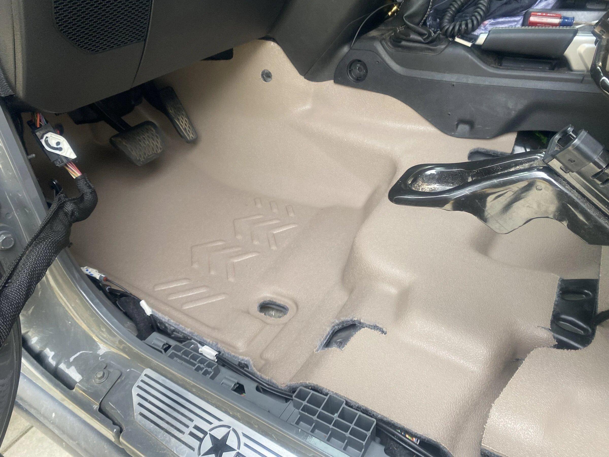

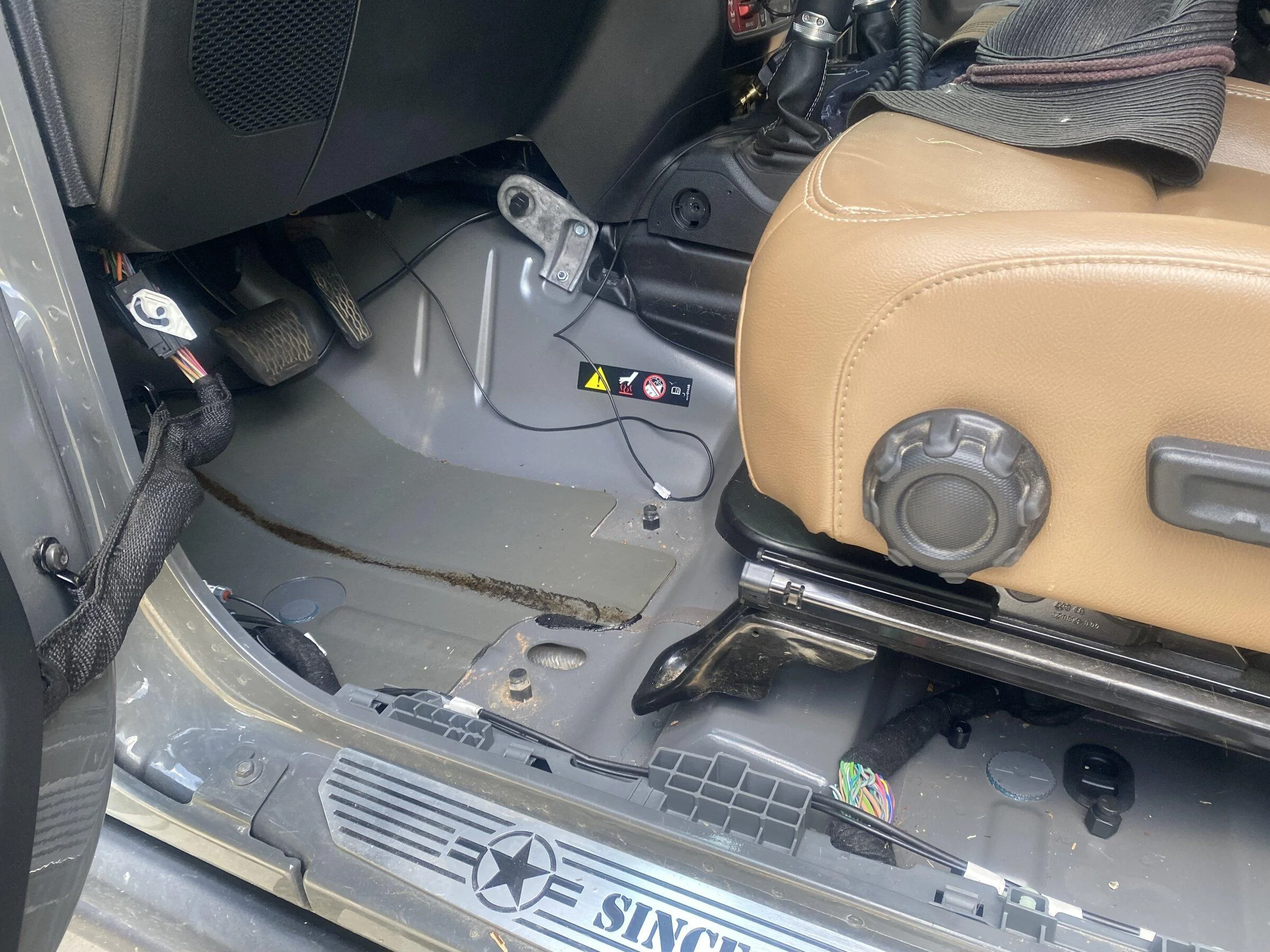

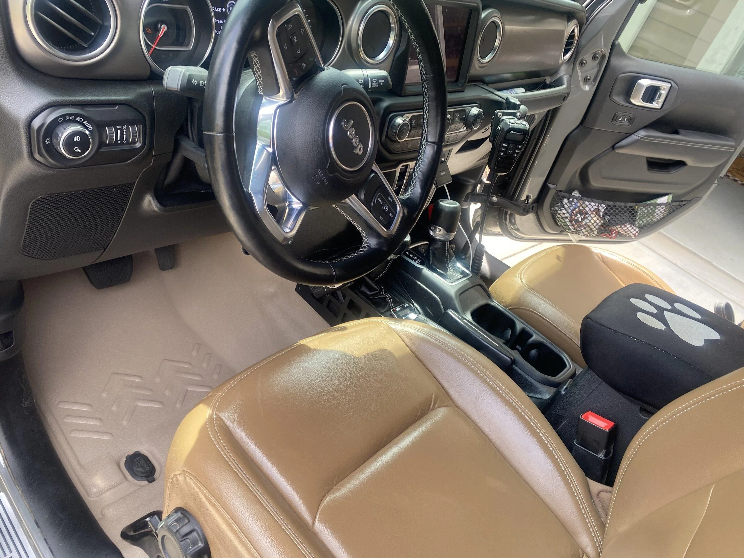

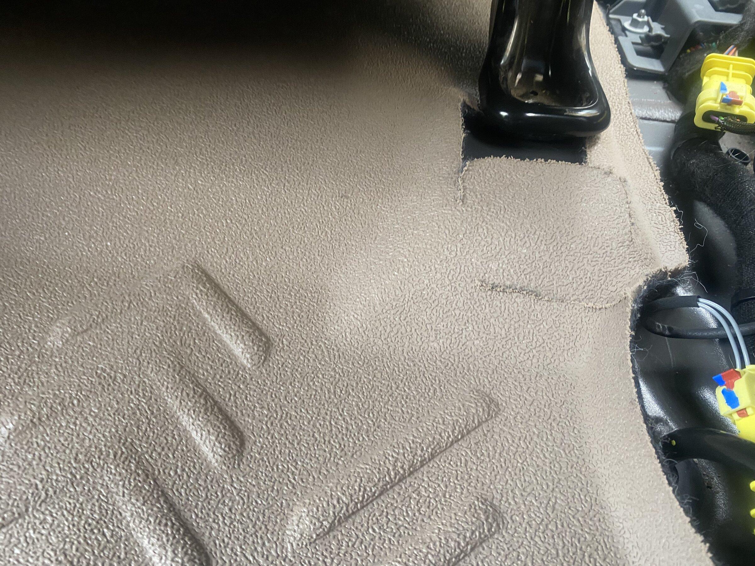

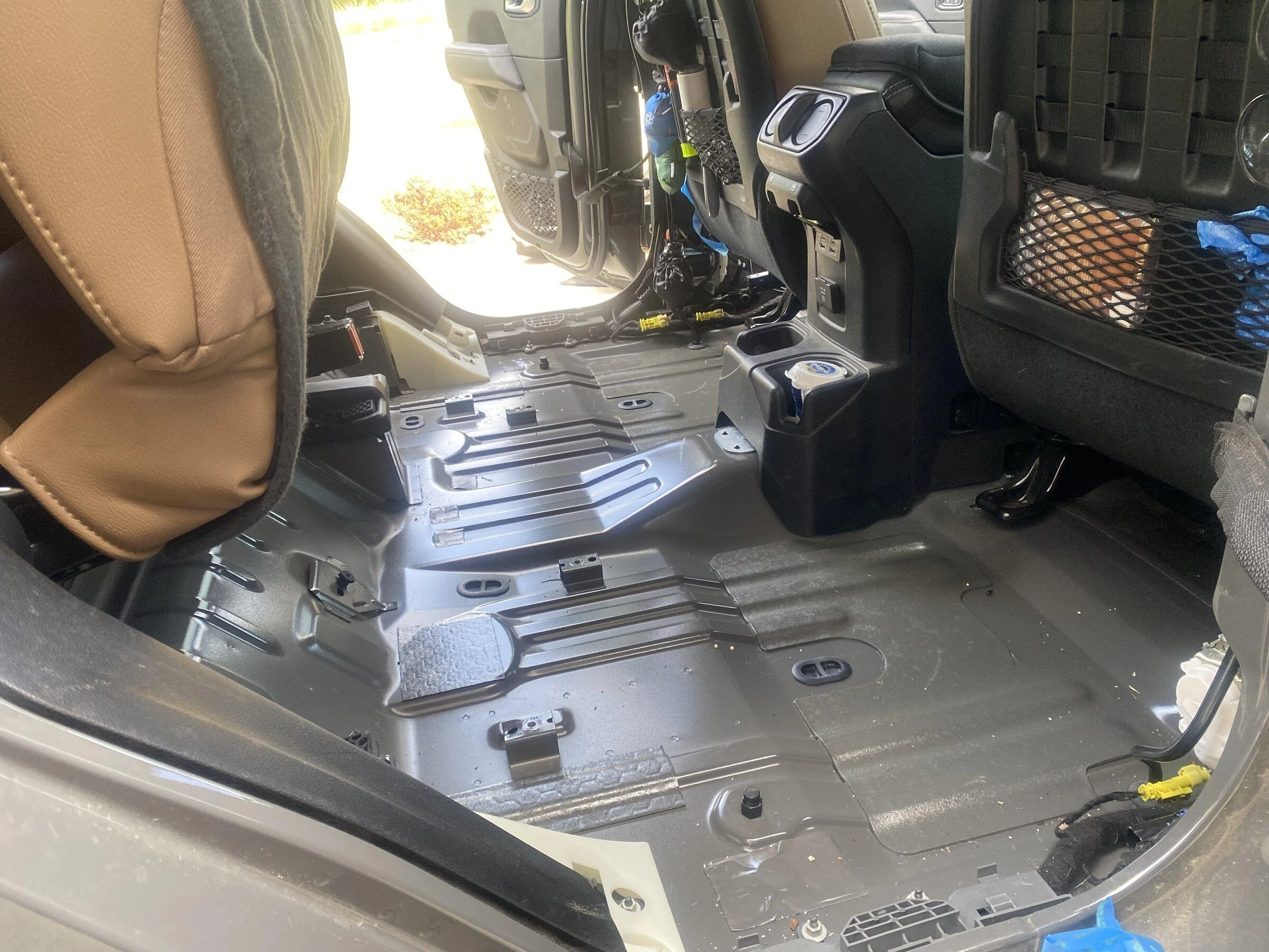

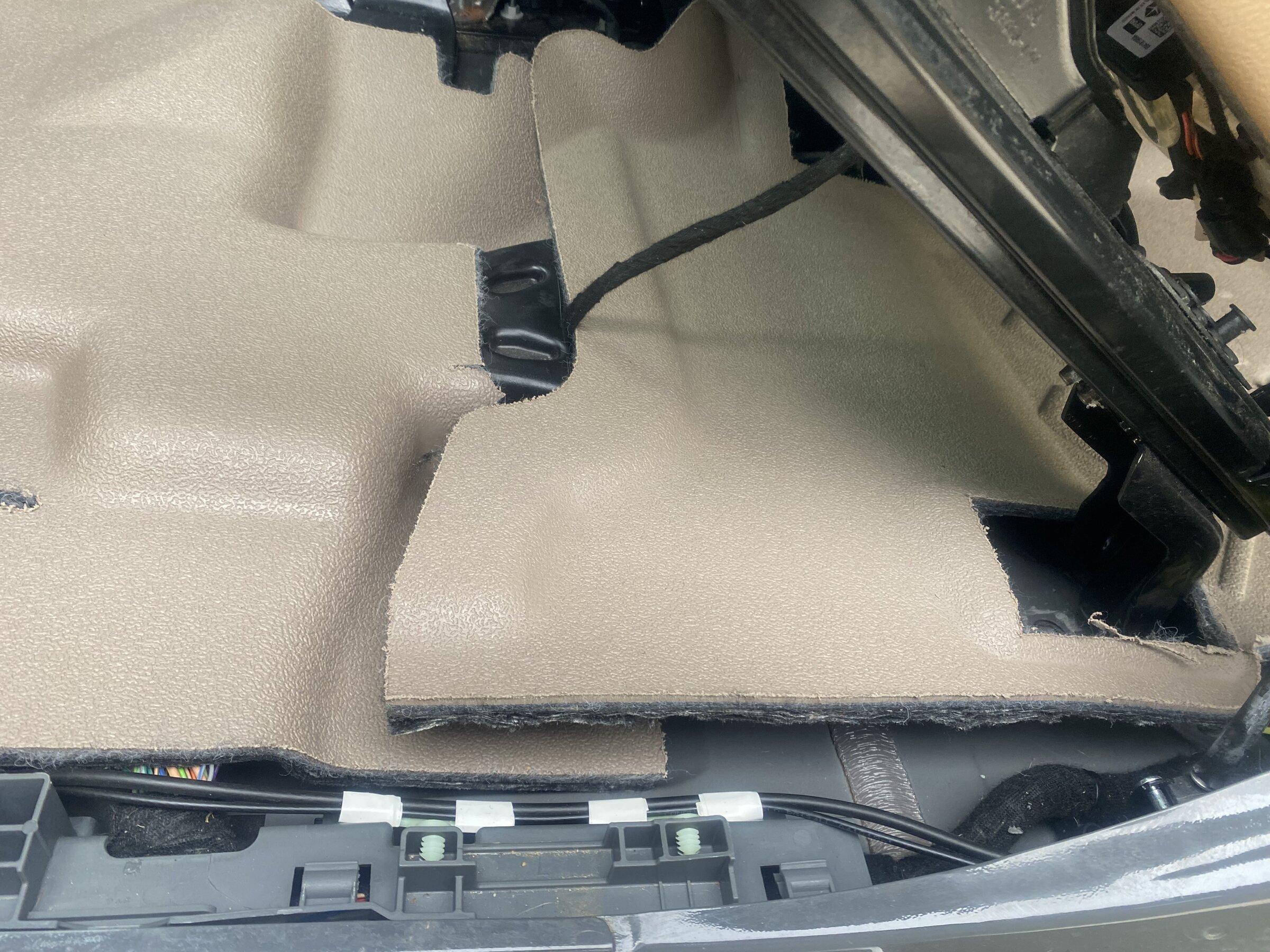

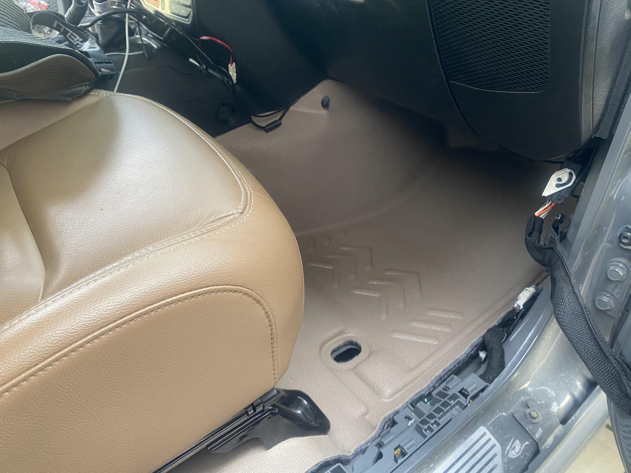

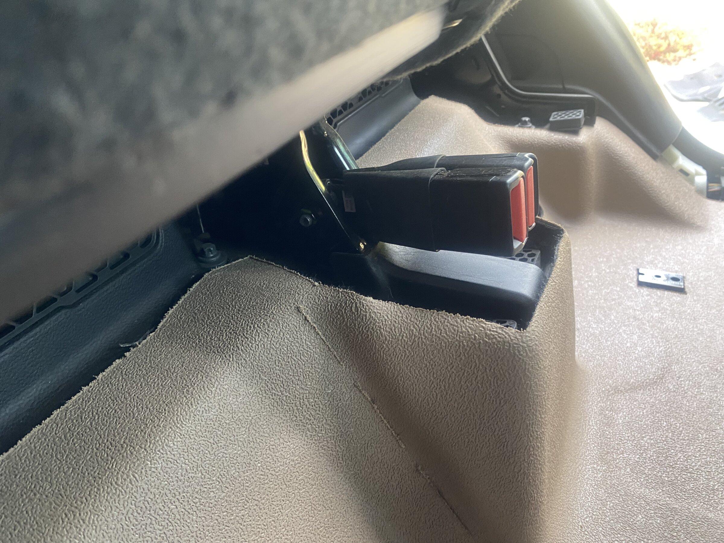

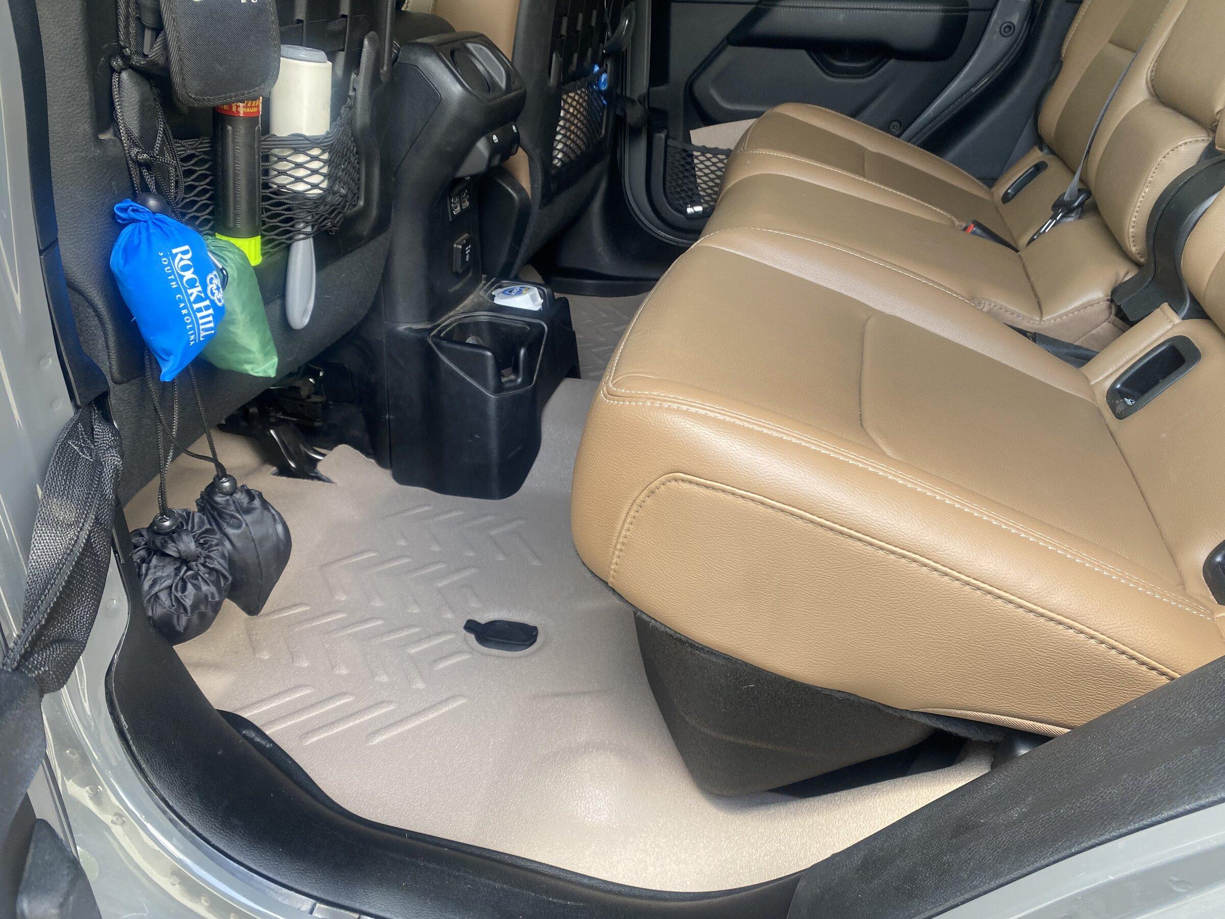

I spent some time yesterday installing the @Armorlite_Kail In Desert Khaki in Samson (with the brown leather interior). The install is a real PITA, but I am hoping it makes my pups hair clean up much easier and much les noticeable.
One critique of the installation instructions is that my JT does not have T50 torx head bolts. I had to find an E12 socket to remove the front seat bolts.
I have a color sample if anyone needs it.

rickrogan
Rick
Jan 6, 2020
73
113
From the videos, I've watched, installation looks like a Real Joy. Any trimming or knife work required on yours? Or just a bunch of wrangling? (And of course, just the challenge of having the right socket to get the seats out)
No trimming, just a bunch of seat and carpet wrestling….
Armorlite_Kail
Peak Sponsor (Level 2)
Kail
Mar 1, 2021
44
157
Texas, North Carolina, Michigan
JK Rubicon Unlimited, JL Rubicon Unlimited
ARMORLITE
Looks great, thanks for posting. When we made the instructions the bolts being installed where the normal torx like the JL has. But the assembly line for the Gladiator had their guys breaking bits during install so at some point they switched to a torx socket. We need to make a revision to the instructions, thanks for bringing this up.
