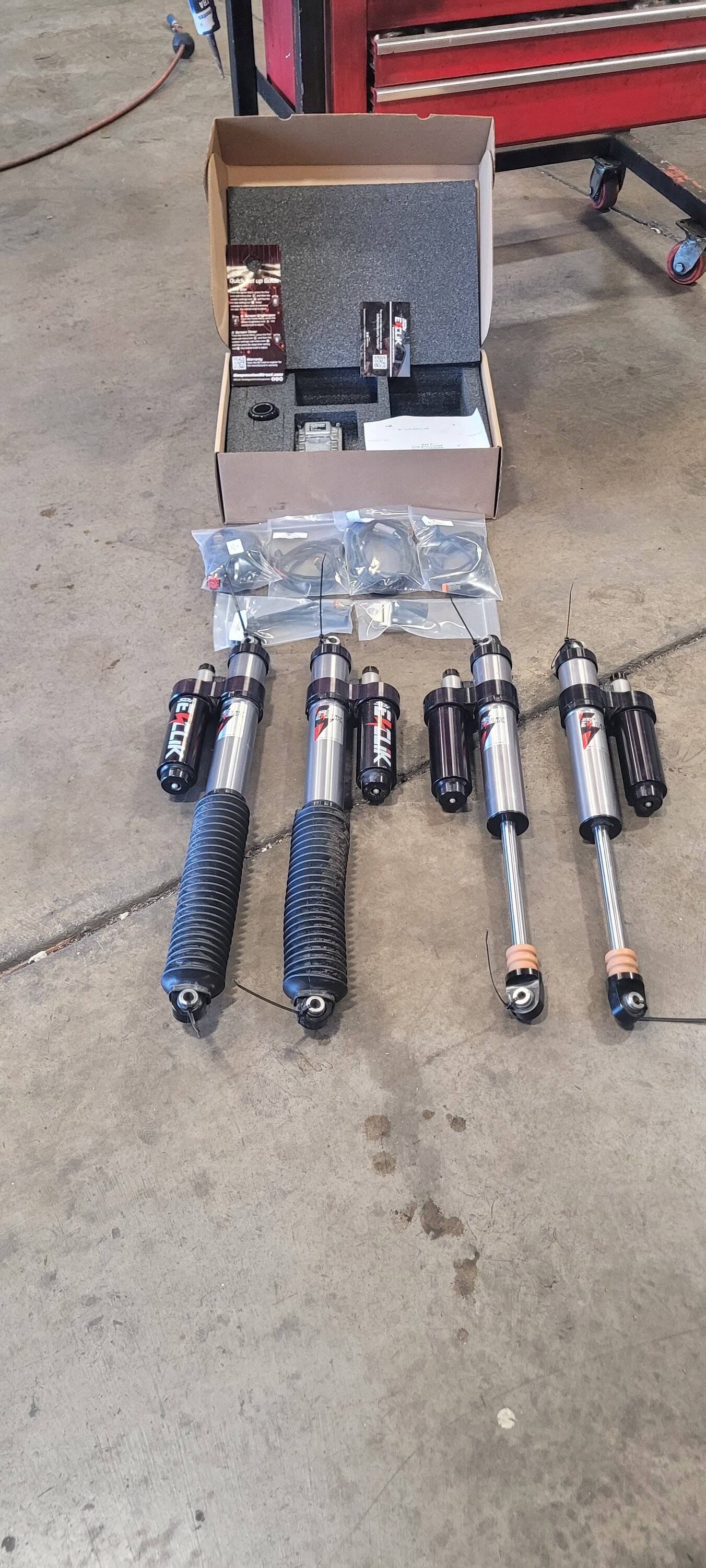

I have a set of E-Cliks w/ Pro Menu option I'm selling for a close friend/client of mine. These were installed 11/2022 and have approx 4400 easy miles on them. He traded the truck earlier this month so we removed a bunch of the expensive options he had installed beforehand.
Everything is in the original packaging, has all included literature, drilling template for the fuse box lid, and even a larger number of zipties are included to help facilitate a cleaner install! I'm including a pic before I cleaned the shocks up so that it would be apparent there isn't any leaks showing in the dirt/dust. The rears have shock boots installed to protect the shafts from front tire roost. I can set the seal head snap ring lengths for whatever you need for your setup. I can also order in and swap longer clevis' should your setup require that ($100 extra).
I also have an awesome valving setup for these shocks for those running a med to heavy weight setup on Clayton springs, but can also tailor to your needs if you can supply a spring rate and axle weights (additional costs involved). More info about my work here: CrazyCooter's Shock Tuning Thread and here:
These fit JT's with 2-3.5" lift, but can be configured for more lift, just by changing clevis lengths. These can also work on a JL.....I can swap out the rear misalignment spacers for 12mm and you would have an extra 20" of cable for the rear shock due to wheelbase differences.
I'll give the new purchaser a 90day warranty covering leaks not caused by damage to help with confidence in buying this expensive preowned package. I have seal kits in stock and will handle the reseal in house.
Asking for $3200 including the ride to a CONUS address. CA residents will have to pay sales tax unless it's a cash person to person sale.
