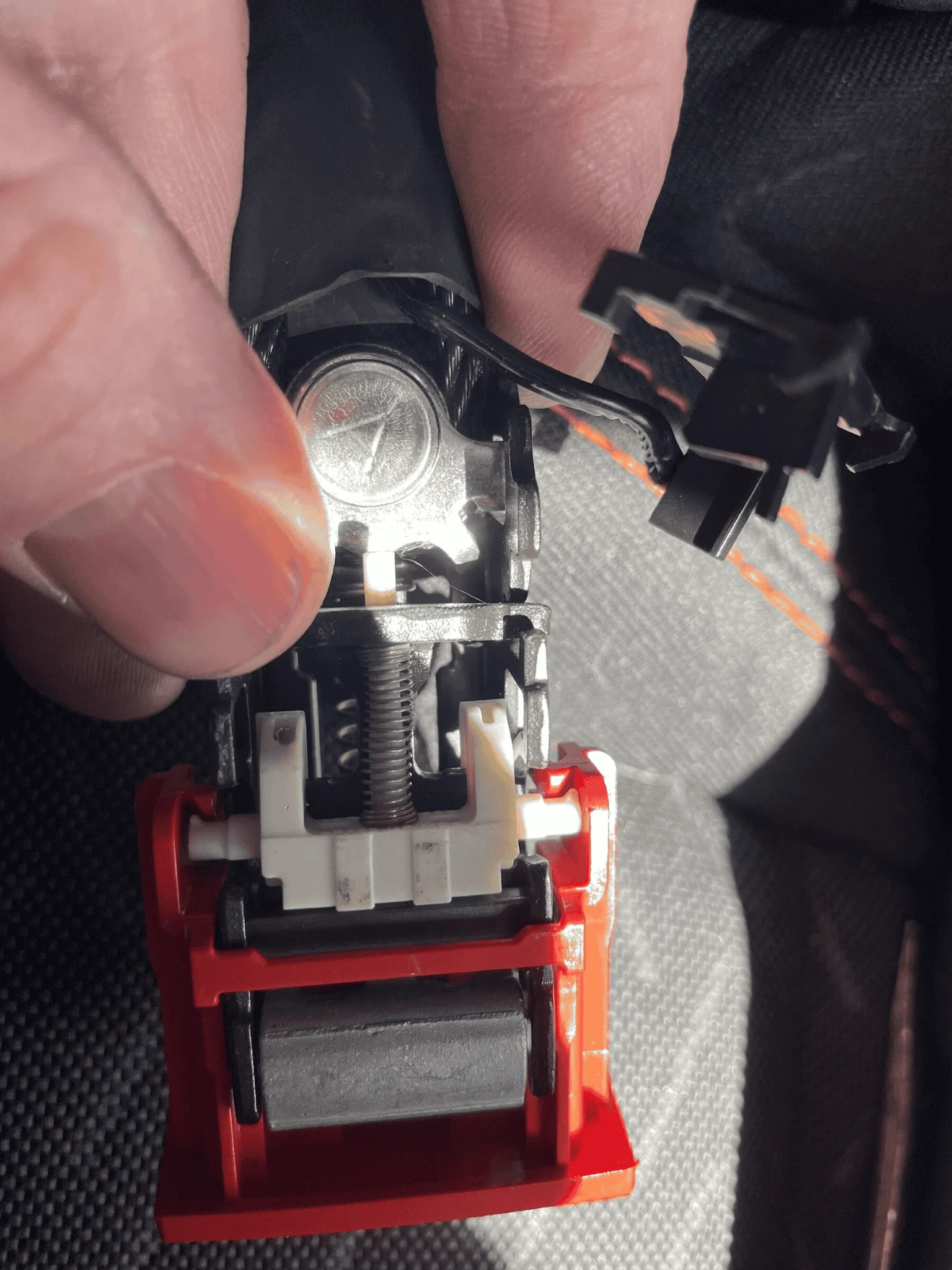

I am going ti try this. It is hard to tell from the pictures, but I think he is talking about taking the round thing out that looks like a battery.

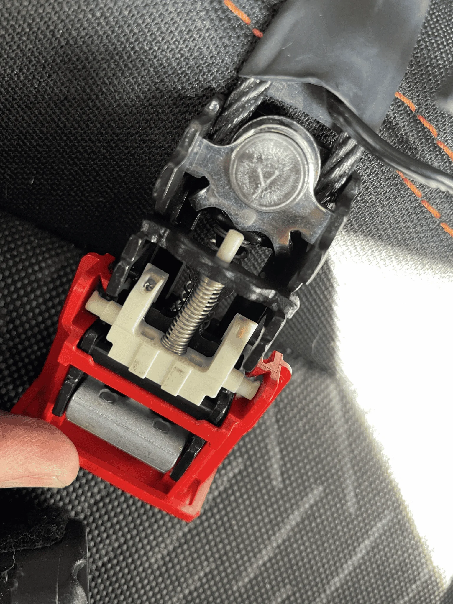

Haven't done it myself yet, but it looks like the pin that the original poster refers to is the roll pin in the white plastic on the left below the thumb in the first picture .... when you look at the second picture, it appears that the roll pin has changed
As I bounced from one pic to the other, my teenage son asked "Is this like Where's Waldo for adults?"
Edit: adding original post
Finally got around to fixing the annoying seat belt safety lock out. Every time I needed to back up and jump in and out with the door open with out the seat belt it stayed locked in park GRRRRR
So a little help from my uncle it was determined the mechanism had a super magnet triggering the safety. With the help of a safety pin I was able to remove the pin and magnet.
You can see it at the end of my thumb.
