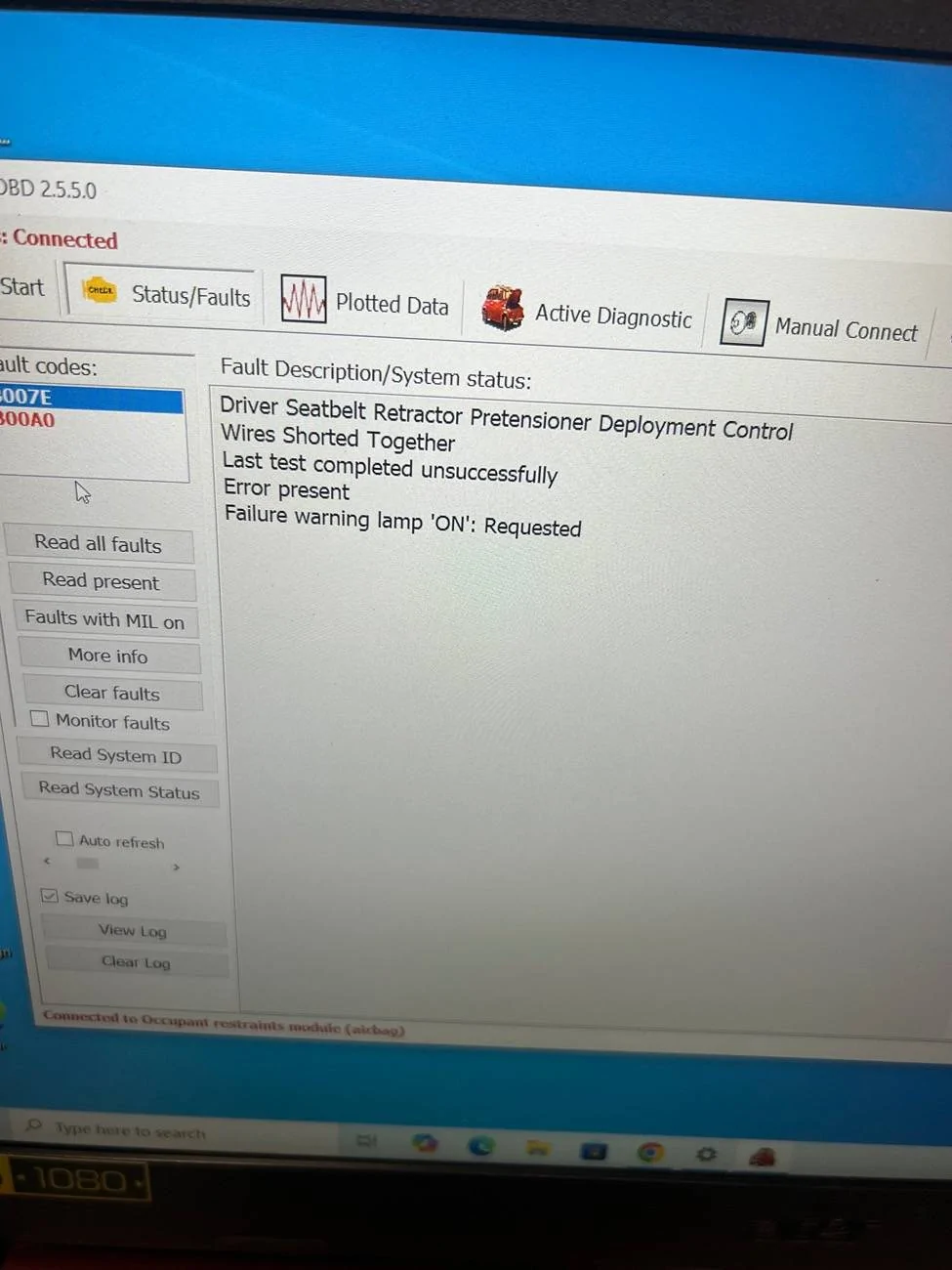

Last week I installed RSE rock sliders/steps. I had the B pillar panels off and the sill plates to run the harness. Nothing major at all with wiring. Button everything up and go to start. I get the Service Airbag system message. Used AlfaOBD to get the exact location which is in the subject.

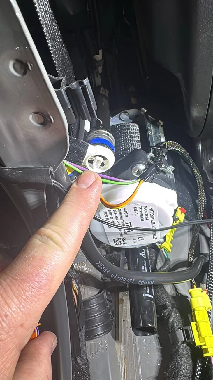

I took all then panels off and inspected all wires, nothing is frayed or pinched or cut. Under the seats everything is connected.

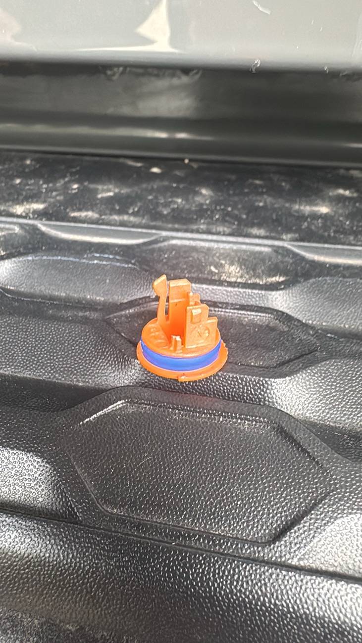

I did notice this little orange plug was off a connector and popped it back on. Looks like it's just a little cap to keep the plug connected. I did see one of the little legs was busted off - but it still fits tight over the connector. I have legit searched for hours and gone over everything. Short of taking it to the dealer - I have no idea where else to look.
