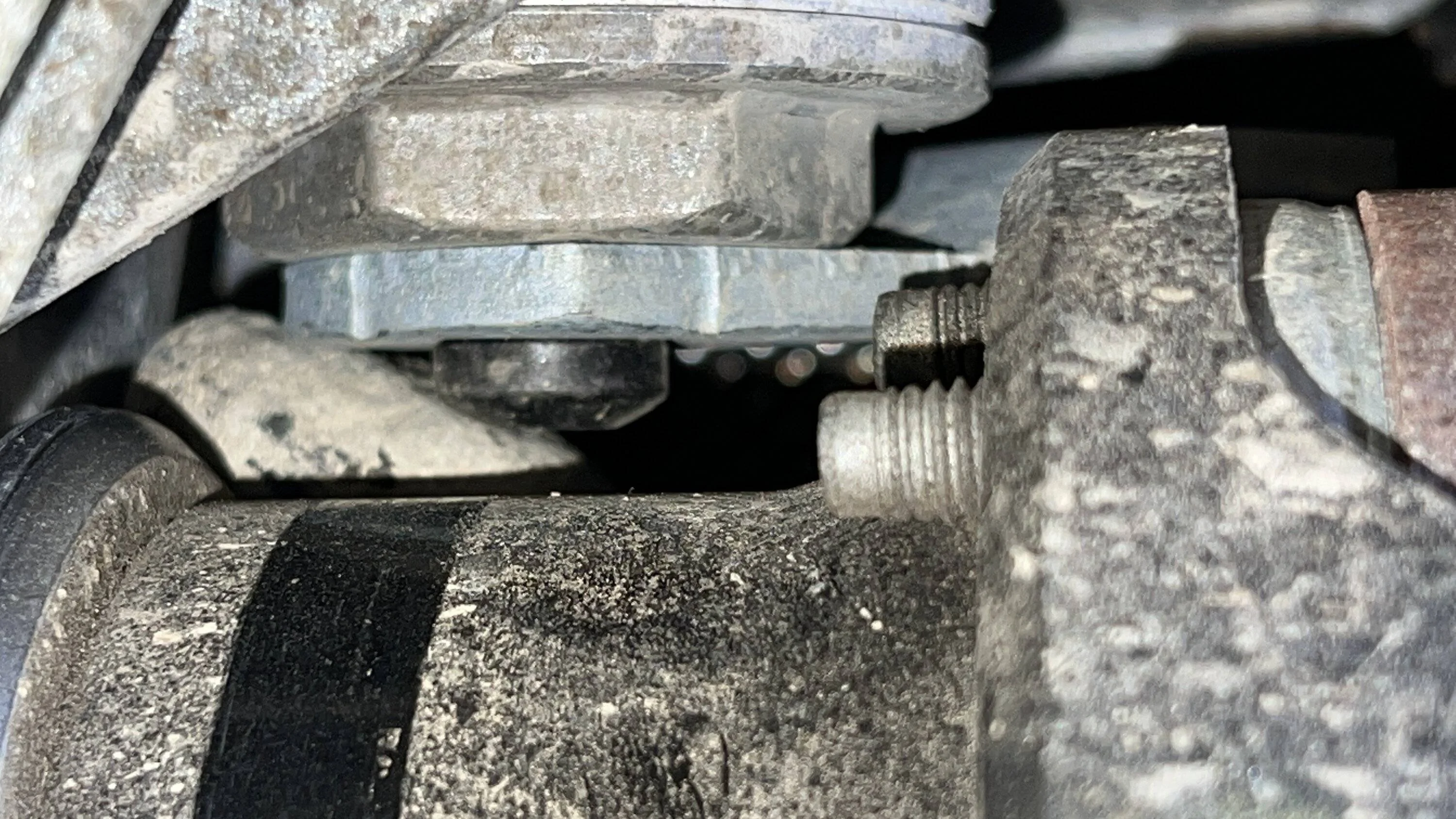

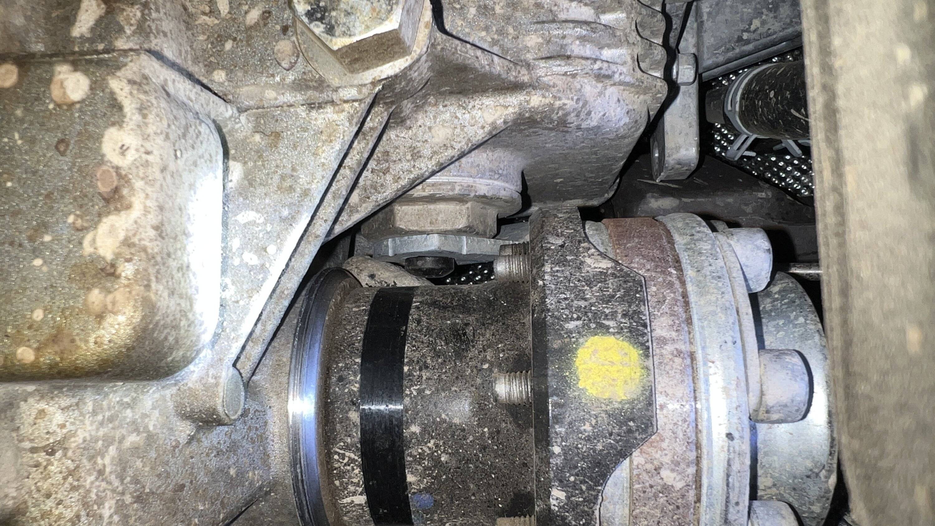

This actually happened to me. Well wait not because a sensor but hear me out. I was out on a simple day drive before a major surgery back in August, went on a dirt road, and could NOT for the life of me get it into 4wd! I tried and tried, all sorts of combinations of things. I thought it was broken. So went back to my folks in prep of surgery. Well...9 weeks later before leaving to go back home after part of the recovery I found this.
You see that rock up there?
How in the world that thing EVER got up in there...I will never, ever know. INSANE!!!!
Just a little PSA. The improbable, no matter the rate of probability, is still possible.
