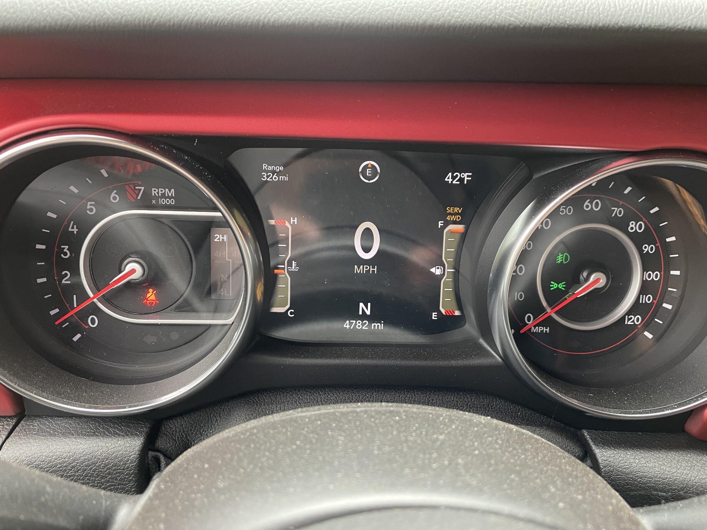

New here, picked up a 2021 JTR in Oct 2021 with 22 miles on it. Got the first serv 4wd light at the end of Jan, and the second and third time on the 27th of Feb. Miles were 4000 and 4800 respectively. Called the dealership and they said probably the drive train control module behind the rear seat. Will take it in March 30th.
When this happened, I didn’t get any other lights, but I did lose 4wd. I tried 4low and it was using the 4:1 gear reduction but the front was not spinning. All three times I shut it off for 1 min and restart cleared it.
I will update when Jeep looks at it. I’m not happy that it loses 4wd when this happens, and it only has 4800 miles on it.

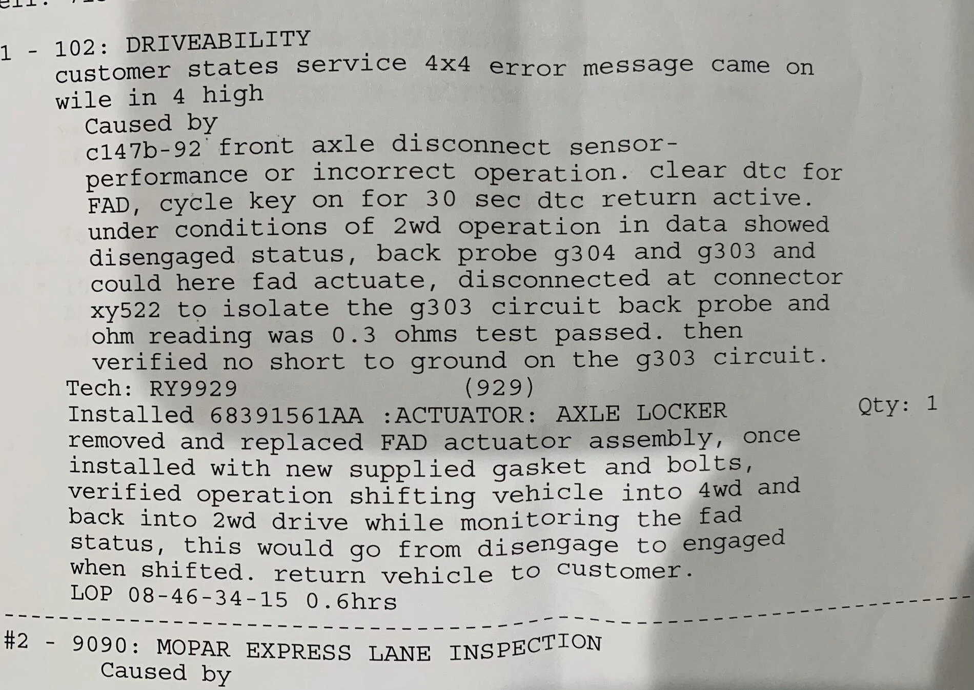

Not to bring up an old thread / post.
But I got the 4WD SERV light on my 2021 Gladiator Mohave a couple weeks ago. 22,000 miles and this Jeep has been a cherry. We love this Jeep truck. Well into our 2nd year of ownership. It's perfect for everything we need, when we need a little pickup truck with capability and an amazing ride.

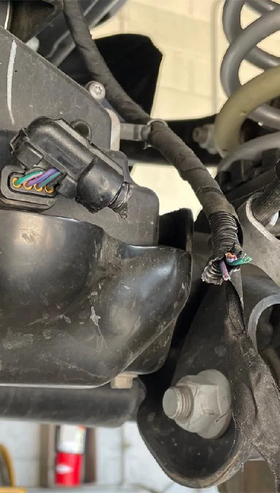

Took it to a dealer, and I got this picture from the service adviser...

So, dealer says it looks like a off-road damage.
I looked closely and there's bite marks on the coupler!
My lovely wife likes to bring home stray dogs. I was out of town and those stray dogs chewed on that FAD point until I got back a week later.
Dealer charged nearly $900 for the repair. Because it wasn't covered under warranty.
1st, I have no issue paying for the repair. We did pay for it. It's repaired and our Jeep truck is fine.
2nd, My wife learned that loving stray dogs can get expensive.
3rd, Jeep Quality was never an issue.
4th, Check under your Jeep before you haul it off to the dealer. I'm glad that the repair is warrantied. But man I could have fixed it myself for less than $100.
