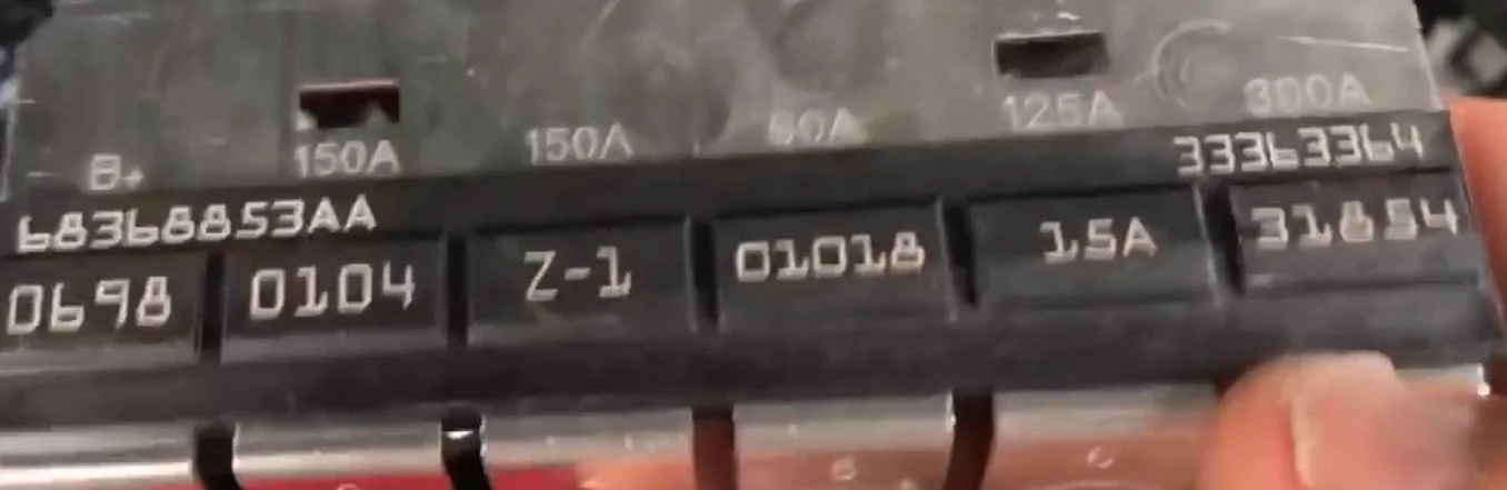

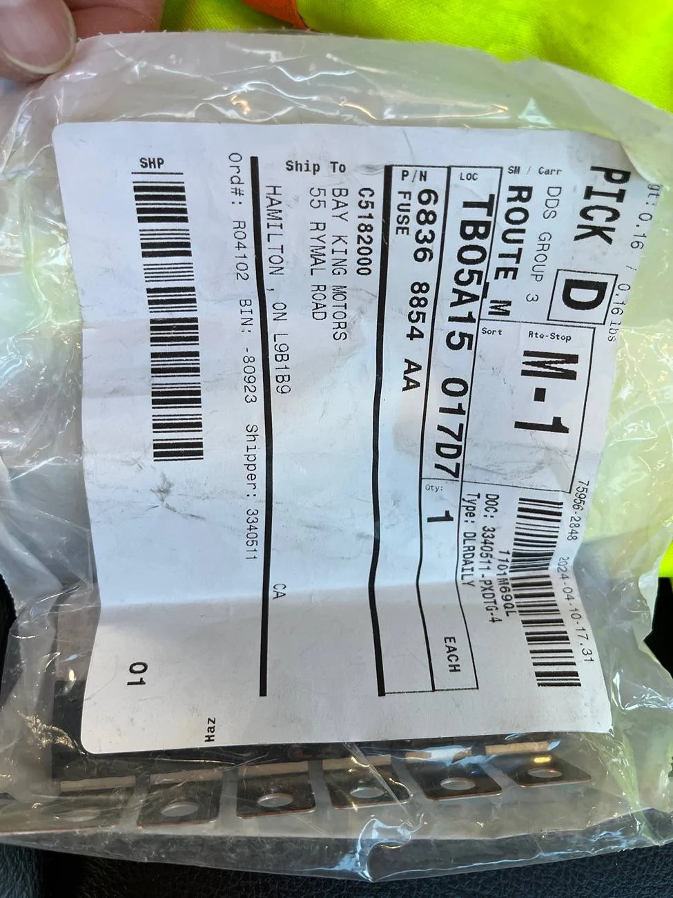

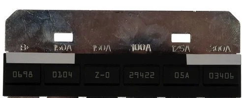

Ok...what i have found out.
This pic is from this vid...
From the right, the third fuse is 60A. There is another block out there that has that protection at 100A.
Since this dude pulled this off his jeep in the vid i ordered the 60A, this is what was confusing me when looking at the parts.
Jeep Gladiator 'Service Shifter' error 6003E15A-56B6-48F8-A3C5-FACEF2058354

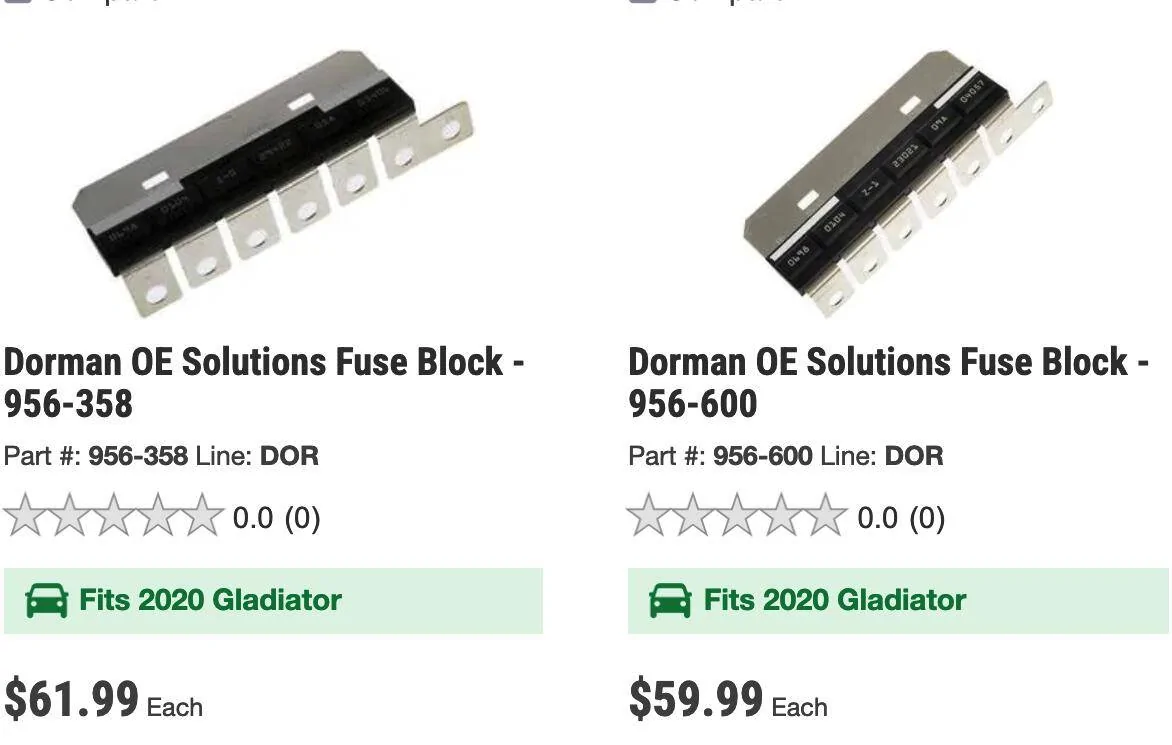

From the O'Reilly page i was able to look at a couple of different thumbnails, and zoom in to look for diffeences. The below pic shows the protection from the right is: 300, 125, 100
Jeep Gladiator 'Service Shifter' error 138FC7D9-42F0-4FA5-B4C2-962D9ABBB21E_4_5005_c
So, the part number for what we need, I believe, is:
Dorman 956-600
https://www.oreillyauto.com/detail/...ive-truck-2020-jeep-gladiator?q=956-600&pos=0

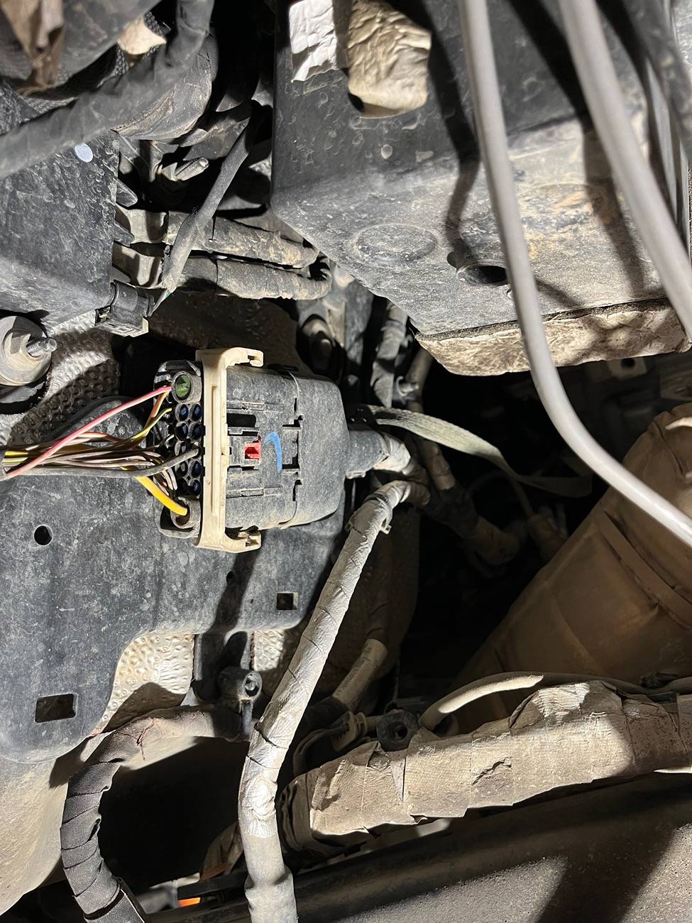

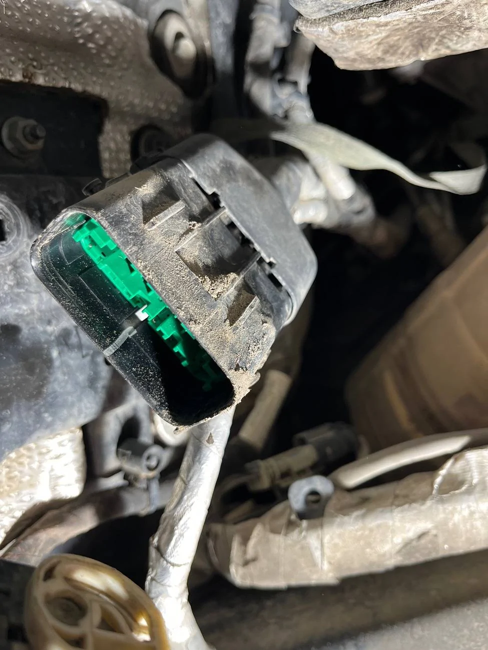

Two things I keep in my glove box, 1. Z fuse array and; 2. Can Bus star connector block that sits behind the glove box.

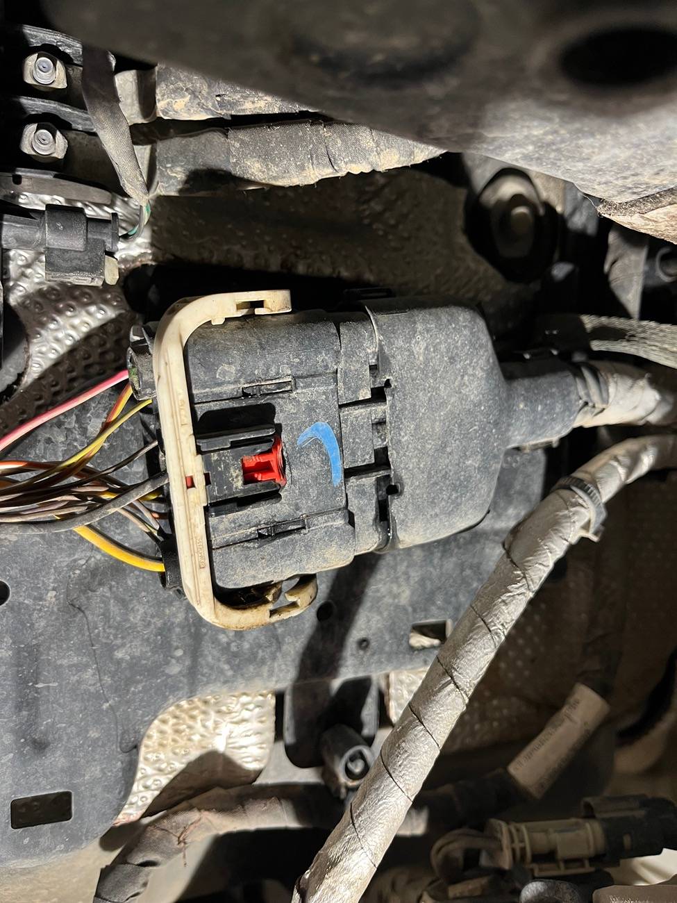

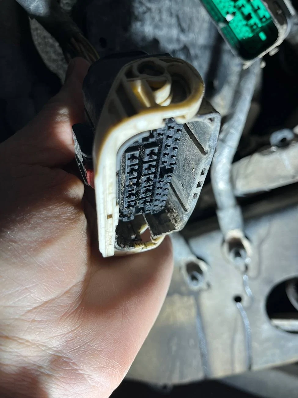

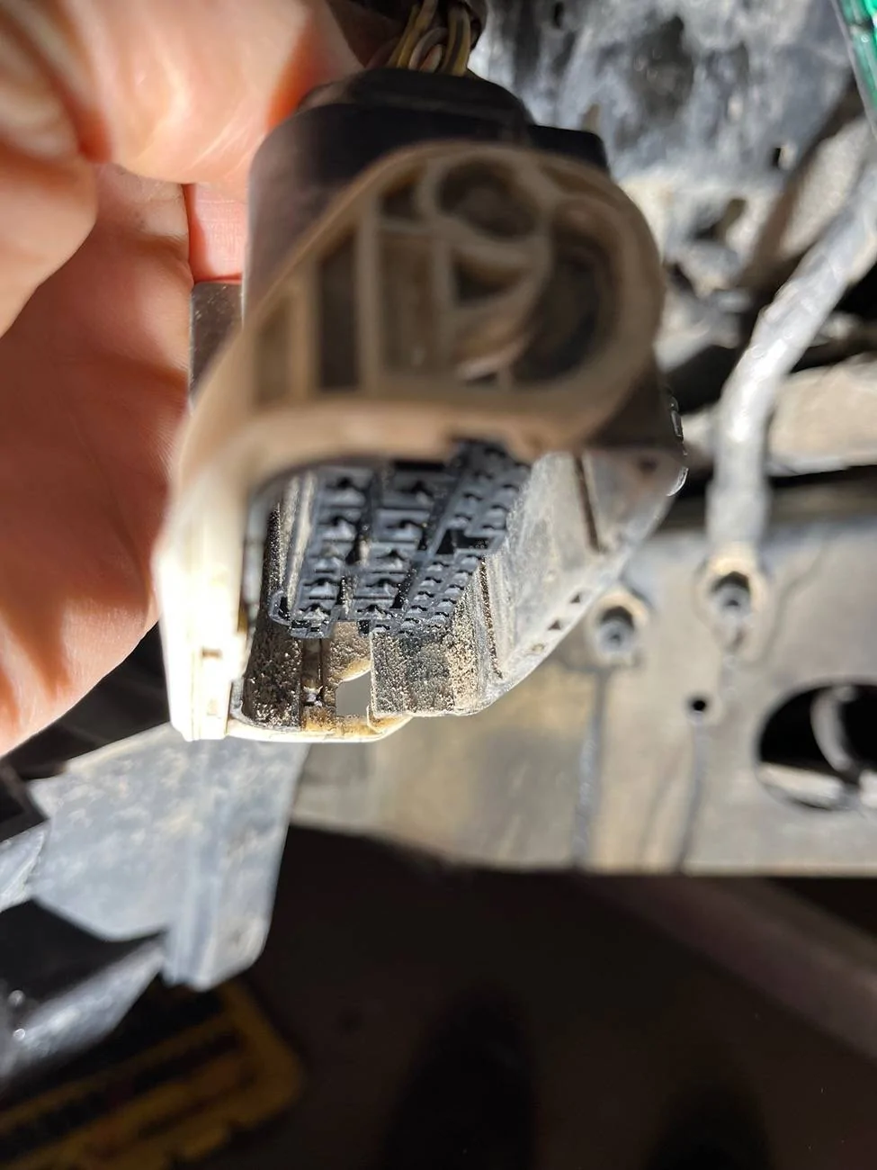

I’ve seen your “shifter” dash warning because of water ingress into the transmission control module (TCM Connector) which is located right behind the passenger front wheel, just left of the AUX battery, accessing through the wheel well liner. Maybe at some point you splashed around on some trail and that connector went under water and now that water/corrosion made its way into the connector and locked up the shifter electronics.
If you’ve ever taken off your doors then you’re obviously not afraid to separate that big ass connector. That’s what the TCM looks like and connection functions the same. I would pull off that passenger tire, undo some clips and fold the liner toward the brake caliper and clean up the TCM, then gently work the white lever back and forth till you get good separation, then pull apart. Inspect the pins for corrosion and such. Have an electrical spray like DeoxIt shield to clean and lube the pins and reinstall.
There are several reasons we can get that code and it’s not always the AUX (though it is widely hated) That dash warning is electrical related, mostly, notwithstanding a serious mechanical failure.
The two pics with part #s is the Z fuse array and the other is the can bus star connector.

ok...let's update.
Got the fuse array. I ordered the 60A, mine is the 100A. This is typical. I've got the heart and I'll put in the effort yet still mess something up. But I digress. I went ahead and installed the 60A, I'll see how this goes, my primary goal is to get this thing into gear.
