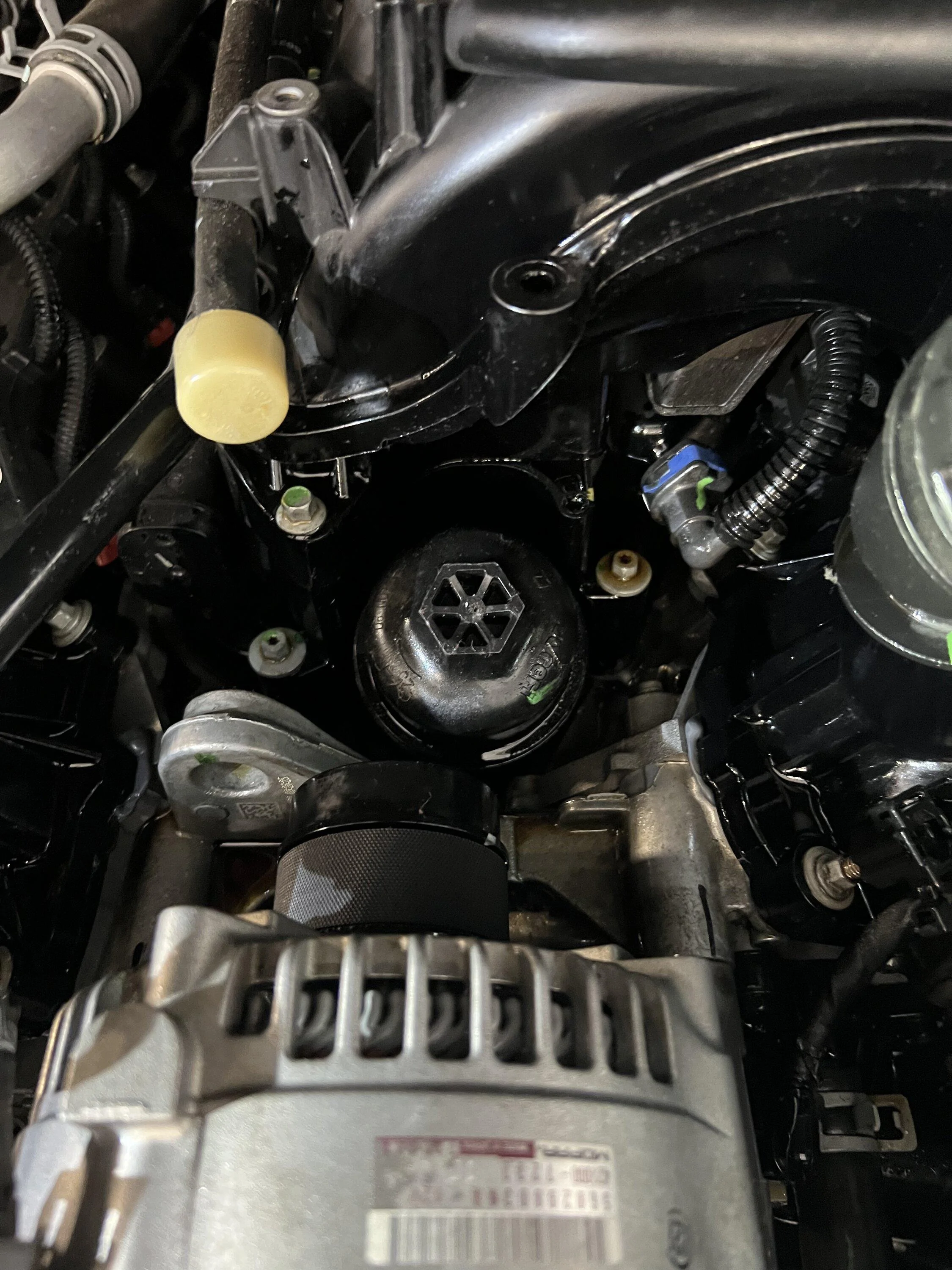

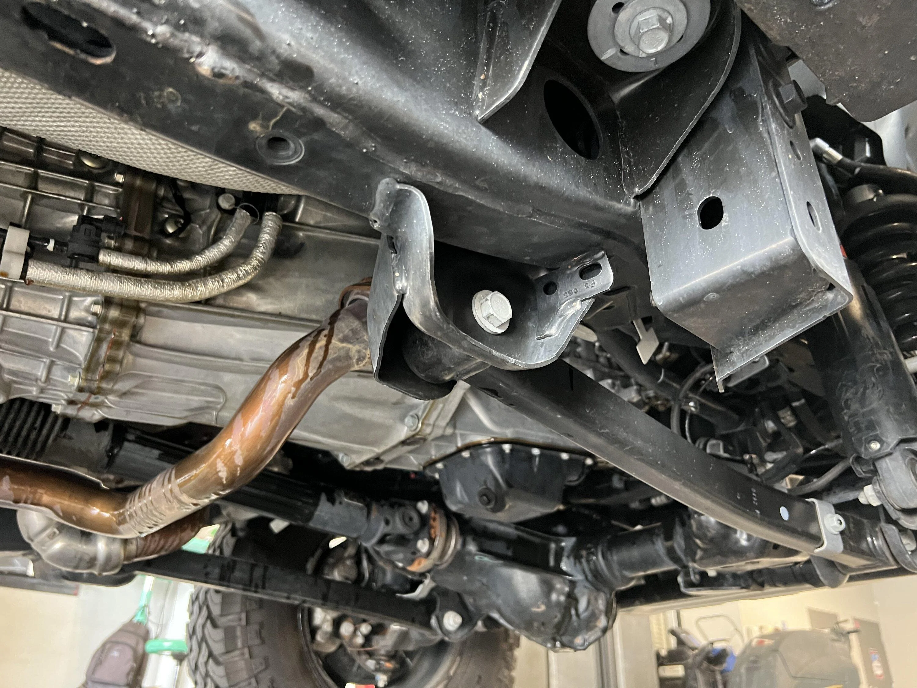

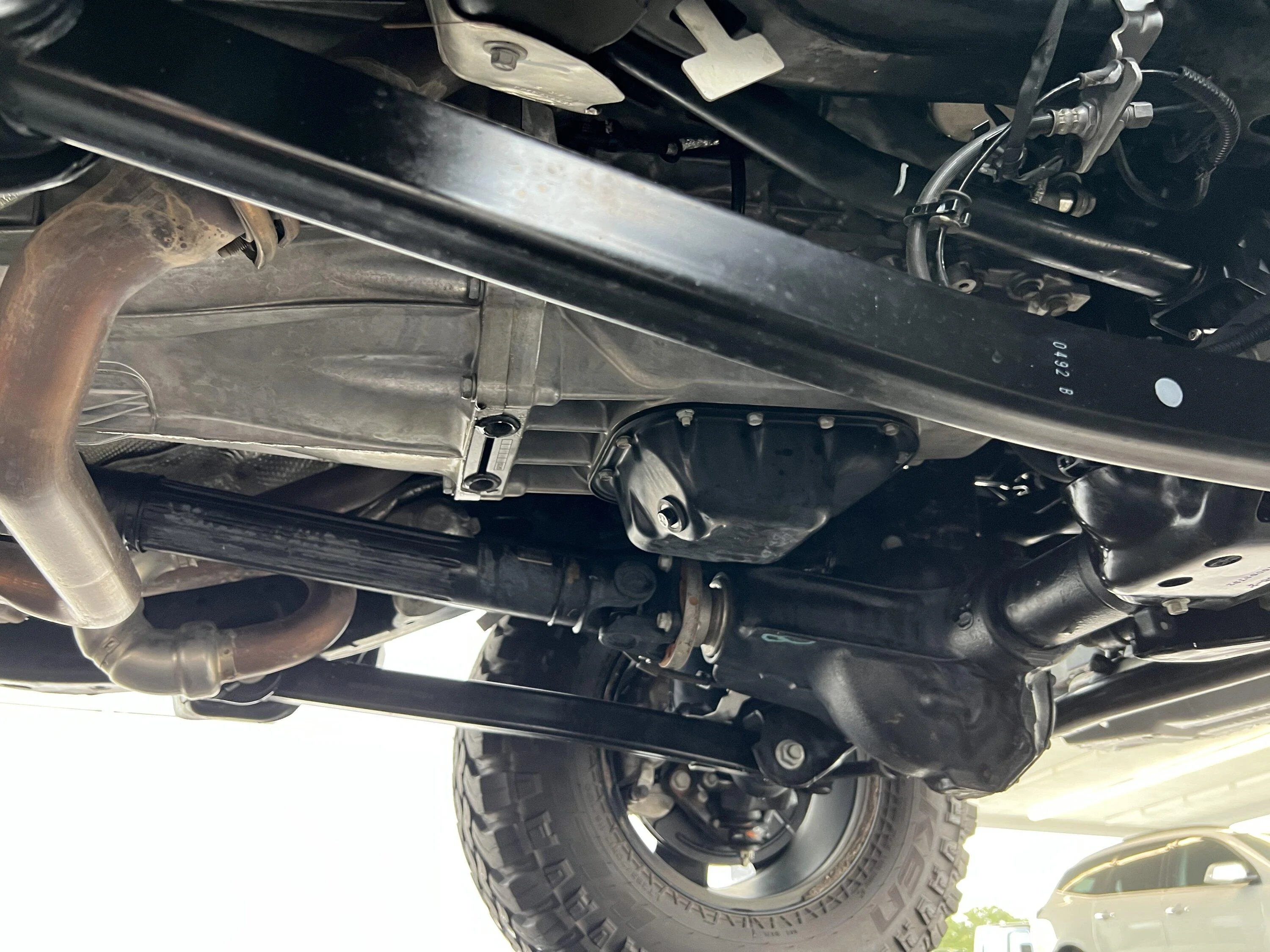

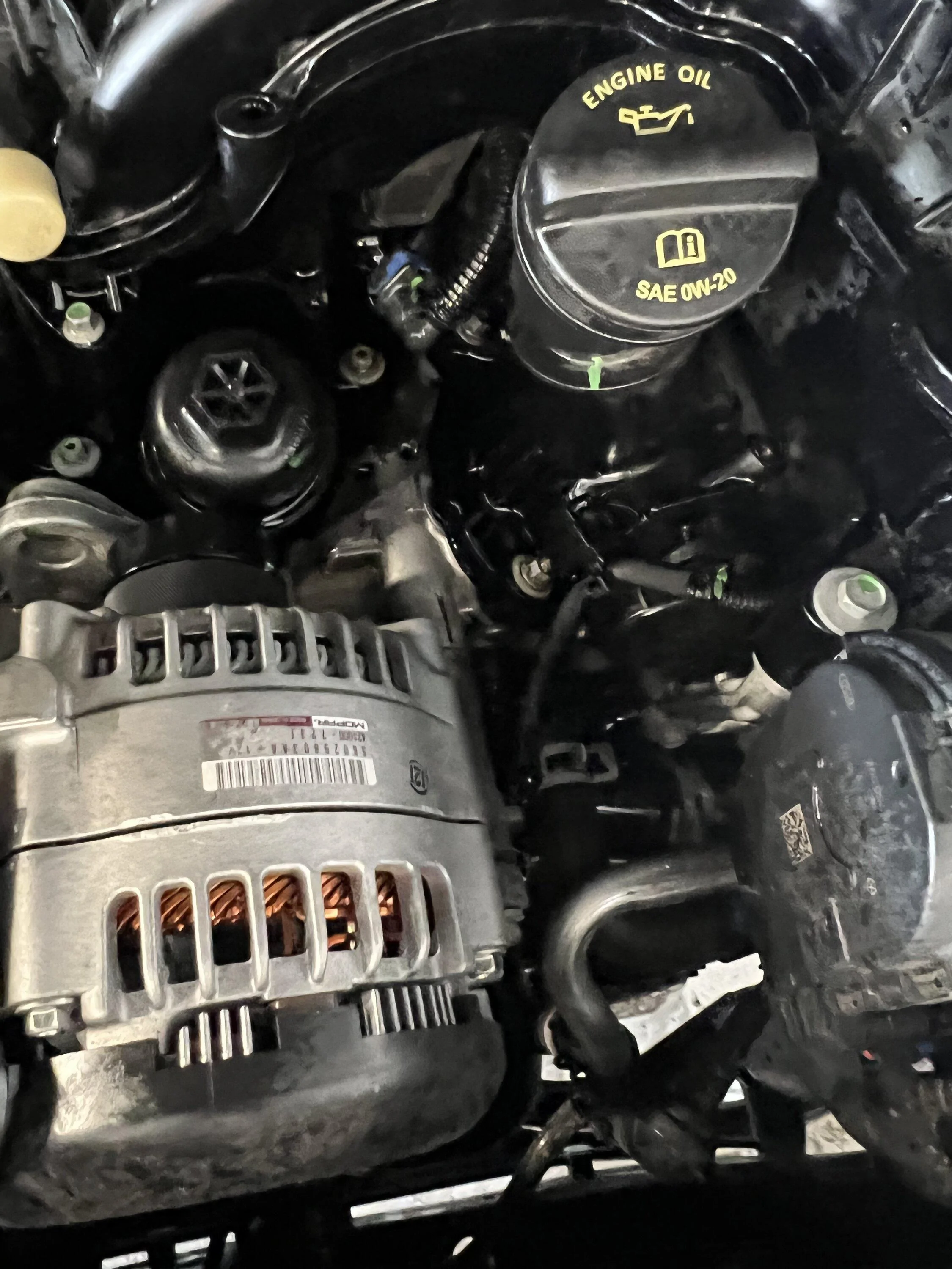

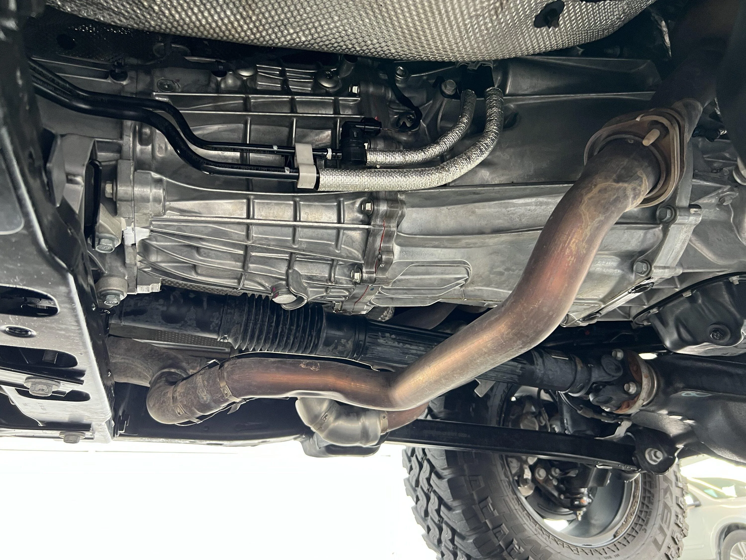

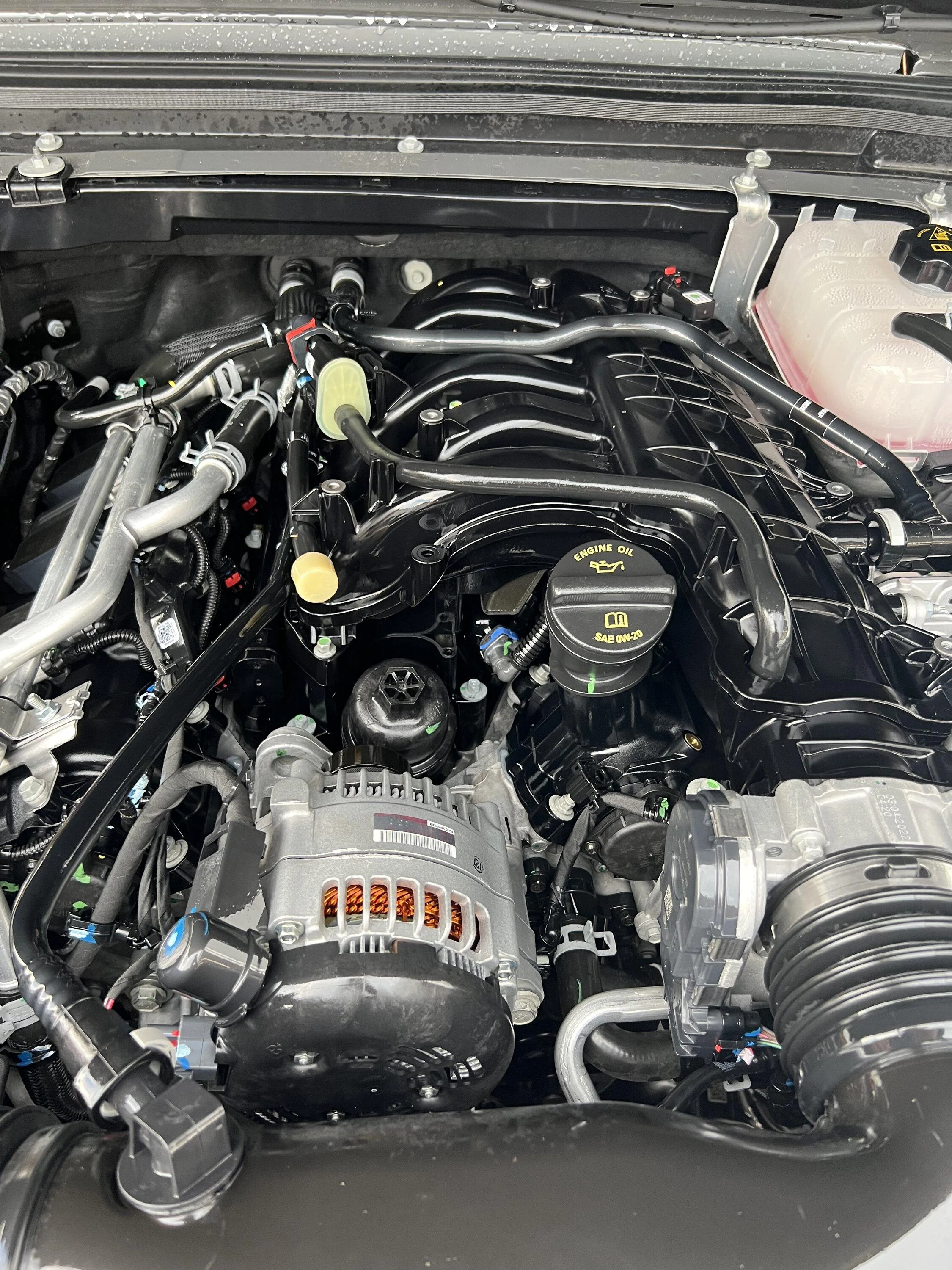

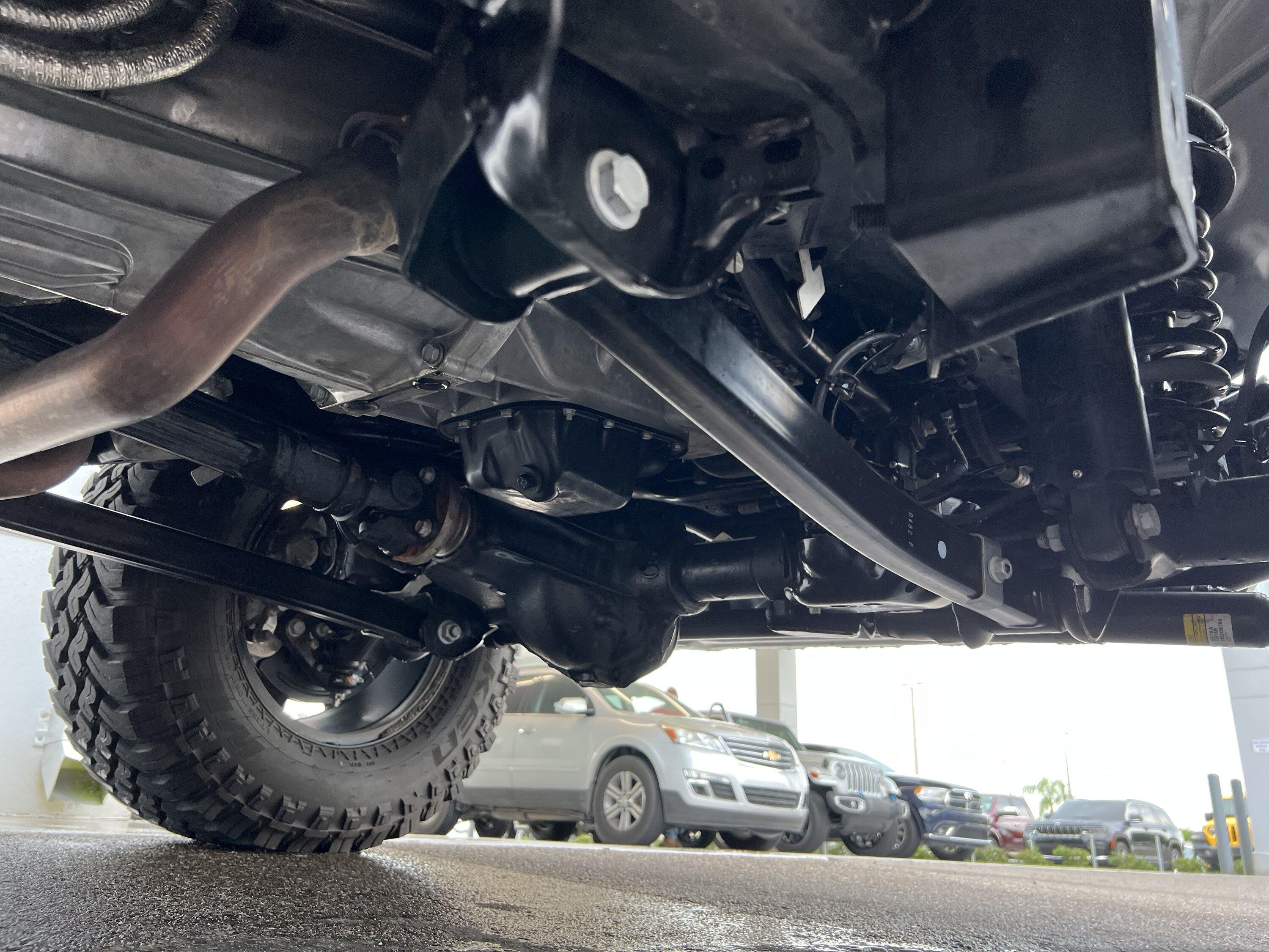

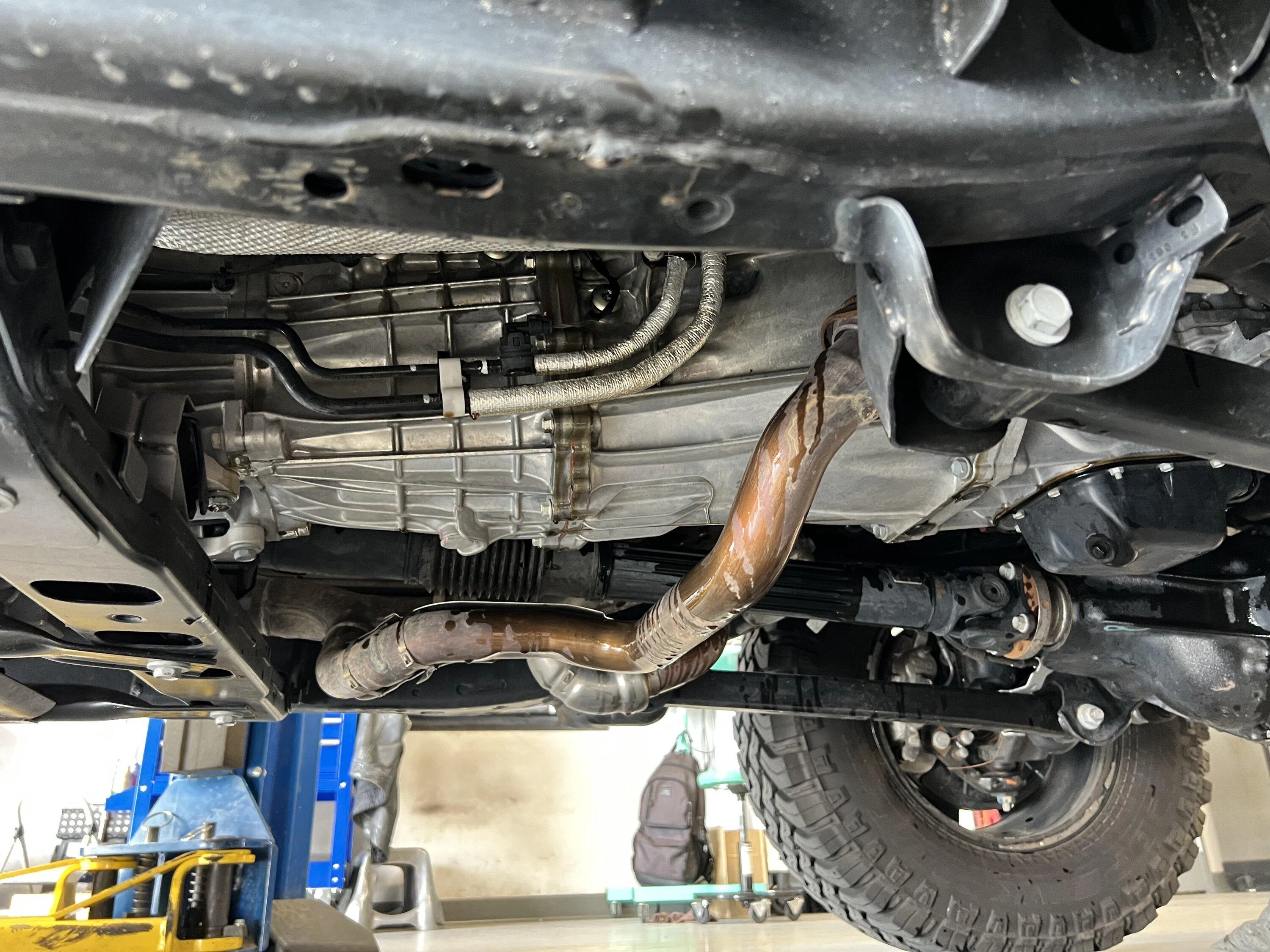

Thanks everyone for your replies and well wishes. I just picked up the Jeep from the dealer. They called around 4 to say it was ready, and I had left there around 11:30 this morning with the loaner. So about 4 1/2 hours to clean and test drive (got there at 10). I have to say, they did a phenomenal job cleaning the entire engine bay and undercarriage. They also detailed the engine bay, and I couldn’t find oil anywhere except maybe a tiny bit of residue on top of the drive shaft.
They all seemed genuinely apologetic and it seems like they did their best to make it right. Of course they want me to have that impression, but overall I’m satisfied with the outcome. I have the printed service receipt which documents, in writing, that the oil filter failed and caused a leak during the oil change. It includes the tech’s names and additional notes (replaced o-ring, cleaned oil).
I had also heard about warranty work not being covered if the oil changes/maintenance was not done at a dealer, so that’s the main reason I went in for the Jeep Wave service. I typically do my own oil changes outside of warranty.
At this point, I’ll just have to keep my fingers crossed that no issues come from this. But if anything does, the dealer knows that I’m coming to them with the expectation that they make it right.
Here are some pictures from when I picked it up. Everything’s wet because it had just rained right before I got there. Let me know if you see anything I didn’t. Engine sounds good, and I don’t hear any ticking or knocking.
Thanks again for all of your support!

Thanks for sharing your story. I am thankful that I change my oil and document such events. Keeping records is key when doing it yourself. Now that you had an issue with what they said was a loose filter cap or bad oring, I would assume you would keep the same dealer doing the rest of your oil changes. If some thing does come up due to lack of oil pressure, it would keep them in spot light. If the oring was left off or loose, it's hard to say what the oil pressure was and if any bearings were starved of oil. I would at least do a couple of oil samples in the near future.
I doubt you will see any trouble, but I'd hate to see you suffer for someone else's mistake.

Looks good to me. Oil isn't much of an issue. Especially fresh oil. Easily removed with degreaser and water.
I bet the tech forgot to put the o-ring on the filter cap after removing the old one.
