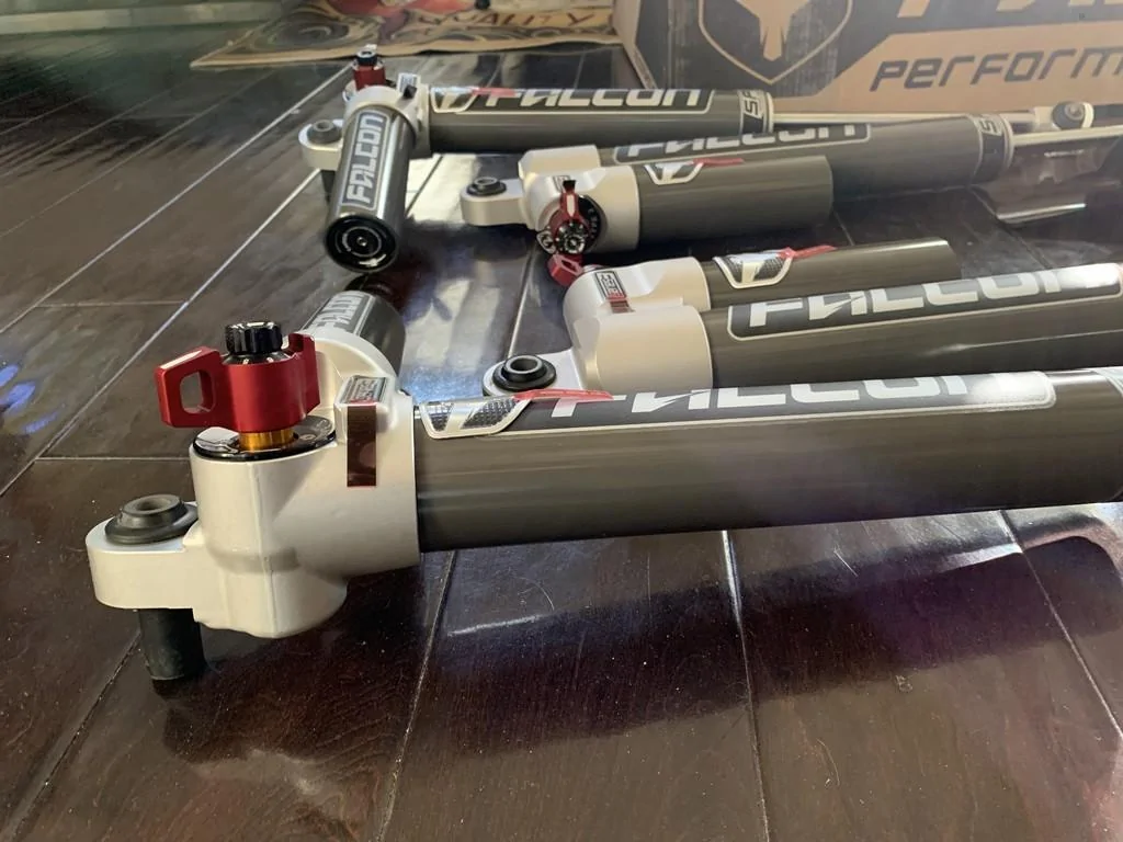

You very rarely will need adjustable on a Fox, King, or other linear/progressive shock. Largely the adjustable shocks are to soften up the harshness that comes with a digressively valved shock like Falcon, Icon, or lower/mid Bilstein.
Digressive shocks are excellent for daily driven or rock basher Jeeps because they are more aggressive off the bat, making them good for big hits (like dropping your Jeep of a shelf) and tighter on road. However, this makes them harsh over bumpy roads, whoops, and washboard fire roads. To combat this, the adjuster will soften the compression valving when you are off road and tighten it up when you drive on road.
Fox/King are linear which are your softer riding go-fast off-road shocks that are basically the inverse - they do very well on washboards and whoops but are more at risk of a G-out on big hits and have more roll on road. Here the adjuster is more for fine tuning and you'll see much less difference than you will on a digressive shock. If you valve them appropriately, you really don't need adjusters on these kinds of shock but they are nice to have.
So if you mostly drive on road and do slower crawly stuff, Falcon is where it's at IMO. If you want to cruise the desert or fire roads, look into Fox/King.
