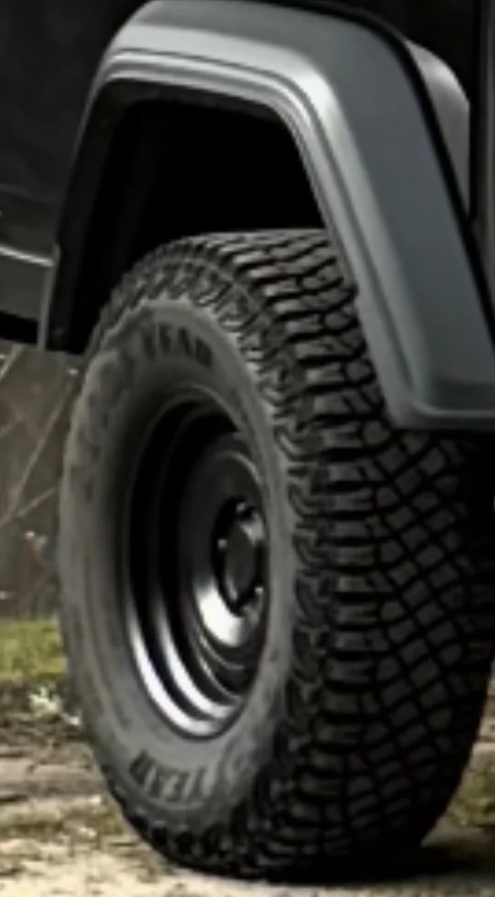

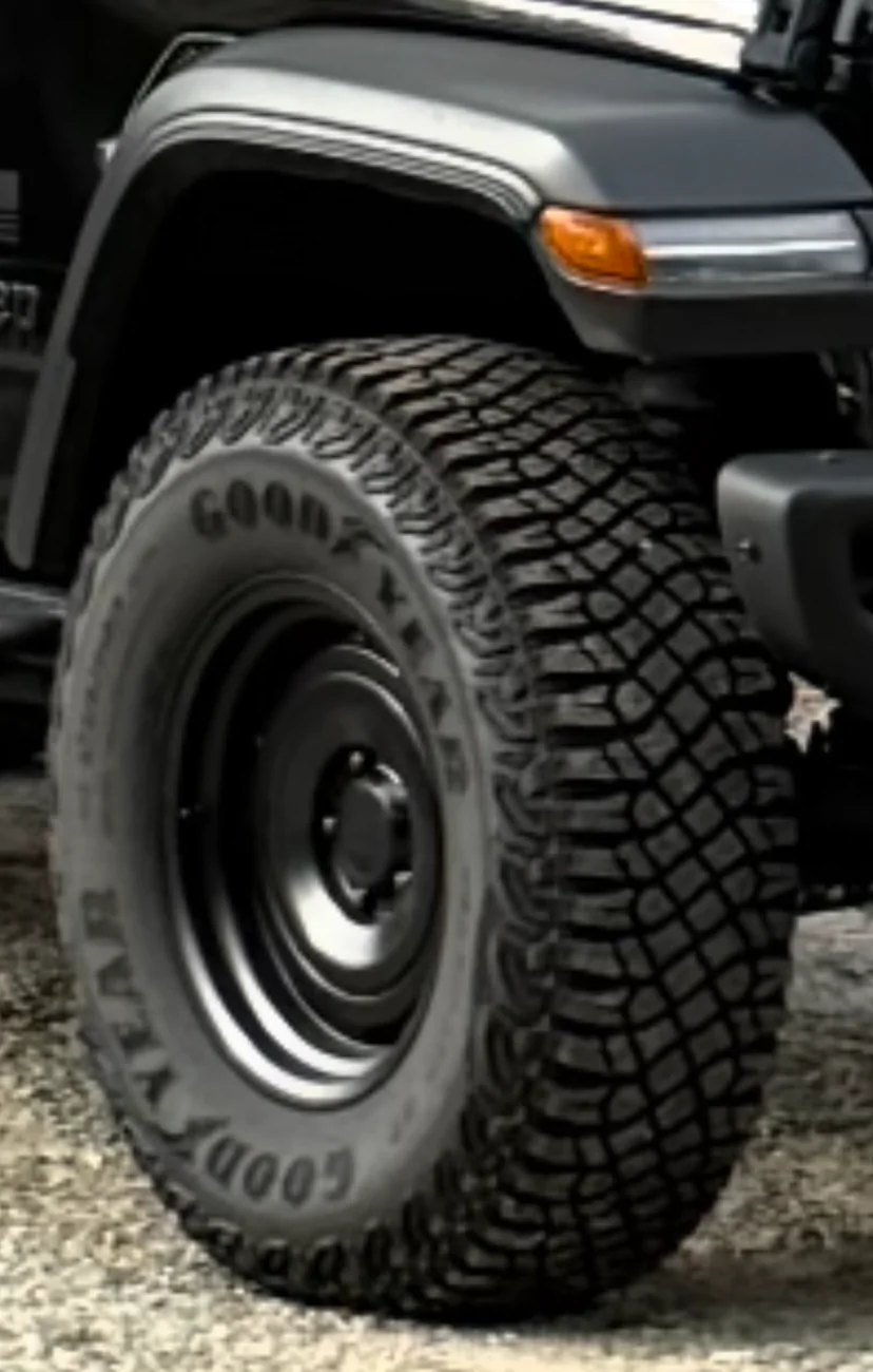

I have a 2020 sport s 6mt. Yes it’s a manual. The max tow flares were added to get proper turn signals.
I currently have
Rubicon fox shocks
Steel bumper/hardrop./tow springs
1.5 teraflex front level
.75 day star rear level
Mopar lift lca
Rock krawler adjustable front track bar
Helwig rear sway bar
315/70r17 Goodyear territory/kmc Roswell 17x8.5 et0
I would like to swap out my shocks/springs/leveling kit for proper length shocks and springs and eliminate the need for a leveling kit. Didn’t mind the ride at the time as the shocks were brand new.. but now looking for a better ride a year later.
As far as ride height is concerned I’d like to keep the same ride height. Looking for the suggestions from the group

Well, get a 2" Mopar lift with the bilstein shocks . Or a 2.5tera flex alpine with falcon shocks .your looks to be in the 2 inch range .
