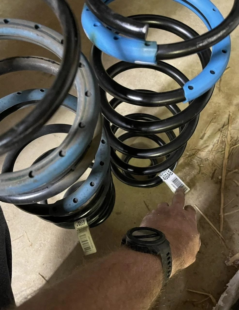

I don’t have the measurements, by my stock overland springs are below. I’m not sure why some springs are AB and some AC.
Front (L/R) 330AB/331AC
Rear (L/R) 439AB/440AC

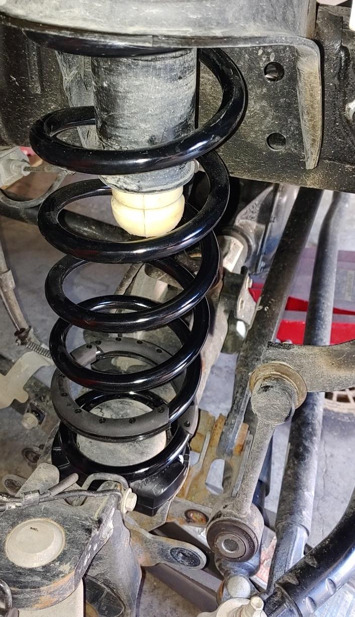

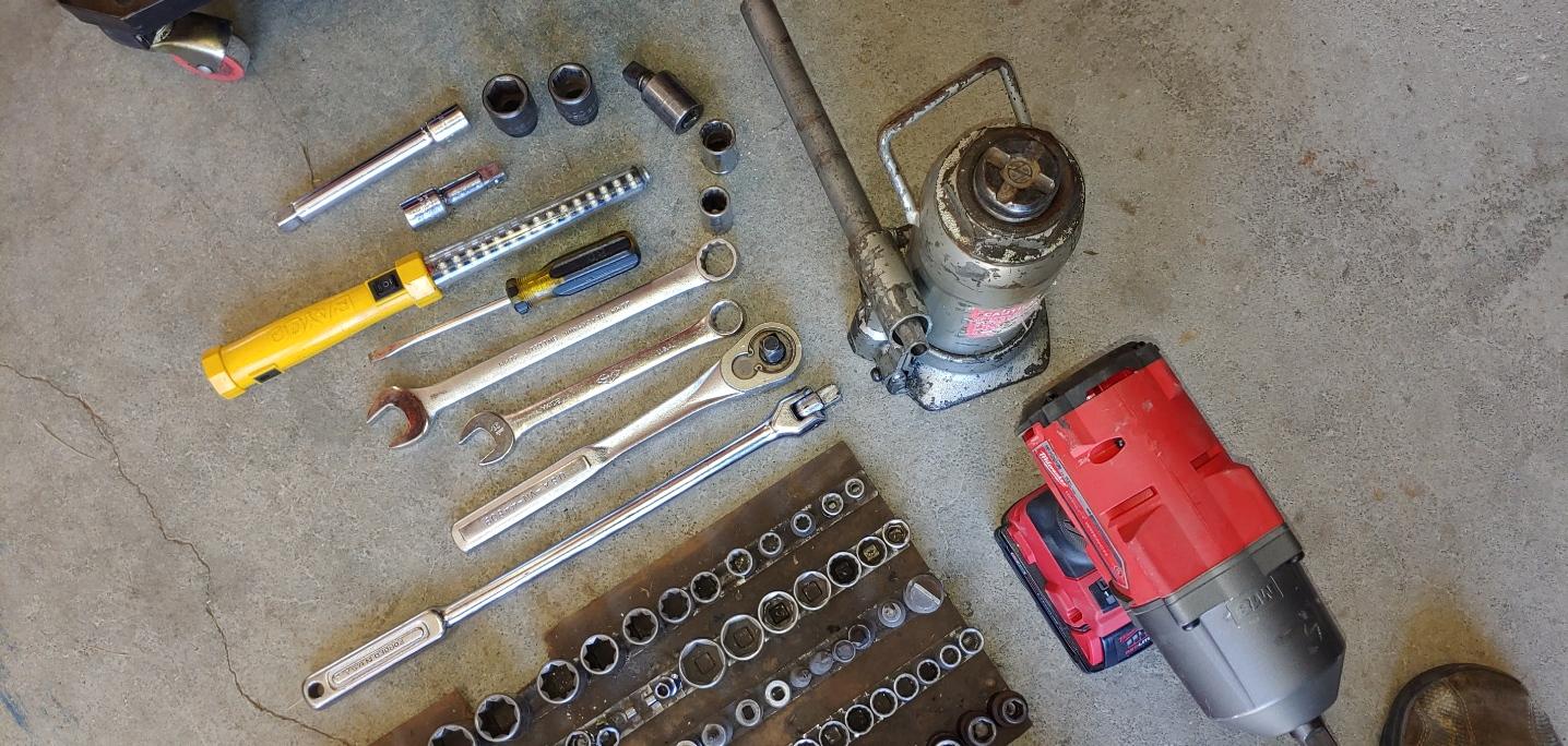

OK, here's what I did-
I carried my tools to the garage. I wasn't sure what to expect but figured almost all metric except for the 7/8" socket to remove the wheels. I took two of my 3 floor jacks to the garage - that's a 200' haul across gravel up to the garage from my shop. So two trips with a jack on the 2-wheel dolly each time. Then I carried two of my larger jack stands to the garage (another trip, 200')
Next I removed the drawer from my tool box that has most of my metric wrenches and took that to the garage, then I took out a section of my socket storage from the top of my box that has the most common size metric half-inch drive sockets and carried that up. Brought up my mechanics seat and cordless Milwaukee impact.
Of all of that stuff, I used only two wrenches and I think 4 different sockets, an impact swivel and a couple of short extensions.
One end at a time - front first. I loosened the lug nuts - breaker bar and socket.

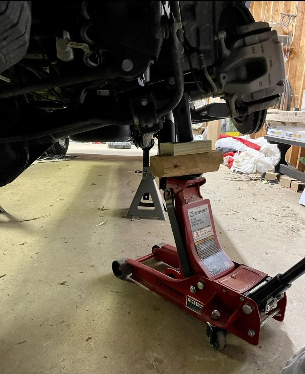

I used two jacks, one under the pumpkin and a smaller one under the right lower control arm bracket on the axle. I figured the pumpkin being off-center wouldn't raise the axle level or give me the control I wanted.
Truck up, set stands under frame, let it down onto the stands and let the axle droop a bit more, but jacks still under axle.
Removed tires.
Using impact and socket, removed shocks.
If I was doing it again, I'd plan better what to remove on each side with the tires turned either left or right. You do need to turn the wheels to get into some spots easier. With them left you can remove certain things on either side, then turn them right and remove other stuff.

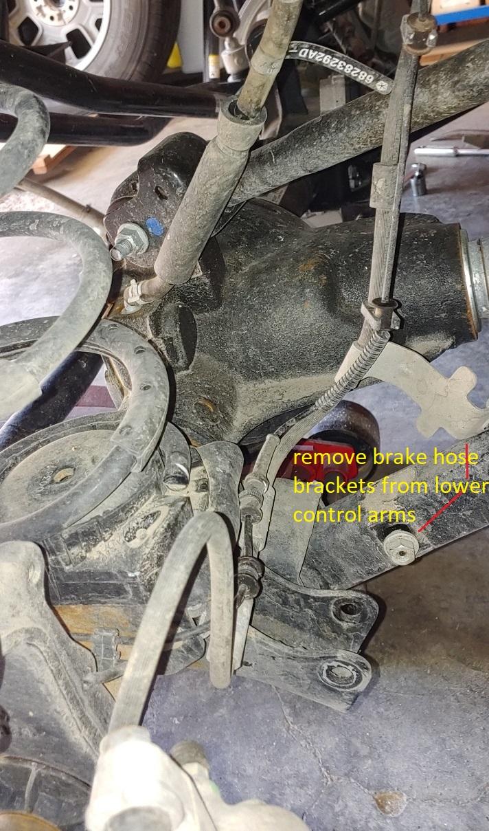

I saw I'd need to remove the brake hose brackets from the lower control arms so did that.

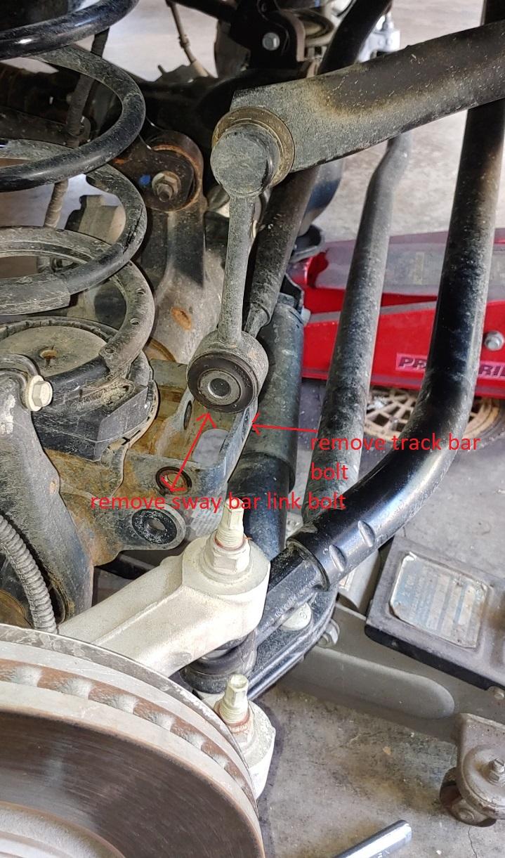

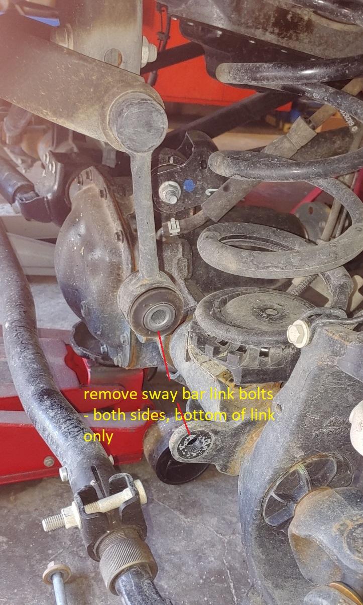

Sway bar links disconnected at the axle end, didn't touch the upper end of the links.
I did not even touch the control arms themselves, left them fully in place.

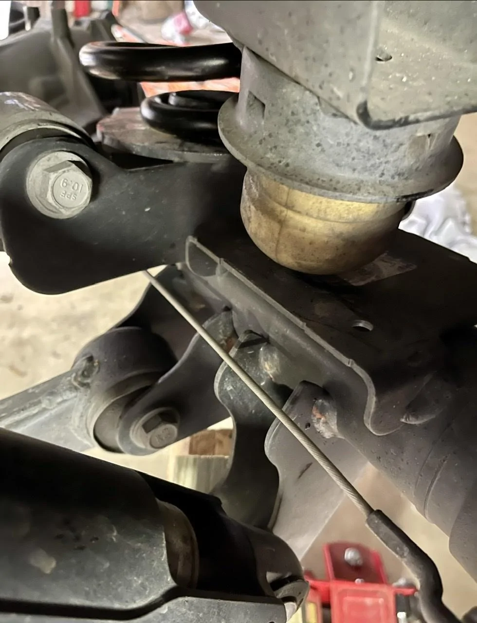

I removed the bolt for the axle end of the track bar - right side near the bracket for the lower end of the right sway bar link.

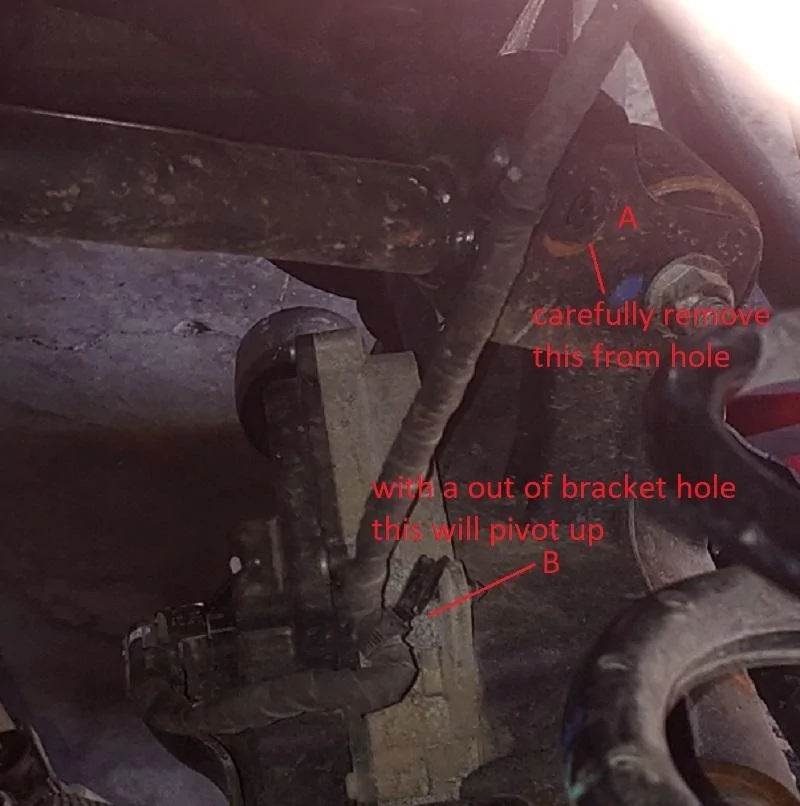

For the FAD wiring, I found that if I removed one of the wire straps that is secured to the axle that the wire would pivot up and give me plenty of slack to lower the axle enough to remove and replace the springs. So I did not disconnect the FAD wire - in one of the pics (the worst one, sorry) I show where I removed the wire strap from its hole in the axle bracket - carefully with needle nose pliers, pushed it out of the hole. It's barbed in the hole so if you push the barbs flat toward the bracket on the back side, it can be manipulated out and re-used without damage.

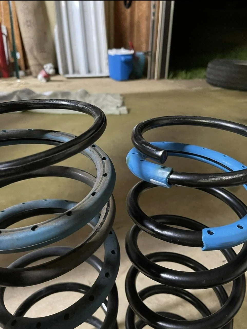

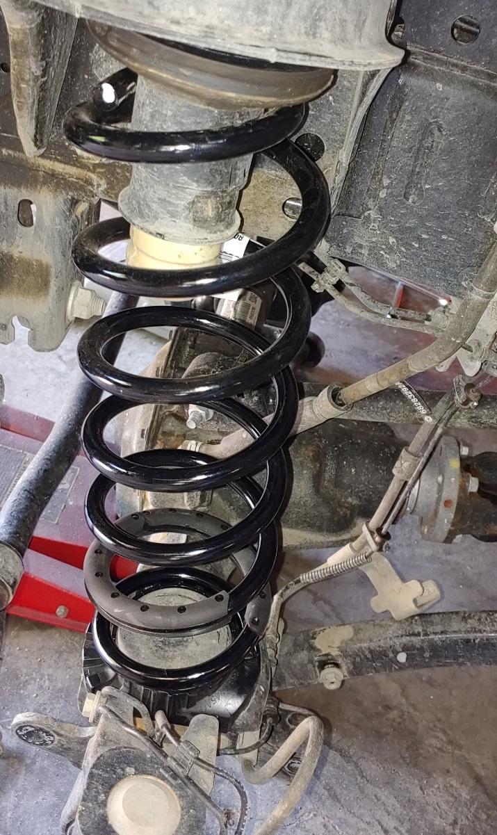

The Overland springs came out pretty easy, the Rubicon springs going in were a bit stiffer and a bit taller so I sort of pulled down on the axle a bit while putting the spring in place on each side. Not a lot, didn't take that much really.
I then reversed the process and put it all back together -

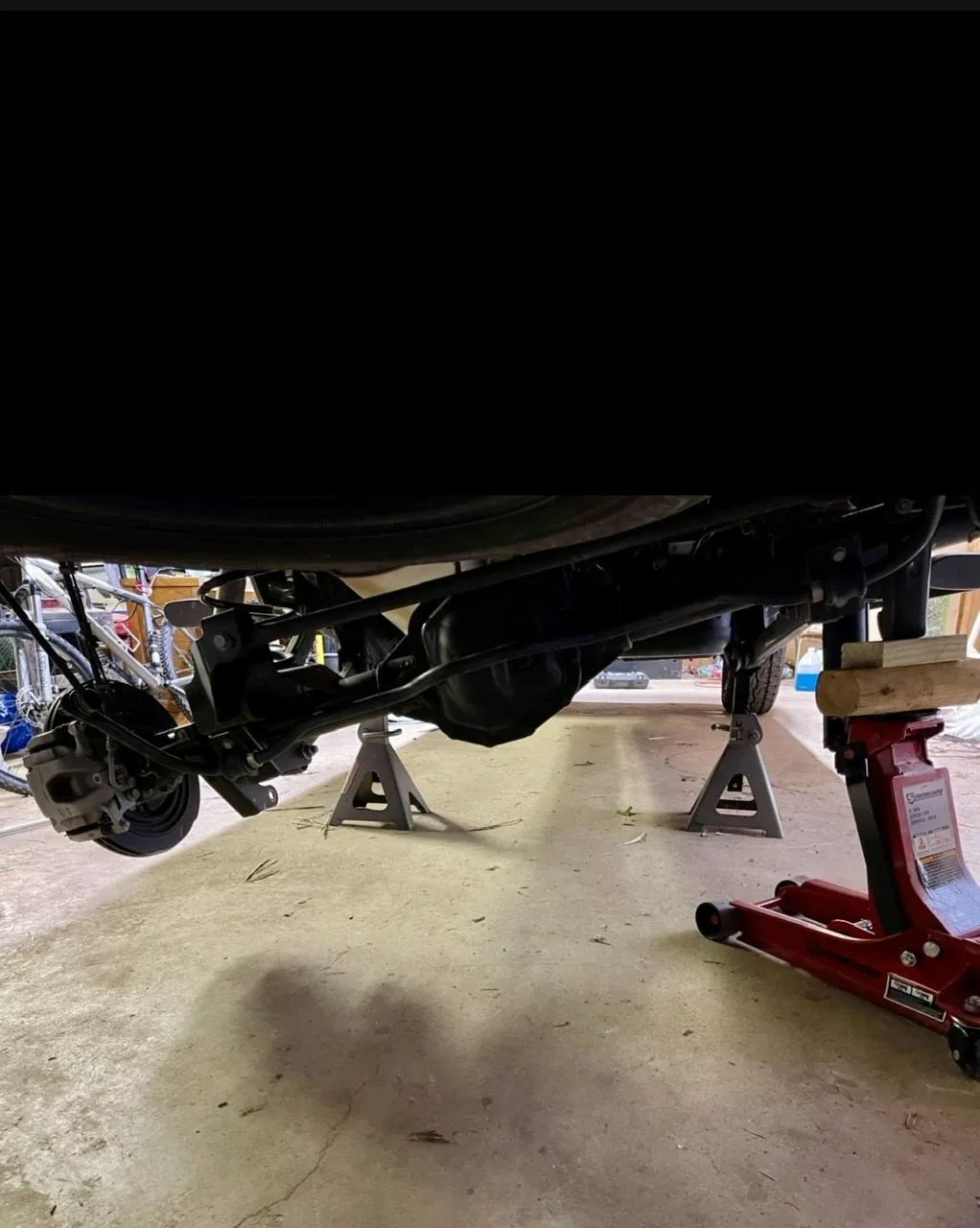

Next to the back end. This was much easier. No messing turning wheels back and forth to get an impact in place or reach with a socket, etc. Things were in plain sight.
Again, axle end of track bar, axle end of sway bar links, and shocks.
To get clearance to remove the springs the brake hoses BARELY made it. They were maxed out. But it wasn't a lift so I didn't need to unbolt the calipers and raise them to get hose slack.
To get the rear axle down far enough to remove the springs, I found a piece of pipe that fit up into the middle of the rear axle snubbers/stops, the pipe length was so that when I put the pipe up inside, it just barely stuck out the bottom of the rubber stops. I used a bottle jack on the axle "shelf" where the snubbers or stops would hit and jacked up against the pipe in the rubber stop and pushed the axle down JUST enough to get springs out. Careful so as to not stress the rubber brake hoses to the calipers.
The worst part was holding the top spring pads up in place with the "nipple" up in the hole and clock the springs so the end of the coil was in the proper place against the stop on the top spring pad. That almost took 4 hands. If doing it again I'd clean up those pads really good and use 3M 008001 super weatherstrip adhesive to hold the pads in place up there!

These are the tools I carried to the garage - the ones in the middle are the only ones I used out of the drawer and out of that section of sockets. Geesh, could have carried those up in my pocket!
Yeah, this is all I really needed for tools - couple of wrenches, 4 sockets, swivel and extensions and breaker bar (torque wrenches I carried up later)

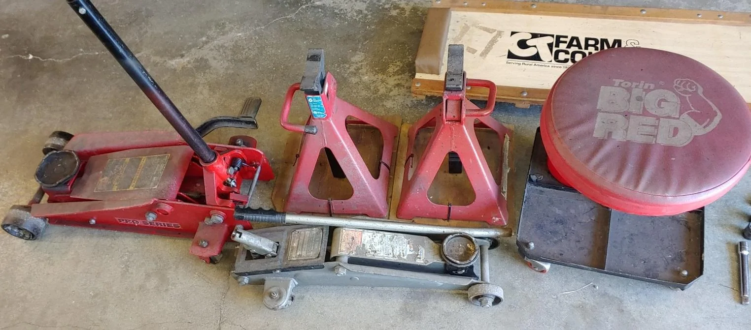

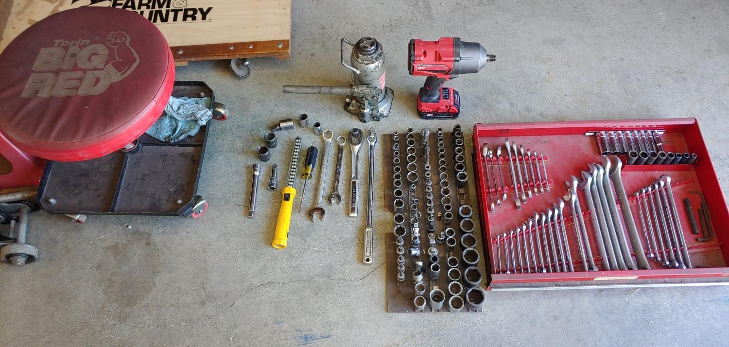

Two jacks, two stands, broken creeper and a seat -
FAD wire showing where I removed a clip and the lower one that swiveled up a bit to give me plenty of slack without disconnecting -

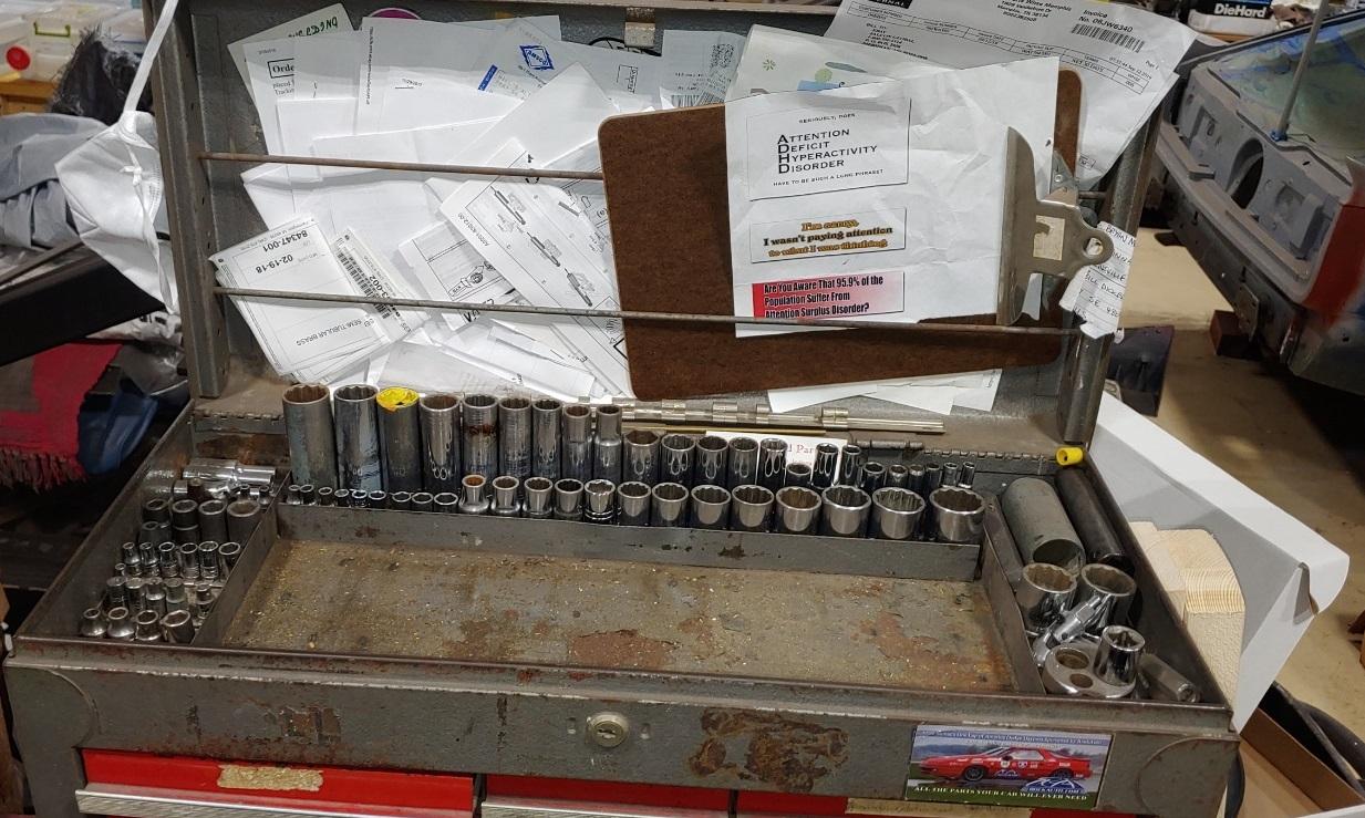

I keep my sockets on rails mounted on "Masonite" hardboard so I can easily lift sections out to take closer to the work. The tool box itself is a mess, dates back to about 1975. It's too heavy even for two men to lift, when I moved I had to use my engine hoist to set it into the back of my truck to get it to my shop from the garage - that's just the TOP section.
The empty spot is where the sockets I carried to the garage to do the spring swap belongs -
(I have a 3/4" drive socket set, and some larger and specialty sockets in a drawer. Too many to fit here)

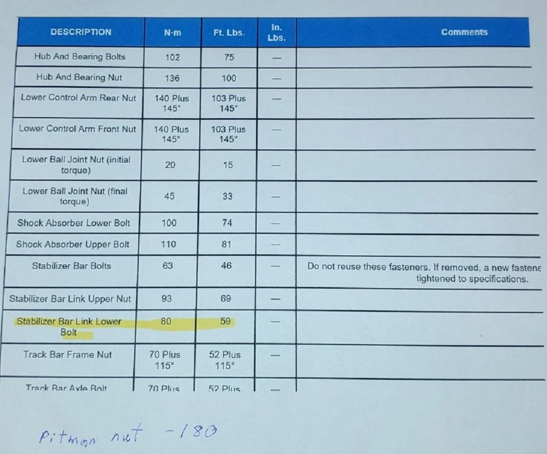

Do you or does anyone have the torque specs handy for the shocks and lower sway bar end links? I’m doing this again tomorrow and trying not to forget anything.
I didn’t touch the lower control arms when I did it last time so not concerned about that.
This is what I have in a binder in my shop. Can't recall where I got it.....

Btw, it’s not just a max tow thing, Overlands apparently have the longest rear coil springs. When I compared them to the Rubicon coils, they are about an inch shorter. Those are probably the most HD coils too since off of a launch edition. 450/451AB.
If I recall correctly. Mojave springs are shorter than Overland. It's really a total pain to remove Overland rear springs - the brake lines are stretched to the max to get the springs OUT but you can relax the rear axle back up a bit when putting other springs in.
Yeah. It was sketch too because I didn’t have a big enough floor jack. I had to use the lower shock mounts and flex it all the way to the bump stops. My jack didn’t go high enough so I had to stack some wood on top.
Then I still had to pry them out. I tried my best. I think I got the nipple thing in the hole. I hope it’s not a huge deal if not. It drove great so hoping not.
